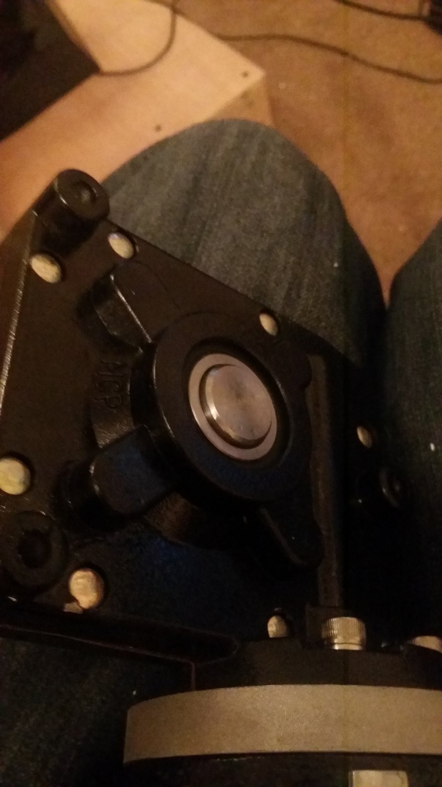

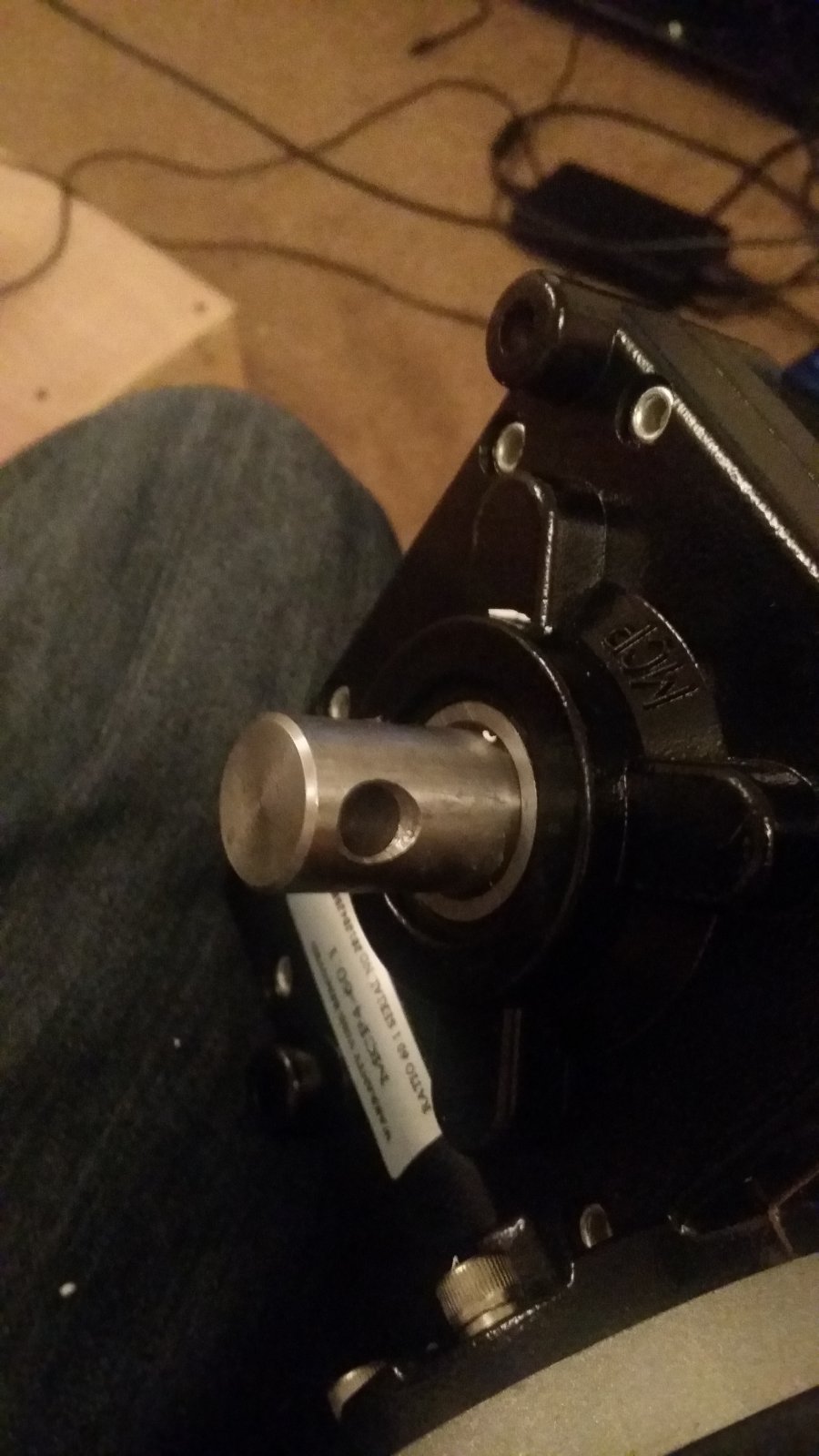

    More importantly (whilst I haven't sorted the linkage part out yet) I have collected my motors but :
    What do you guys reckon for mounting the arms (and maybe the pots) to, I was kinda expecting the hole to be on the face rather than the side

    also with these motors, as the mount hole is on the side of the shaft, would it be a bad idea to weld the lever to the face of the shaft to save messing about, which in turn, weld a bolt/metal to the other side for the pot to attach to?

    I would be concerned that the heat could make the shaft brittle.

    That is true :( i know the keyway is an option although im either searching wrong but cant really seem to find anything or quite expensive, do you think if i did like an L bracket that mounted to those side holes, it should be ok?

    I think a correct sized interference fit tube using the hole to bolt through to secure it would be better.

    Ah yes i remember seeing yours now (couldnt think at the time), another suggestion i had been given would be to drill and tap down the middle for a bolt..
    Do you remember what you used for the tube if its the same motors we have?

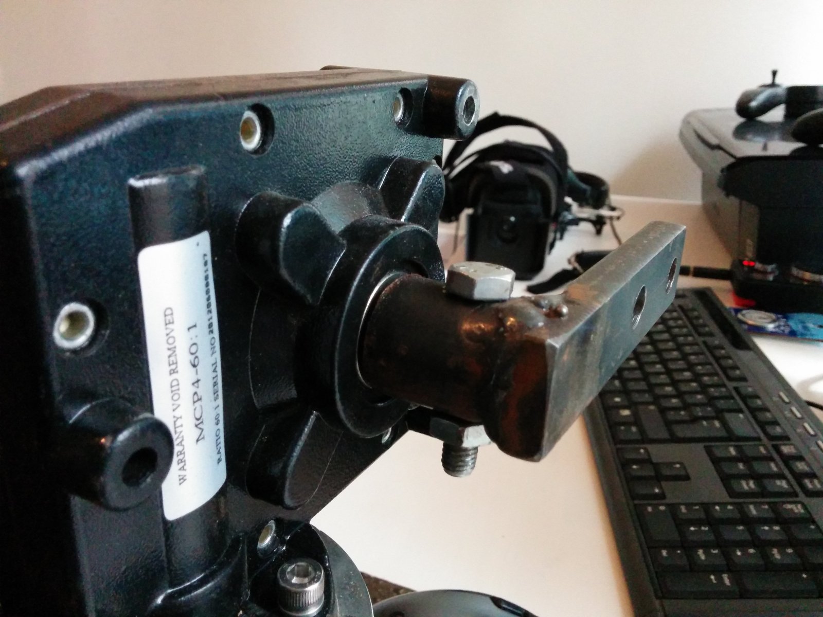

    I have the exact same motors as you do. I attached the levers with a tube that had a hole to allow for a M8 bolt to go through. The tube was little too big (fractions of mm) and I used aluminium from a beer can to fill the gap.
