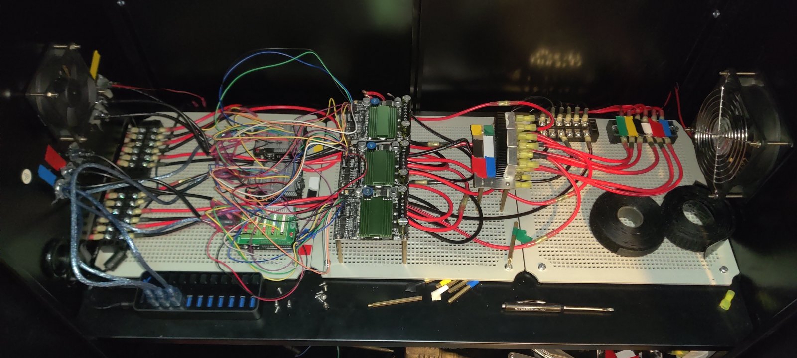

    So running into a little issue here, trying to get the second motor on the same Arduino to work correctly.
    The motor does spin both ways when given voltage either way.
    Video pretty much explains everything.
    Thank you in advance

    I watched your video , the first thing that strikes the eye is the arduino version 0.70 the latest is 1.0 :),
    Something must be wrong because with the “Monitor” option enabled both motor 1 and 2 should be stationary.
    Disconnect power from the motors , and check if by turning the potentiometer you have a change in the green line ?
    It would be best if you made a test wiring for only two motors , separate from your power cabinet.
    I'm worried about the movement with the “Monitor” setting :(

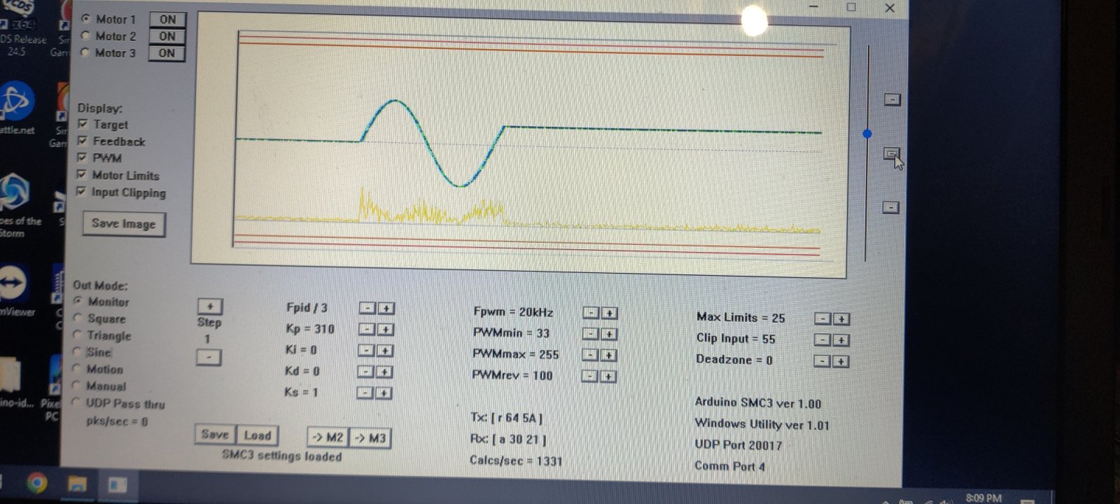

    These are the settings for motor 1 on the first board.
    I copied the settings to motor 2 and messed with every single setting, from minimum to max, with obviously no success.
    I'll keep this updated,thank you for the help

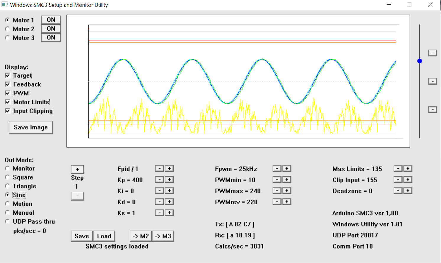

    How SMC3Utils works :
    1. the motor does not move when the green line (potentiometer signal reading) is in the middle, and coincides with the blue line.
    2. 2. when you select “Sine” from the arduino will output a signal to the IBT to turn the motor , at the same time from the potentiometer will return a feedback signal by what angle the motor turned , that's why on the graph the blue line and the green line overlap .
    If you have one motor working, then rewire all the wires from motor 2 to the arduino outputs of motor 1 and connect to the output of motor 1 in IBT2. If it is ok then you have verified that the motor and wiring is correct.
    I would look for a faulty IBT2 though, I have had only one channel in IBT2 faulty several times in my project.
    The question is whether you uploaded the batch to the Arduino with “MODE 2” set ?
    Attach the file you uploaded to the arduino.

    I think you need to go back to the beginning, at this moment you have a thicket of wires and confusing meter readings that are difficult to interpret.
    I suggest:
    1. remove one arduino board.
    2. connect two potentiometers according to the diagram
    3. run SMC3Utils and test whether the board correctly generates a signal to control the motors.
    It should, with “Sine” movement, look like this on the attached video, on which I assembled the ELEGOO board + 2 potentiometers.
    Notice that despite the absence of motors and controllers, the arduino generates the correct sine wave (blue line) and PWM signal (yellow line) for both motors, of course, the feedback signal from the potentiometers does not change because there is no real movement.

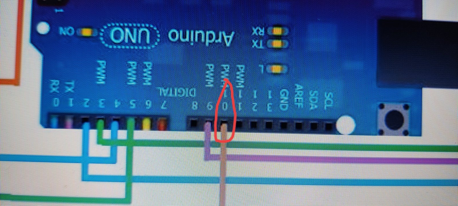

    Well I figured it out, after 3 painful days.
    This is not a dash and a zero -0. This is the number ten!!!!!
    I thought it was supposed to be plugged into zero. Which is why all 3 boards did the exact same thing lol
    Time to put everything back together and return 3 Arduinos it seems lol.
    Omg I'm so happy I found it,I was going absolutely nuts.
    I really thought it was a dash.
    I actually ended up reading the code to figure it out lol
