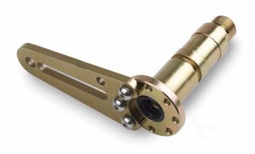

    Just buy a threadend like something like this:
    https://www.toolstation.nl/draadein...QUmmJbupEas7sXHGrg1AVu59ioJhYpbgaAgA2EALw_wcB
    And then female ball joint something like:
    https://www.grandado.com/products/s...DZA6_NBtCCqp-VRzzi4w12lKUrRFoH_oaAogjEALw_wcB
    And for levers something like this.
    Here video of how it works, of course mounted reversed. Watch at 38 sec.
    https://shaft-collars-couplings.sta...--search-/accu-flange--shaft-mounting-collars
    At least this is what I am planning.
    I am currently in contact with a company that is specialized in gas springs/dampers. Which should help the motors with the load and also with smoothening out motion(s). But I can't give any detailed info on this yet.

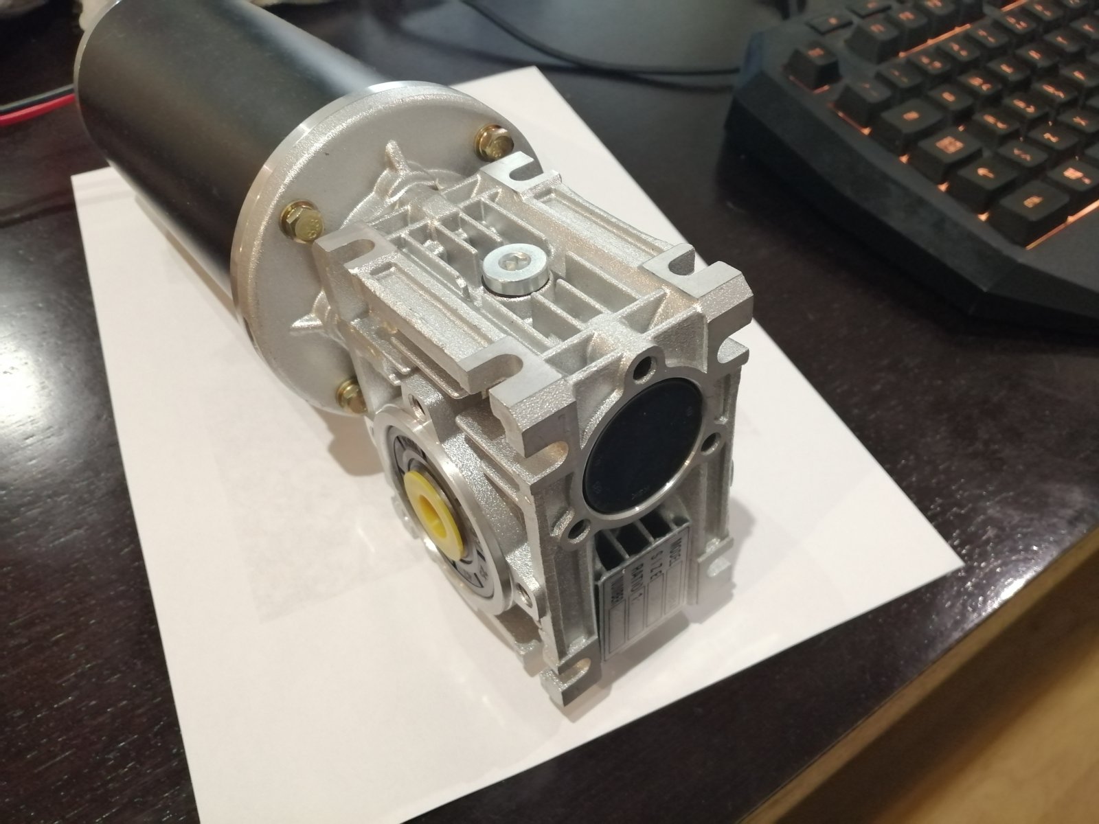

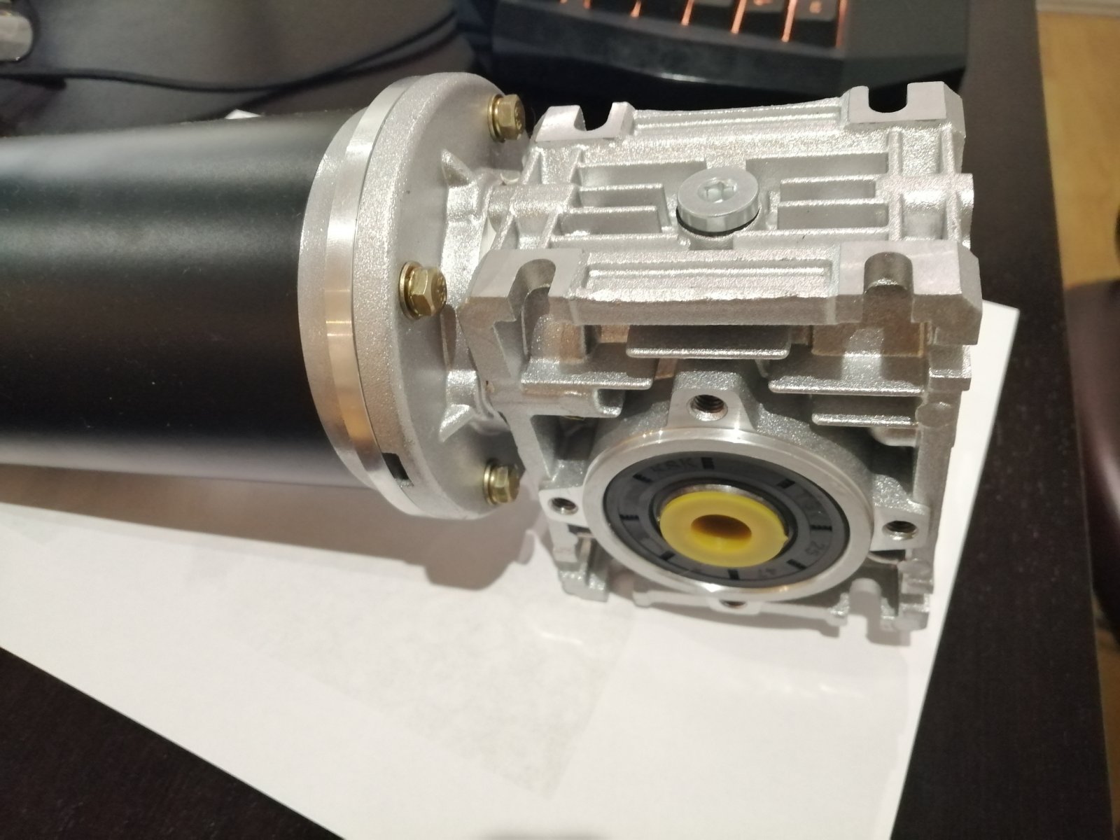

    @Mike Melga ps. share some pics of the motors and shaft if you can please. Thanks.

    Forgot to say, you can then simply mount the lever to it like so:

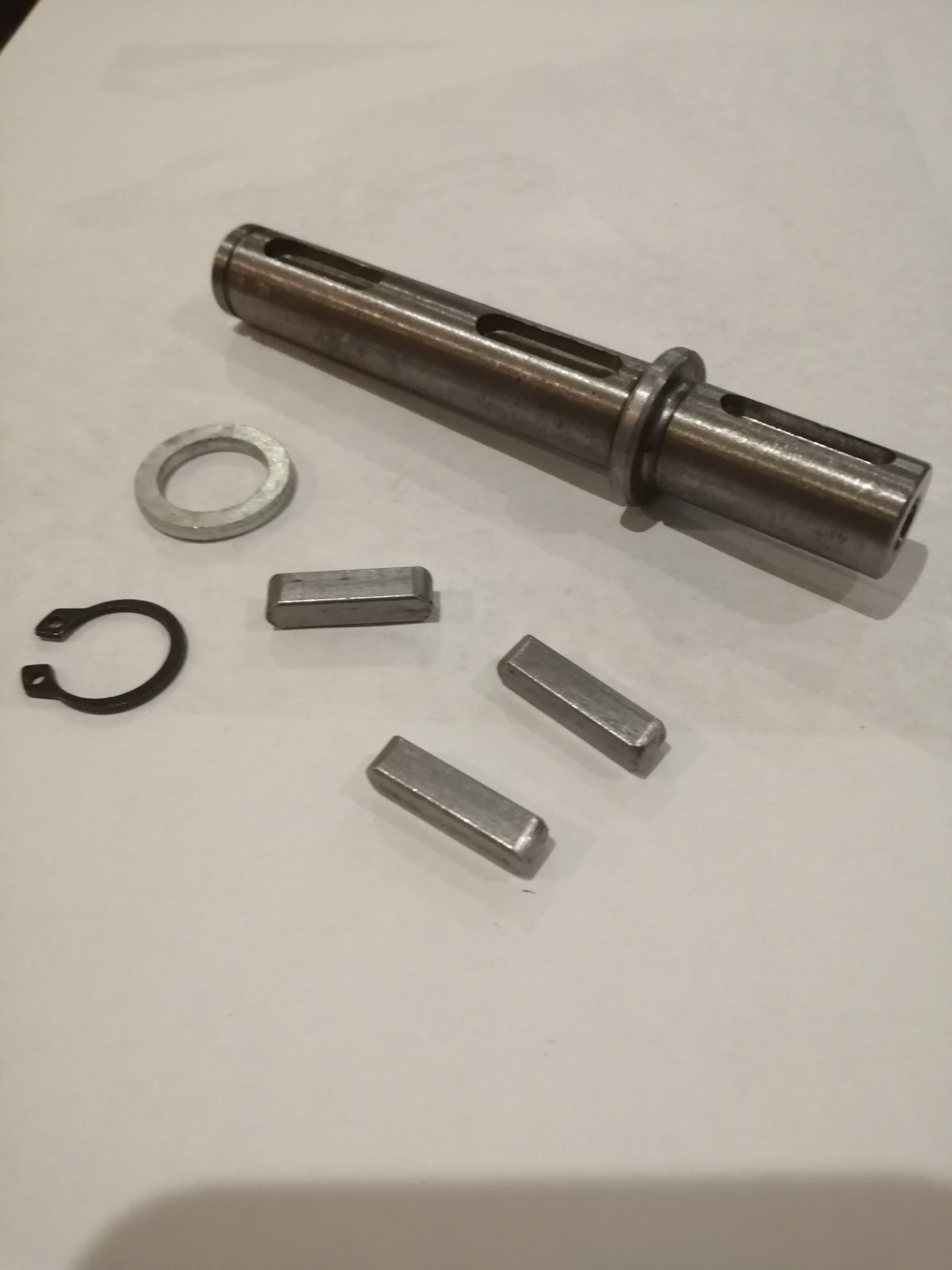

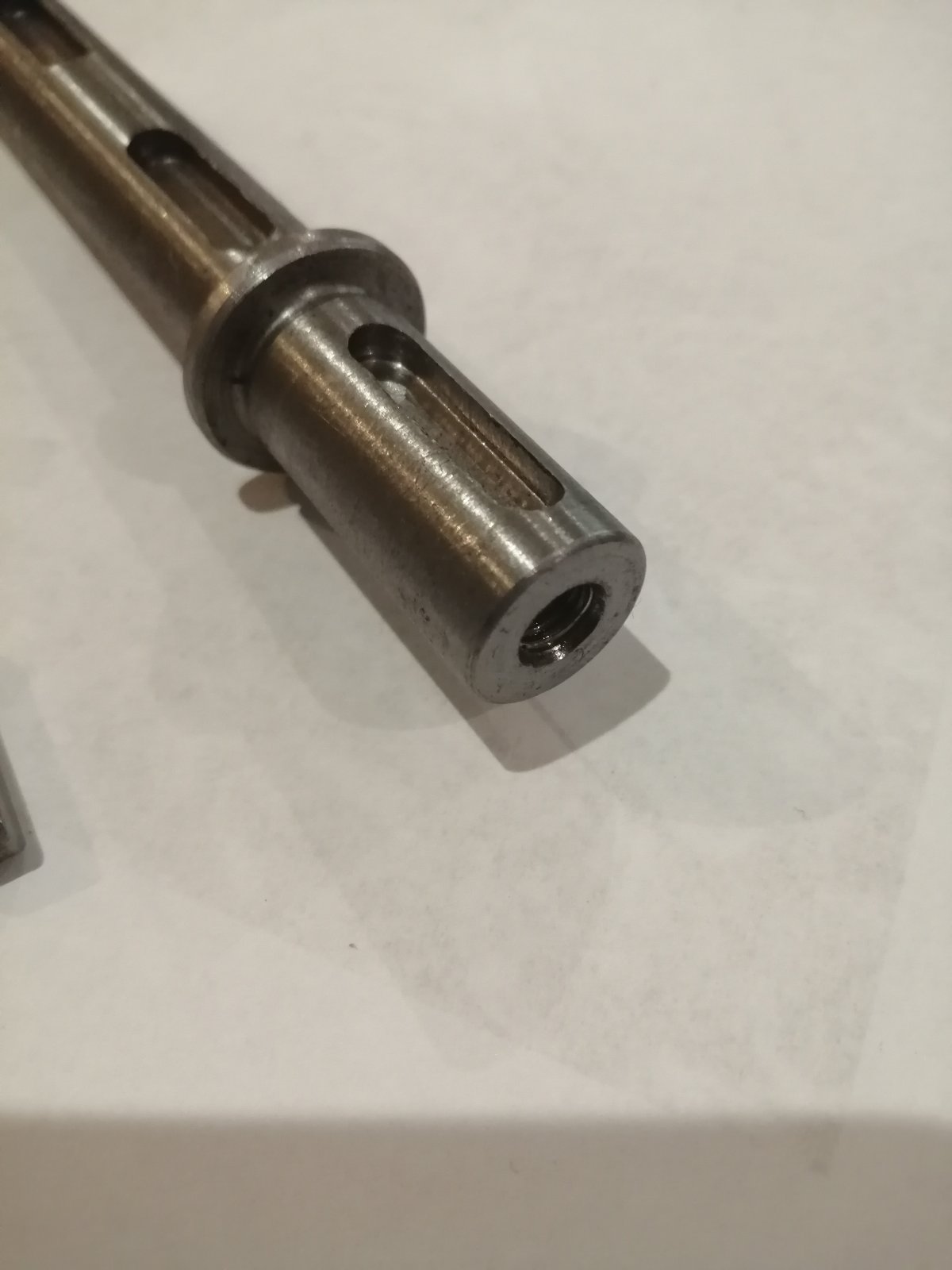

    @Rens
    Here are some pics of the motor and shaft.
    I guess the rods are quite simple to find. I just haven't look enough.
    I will try the u-joint next week. I am looking for something compact.
    My main problem is the shaft collar and lever. I am trying to find a dealer here in Europe.
    If you find one...let me know :)
    IMG_20201010_193744.jpg IMG_20201010_193737.jpg IMG_20201010_193611.jpg IMG_20201010_193542.jpg
  17. Rens
    Rens Member
    Aug 21, 2020
    79
    517Coins
    +29 / 0 / -0
    Nice, looking good. What is the diameter of the shaft? I believe it is 14mm? According to the datazheet but I find this to be a strange diameter. (9/16 of an inch).
