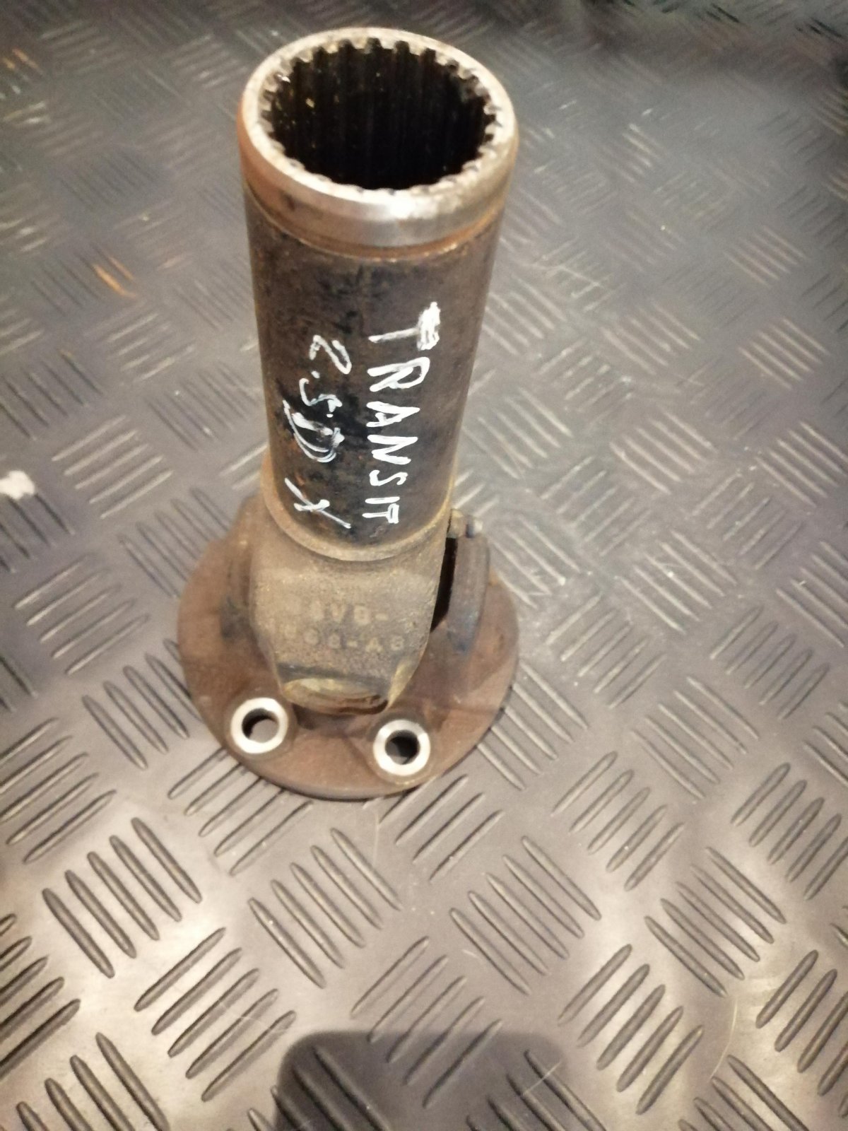

    I agree, the second one can handle the force and will be stable enough.
    22,027
    153,758Coins
    +11,148 / 57 / -2
    A steering joint could support a seat, but its smaller size means you may get some unwanted lateral twist.
    A car tailshaft uni joint is overkill in terms of supporting a seat, but ensures there is no lateral twist.

    hi guys. I have been using the small one or one similar to that for years on my rig with no problems. Helps to keep the centre of gravity low being so short. The real test is how much twist (wear in the bearings) there is as the seat needs to remain straight.

    Thanks for your comments.
    Just in case...I've bought the other one. Now I have both :)
    The bigger one has a very subtle 'home position'. You notice when you leave center position. It's very subtle so I guess it won't affect overall movement.
    Or am I wrong?

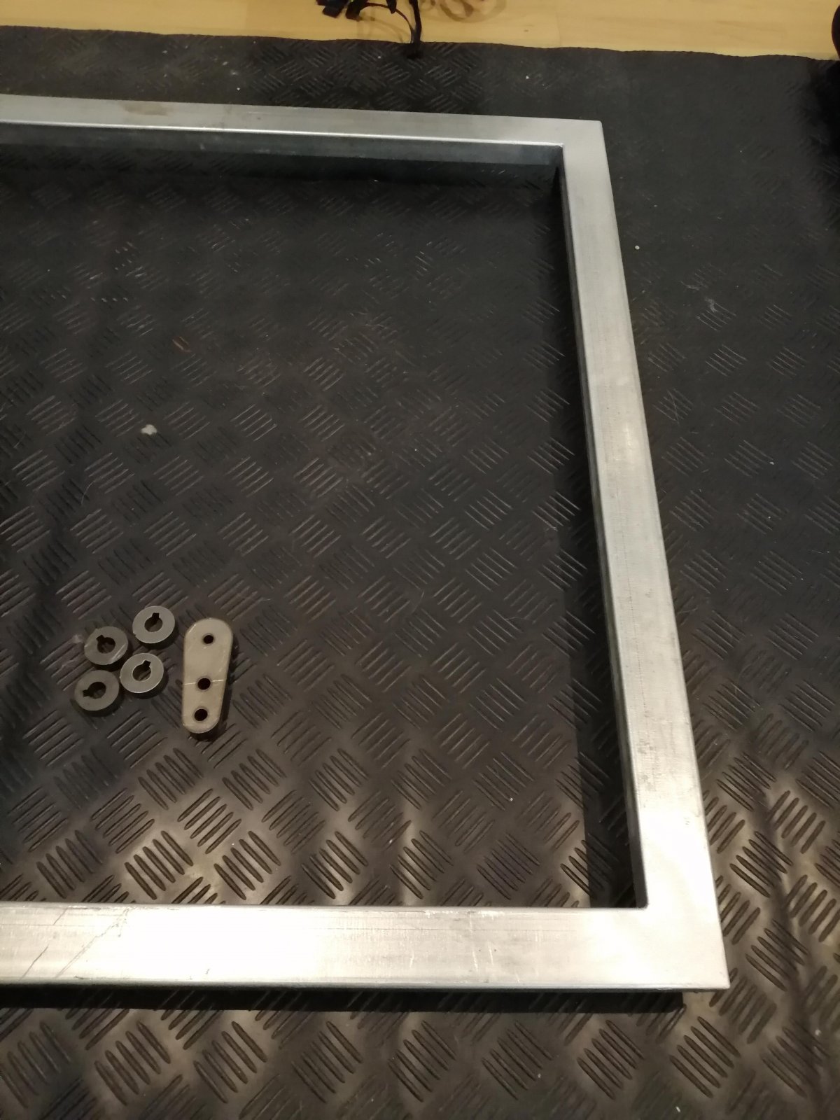

    I already have my base and seat steel structure and also a base sketch for a triple monitor mount.

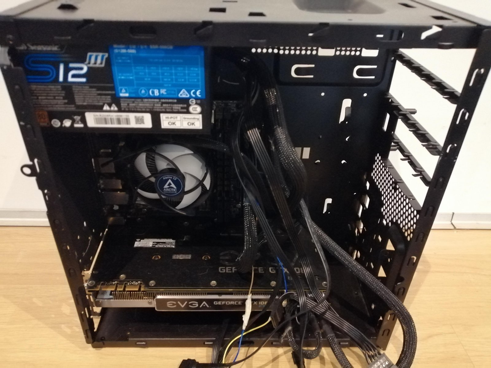

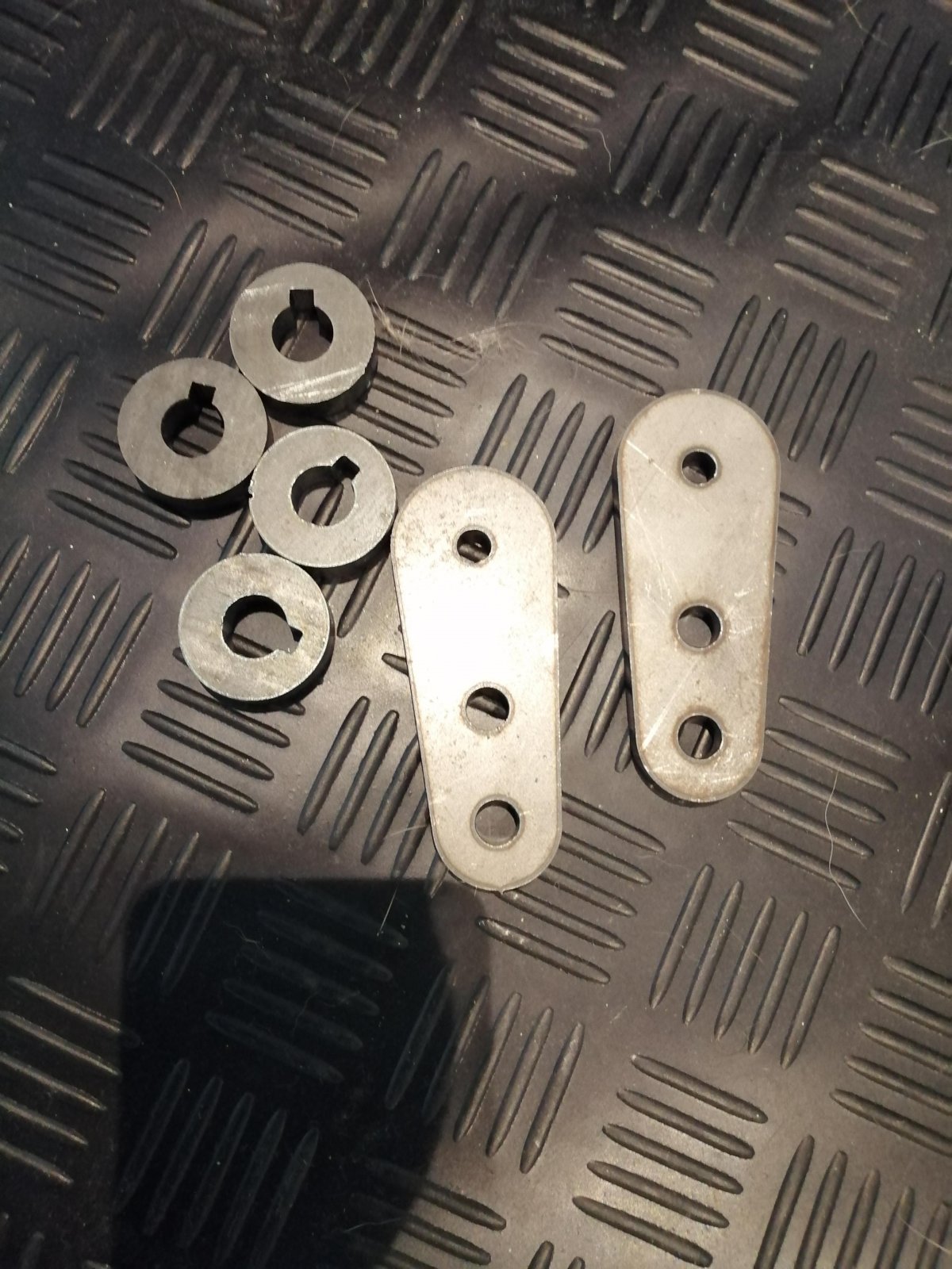

    I have my custom made shaft couplers already made and my 'engine' almost assembled. It is currently an i5 7th gen, 16Gb, GTX1080, 512 SSD + 6TB HDD. It is not ideal but it will be upgraded early next year.
    I will use the Ford Transit u-joint. It is way more robust.
    So...I have everything and now is just a matter of engineering the mount and assembly it all together.

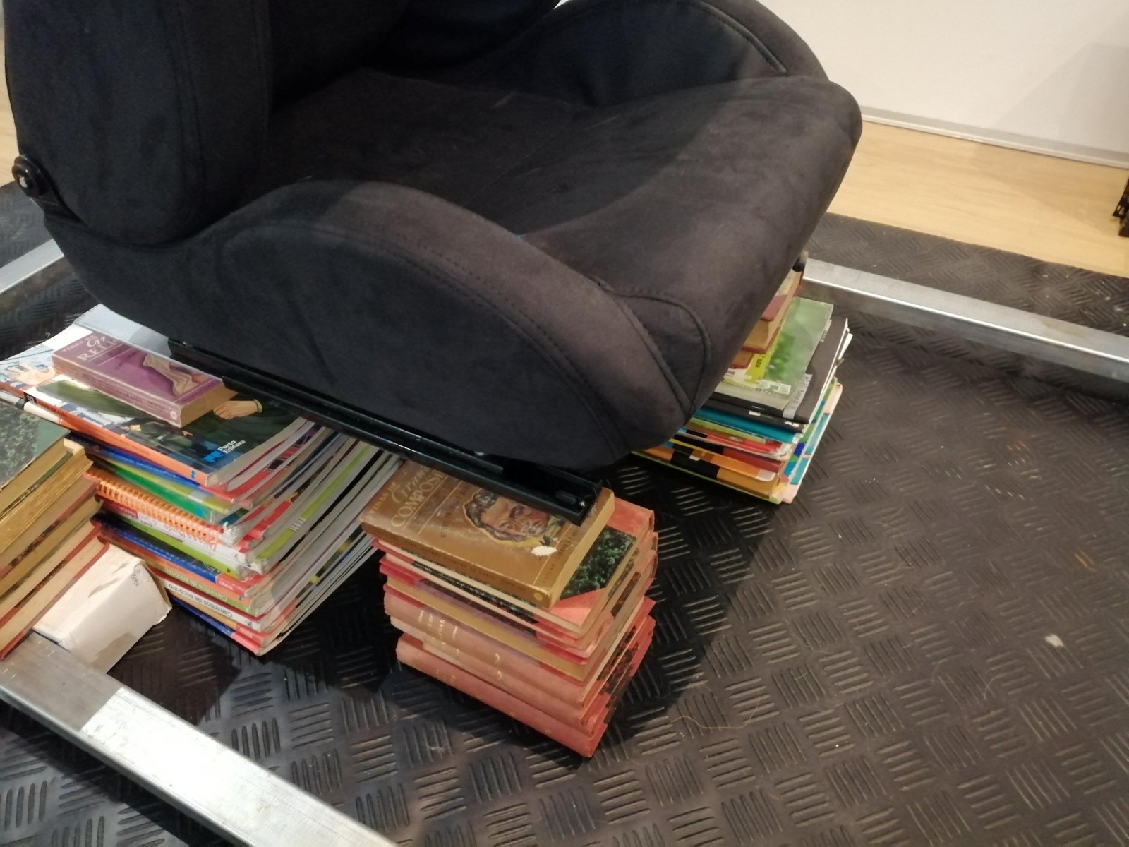

    I am currently measuring seat heights using books as you can see for the photo :)

    I remember that getting a good seating positioning is quite challenging. I measured everything upfront a 100 times, and still when the welding was finished it wasn't completely to my liking, the wheel was to high, and to close to the chest/body. So I had to cut some things reposition a bit and weld it together again, it's not ideal, but at least the positioning is "perfect" for me right now. So it's a trial and error process more or less, unless you get lucky I suppose and get everything the right way the first time.
    The only thing I don't like right now about my rig is that my Handbrake is quite far away to reach. Perhaps I have to get used to it. Well, it does the job, and to be honest I wouldn't really know where else to place the damn thing haha. One other thing I am not to sure about is my racing seat. Perhaps I have to get used to it, but I can't say it's that comfortable to sit in. It's also quite small, I barely fit in it, I'd say I fit just perfectly in it. But I am being a little bit picky about these things I guess.

    I bought a semi-racing seat because of that. It is a bit wider and more confortable than a regular one. It is not FIA approved or anything like that. It is just a racing seat mainly for sim racing. Even so...it still take some time to get used to.
