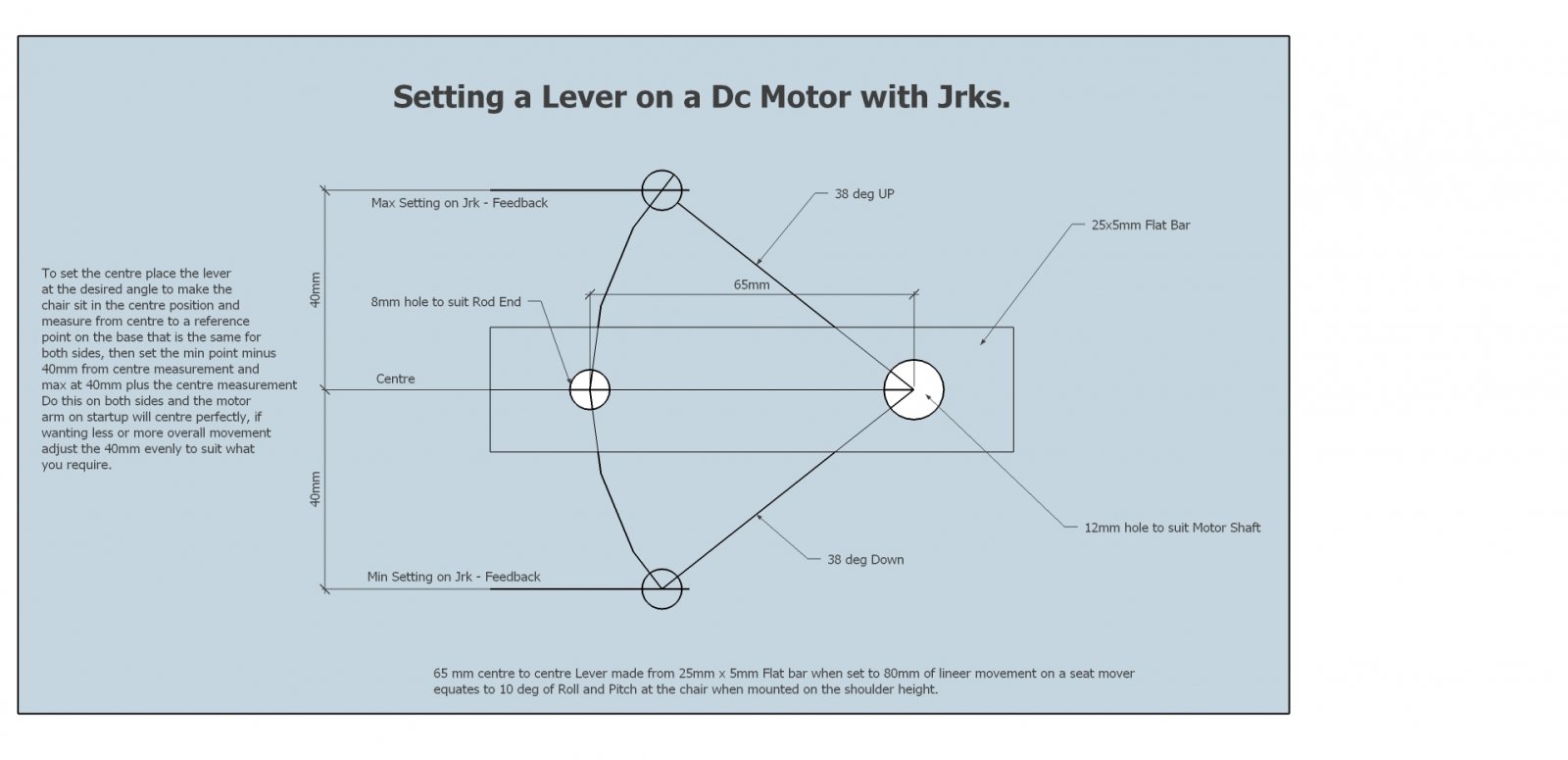

    Which do you recommend? Don't need a ton of movement, just want it fast and strong.[/QUOTE]
    Ok speaking from a seatmover perspective 65mm is tons of movement, I actually setup like the pic below.
    Im only using 76 deg of the movement and it can use this in about 0.1s, to go from top to bottom, a little too quick.
    But I recommend setting up on 50mm , and make sure you can extend your connecting rods too, so that you can test the others, and make a decision for your self.

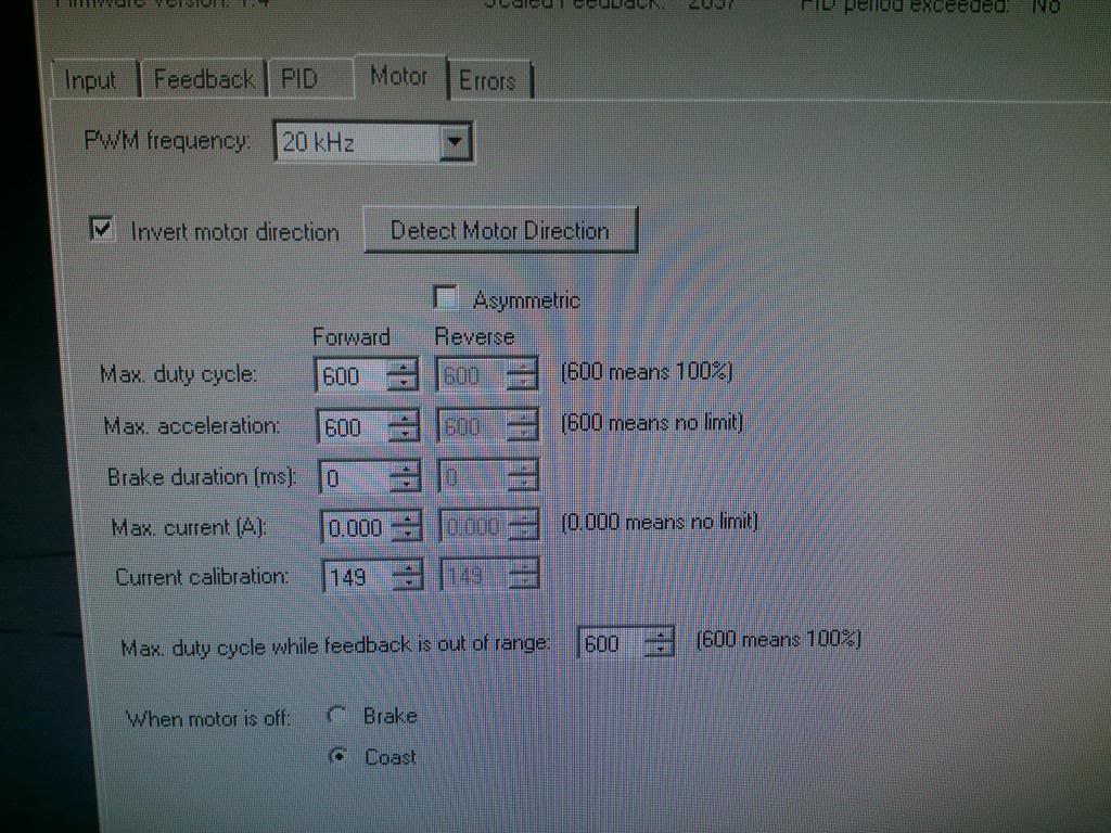

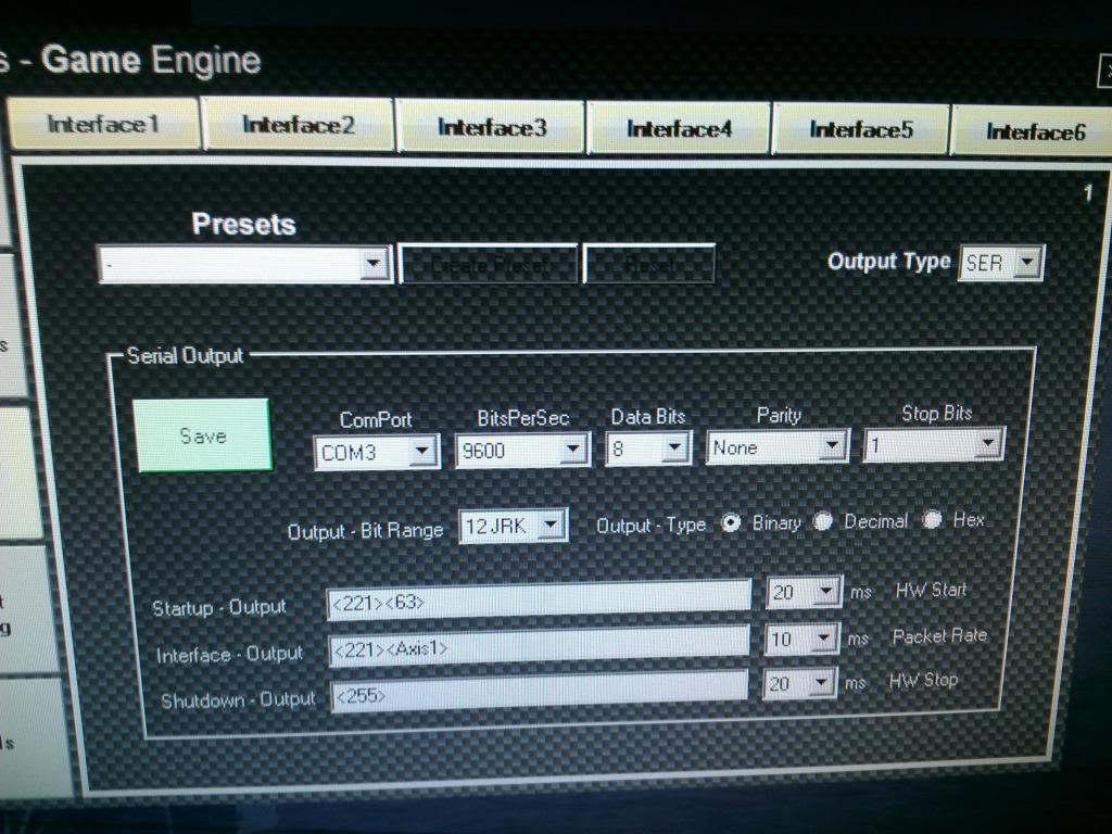

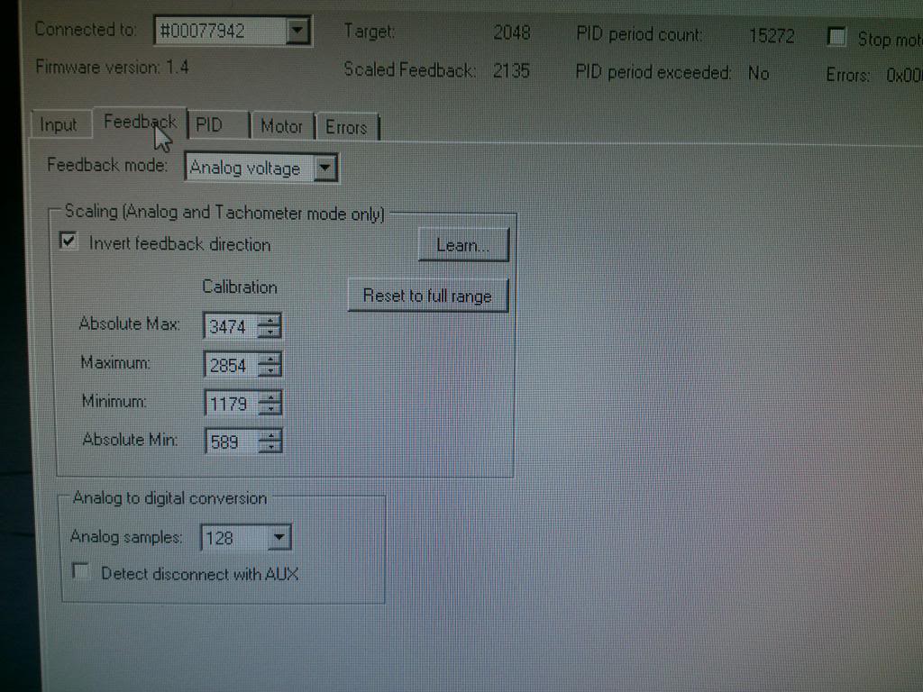

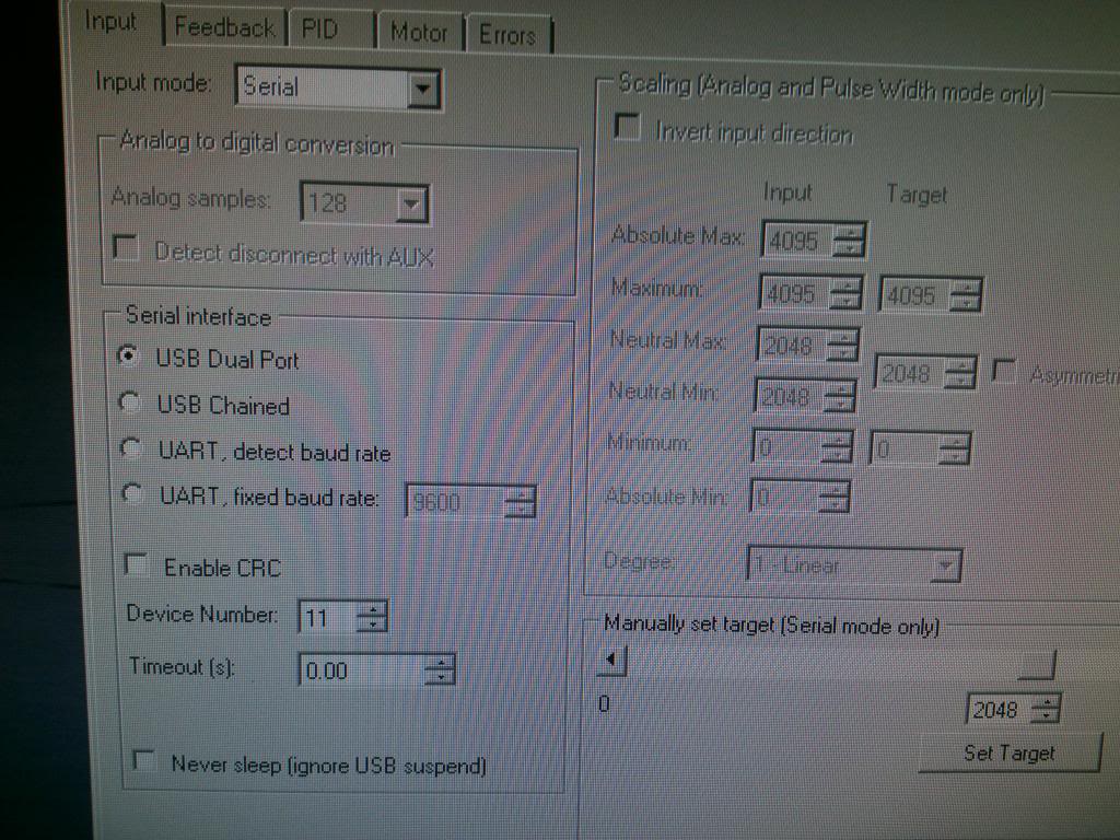

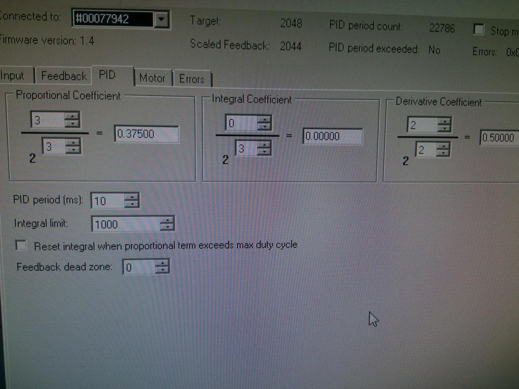

    I did notice when motors were working real hard like offroad or crashes I had a motor go down twice. Any ideas? I dont know if its a jrk setting, or maybe just overheating without the heatsinks on.
  10. bsft
    @jem45472 , could be a number of things,
    Yes, start with heatsinks and fans on JRK for sure, could be a spike and that fact they are running hot.
    Next thing to look at is motor settings and PID, also feedback settings. It could be spiking out on a error. Check the error tab of utility to see which is coming up.
    Come to think of it, what settings are you using? can you post pics of utility tabs?

    Dave, I will take pictures tomorrow dont have time today. I am also inclined to think its a feedback problem. Thanks.

    Here are my settings.

  18. bsft
    In utility
    PID period increase to 20 ms
    intergral limit to 5000
    analog samples to 512
    Game engine settings.
    HW start 10ms
    packet rate 20ms
    HW stop 10ms
    try that perhaps
