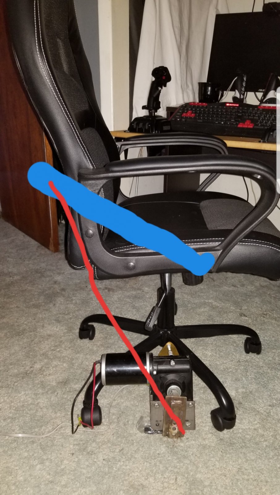

    Ok, so I really need to downsize this, and this is along the lines I'm thinking. The blue line would be a bracket connected to armrests which would give me a connection point in the back above the center of gravity. The red line is my connecting rod from motor. I see no reason why this wouldn't work, while keeping things nice and compact, but I'm also not the sharpest tool in the shed. What do you experts think?
  20. noorbeast
    22,209
    154,717Coins
    +11,212 / 57 / -2
    The most effective use of torque is when the rod, your red line, is at 90 degrees to the lever. For a compact design you want to maximise torque, as it is far more important than speed, so you want the greatest distance your compact footprint will allow from the pivot to where the rod joins the lever at 90 degrees. In other words flip the motor around and move it back as far as you are willing to go.
    Have a play with SimCalc to help get your head around the tradeoffs in design Vs physics: https://www.xsimulator.net/communit...e-linear-speed-and-forces-of-your-design.270/
