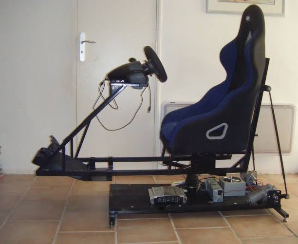

    I got you, thanks. The picture is not accurate, and I probably shouldn't have posted it like that. I was just trying to figure out first how to make an attachment that is above the bottom of the seat to avoid pushing and pulling from underneath if possible while keeping it as small a footprint as I can.

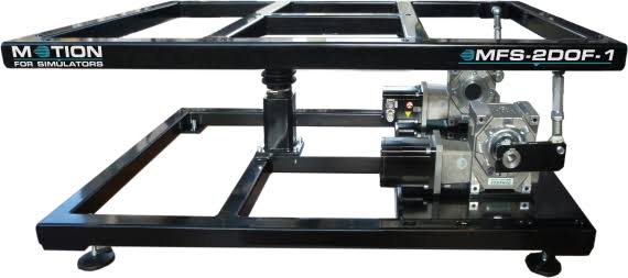

    Hi sir, what method the best for 2dof with wiper motor sir??
    a directly connected rig, or a separate 2Dof from the rig? as in the picture
    Note : image from google for example.

    Those are not wiper motors, either are the ones I am using. Most of the sims you see on here are using heavier duty gear motors. They look the same, but are much stronger. If you are planning on using normal wiper motors, I advise you to build like the picture I posted above to you, or copy what I started with in this build thread.

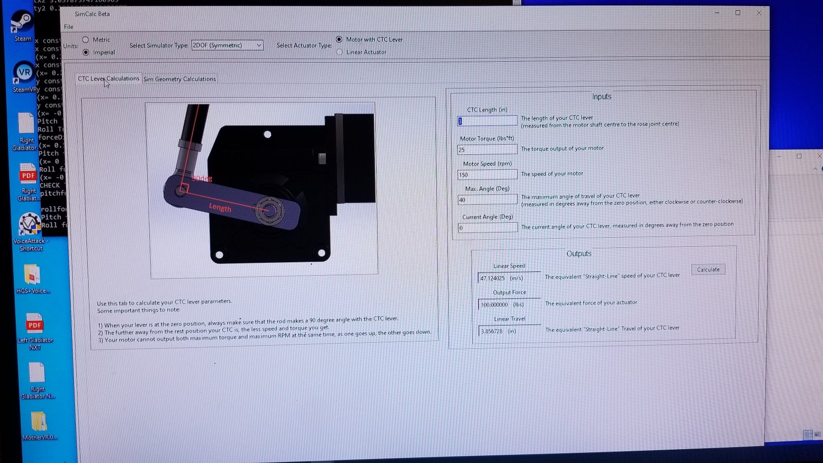

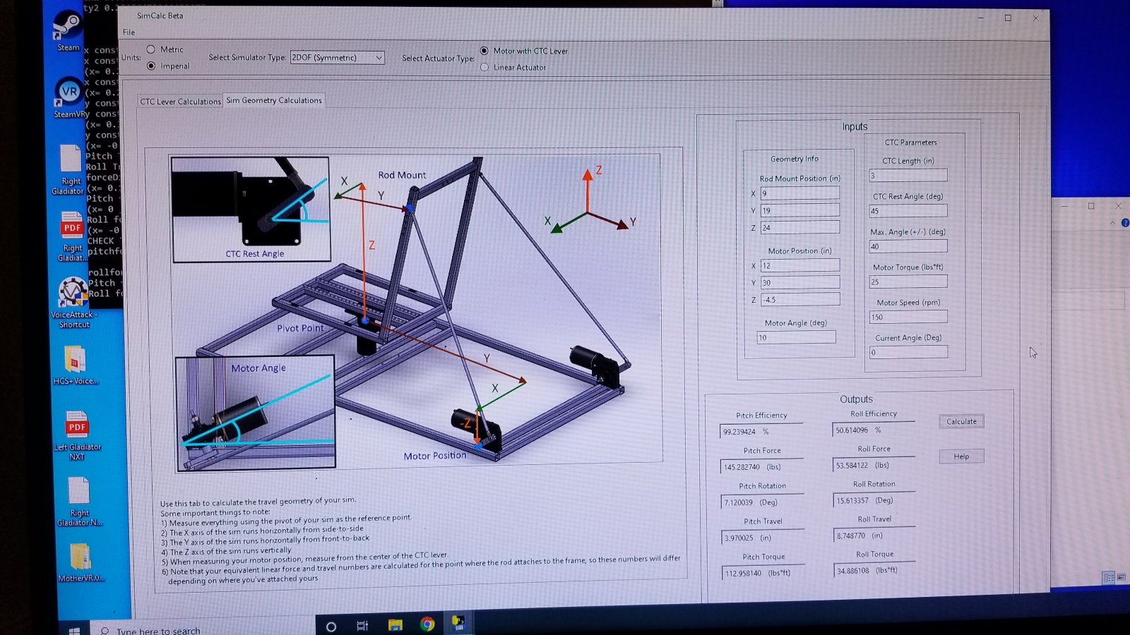

    I have the room to rebuild any way I want, but would preferably like a compact. I have messed with simcalc, but want some real world advice. My components are jrk1212's with 25:1 gearmotors. This is mainly going to be for elite dangerous, and some racing. My past setup was very fast and powerful with a typical shoulder mount design. Can my 25:1 drive the seat mover satisfactorily attached underneath the seat, or should I go up a little to past the leg height like yours. Or am I really better off with another shoulder mount design. If I could pull off the attachments under the seat at front or rear would be most compact, just don't know if it's best for the 25:1 motors, or if I'd be missing alot of the finer motion details going that way.

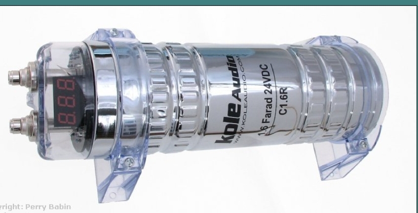

    Running an aggressive profile, sometimes my server psu would shut off. Would running a car audio 12v capacitor inline help my weaker psu's?

    The 25:1s can work in a compact design, even connecting under the seat, for average weight users, though you want as much inherent design leverage as possible, so maximise the distance between the pivot to the rod connection point on the levers. For heavier users or limited leverage 60:1s are a better choice.

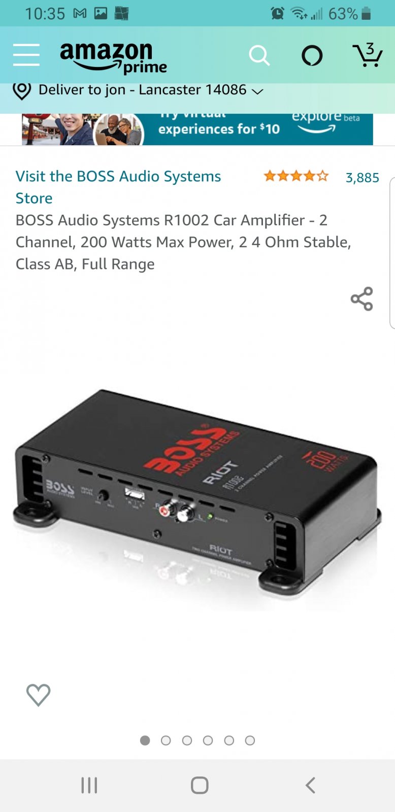

    And also ordered a new 200 watt amp for Gamevibe to power my bass shakers.

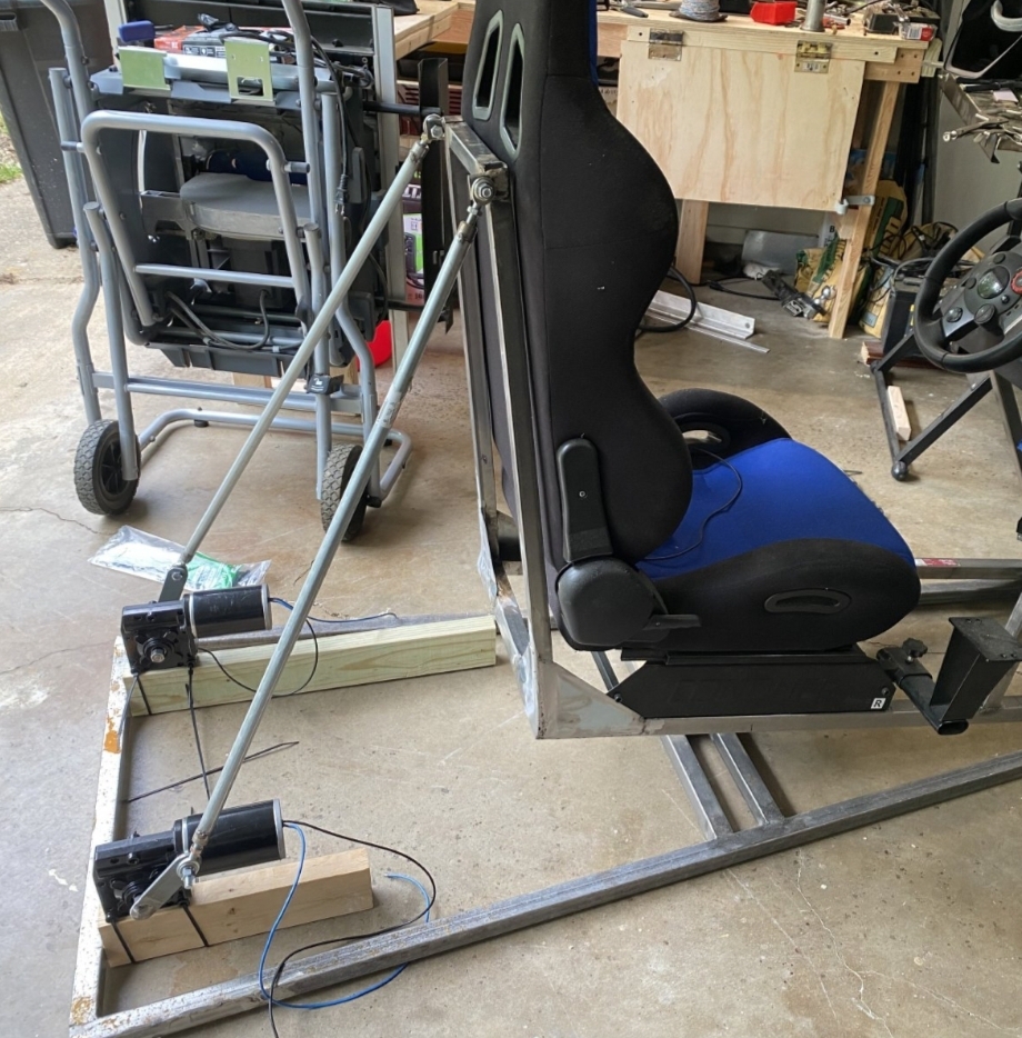

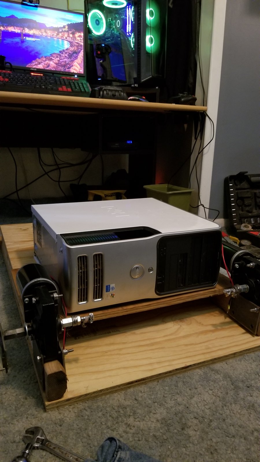

    Well, started laying things out a little today to get some ideas. Decided I want to run the PC at the sim. I'll run a USB extension and hub to desk for mouse and keyboard. That'll allow me to keep my chair mounted flight sticks, and the rest of the cabling nice, short, and neat.
    Because of this, it's not going to be as compact as I envisioned when I started the rebuild but I'm still coming in at 1066 x 610 mm. That's almost 1/4 the size of the original build.
    Since it's not quite the compact I planned on, I'm back to rear mounted motors, and shoulder mount. Not necessarily a bad thing, it'll allow me to take advantage of the speed of my 25:1 motors.
    A quick mock up until I figure the rest of the details.

    I'm a bit tired, these are my specs if I measured everything right.
