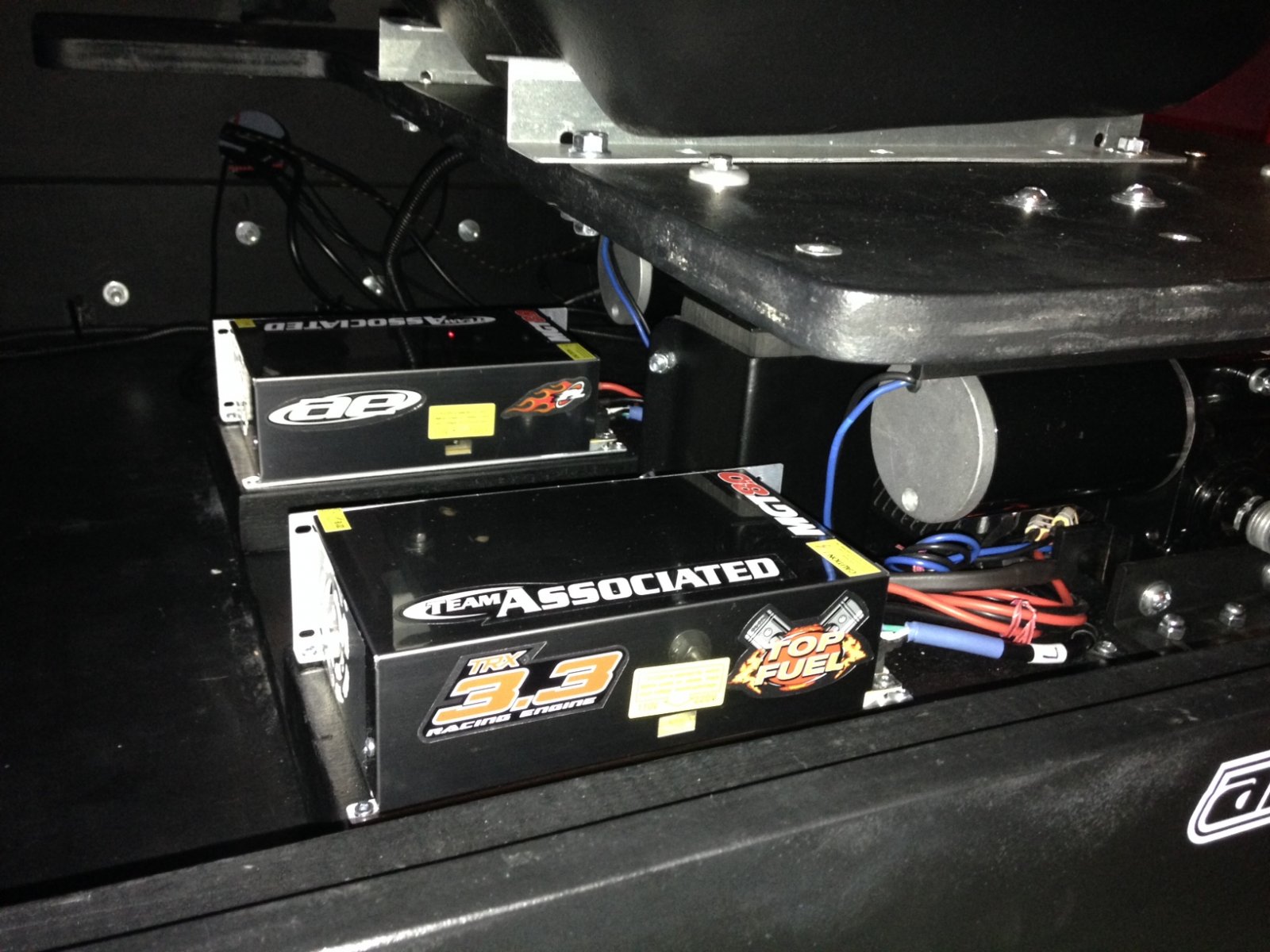

    Here's a pic of what I mean by having the power supplies mounted beneath the rig, with the fans blowing outwards in the forward direction of the pedals & my feet.
    There are two benefits to doing this.
    It does indeed keep my feet cool, plus more importantly I would be aware if there were any overheating or fan issues, especially when in VR as for the most part I'm blind to my surroundings.

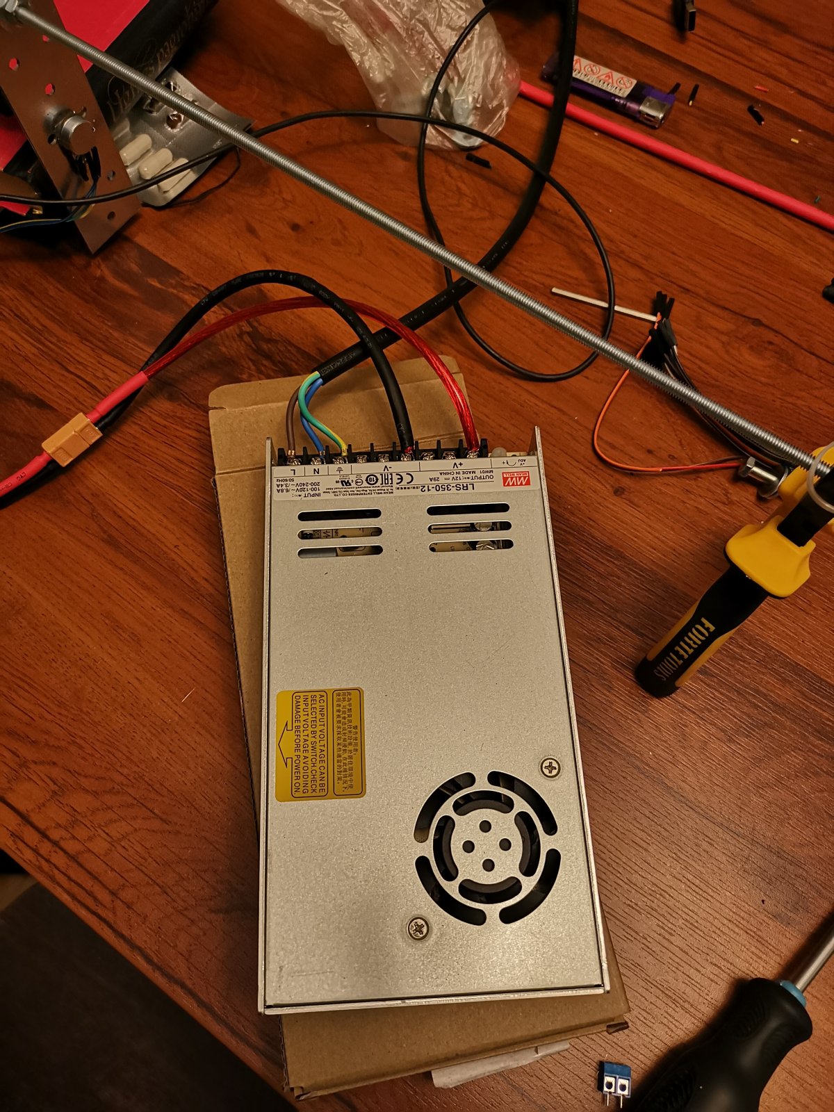

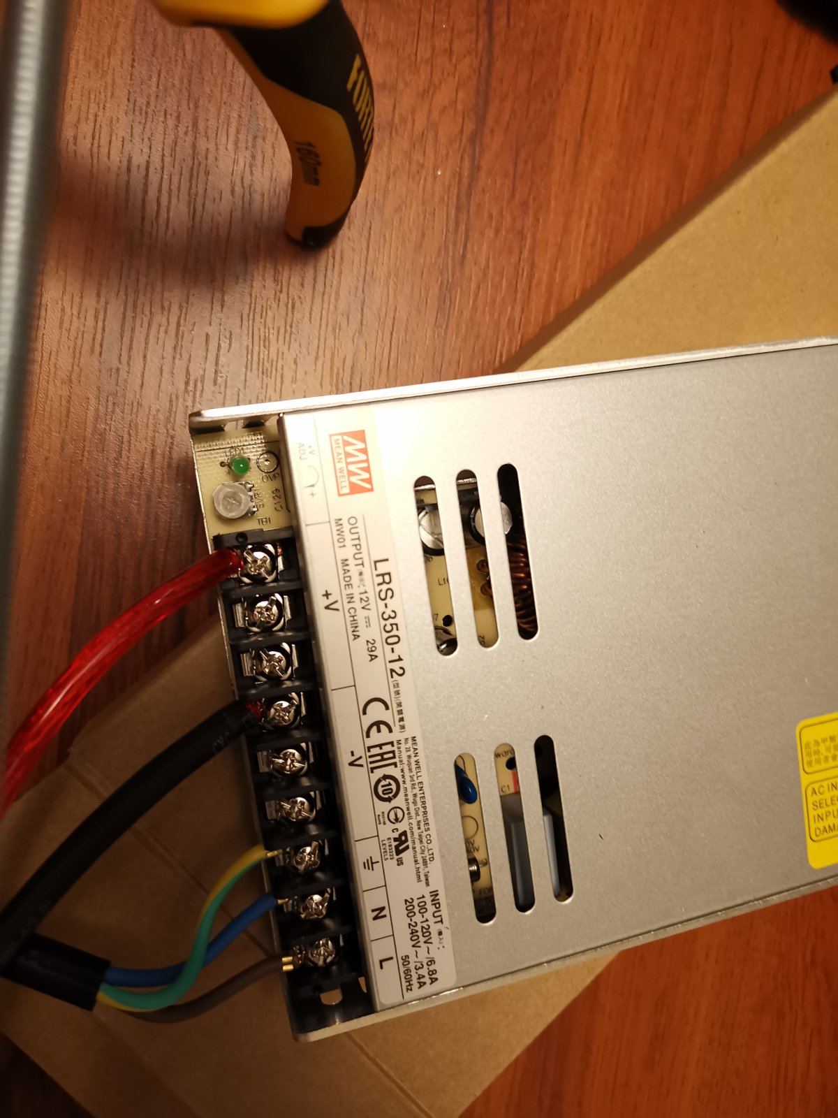

    Thanks for the reply! I went to the local electronics shop yesterday and bought some cheap 12V 29A LED power supply (that makes it around 350W). I was hoping it will be enough but seems that either its bad quality and it can't supply the current specified or something else is wrong.. I connected everything and I keep getting Motor Driver and No Power errors in JRK Config utility while the motor is stopping or changing direction quickly. Also, when that happens the voltage of power supply drops to almost zero.. I have a server PSU lying around, so will need to try that I guess.. Btw, if I check current in JRK config utility's graph, it never goes higher than 18-20A.. I am attaching the photos of power supply I got.

    Are you only using a single power supply for both JRK's???
    If so, then there's a pretty good chance that's your issue right there.
    29A & 350w seems a bit low for what's required of a seat mover, but I could be wrong.
    As stated earlier, I probably went overboard with the power supplies which I've chosen, but (knock on wood) the dual 12v/40A/500watt system hasn't failed me yet, nor does it seem to even break a sweat with prolonged gaming sessions.
    Better safe than sorry, and I feel more comfortable with each motor + JRK having it's own power supply to draw from, especially when each JRK/Motor is doing a different motion at any given moment.
    I only see a single pair of JRK power connectors (+/-) to that power supply though, so are you only testing with one JRK and still experiencing those issues???
    I think that when a motion platform is requested to change direction quickly and in a hard manner (especially under load), that it creates a brief voltage/amperage spike and current draw.
    From what I recall it could be up to around 30A's or so.
    I'm not sure how that also affects your voltage dropping to zero, but it may be some form of built-in protection or just what happens when the requested amperage needs cannot be met by the power supply.
    I hope that you figure it out, and a higher rated power supply(s) may be your easiest and simplest answer.
    Since you have a pair of them on hand, perhaps try one per JRK/Motor and see if that helps.

    I only have one motor and one JRK currently and I was the motor without any load appart from the pot.. I was thinking, maybe 12v 29A is cobined output of 3 ports in the power supply? Maybe one output pair can only deliver part of that. Do you think its possible?

    I had the same problem with meanwell PSU and JRK G2's. I contacted Pololu and was told to add either 12v batteries or shunt regulator in between PSU and JRK's. I purchased shunt regulators at pololu and solved my problems. I didnt want to go batteries because it looks messy and i wanted to keep it compact. Shunt regulators are pretty cheap too. IIRC it was <$10.00 USD a piece.
