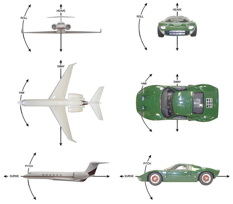

    Can anybody please tell me a way to get Roll & Pitch values?

    Unfortunately I could not find in the game's memory pitch and roll values. I think it's because this game is not "car simulator".

    The game is all about speed and drifting like in F1 simulators ...
    So, The best design for it is only a surge , sway , yaw platform .
    like this ...
