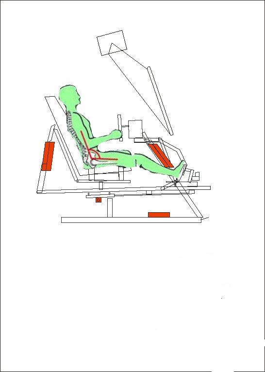

  8. bberger
    bberger Member
    Aug 21, 2010
    85
    306Coins
    +37 / 0 / -0
    Despite my girlfriend it's amongst the most beautiful things I've ever seen, really, really nice construction you've built there!
    The only thing that I'm still trying to understand is: wich axis exactly do you move? You've got the 2 SCN's on the back (as in any casual 2DOF sim), but where or the other ones and what's their purpose?
    I'd love to see a small sketch :)
    Abgesehen von meiner Freundin gehört das wohl zu den schönsten Dingen die ich jemals gesehen habe, wirklich wirklich nette Konstruktion hast Du dir da gebaut!
    Die einzige Sache die ich immer noch versuche zu verstheen ist folgende: welche Achsen bewegst du nun genau? Du hast die 2 SCN's hinten (so wie in jeder üblichen 2DOF sim), aber wo sind die anderen und welchen Zweck erfüllen diese?
    Würde mich über eine kleine Skizze freuen :)

    hi bberger,
    the design is for 6 dof but i work only with 4 in the moment.2 for the raceseat design backsite,2 for a joyrider design in the front.and for the next time one for go for and behind with the sim and one for drift.the scn5 are red in this paint

    Hi Nima
    It´s looking great ,but ther is only movement on 4 axis
    with an other design you could have 5 axis movement, with frond and rear wheel loss only missing heave.
