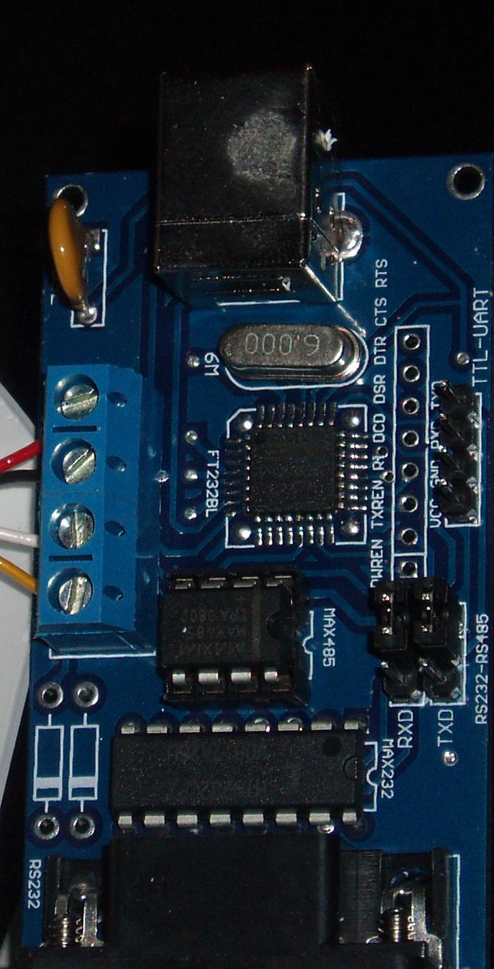

    When I press the START button on the profiler. I can here a little noise in the actuators. Like a click.
    Then when I press play game in the force sender. Rfactor starts up.
    When I start driving the actuators do not move. They just stay in middle position :(
    The only thing I have not done from the original diagrams is I have not placed a resistor from A to B in the rs485 USB adaptors.
    Surely something like this can not cause NO action :)
    This situation is like a pregnant woman. Waiting so long for birth but it is not happning. But when it does it will be joyfull. lol. feel so close to getting it working.

    Something does not seem right. In caliberation section of force profiler. The actuators do not even caliberate. It is as if there is no signal going through the usb to the rs485 adaptor and into the actuators. Yet they power up when profiler starts.
    My pc is relitavley brand new. I bought it for the sim project so ever USB (it has 6 usb ports) is working fine. Maybe I need to take picture of jumper setting on the adaptor and show you guys.

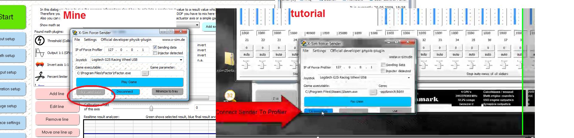

    I load up force sender and load the test plugin. Big box of sliders came up. I pressed auto slider and all little bars went up and down. But scn5 actuators did not move.
    I have made picture of the adaptors. I did switch the jumper set to rs485 mode. There were two little jumpers. (clips)
    Could be adaptor issue. I'm using two adaptors usb. So both cannot be broke.
    Time really flys quick also when your NOT having fun :( hehe prob8.jpg

    Dear raceray,
    I followed tutorial, which is a great one. I failed at 2.23 seconds into the video.
    The problem is I cannot press send data again. As it is already connected to profiler. In this video send data was press once early on, and then after a few stages, bvillersjr presses it again at 2.23 and then the actuators move. This is what I want mine to do :)
    Please see photo. Everything into tutorial went fine until 2minutes23 seconds.
  16. Fahim
    Fahim Member
    Dec 11, 2008
    477
    553Coins
    Sorry I am wrong. It was not pressed early on. I will start tutorial again. Cheers.
    Right, I have gone through the tutotial again. And again at 2 minutes and 23 seconds. I fail. When I press SEND data The actuators do not move. In the video they go down and then back to normal position at 2minutes and 23 seconds. :(
    Not on mine. They just stay in middle position :( . The test plugin was selected and values on test bars were 40,000 & 25,000 as per tutorial.

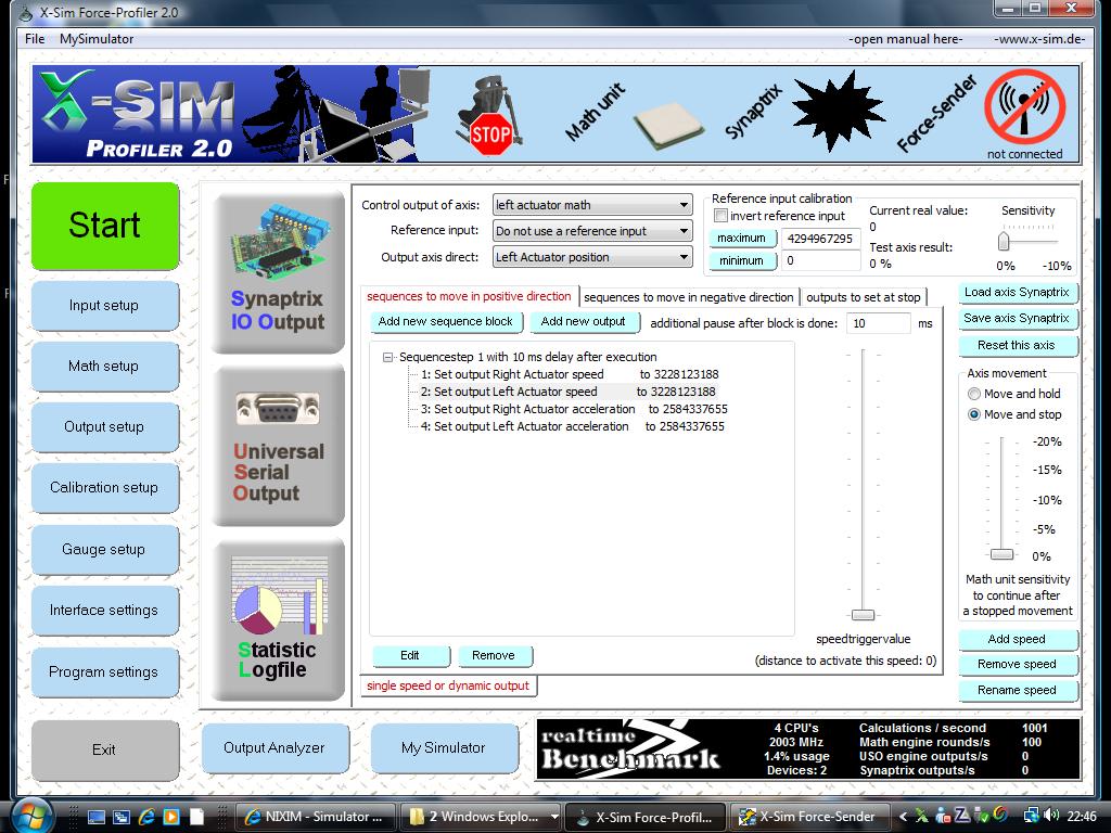

    Okay guys. Now I have atleast RESULT.
    At 2.23 time of the video. I decided to press START on the profiler. And then when I went back to the TEST BARS. I moved them and the actuators did move.
    So I have done something different to the tutorial at this moment. I had to press start myself.
    Now I need to get them to move in a game :)

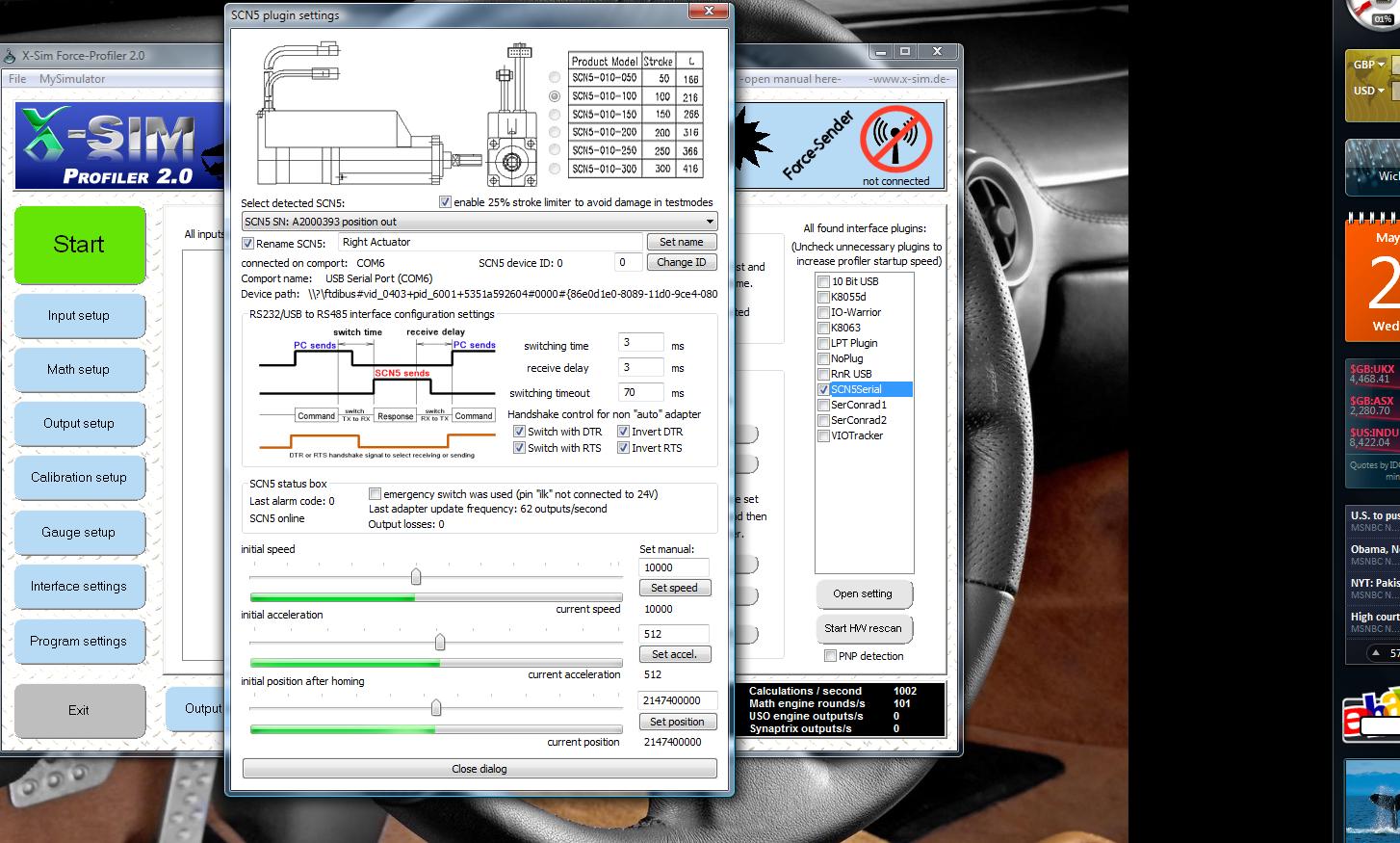

  18. Fahim
    Fahim Member
    Dec 11, 2008
    477
    553Coins
    I have had no luck what so ever getting my actuators to work with RFactor. Although they do work in the testplugin (testbar sliders)
    I think I need to give up and try Live for Speed. I will make a request for LFS profile with 25% limiter in the appropriate thread.
    Then maybe I can get some sort of result.
    I am running on vista. I followed bvillersjr tutorial from youtube on how to vista.
    But I did not so sirnoname tutorial when you have to do command promt and do the adminstrator thing. ;P

    If my actuators work in testplugin mode by moving sliders. Does this mean my adaptors are perfectly okay? I just cannot get them to work in the games.

    Yes, if they move with the testplugin, they are setted up ok.
    I assume you have messed up with the rFactor plugin dll file. Sure that you have placed the correct file in the rfactor plugins directory?
    Btw, rFactor just outputs data if you are in your own car in cockpit mode...
    Spectator mode does not work...
    When you have loaded a rfactor profile and driving in cockpit mode with hardware plugins enabled, do you see changing values in the Profiler input setup then?
