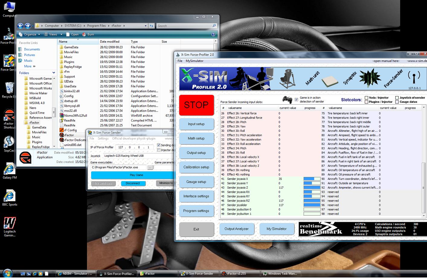

    I took rfactorplugin from x-sim plugin folder and put it in c:/programs/Rfactor/plugin folder.
    Then when starting force sender I just choose the rfactorplugin when that menu drops down.
    This is results when playing the game. The G button is always enabled. Maybe a re-install of x-sim might do the trick. When I installed it I THINK I chose not to install yoda program and injector. prob11.jpg

    sorry, typo...
    Use this dll...
    C:\Programme\X-Sim\other stuff\rFactor
    regards

    Hi, It is working now. Thanks :)
