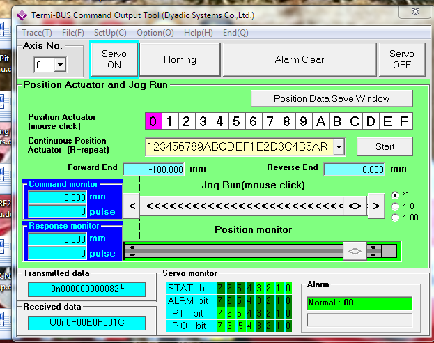

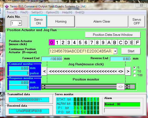

    Well, the saga continues. The third SCN5 arrived. Tried to test using TBVST from Dyadic and got the error: "Failed opening communication port". I requested a return ora repaired unit today.
    Tested the other two SCN5's using the same tool and when you click on "Homing", the actuators retract (See screen captures). It seems then that there is communication from the computer to the actuators, and that they are functional.
    I made a little circuit for one actuator, copying meticulously the wiring schematic, and tested the three actuators one at a time. TBVST detected and homed my older actuators, but not the third one.
    Reconnected to the control box, performed the TBVST test again, and it worked for the older ones, third still dead.
    Reinstalled SimTools,, exempted port 4123 in Windows firewall, patched Assetto Corsa, followed Quick Start, default profile, SimForce GT preset, configured axis 1 and 2 as per recommendations and when I try to move the actuators using Output Testing, there is nothing. No movement at all. The USB conerters (Devantech) do not show any blinking lights, as they do when I test with TBVST. Started Assetto Corsa, Game Manager shows it running, but not movement at all.
    I believe I am making a consistent error in setting SimTools, but for the life of me, I can't find what I am missing.
    I do not believe it is an actuator issue, since I can detect both and home them using TBVST.
    Here are screen shots of the TBVST output, for left and right actuators.
    I also ran a "Continuos Position Actuaator" test, actuators move repeatedly through the full stroke. The movement is smooth and they are very quiet. I have had these actuators for about two years, and only now I tested them. The shafts show no sign of wear. I am leaving for a trip abroad this Thursday and will return on October 31. I will then attack the assembly of the simulator, after the problem with the actuators is solved.

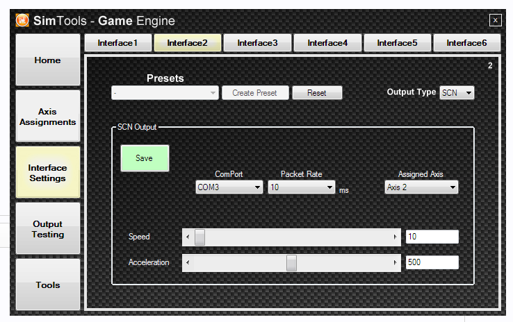

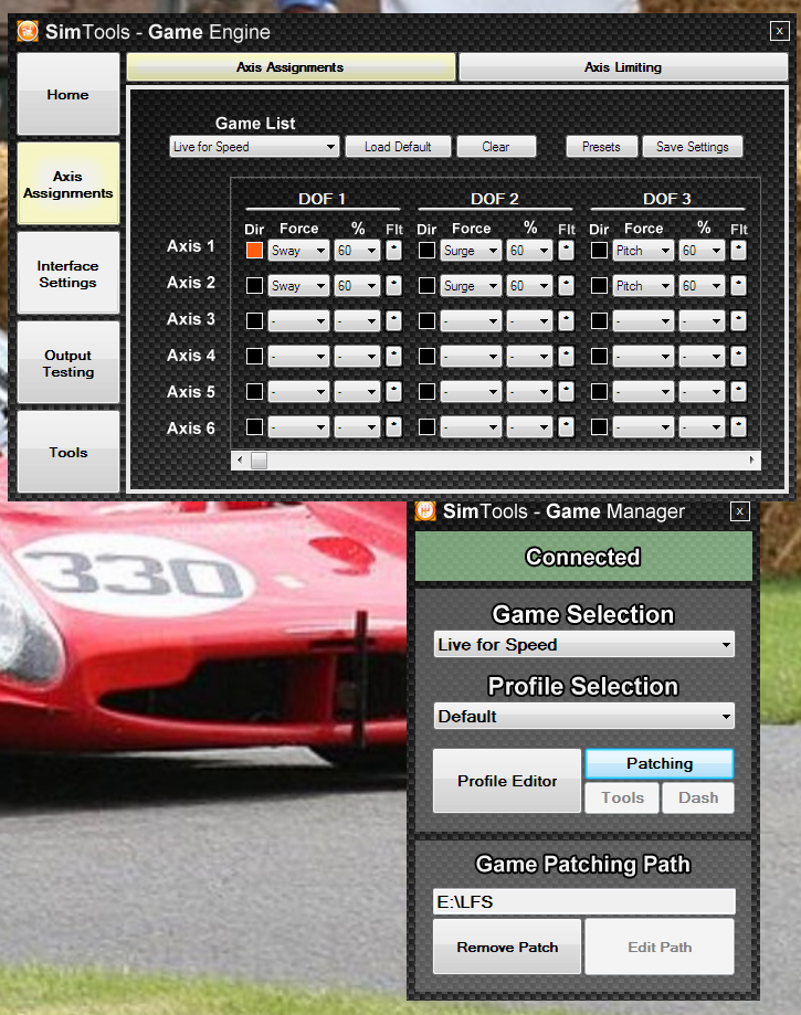

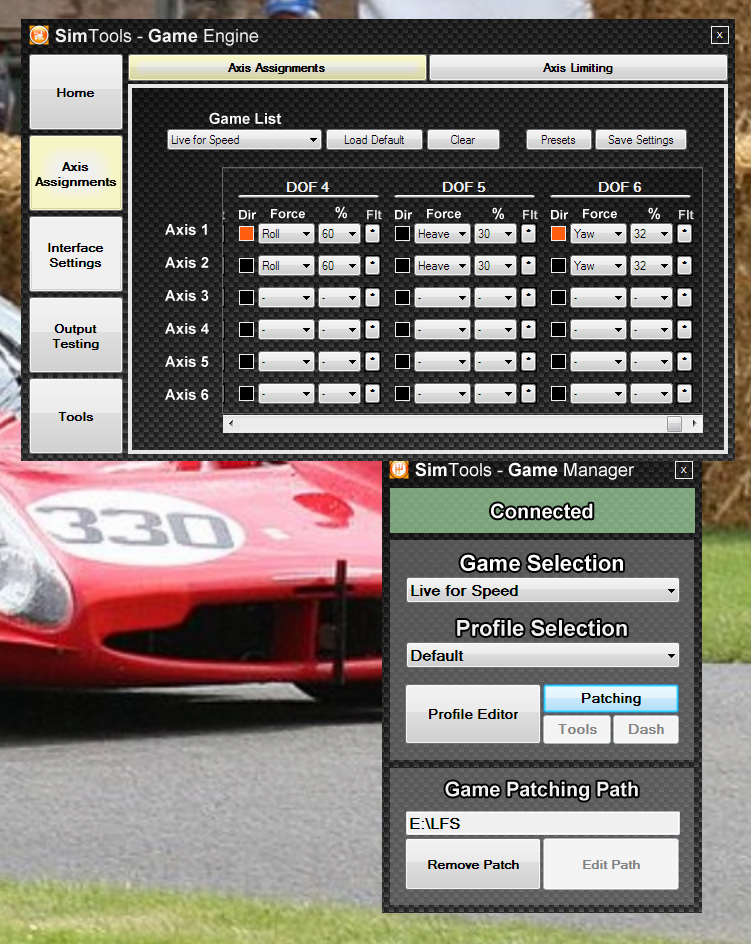

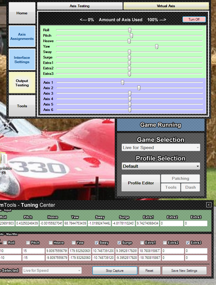

    I have here the screen captures for Game Engine and Game Manager. I have a question that might help sort out the problems. If I set the axis using the default setting, and use the Simforce Gt preset, set the interfaces, and without patching LFS, turn on Game Manager, would I be able to test the actuators using Output testing? If this is possible, and I can expect movement, then my deduction would point to a wiring problem.
    As soon as I start Game Engine, with the SCN5'5 powered up, the actuators go through the centering routine, but no response to Output testing. The SCN5'5 operate nprmally, without any alarm codes when tested using Dyadic TBVST, also checked that ID =0
    With LFS running, I see activity in Virtual Axis, and the leds in the Devantechs are flickering.
    "Another question: in the forum, answering a question about lack of movement there was this post:
    Check the Axis Assignments for each game in GameEngine.
    If you fill out the default profile in Axis Assignments, all newly installed game plugins will have these settings as the default.
    "If you installed the plugins before setting up a default axis assignment, then the new games have no axis assignments at all. And therefore you have no motion.
    What type of simulator do you have?
    yobuddy "
    When I patch LFS, is the plugin for LFS built in? Or I have to download it?
    So the order would be, fill out the default profile in Axis Assignment, set the interfaces, patch LFS after loading the profile for LFS, if not built in. Is this the proper way to do it?
    If you follow the quick guide, the profile is loaded first, then patch, set axis assignment and then the interfaces.

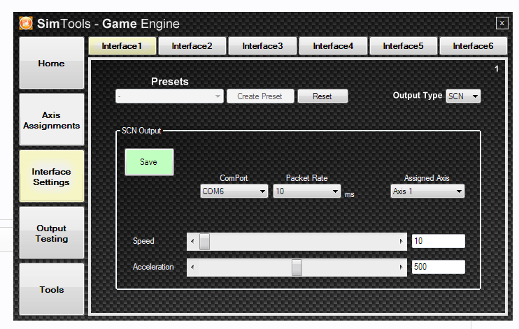

    ok right goto your axis assignments.
    dof1 - axis 1 - squre box black - sway - 60% ........ dof2 - axis 1 - square box orange - surge- 60%.
    dof2 - axis 2 - square box orange - sway - 60% ........ dof 2 - axis 2 square box orange - surge - 60%.
    blank all the others out for now as you are not using them.
    also the orange boxes ,ight be wrong but will just bee the direction when you move ok you can alter this later lets get it moving to something.
    then goto interface and set your speed to 10000 - acceleration 500 on both interface 1 and 2.
    let me know what happens then ok.

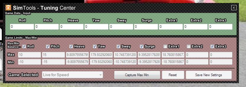

    now if you goto your game engine and right click the tab you will see tunning.
    open that and select the game live for speed in the tab and see what info you have in there when you select it ok.

    Hello f1iceman,
    Here is the screen capture of LFS, default profile, with the recommended settings.
    I believe I shouldn't have wiring problems, since the actuators operate without alarm in TBVST, and go through the centering routine when Game Engine is turned on. What baffles me is the fact that I can't actuate the SCN5's through Output Testing. It is seems that commands issued though Output Testing or the gane itself are not sent to the actuators, or if sent, are in very attenuated form.
