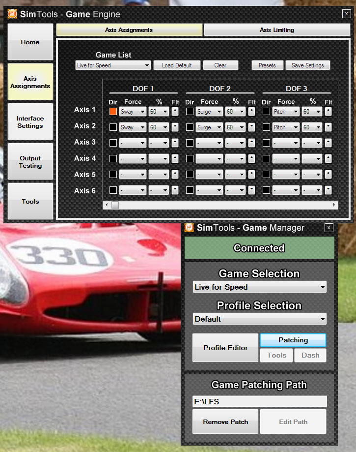

    just set up to sway and surge for your sim get all that setup and goto each step from there ok.
    you defo don't have wire problem if when you launch the simtools it moves and calibrates the scn5 and seat so its ready.
    set it to just the sway and surge and then shut down and restart it and see if it calibrates again on just those two.

    just a note you have to shut down simtools and restart it if you change the speed and acceleration settings ok.

    I really think tho you only need to change the speed settings looking at all the pics again but you don,t need the info for any more than sway n surge if that's what you run ok, keep it simple and easy to track then, change that speed only and see if that does the trick ok.

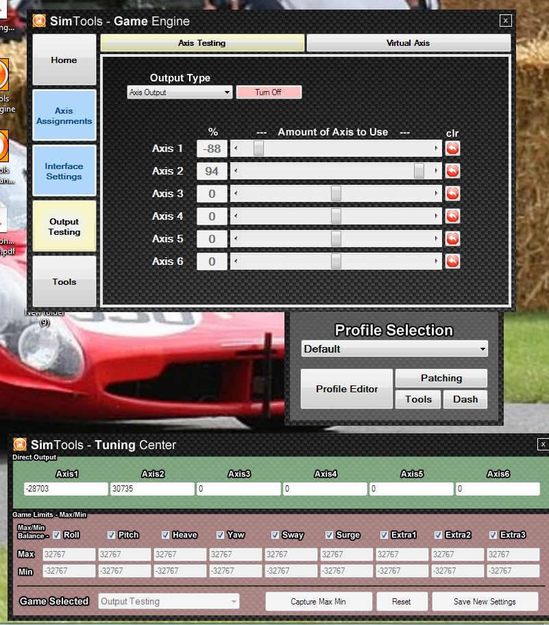

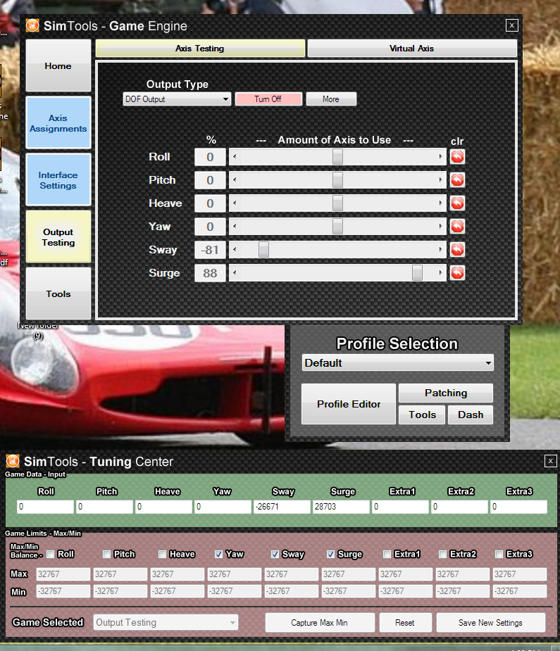

    Hi f1iceman,
    I lowered the speed in sway and surhe to 4 and 5, still no reaction.
    Did another test with just Game Engine, Game Manager and Tuning Center on, and used Output Testing in both modes.
    As you can see, there numbers change in the green boxes for sway and surge in DOF output, and for axis output.
    What is really puzzling me is that it seems the game is sending signal to the actuators, and also Output Testing does the same, but I have no movement.
    I am going to try to import a working preset for SCN5, and see if I can get over this problem.
    I have tried to set high and low values for the tuning center with no results. Thanks for your willingness to help.

    have you changed your speed setting in the interface section of the game engine ?
  7. f1iceman
    Aug 29, 2015
    848
    UK
    - 87Coins
    +396 / 2 / -0
    it will not work with it as low as you have it its at 10 and needs to be at 10000 for base setting.
    remebr interface 1 and 2 speed needs changing here.
    change and shut simtools down it will say then reboot and try your game again.

  9. Hmaia
    Hmaia Member
    Dec 24, 2012
    51
    Engineer
    Portland, OR
    138Coins
    +24 / 1 / -0
    3DOF, SCN5
    Thank you so much!!! That did it, I have movement!!!!
    Now I can play with the game engine and the tuning center.
    That value was caused by a misunderstanding in a previous post by norbeast. We dumb Americans use 10,000 (comma) for ten thousands, instead of 10.000 (dot). 10.000 to us means 10. Problem solved. Have a great weekend.
