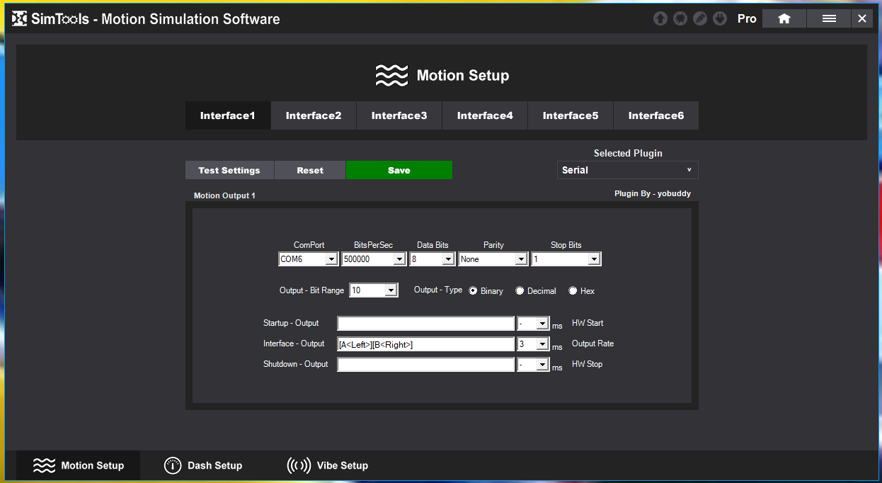

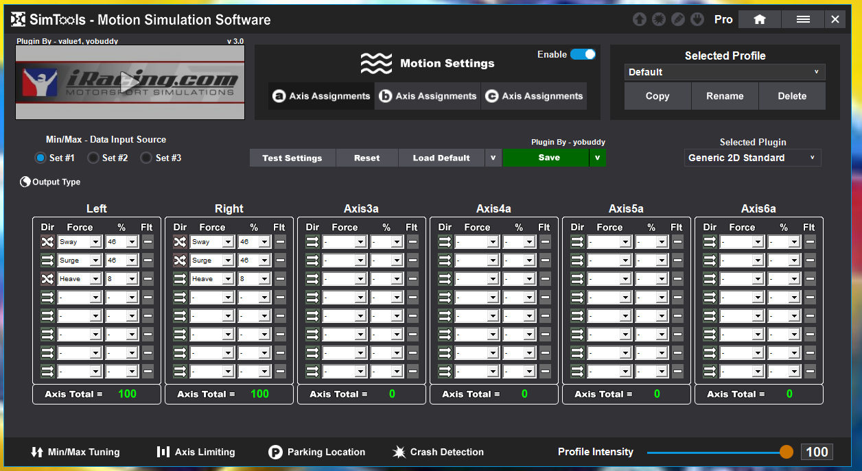

    I have a Njmotion compact R which works perfectly with ACC but not with other games, mainly Iracing...
    I installed the plugins via simtools, I configured all axis correctly, the tests are good, but when I launch Iracing, I have no movement... I'm not very good at all these settings... Someone to help me please?

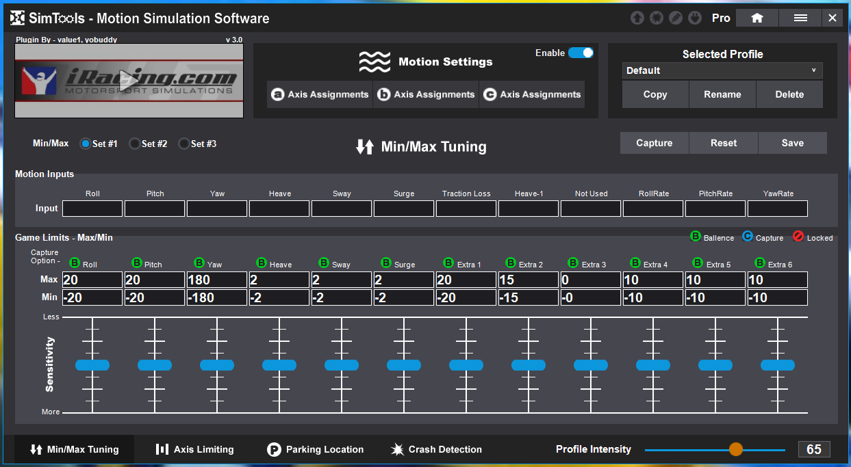

    Can you please post pictures of all of your settings, including the Tuning Center.

    You likely need to capture the Tuning Center Max/Min settings and then tweak them from there.

    What is the tuning center ?
    This you mean ?

    Yes.
    You should have data in the Input row when iRacing is running.
    If so use the Capture button, drive around at about 80% norml pace and avoid hitting anything, Save that then test.
