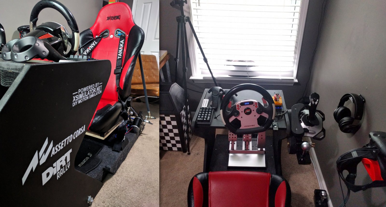

    After some final fit and finish work, I'm calling the build DONE!
    Since it's the centerpiece of the mancave renovation, this means the mancave is done too; Time to show off!
    It can be slid under my desk and used without VR, here's my wife giving Dirt Rally a go with that setup:

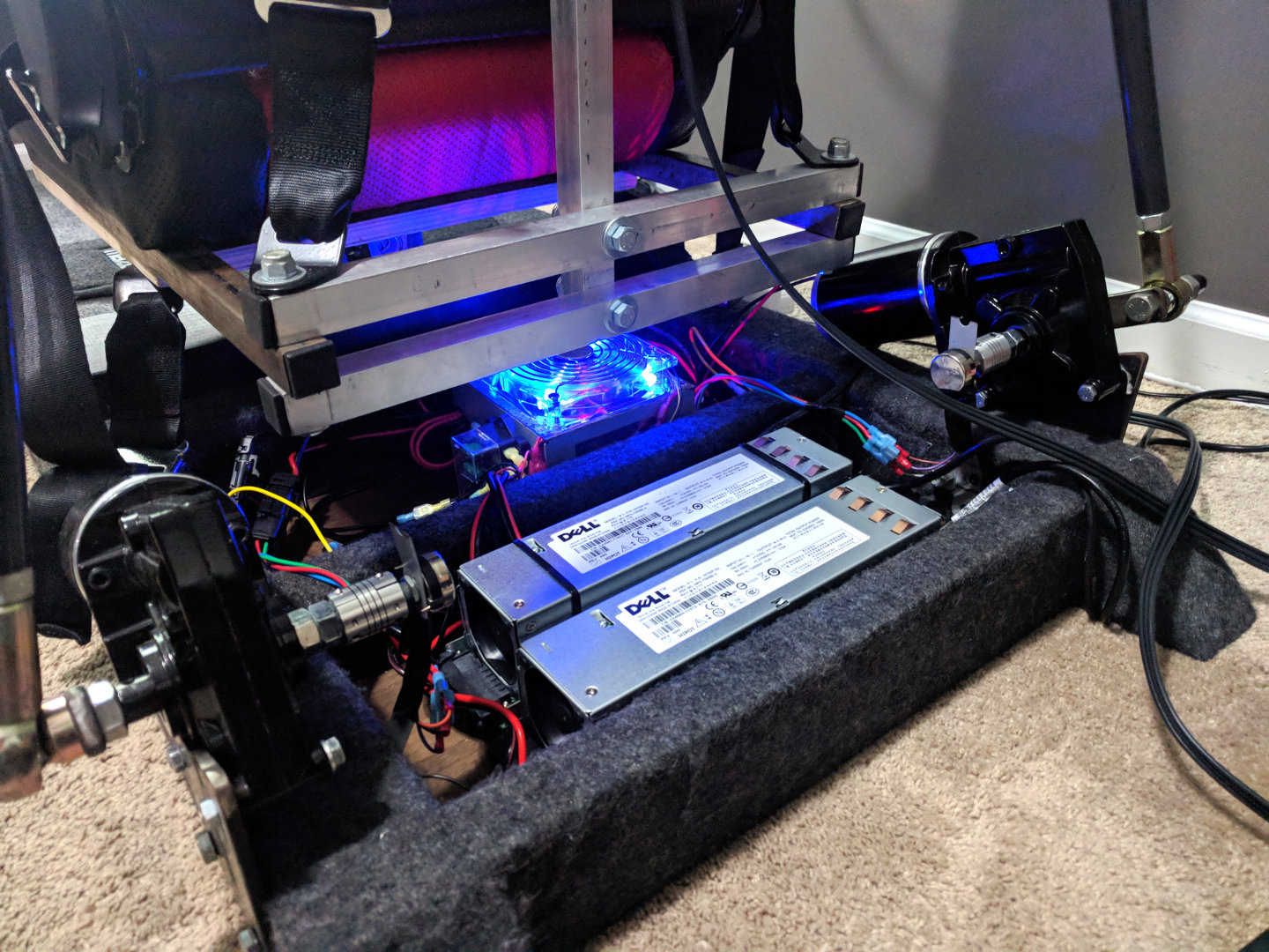

    The controllers came in from ebay seller satisfyelectronics and they worked perfectly! These are the first ones I've had that actually work 100%, they are around the $5 price point shipped from China.
    I wired them up as half-bridge following Pit's guide and they feel great! They seem to require less pwm to have the same intensity of movement and seem to overshoot+recover less than with the single driver per motor. I'm leaving everything configured the same as before to do some shakedown runs and then I'll work on dialing in the SMC3 tune for this change.
    Full disclosure, it was late at night and I was tired doing the wiring and accidentally plugged the 12v input to one of the controllers inverted which made my arduino let out the magic smoke as soon as I powered the chair on. It ended up being just the 5v regulator which sacrificed itself to save my USB port. Everything still works fine because this chip isn't needed when the arduino is being powered using usb, so I really lucked out with the damage there since I don't plan to use this board for anything except this chair using USB input.

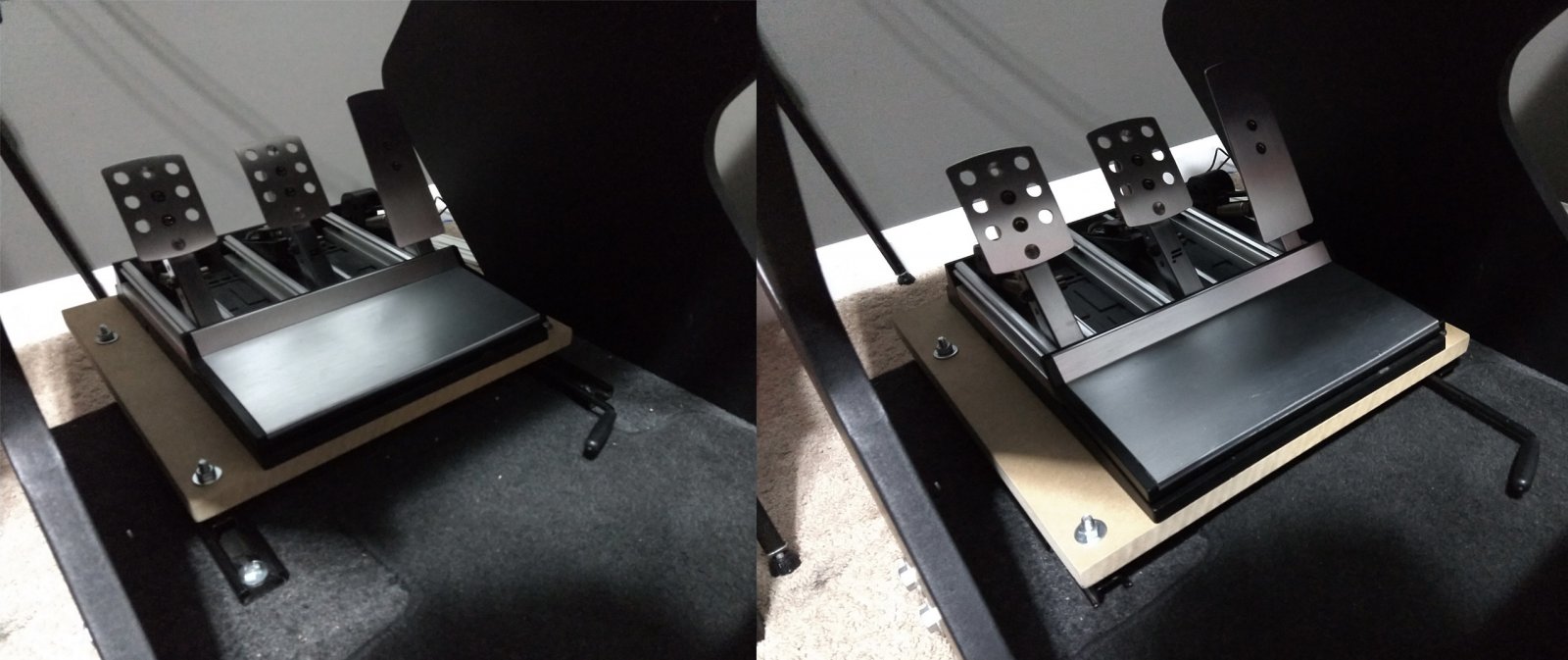

    I used the seat slider rails I took off of the seat to make a platform for the pedals mostly so it's not quite so cramped for my taller friends to use when they come over but also so my wife (shorter) can reach the pedals, really happy how this turned out:

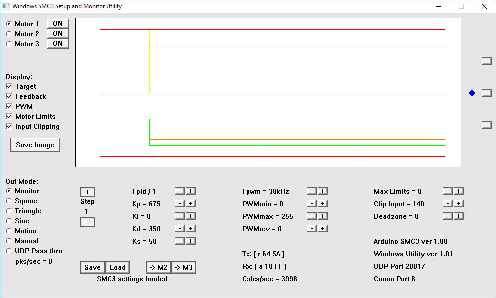

    @armpit, if you're still active here could I trouble you to share your final settings in the SMC3 utility and where you ended up as a 'default' with SimTools axis assignments? I'm kind of at a loss as to where to start with tuning them, since this is my first sim and I'm not sure what it's 'supposed' to feel like.
    I'm also using the PGSaw motors and they are also giving me that PWM buzz that you had - going to try the 104 ceramics on the Arduino side of the hall sensor connections tomorrow morning. The sensor boards I'm using already has an RC filter built in and I'm still seeing noise in the SMC3 util, so I figure that's probably worth a shot.

  15. armpit
    armpit Active Member

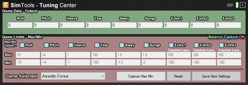

    Here are my SMC3 settings and my axis settings for Assetto Corsa. These might help you out but they may not work for your particular build at all.
    It's definitely worth taking the time to set up a motion profile from scratch following the FAQ https://www.xsimulator.net/community/faq/steps-to-create-a-motion-profile.228/

  16. Human Dude
    Human Dude Member Gold Contributor
    Aug 22, 2017
    33
    Earth
    38Coins
    +19 / 0 / -0
    Thanks!!
    I've got something that seems to work-ish with SMC3, but I'm not thrilled with it and yours are pretty radically different. I'm thinking it's probably worth trying, I can always reset it back to what mine were before if something closer to yours don't work at all.
    The SimTools axis settings is mostly just to confirm I'm on the right track more than copy direct. It looks like I'm headed in the right direction on that front, at least. I had thought that each axis was only supposed to run up to 100% to avoid clipping - you seem to go way over that. Was there a particular reasoning that let to that?
  17. armpit
    Jan 7, 2016
    128
    Software Engineer
    SC, USA
    - 8Coins
    +132 / 0 / -0
    The axis exceeding 100 is what I found gave the best feeling for me - it gives me more feel for what my car is doing but will clip if say I'm braking hard while in a turn on a bumpy road I may not feel the bumps in the road much. Definitely will depend on the game and especially the tuning center settings, which I realized I forgot to post for Assetto. Every game will vary wildly in setup for all of this, and there's personal preference that goes into it as well

    Going over 100 being okay is a pretty big piece of information. I was struggling with getting any feeling out of road surface or curbs / rumble strips at all. Thank you!

    The guide to refining a motion profile, and associated link concerning axis % allocation, detail that the ideal is around 100% and that it can be over when a DOF is shared between multiple axis, but the caveat is that if the axis movement reaches 100% for any reason then clipping will occur: https://www.xsimulator.net/community/faq/steps-to-create-a-motion-profile.228/
    The chances of clipping at 140+% are pretty probable, for those that run many 100% then clipping is almost a certainty.
