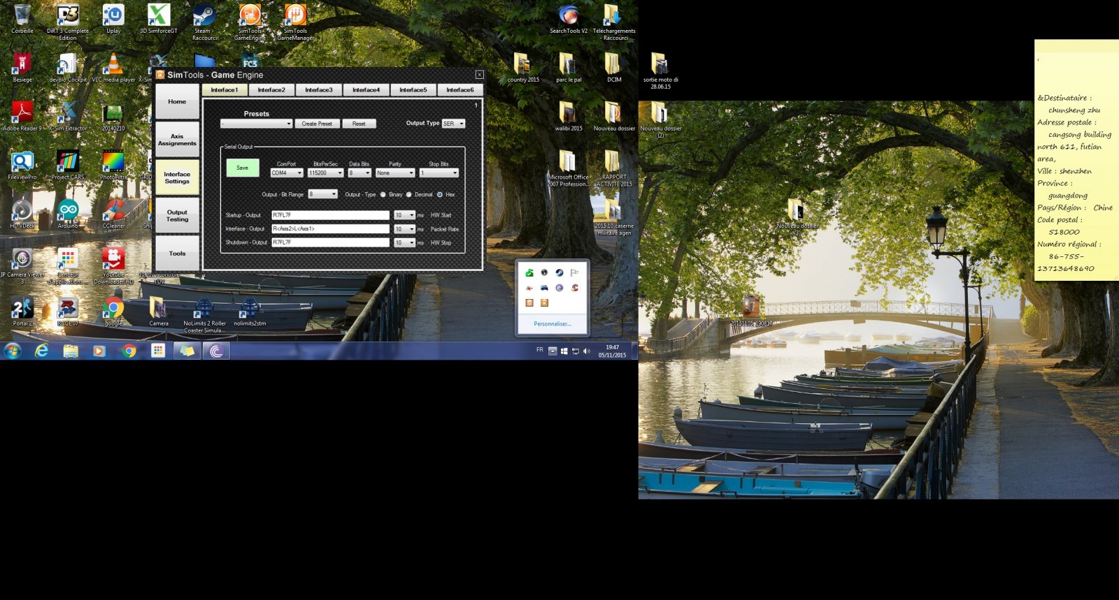

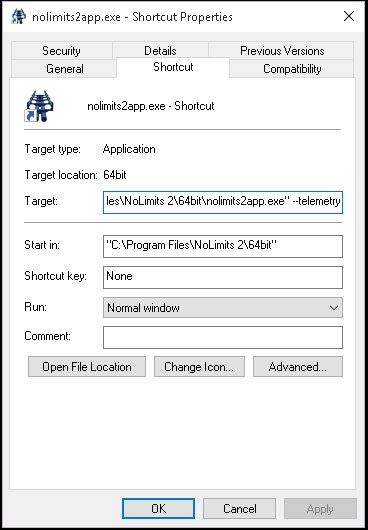

    Um, as I say NL2 works great with SimTools
    I'm using Arduino, Motomonster, wiper motors.
    1, I use , Racingmats arduino code for 2DoF http://www.xsimulator.net/community/marketplace/arduino-code-2dof-and-2-pins-direction-hbridge.67/
    2, add -telemetry to a shortcut...
    In my case, "C:\Program Files\NoLimits 2\64bit\nolimits2app.exe" --telemetry

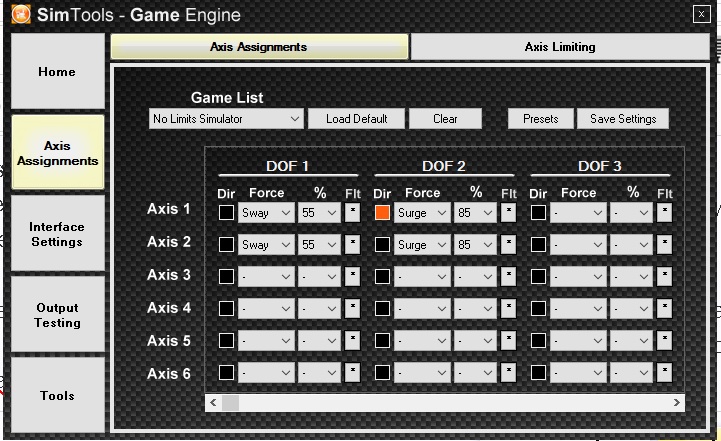

    2, in game Engine I need to reverse one axis/ motor on Surge, otherwise It would do what you are saying
    "again I'm choose any effect the simulator always moves from the front to the rear and very raremant from left to right with any effect.'
    Hope this helps.

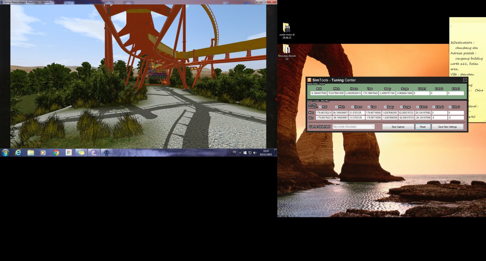

    I have done testing with the effects roll, sway, pitch.
    only the roll effect works. with the other 2 nothing moves.
    roll for the effect it makes me no matter what, in a turn right it will look a doite and the next he'll look right to left.
    on a straight flat line it will look right.
    to after the screenshot is that there would be something wrong in my settings.
    I said that I also made the test by changing the direction of rotation of motors.
    I can not find the problem.

    @matrixpascal , did you try reducing the numbers in tuning centre for roll?

    with a lot of research and patience I finally managed to run the simulator with the roll and pitch effects.
    in terms of point I can not seem to find how to go below 0 I have not figured out how to do or find.

    Hi Matrixpascal, can you post screenshots of your current tuning center?
