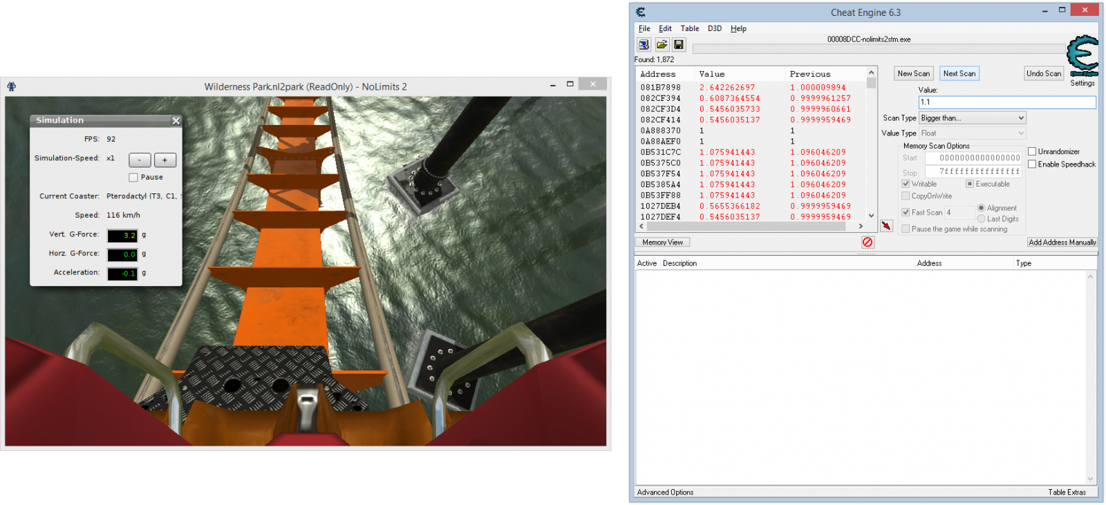

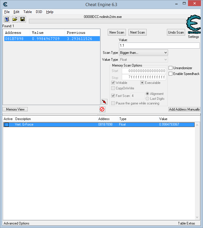

    In the Tuning Center un-check the tick in the box next to the name of the axis you want to manually enter a value for, say Roll, you can then manually enter Max and Min values all the way down to 0.01.
    The values must be entered like this, 0.5 not like this 0,5 as a decimal point is the recognized deliminator.

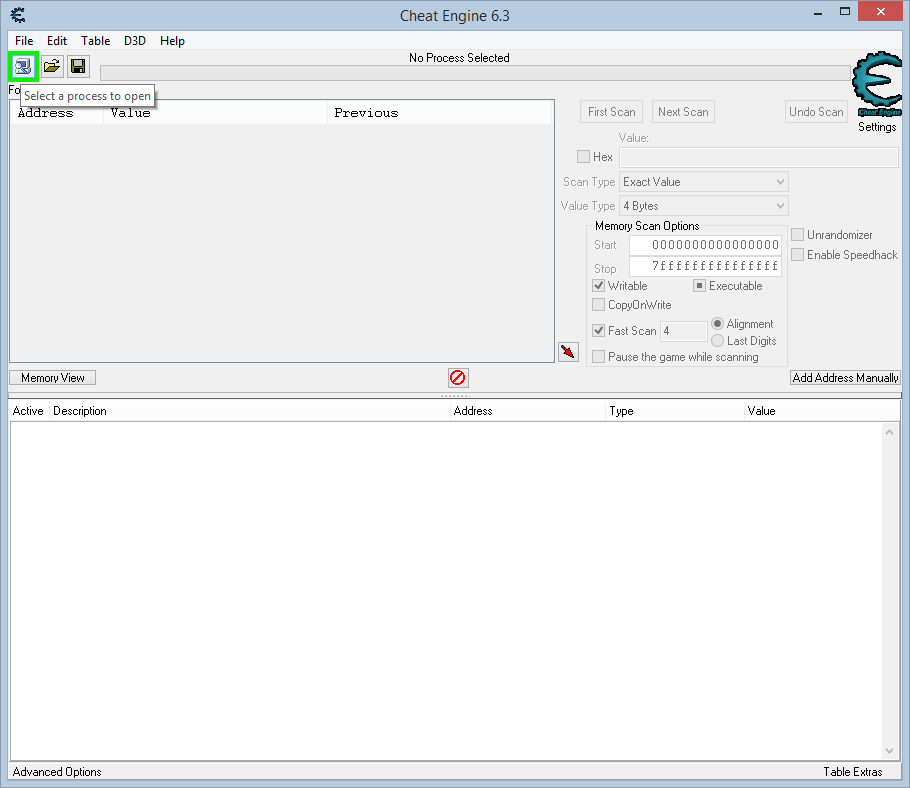

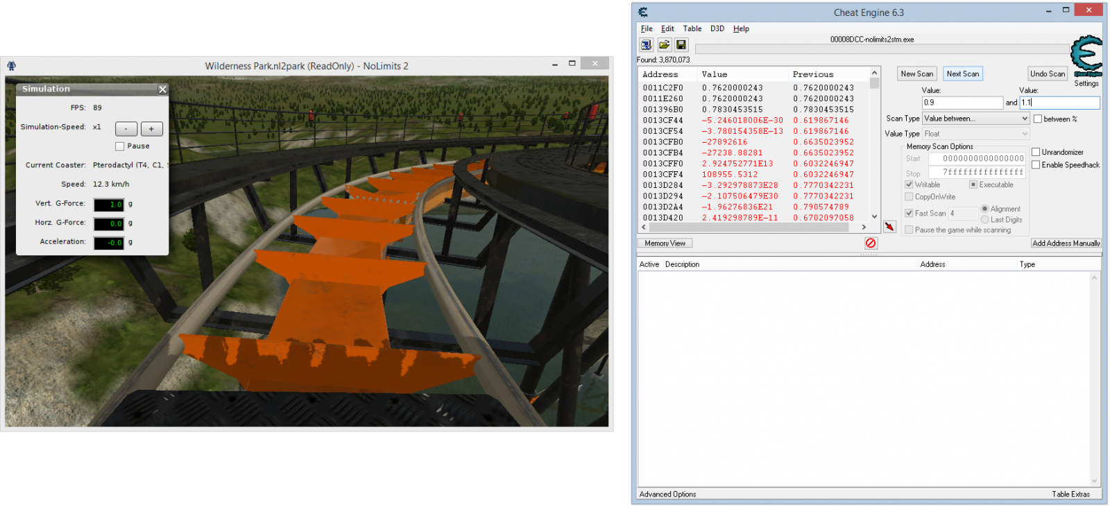

    It's interesting! I cannot download "cheat engine",can you email to me ? Thank U!

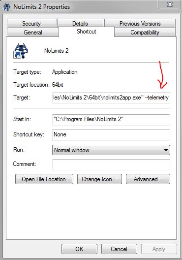

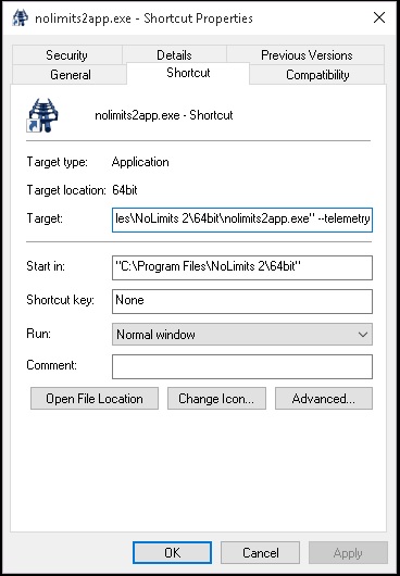

    I installed no limits 2, and now game manager says "game running" but still no movements... after searching up, I created shortcut with flag; -telemetry, but there is nothing..
    can you help me again??
  20. value1
    Jan 9, 2011
    2,192
    Zug, Switzerland
    14,294Coins
    +3,363 / 13 / -1
    Have you realised that it's "--telemetry" not "-telemetry" (two hyphen, not one)
