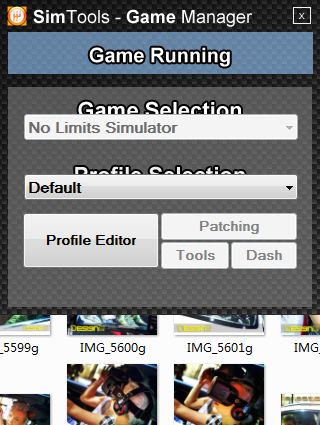

    I'm also having the same problem. I have the steam version and I tried patching the no limits 2 folder and the 64bit folder with no "patch installed" message. I also added the --telemetry in the steam launcher and still no luck. Game manager says Game Running when I start the game but no motion. Any help would be greatly appreciated.

    Have you tried running Game Manager as admin and then try patching NL2?

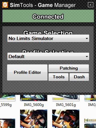

    Ok I got it working, I had to run Game Manager as administer and install the patch. Thanks for the help!

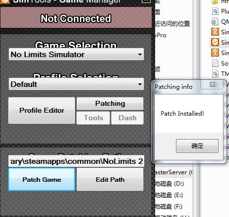

    @value1 hello value1, i just get an nolimit2 on stream, the version shows 2.2.1.2 64bit. but there is Strange situation,there is no motion data(i already check in the tuning center). everything is fine( install plugin) when i start the game before. but when the game is start. it pop a message on background "motion not supported". i try everyting i can do , run the gamemanage and NL2 with admin, add --telemetry on start option. my "SteamLibrary" is not in the default installation position,i install all the steam game in F:/ , is that should have a problme with the plugin runing? 307613499252165166.jpg 152214776916555667.jpg 221383415616215918.jpg 832910552387348755.jpg

    more information is i m test NL2 in windows 7 x64 + steam and win8.1, still the same problme. and i v try to patch in NL2/64bit floder. and restart the gamemanage, it is the same too.....

    Hi @donald if you are using the latest plugin, and running the game from Steam, you must patch to the programx86/steam/steamapps/common/nls2, folder.

    I just can confirm that the plugin works with NLS V2.2.1.2 :)
