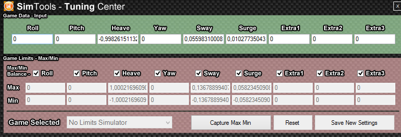

    When you do next have a poke around NL2 @value1 is it possible to have it like Extra 1 and 2 in P3D?
    I would certainly like to have the ED style option in every flying and sim game where 360 game play is the norm, it is far more realistic than the sim going from one axis extreme to the other at the inversion point.

    Hiya mate,
    Yeah makes a huge difference as when you do a barrel roll or a loop so either your roll axis or pitch axis goes past 180 it turns into a -180 and throws the rig to the opposite ends of travel it is the same with Yaw aswell.
    If it was like you did with elite and P3D and the old nolimits plugin with acceleration rather than the way it is now. I have no idea how you do it anyway so no idea if its hard or a quick fix.

    I am still have not enough coins to test this plugin, But could know that Pitching and Rolling are available now,
    are they representing positions? and are they ranged from 0 to 360 degrees, I am thinking of building 360 degrees pitching machine for this game and later maybe will be able to improve it for 360 degrees of Roll

    The current plugin doesn't like going past 180 degrees it turns it in to a negative 180 degrees and throws your rig all over. Hopefully our plugin master will fix it when he has time :)

    It has all 6 forces , so yes
