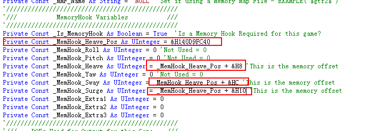

    @value1, as the picture shows,I have found the [​IMG] Vert G-force's Static Base 140D9FC40, and 140D9FC40->04E81150,
    04E81150+8 ->Vert G-Force's value,
    04E81150+C->Horz G-Force's value,
    04E81150+10->Horz G-Force's value.
    and as thesecond picture shows, the red box marked place, how can I fill it?

    '/// MemoryHook Variables ///
    Private Const _Is_MemoryHook As Boolean = True 'Is a Memory Hook Required for this game?
    Private Const _MemHook_Heave_Pos As UInteger = &H140D9FC40
    Private Const _MemHook_Roll As UInteger = 0 'Not Used = 0
    Private Const _MemHook_Pitch As UInteger = 0 'Not Used = 0
    Private Const _MemHook_Heave As UInteger = _MemHook_Heave_Pos + &H8 'This is the memory offset
    Private Const _MemHook_Yaw As UInteger = 0 'Not Used = 0
    Private Const _MemHook_Sway As UInteger = _MemHook_Heave_Pos + &HC 'This is the memory offset
    Private Const _MemHook_Surge As UInteger = _MemHook_Heave_Pos + &H10 'This is the memory offset
    Private Const _MemHook_Extra1 As UInteger = 0
    Private Const _MemHook_Extra2 As UInteger = 0
    Private Const _MemHook_Extra3 As UInteger = 0
  4. AlexinChina
    AlexinChina Member
    Sep 2, 2015
    71
    China
    371Coins
    +8 / 1 / -0
    In VS2010,I have gain a error:
    1 Error constant expressions can not be represented in the type "Integer" in.
    I'm looking forward your answer, thank U!@value1,@SlientChill Thank U!

  6. SilentChill
    2,654
    20,668Coins
    +3,594 / 34 / -0
    Why are you mem hooking ?
  7. SeatTime
    2,572
    +2,854 / 40 / -0
    Agree, this game supports telemetry UDP..as you have proven.
    And as advised a page back..
  8. AlexinChina
    AlexinChina Member
    Sep 2, 2015
    71
    China
    371Coins
    +8 / 1 / -0
    haha, because mem hook looks easier to implement, and I don't how to acheive the UDP feedback.
    And thanks for your answer!:)
