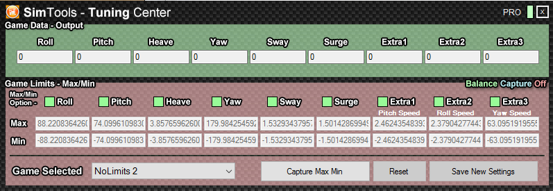

    I have posted this somewhere else - but for future searchers - To get a good profile for No limits 2 you need to monitor a complete ride via the Game Engine/Output Testing/Virtual Axis (handy to do this for any simulation) and ensure the system is not clipping - this will give you a good smooth ride. Then set the Axis percentages to suit your rig. As an example here's my setup (6DOF).
    - Heave = 20%, Surge = 20%, sway = 20%, Roll = 40% and Pitch = 40%. Do not use Yaw - unless you own a 360 degree capable sim :) it will just mess things up. Also Sway and Surge have 10% smoothing.
    Tuning Center as follows:
    Main Slider - 100%
    As I'm using the standard Pitch and Roll, this obviously is no good for the 360 capable Roller Coasters. Looking into a profile using possibly the current Extra1,2 and 3 for that.
    And a video of the rig with this setup.
