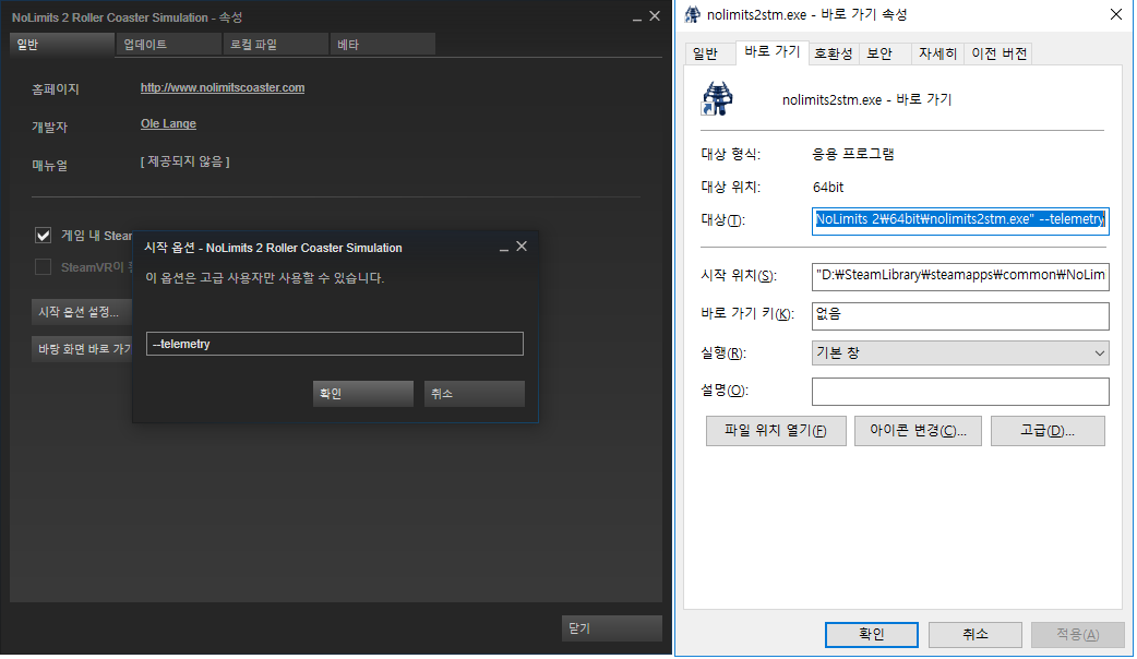

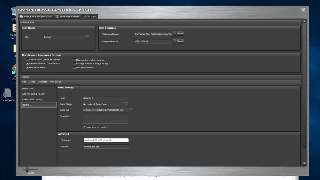

    its simple. your telemetry command line its wrong.
    not a "--telemetry" only. If you could uses on steam client, you have to put
    ENTIRE line, includes appid of the game, see:

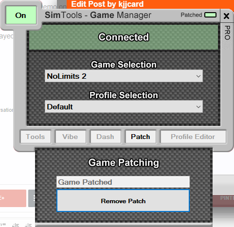

    sorry...
    I live in SouthKorea.
    So the time difference seems to be a lot different.
    As soon as I wake up at 10 am I write this.
    I now apply telemetry to Steam and exe files.
    I set it to English Local as noorbeast said.
    But it is not progressing ...
    It is doubtful what to do in this situation.
    How did you solve it?
    Also, LFS works well, but why is No Limit2 not working well?
    Thank you for your interest.
    I will not give up on this problem.
    Thank you.

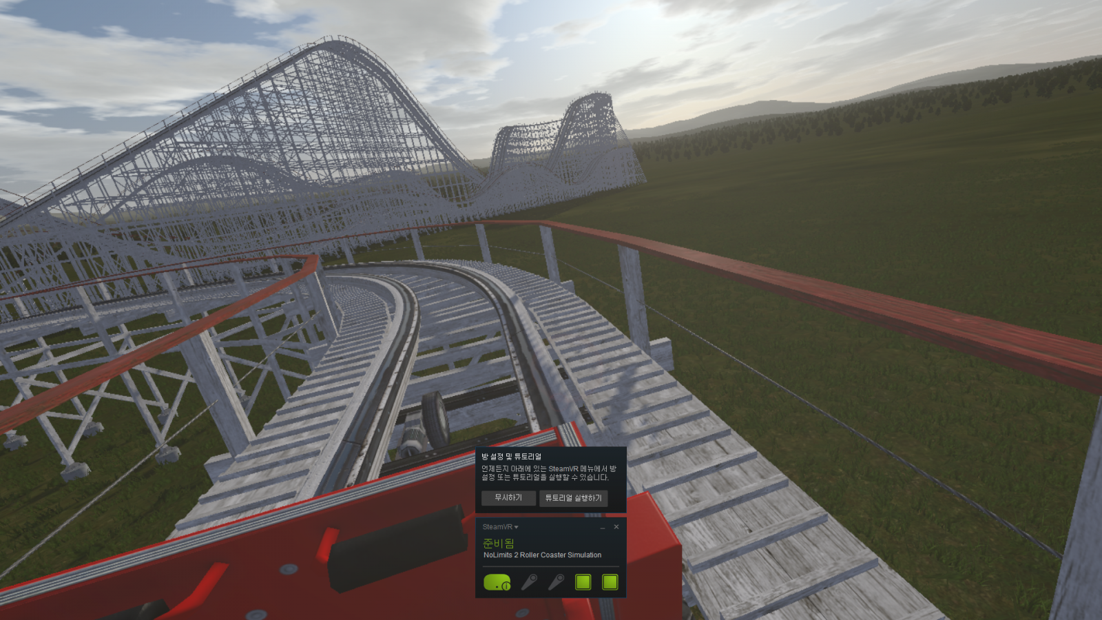

    Hmm..
    I have run NoLimit as my motion platform and moved!
    But it is a bit strange.
    Attach pictures.
    When I first started, I was on a flat rail.
    But the motion platform is tilted to the right.
    What settings should I set?

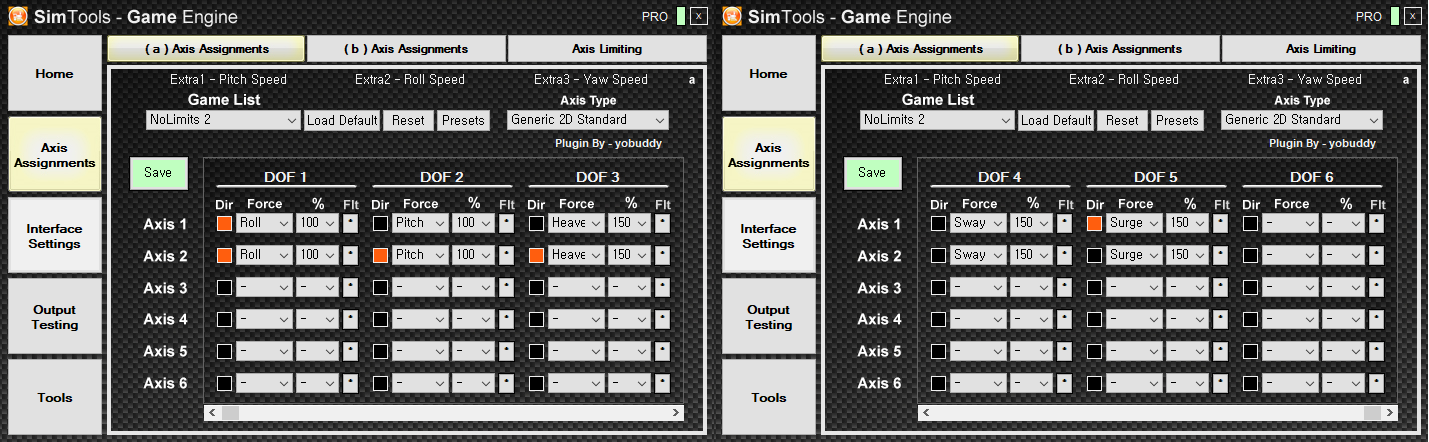

    Your Axis Allocations are way too high, see here for the steps to create and refine a motion profile: https://www.xsimulator.net/community/faq/steps-to-create-a-motion-profile.228/
    Your Dir checkboxes appear all wrong for a 2DOF. The checkboxes being checked orange or not determines which way each axis moves, this is what SimTools expects: https://www.xsimulator.net/community/faq/which-way-to-set-simtool-axis-movements.230/

    This is what I am now correcting. When you add a Heave value, the motion platform tilts to the right from the beginning.
  18. noorbeast
    22,228
    154,837Coins
    +11,227 / 57 / -2
    Your current settings don't look right for a traditional 2DOF, see the manual here for an overview of settings: https://www.xsimulator.net/simtools-game-engine/#Setting-up-your-Default-Axis
    Excluding the values used this is more what the Axis allocations and DIR should look like, if your DIR settings are wrong the axis are going to do weird things like you describe with heave.:

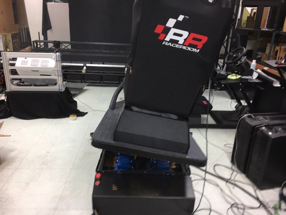

    This is the setting I sent from the company that purchased the motion platform. I set it this way and it looks like it works. But when the roller coaster turns 360 degrees. The movement of the motion platform becomes strange. There is no setting for Heave, Sway, or Surge.
  20. noorbeast
    22,228
    154,837Coins
    +11,227 / 57 / -2
    If you purchased the simulator what brand is it and what actual instructions are given. The picture you just posted suggests one axis only does roll and one pitch. Can you please post some pictures to confirm.
    A rollercoaster doing a 360 is something a 2DOF sim cannot emulate. You can use filtering and in addition @SeatTime has done some recent refinements to the plugin itself: https://www.xsimulator.net/communit...er-simulation-plugin.4777/page-26#post-133264
    But the basic Axis allocations do have to be correct.
