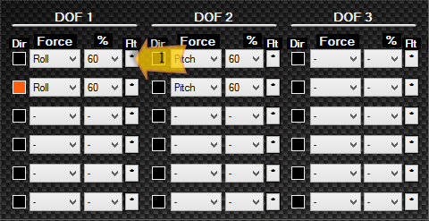

    I bought the site of the model. Https://www.youtube.com/watch?list=...fsyXA_DBBH&v=NKiWUkExirw&ytbChannel=armeniman In this model, ROLL and PITCH are put in 1DOF. But it went well. The problems are Heave, Surge, and Sway. And if you turn around, the motion platform will jump. Hmm... Is it possible to put Heave, Surge, and Sway in 1DOF?

    Your option would be to try roll and sway at smaller percentages on Axis1, with sway having the Dir unchecked, and pitch and surge on Axis 2. Heave could be awkward depending on the geometry of the rig and a transducer may be a better option.

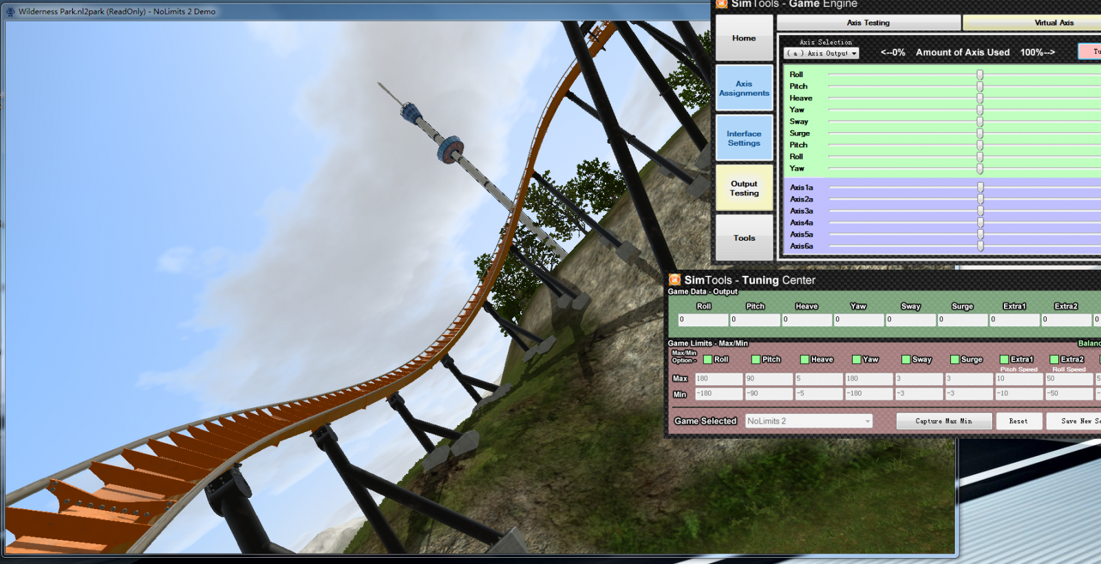

    I have a question: whether this game plugin must use simtool2.0 or later? Because i am using simtool1.3, but my simulator can not move.

    Hello!
    My simulator doesn't work.I am using NoLimits_V2.0.9.0 _Demo and, add -- telemetry.In Tuning Center, Game Selected is NoLimits 2 but Game data-output has no value, and Virtual Axis has not changed In the Game manager.So this Game plugin can't be used for NoLimits 2-Demo version?Or other problems?
  6. value1
    Jan 9, 2011
    2,192
    Zug, Switzerland
    14,306Coins
    +3,363 / 13 / -1
    NoLimits does not provide telemetry data in the demo version only in the full version.

    How can I get a demo version game plugin?

    Thank you for your interest.I deleted "-- telemetry", but my simulator still doesn't work, so "NoLimits Rollercoaster Simulation Plugin 2.0.0.4" is a full version of the Plugin and cannot be used for demo version?

    There is no plugin for the demo version of NoLimits, as the NoLimts demo does not provide the telemetry like the full version of NoLimts does.
    As @value1 said the plugin only works with the full version of NL, it will not work with the demo version of NL.
    When the plugin is used with the full version of NoLimits the --telemetry flag is required: https://www.xsimulator.net/community/faq/no-limits-2-v2-2-and-higher-how-to-activate-telemetry.198/

    One additional note to @noorbeast's advice, @JayceTeng: In all your posts in which you mentioned the telemetry flag, you put a blank between -- and telemetry. This blank needs to be removed. So it has to be
    --telemetry
    and not
    -- telemetry

    But it will still not work with the demo version!
    The demo version of NoLimits does not output telemetry data!
