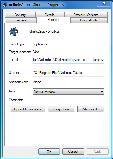

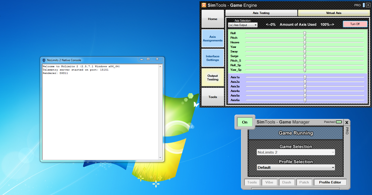

    hello i have no motion when i start the game.
    Game manager status is :Game running
    Axis assignement is config for NoLimits 2
    I use W10 64bits, game version is 2.2.3.0
    Any idea?
  20. DoubleM
    DoubleM Member Gold Contributor
    Jan 2, 2018
    46
    Amsterdam
    - 23Coins
    +20 / 0 / -0
    You need to add a startup parameter "--telemetry"
    And not all the tracks do have telemetry data.
