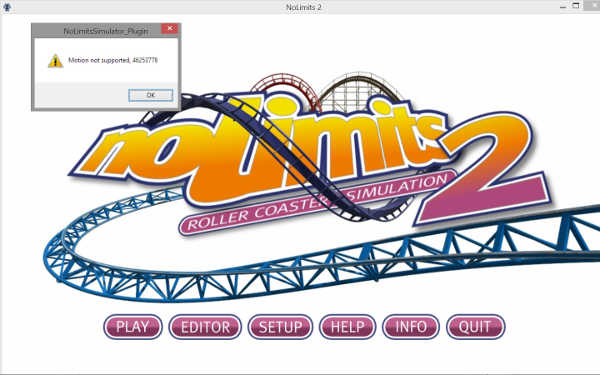

  13. noorbeast
    22,208
    154,711Coins
    +11,211 / 57 / -2
    I have an odd one with NoLimits 2.
    I had motion working and then it just stopped. Hmmm, I had a look at this list and saw that motion not supported is often related to versions. Sure enough an update was available. Great, updated and motion worked. I thought to myself I will try that out with the Rift when I get home from dinner with friends. I got home a few hours later and got message after message that motion is not supported, followed by a number that keeps changing.
    Any ideas, as nothing changed, I just did not use it for a few hours. I can't for the life of me imagine what is going on.

  15. noorbeast
    22,208
    154,711Coins
    +11,211 / 57 / -2
    I just updated to version NLS 2.1.0.0 this arvo @value1 . The same thing happened with the previous version, which I purchased yesterday. It ran the first time with motion but after I reapplied the patch it never had motion again. Initially I re-installed NL2 and the plugin but that did not work, Updating did get motion working again, but only for the first time I used it. It just seems really odd.
  16. value1
    Jan 9, 2011
    2,192
    Zug, Switzerland
    14,294Coins
    +3,363 / 13 / -1
    What operating system are you running, @noorbeast ?
    NLS works fine here with Win8.1 x64 and the Steam version, the 32 bit and the 64 bit version.

    Jan 9, 2011
    2,192
    Zug, Switzerland
    14,294Coins
    +3,363 / 13 / -1
    Bizarre! Let me try something and i'll come back.
  19. noorbeast
    22,208
    154,711Coins
    +11,211 / 57 / -2
    No problem @value1, I appreciate you looking into it. I was hoping the number might mean something as there is nothing else to go on for troubleshooting.
  20. value1
    Jan 9, 2011
    2,192
    Zug, Switzerland
    14,294Coins
    +3,363 / 13 / -1
    Please read out the number loud and clearly. I can't see it and it might help me ;)
