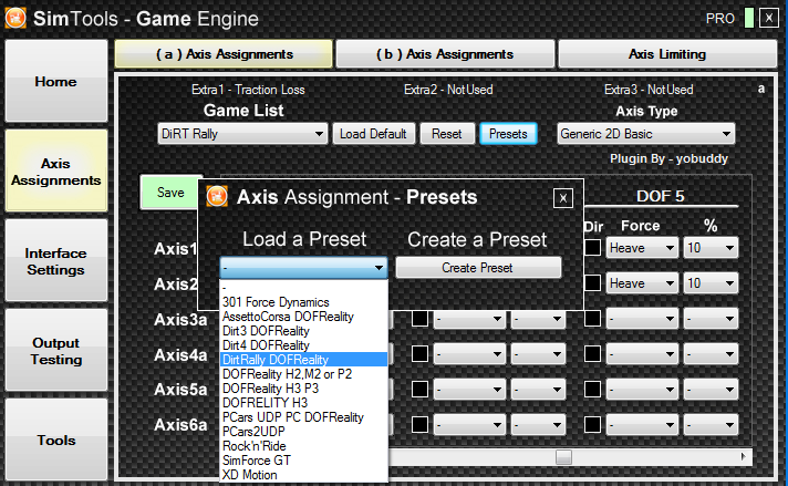

  5. Prabin Kumar Jha
    Prabin Kumar Jha Member
    Jan 12, 2018
    53
    271Coins
    I will send you my pictures of setting soon.

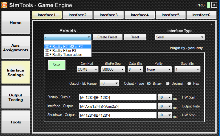

    I have short question: for preset in Interface setting, I have three options:
    1.DOF Reality H2 orP2
    2.DOF Reality H3 orP3
    3.DOF Reality Tloss
    But i have dirt rally so which one of above preset i choose. or for my game, the above preset is different.
    pls. answer me.

    pls. the screenshots:

    You will get the most out of your simulator by learning how to create and device a motion profile specifically for your rig, here is how: https://www.xsimulator.net/community/faq/steps-to-create-a-motion-profile.228/
    Did you make sure you ran some laps before patching?
    The patch path differs depending on your windows system being 32 or 64bit, which do you have?

    my controller is IBT2 ic instead of MM.

    remove start up and shut down commands in the interface settings. also be sure to create a default profile in the game engine

    another option would be to run the smc3 utility in udp passthrough mode. then in game engine use network interface put the ip of the game engine pc and port as stated in smc3. in this configuration smc3 will remain running in the background. it may be easier to set up this way.
