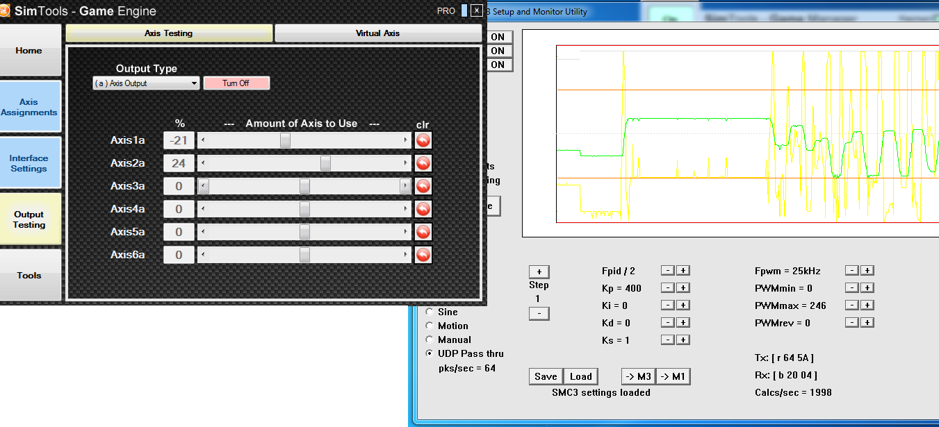

    I ran the default setting but again no result achieved. For your reference, the response of output testing with slider of game engine is attached below.
    During the running of dirt rally, the response of tuning centre is shown below.
    Since I am working on this last couple of days and no response of driver seat dynamics could be got.

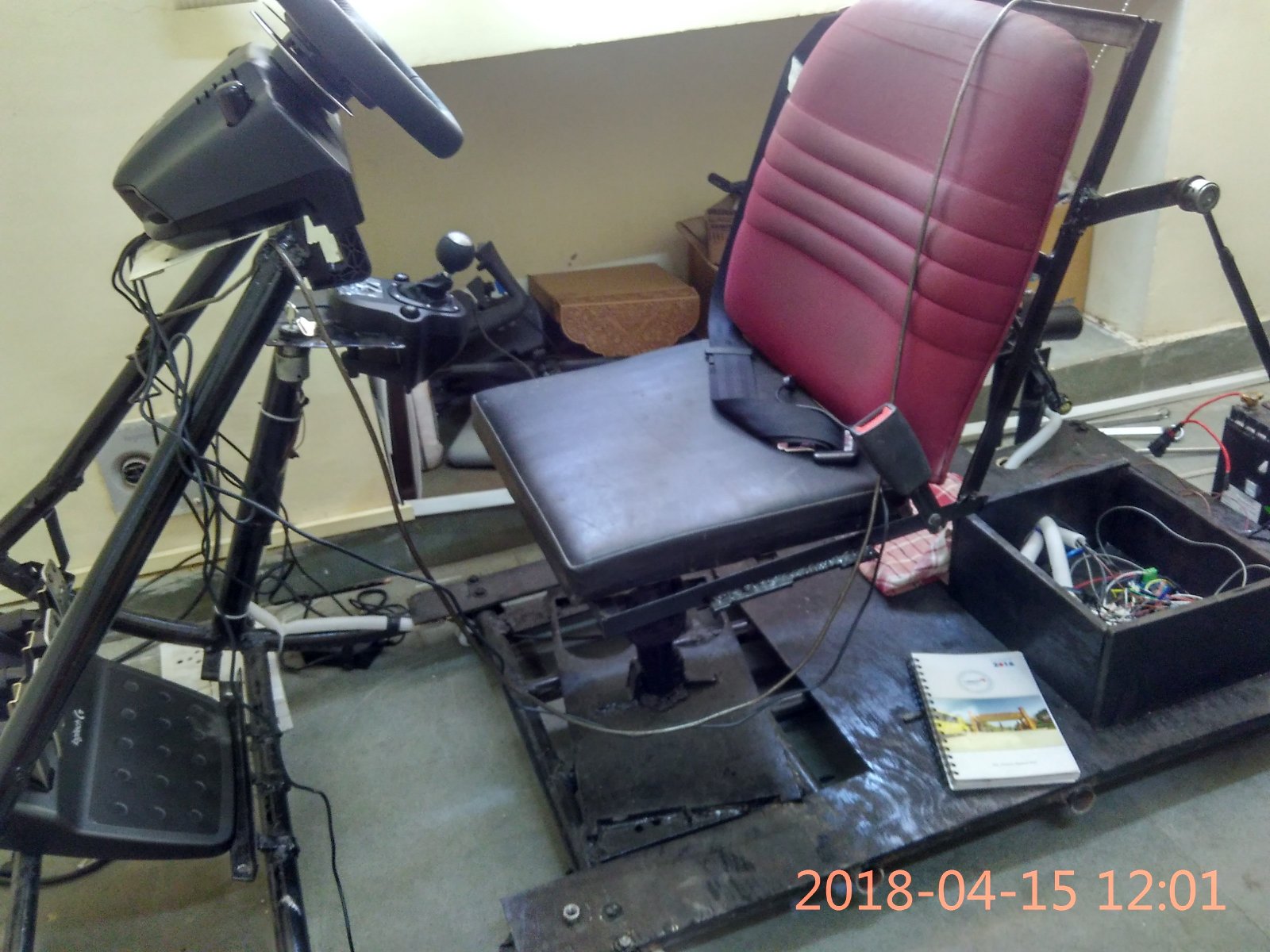

    Motor1:
    Motor2:
    My setup is also attached for your reference. As I connected smc3 utility with game engine via network interface, I did not get any response in motors through output testing slider. Setting of game engine and smc3 utility are shown below:
    Pls. suggest me further to make my model run.

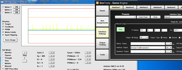

  16. bruce stephen
    Jun 7, 2015
    1,286
    general contractor
    michigan
    9,112Coins
    +1,238 / 9 / -0
    try local ip 127.0.0.1
  17. Prabin Kumar Jha
    Prabin Kumar Jha Member
    Jan 12, 2018
    53
    271Coins
    I tried with local ip as suggested, but no response while operating output testing slider. pls. find the screen shot of setting:

  19. Prabin Kumar Jha
    Jan 12, 2018
    53
    271Coins
    It works with network interfacing in game engine via udp pass through and both motors operate through output testing with slider but as connected with dirt rally game, no response in motors. Pls. see the screenshot.
    Again the problem remains same.
  20. noorbeast
    21,189
    148,814Coins
    +10,919 / 54 / -2
    If a sim behaves correctly in output testing then the most common problem where the game is fully updated and supported by the plugin is a configuration issue.
    The patch path for Codemaster games is different, depending on it being a 32 or 64bit version of Windows: https://www.xsimulator.net/communit...-32-bit-install-path-for-motion-patching.260/
    Games should have been run before patching.
    Follow these steps to create and refine a motion profile, doing one axis/force at a time: https://www.xsimulator.net/community/faq/steps-to-create-a-motion-profile.228/
