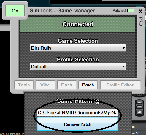

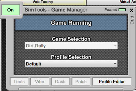

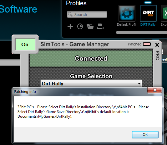

    The correct patch path on 64bit is C:\Users\Your_User_Name\Documents\My Games\DiRT Rally
    Does Game Manager turn blue when Dirt Rally is running?
    Does the top row of the Tuning Center have values when Dirt Rally is running?

    Pls. find reply of above queries:
    1 The correct patch path on 64bit is C:\Users\Your_User_Name\Documents\My Games\DiRT Rally
    2.Does Game Manager turn blue when Dirt Rally is running?

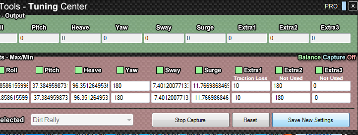

    3.Does the top row of the Tuning Center have values when Dirt Rally is running?
    4. Interfacing setting of game engine:
    Rest for ifs, I will share with you very soon. Pls. comment on the above screenshots.

    The data is present in the Tuning Center @Prabin Kumar Jha, so the profile may need some work but SimTools is working.

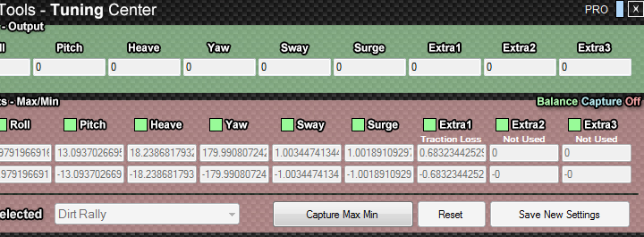

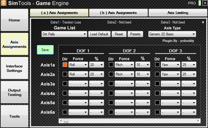

    I started setting the tuning centre keeping surge 20% and rest zero and I got following information in TC but there is no response in seat play. I am still doing. Please correct me if I am wrong.
  13. noorbeast
    22,029
    153,770Coins
    +11,149 / 57 / -2
    The TC values, other than sway, look way too high, I have mentioned before that these are the steps to create and refine a motion profile: https://www.xsimulator.net/community/faq/steps-to-create-a-motion-profile.228/

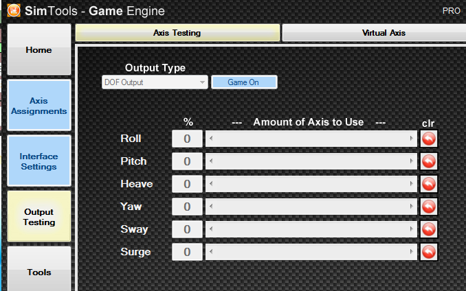

    The data is there in SimTools. Is Output testing working correctly and if so have you created an Axis Assignment for Dirt Rally?

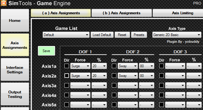

    I kept sway 20% and surge 0% in axis assignment. pls. find the screenshot as follows. PLs. comment. Now I am doing for heave. Still there is no response in motors once connected dirt rally.
  15. noorbeast
    22,029
    153,770Coins
    +11,149 / 57 / -2
    You need to answer my earlier questions, is Output testing working correctly (motors move) and if so have you created an Axis Assignment for Dirt Rally?

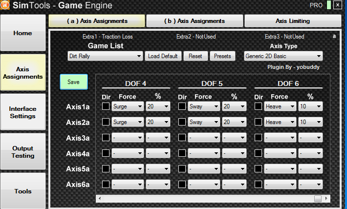

    yes sir, motors work as output testing through slider.

    Pls. find axis allocation for dirt rally and motors move with the help of slider
