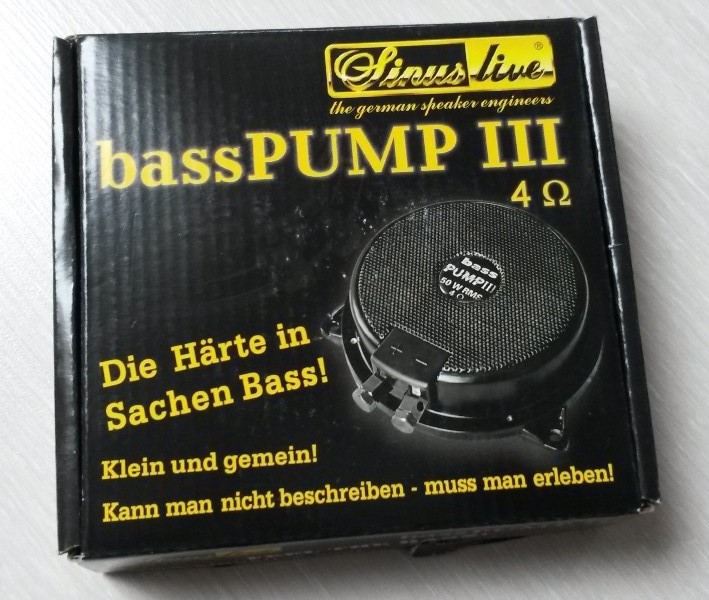

    @Doctor Kruntz I prepare for you all information about the basspump

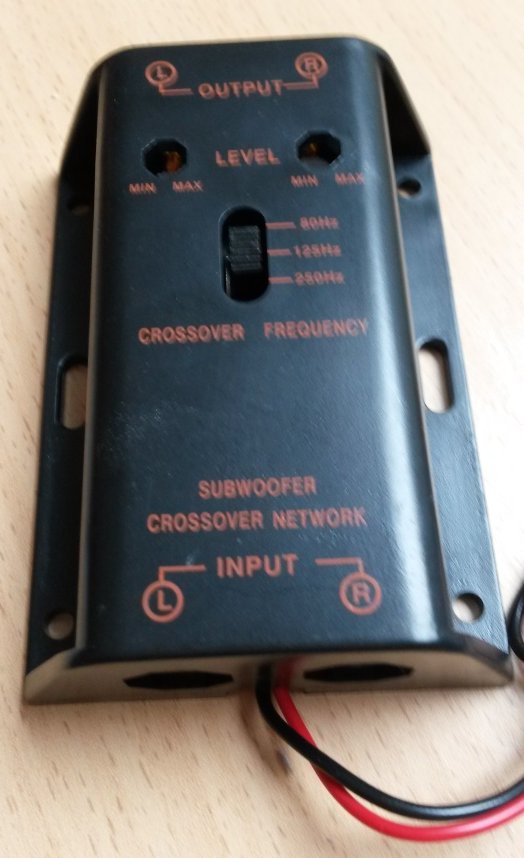

    Hello, Regarding the Basspump,
    BassPump
    Crossover
    Ampli
    I re-used the amplificator come from a little sub-woofer
    I use them in Serial, one under my seat (directly fixed on it) and the second behind the pedals (mounted on the home made plate and fixed on the thrustmaster pedal)

    Used to filter the frequence (to have only the low frequences)

    2 Models (mount in serial)

    Do you have a link where you purchased this from?

    yes, you have two links (basspump & crossover) in my first topic
    do you see them ? (amazon)
