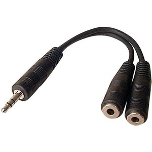

    @Doctor Kruntz r
    Actually, i use the basspump without software. They are connected on my principal sound card with a double jack 3.5mm connector (like the picture)
    is it understandable or do you want more informations ?
    For the ampli, you can take a 100w standalone or if you have a older hifi amplificator

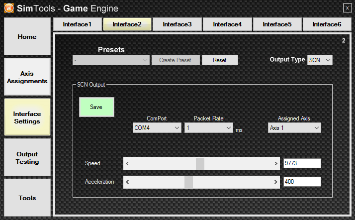

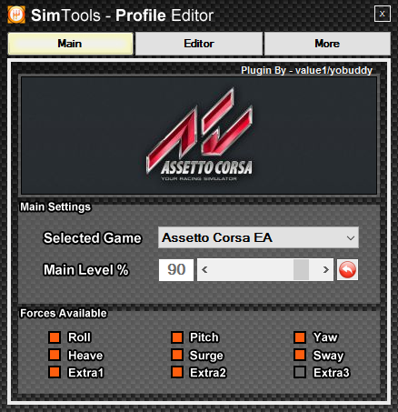

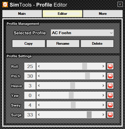

    My general settings and for AC (I continu to set them)
    I start to find a good sensation.
    I test with a track and car who I know well to compare the reality and the virtual

    That is a 220% Axis Allocation. You really need to refine your Tuning Center values.

    Ok, noorbeast, I did not understood completely the total of 100%
    I will try this evening

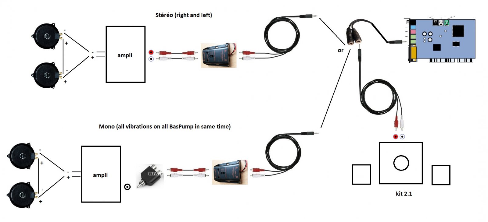

    the scheme of my Basspmup installation (mono for me)
    let me know if it's clear ?

    Many thanks for the perfect bassPump scheme Fohen... ;):thumbs
