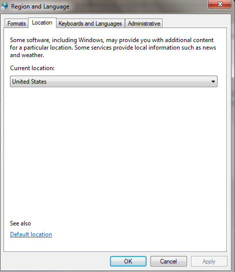

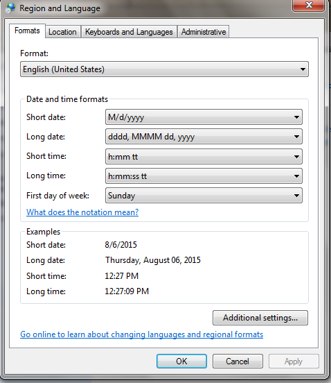

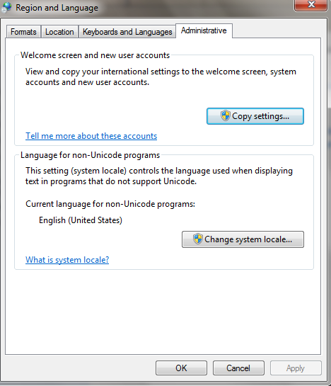

    @dJuL did you go in control panel - region and language and change Format , Location tabs and on administrative tab the Language for non-Unicode programs , into English?
    give it a try if you haven't done all three changes

    Yep I think...
    Region & Language window has changed under windows 10, but I set English / US everywhere and it wasn't enough.
    Fortunately it's easier to put the "." into the clipboard and past it with the context menu, it works fine and I can keep my keyboard in AZERTY and my regional settings. ;)

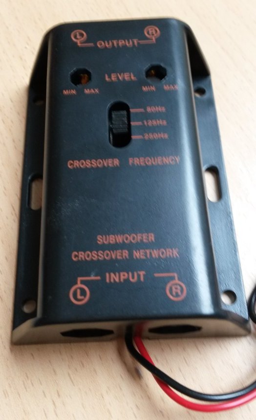

    Fohen, how frequency have you set on the Crossover (80, 125 or 250 Hz)?
    And you have fueled him or it is simply inserted along the mounting scheme?

    Cut your principal HP to do some test with only the basspump and test the 3 positions
    more this setting will be down and less you will have all frequencies (for the bass, you must have low)
    I don't use the crossover at this moment because I added a mechanical-component inside my amplificator

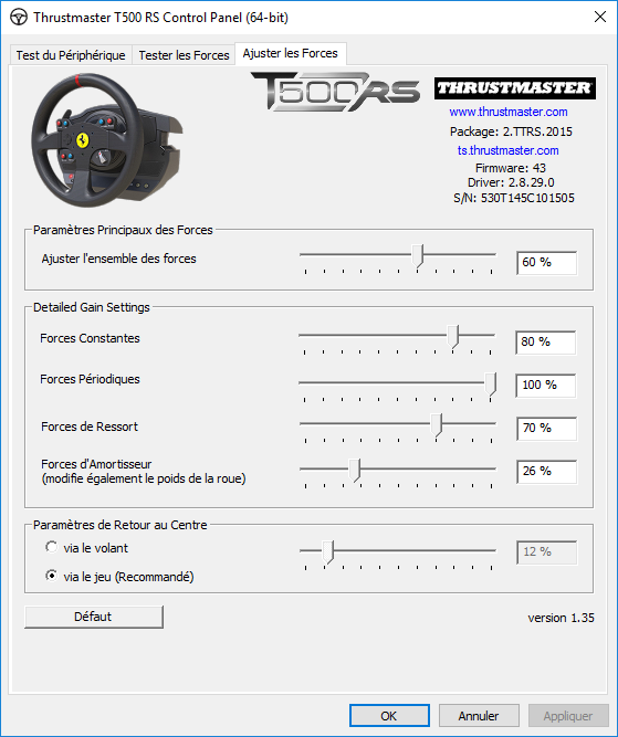

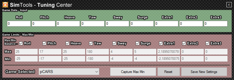

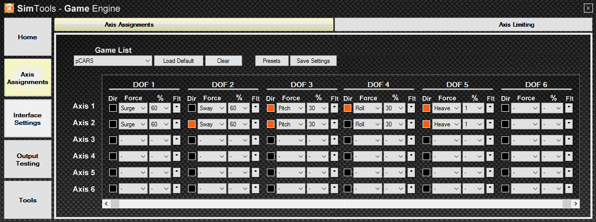

    Hello All,
    After the long period of testing, I think I know well now how to work SimTools and I start to have a good feeling of my Simu.
    I share you my Global settings, for PCars (for the beginning)
    T500RS Control Panel - 900°

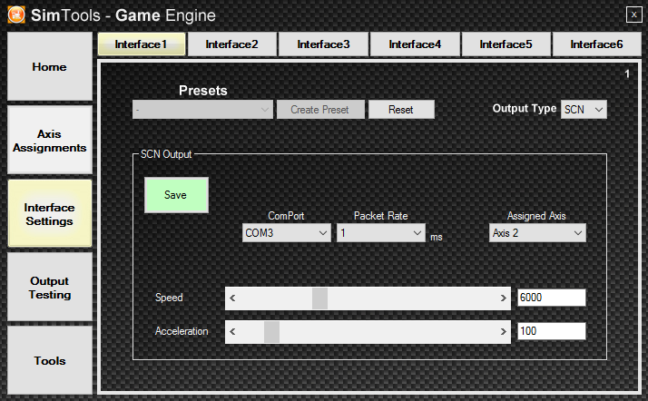

    SimTools - Game Engine - Interface
    SimTools - Game Engine - Axis Assignments

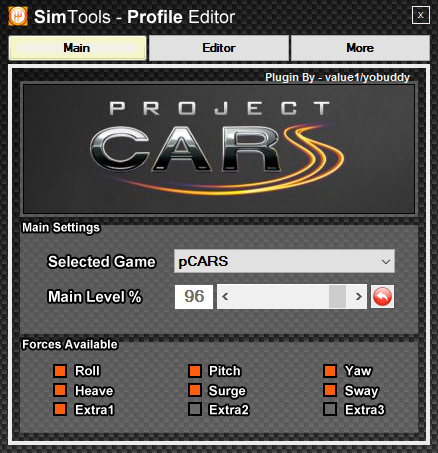

    SimTools - Profil Editor - Main

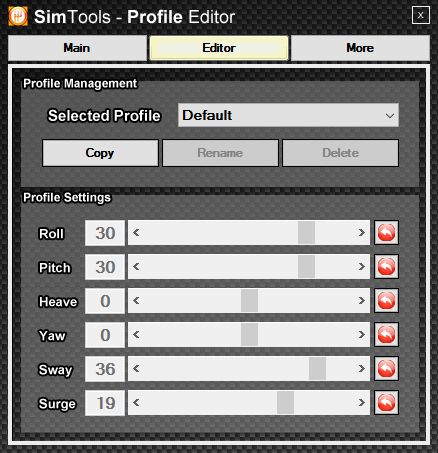

    SimTools - Profil Editor - Editor

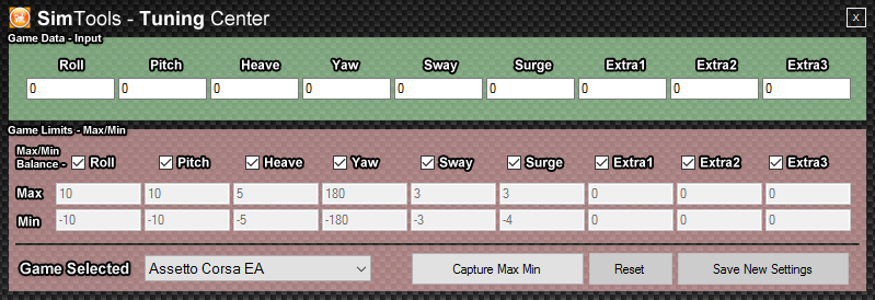

    SimTools - Tuning Center

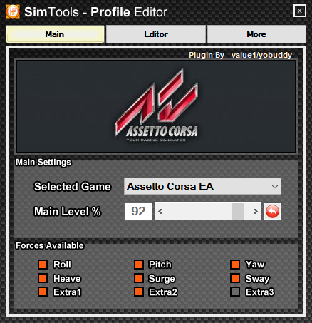

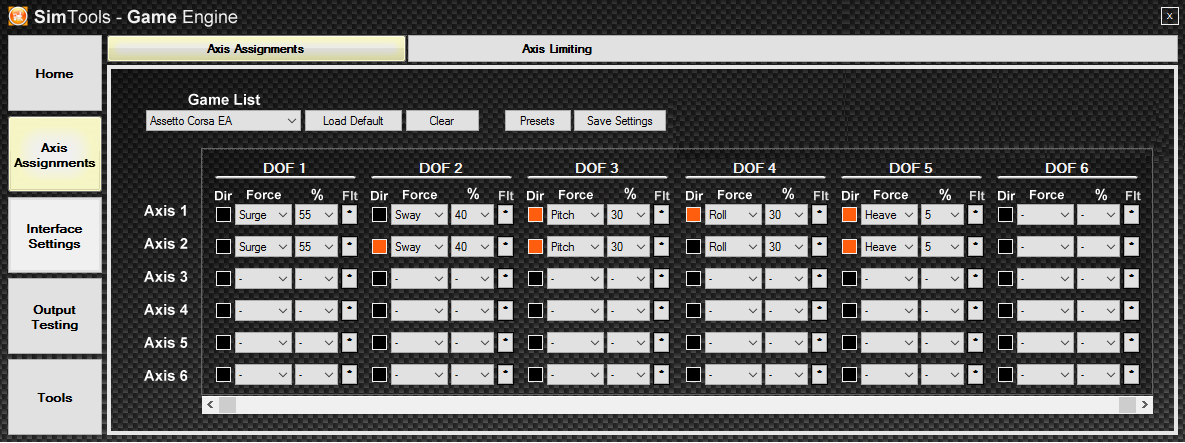

    And for Assetto Corsa
    The settings of my T500RS are the same for me and for AC & Pcars

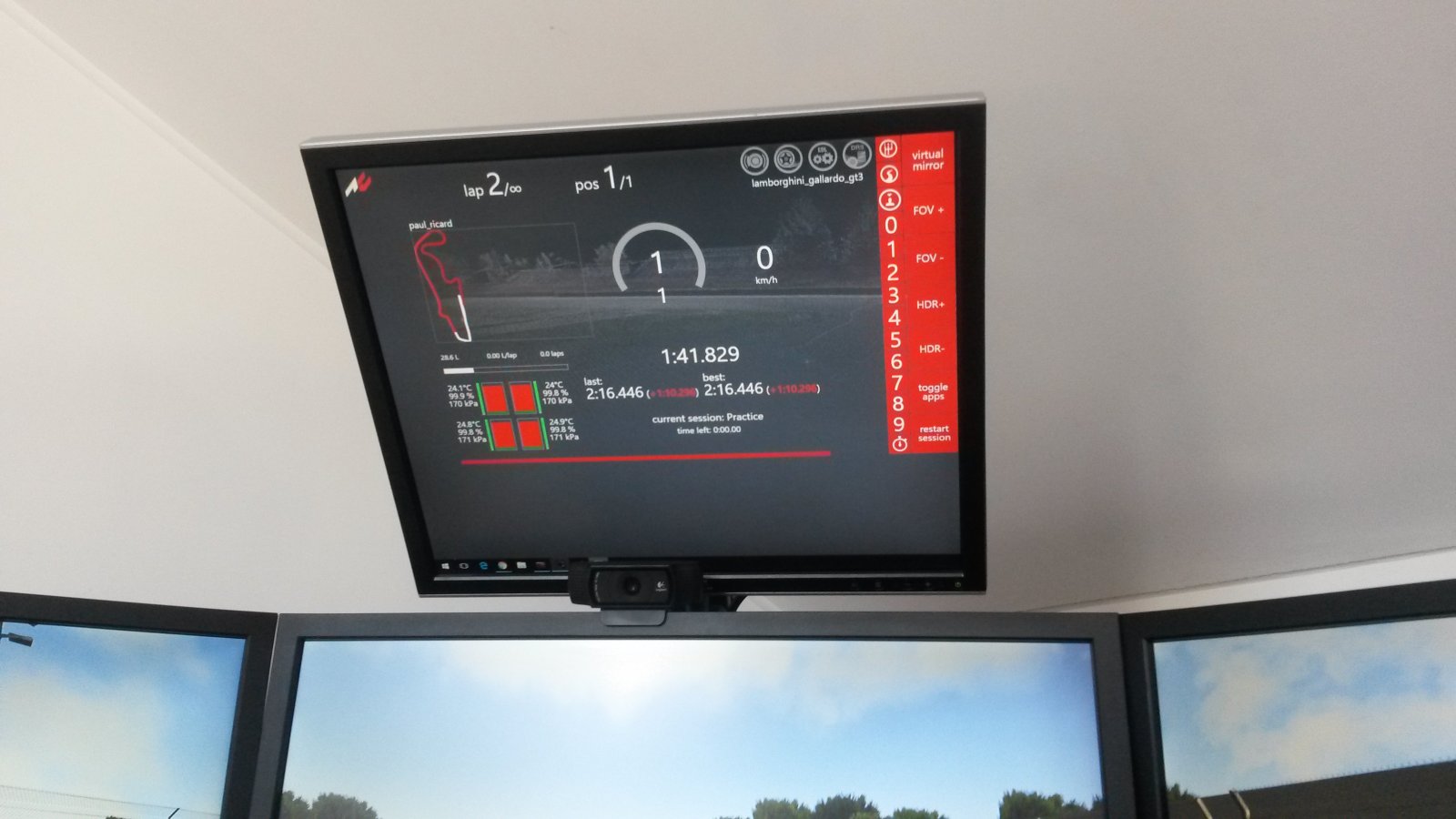

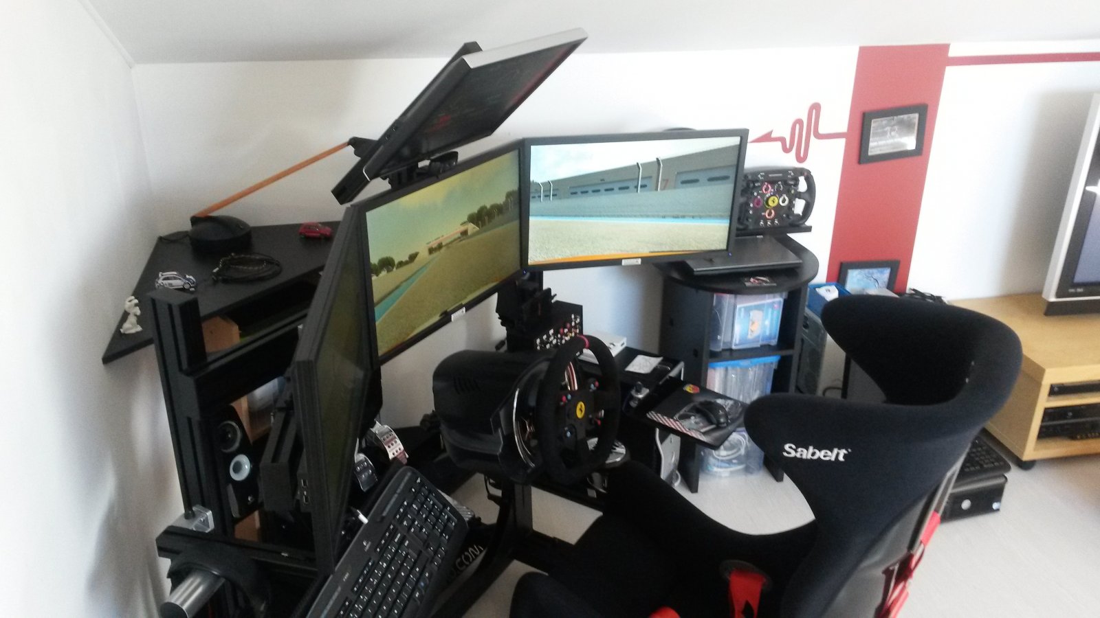

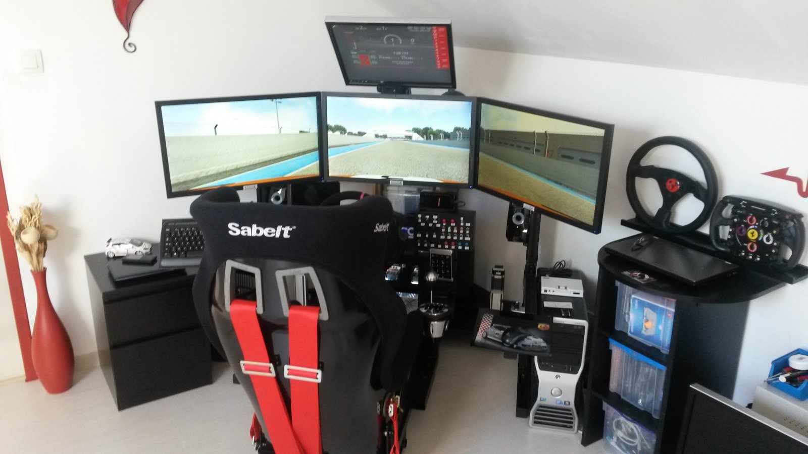

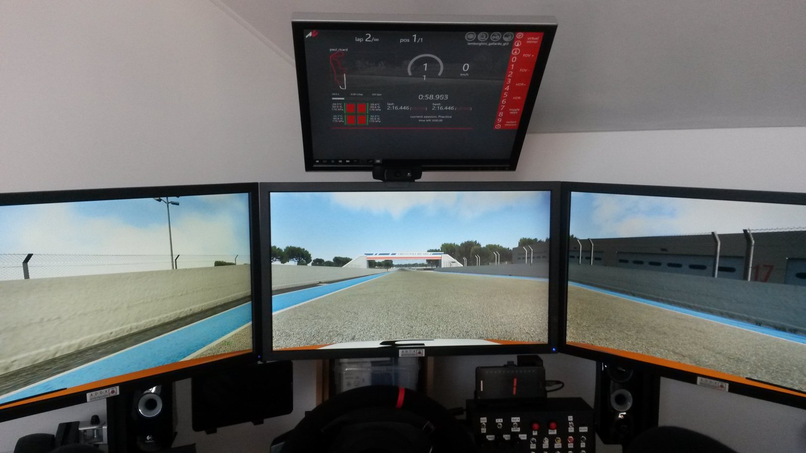

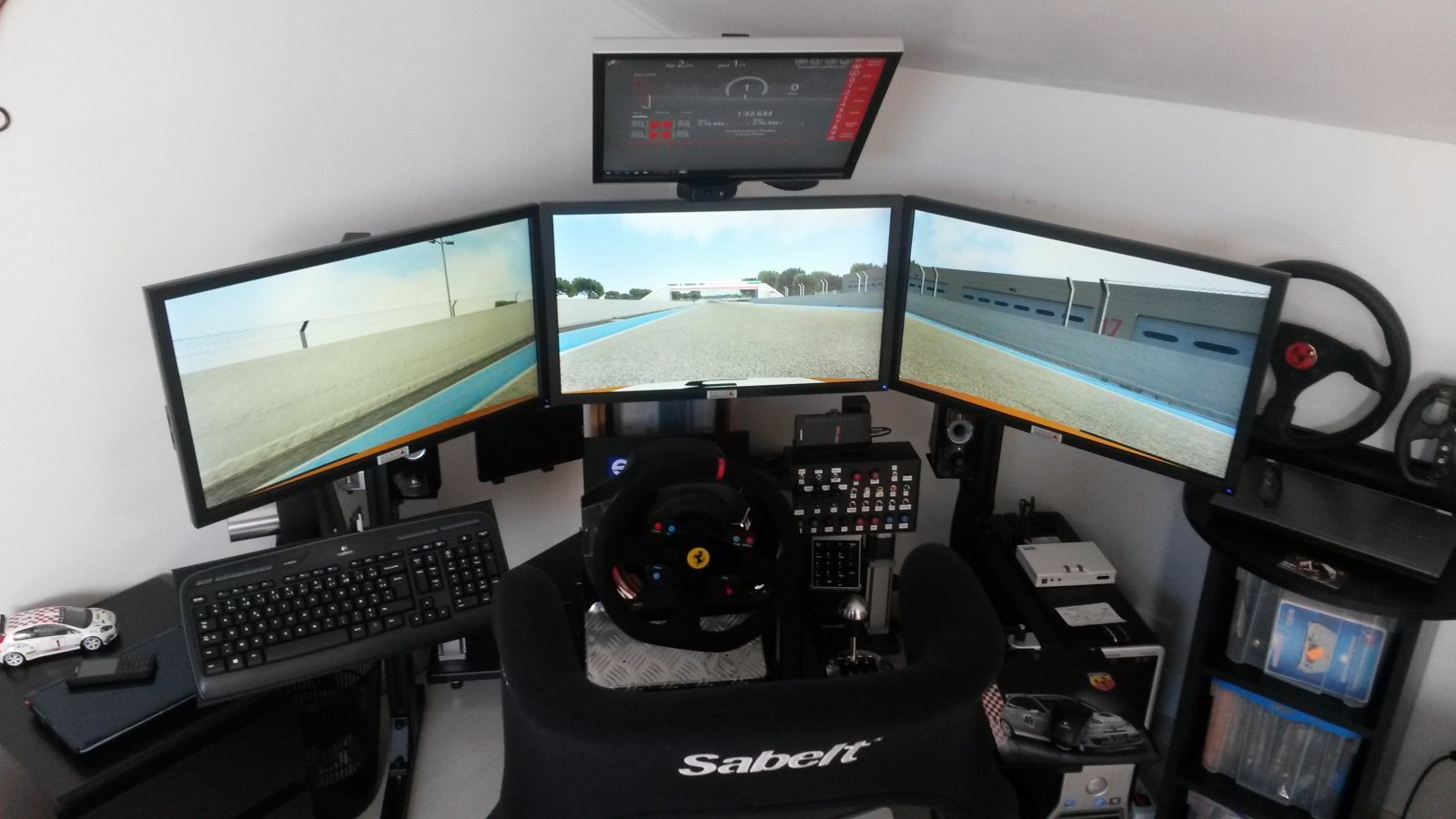

    And some pictures

    it's very beautiful!!
    you can see all you screen when you driving ?!!!

    like in real driving, only one time by lap and during the big line

    Ho wow ! Your rig is very complete !
    I did not know that you could use another screen for apps in Assetto Corsa o_O

    3 screens are merged in one (5960 x 1080), more one screen alone
    You can use the last one for what you want

    Jolie poste de pilotage :thumbs

    Merci Icefox, j'y ais travaillé depuis 3 mois

    Est-ce nécessaire de toucher au réglages dans Profil Editor-Editor ? car il y a déjà Game Engine Axis Assignments et Tuning center tu coup je me pose la question :!
  19. Foehn
    Foehn Member
    Nov 30, 2015
    132
    Race ; Mechanic ; Simulation
    3Coins
    +29 / 0 / -0
    3DOF, SCN6
    Yes IceFox, all are linked and it's very important to customize them
    Game Engine - Interface is set (and commun) for all games (my opinion)
    Game Engine - Axis Assignments : different for the games
    SimTools - Profil Editor - Editor : to adjust in the game related the track or the cars (Gt ; Lmp, etc)
    Oui Icefox, tout est lié et indissociable
    Dans l'ordre
    Le Game Engine - Interface est réglé (et commun) pour tous les jeux et suivant ton ressenti.
    Le Game Engine - Axis Assignments : différent suivant les jeux
    Le SimTools - Profil Editor - Editor : pour ajuster dans le jeu suivants les circuits ou autos
