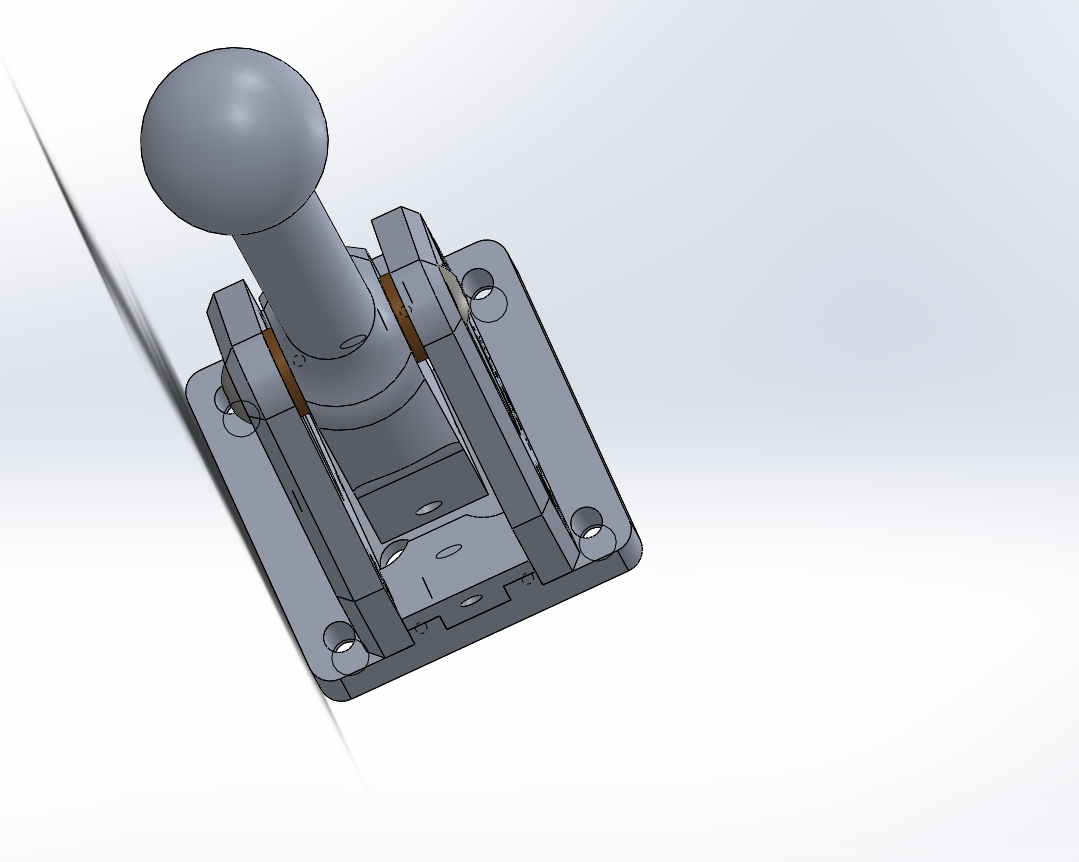

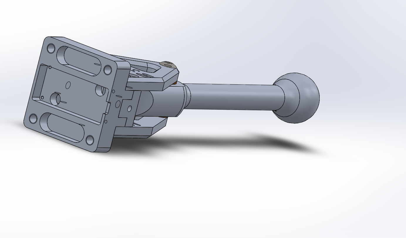

    Due at the using of Dirt Rally, I build a shifter (handbrake cooming soon)
    The major parts of shifter will be build by myself in ergal and will be anodize in black

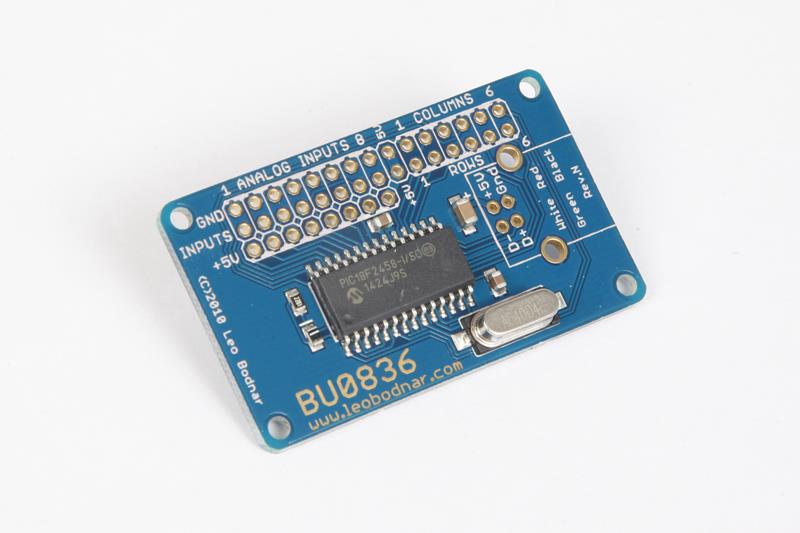

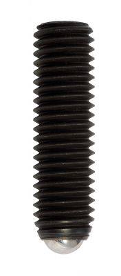

    Please find the material chosen for the electrical parts:
    1 LeoBodnar for the usb controler
    2 Switch for the contactor
    1 special screw with marble (to increase the feeling)
    Some pictures of the proto

    Electrical materials

    Prototype

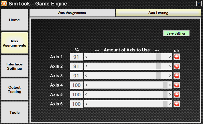

    Hey mate, I was wondering if I could ask you a couple of questions about your settings for the T1000 3DOF? If you have time could you PM here please. Cheers, AussieStig
  11. dJuL
    dJuL yes !
    May 1, 2015
    137
    None
    9,424Coins
    +86 / 0 / -0
    3DOF, SCN6

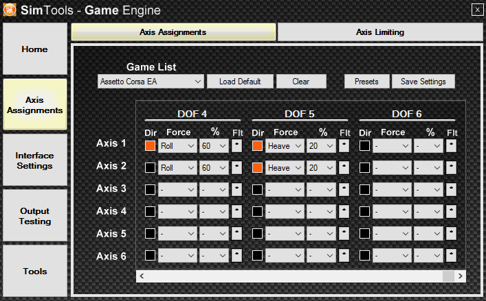

    I changed a lot the settings since I have posted these captures.
    Why don't you post your questions here ?
    Maybe it could help other people.

    sure, please ask here your questions

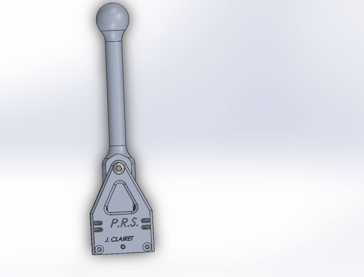

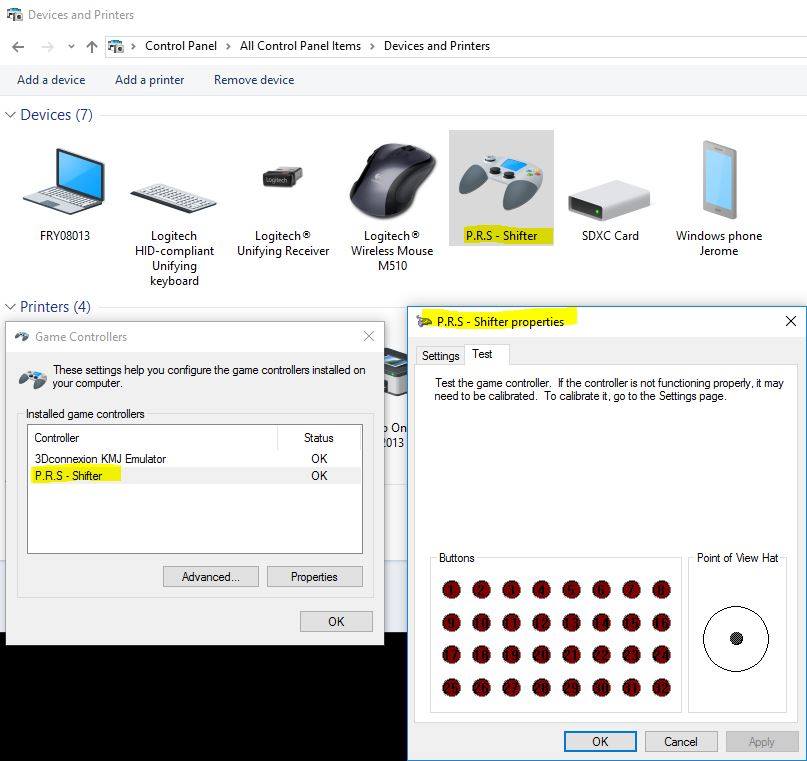

    The project of Shifter is in progress.
    The conception is done and i will start the CNC parts.
    The electronic is ready with our name in the bios
