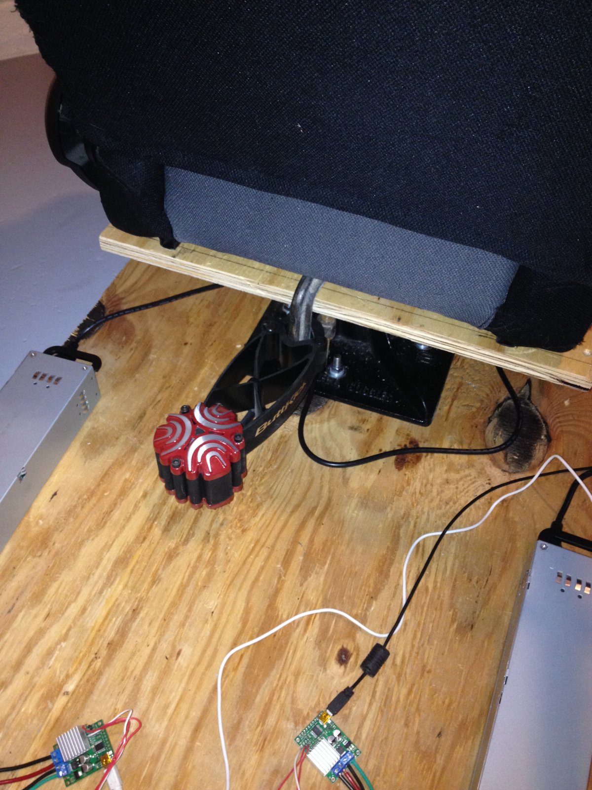

    @Nick Moxley Did you have any trouble with those server power supplies tripping? I hooked up my jrk's last night and was in the config utility. After I setup the settings and had the motor plugged in I clicked run motor in the utility and it quickly tripped my power and fried something. Jrk smoked and now is erratic and smokes if I plug it in. Trying to figure out what caused that weird issue before I hookup another jrk.
  7. eaorobbie
    20,491Coins
    +1,687 / 23 / -2
    Sounds like the polarity is wrong , about the only way to smoke a Jrk.
    Please test with a meter to make sure you have a 12v+ going to the Vin on the Jrk plus a good ground too.

    I'm working on a JRK replacement or discount. One interesting question they asked was: "Is there some reason you think using a heatsink is necessary?" They wanted to know if it could have caused a short. Will these boards run ok without one?

    yes they need a heatsink, we run them ridiculously hard and they survive. Put a heatsink on the big chip and keep it a bit away from the capacitors. without a heatsink, they will thermally shut down.
    Oh and when you speak to Pololu, just say it was getting a bit warm.

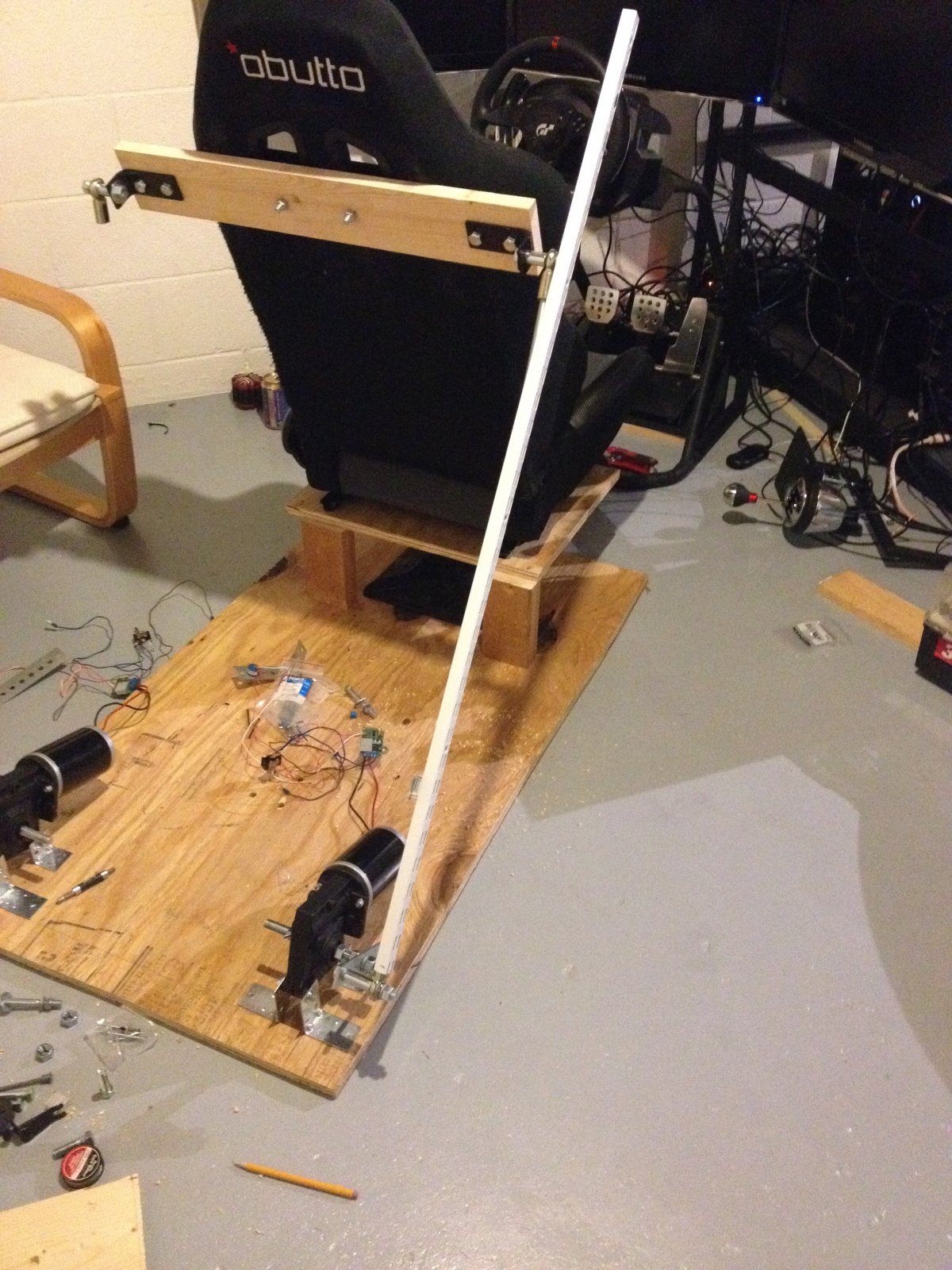

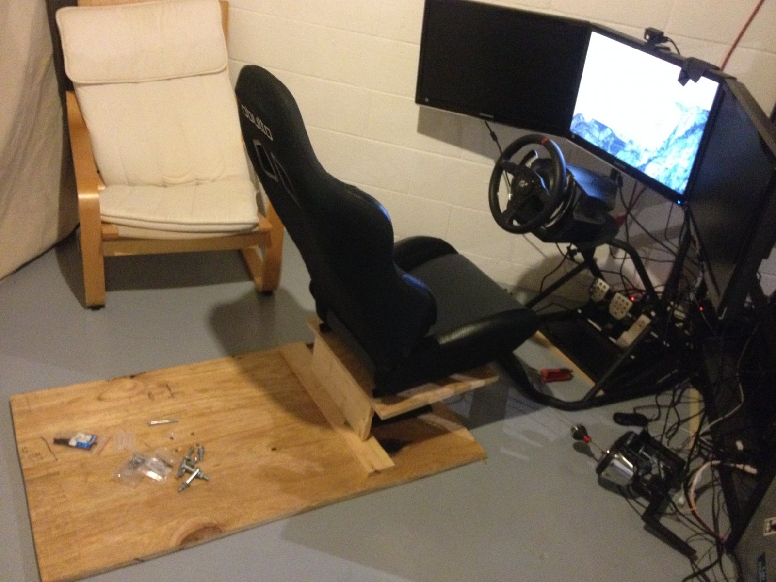

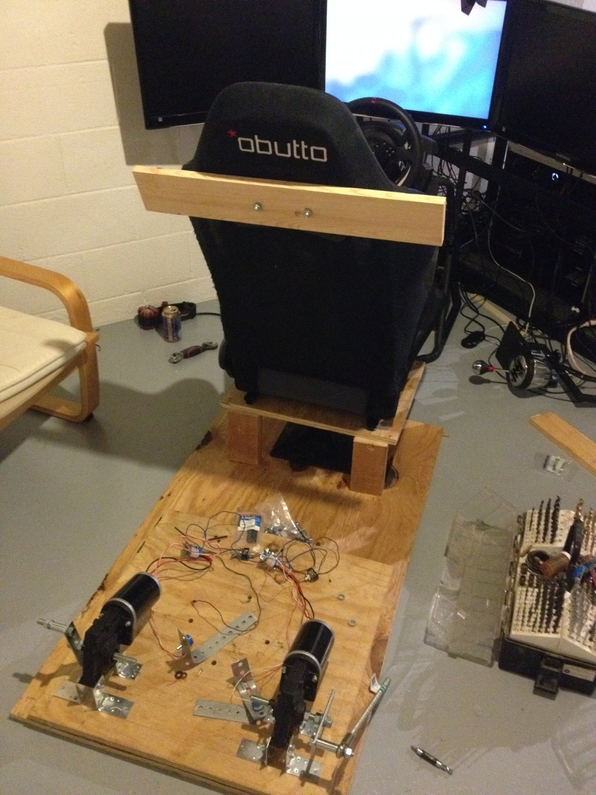

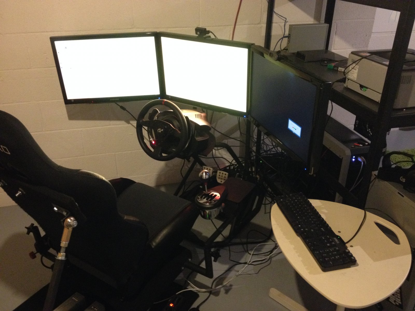

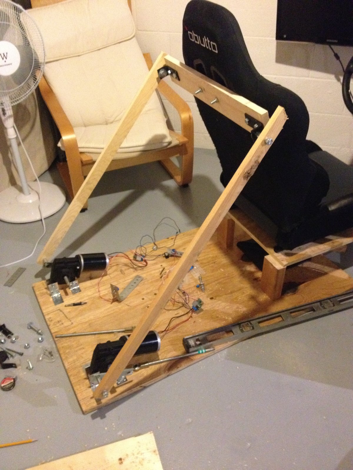

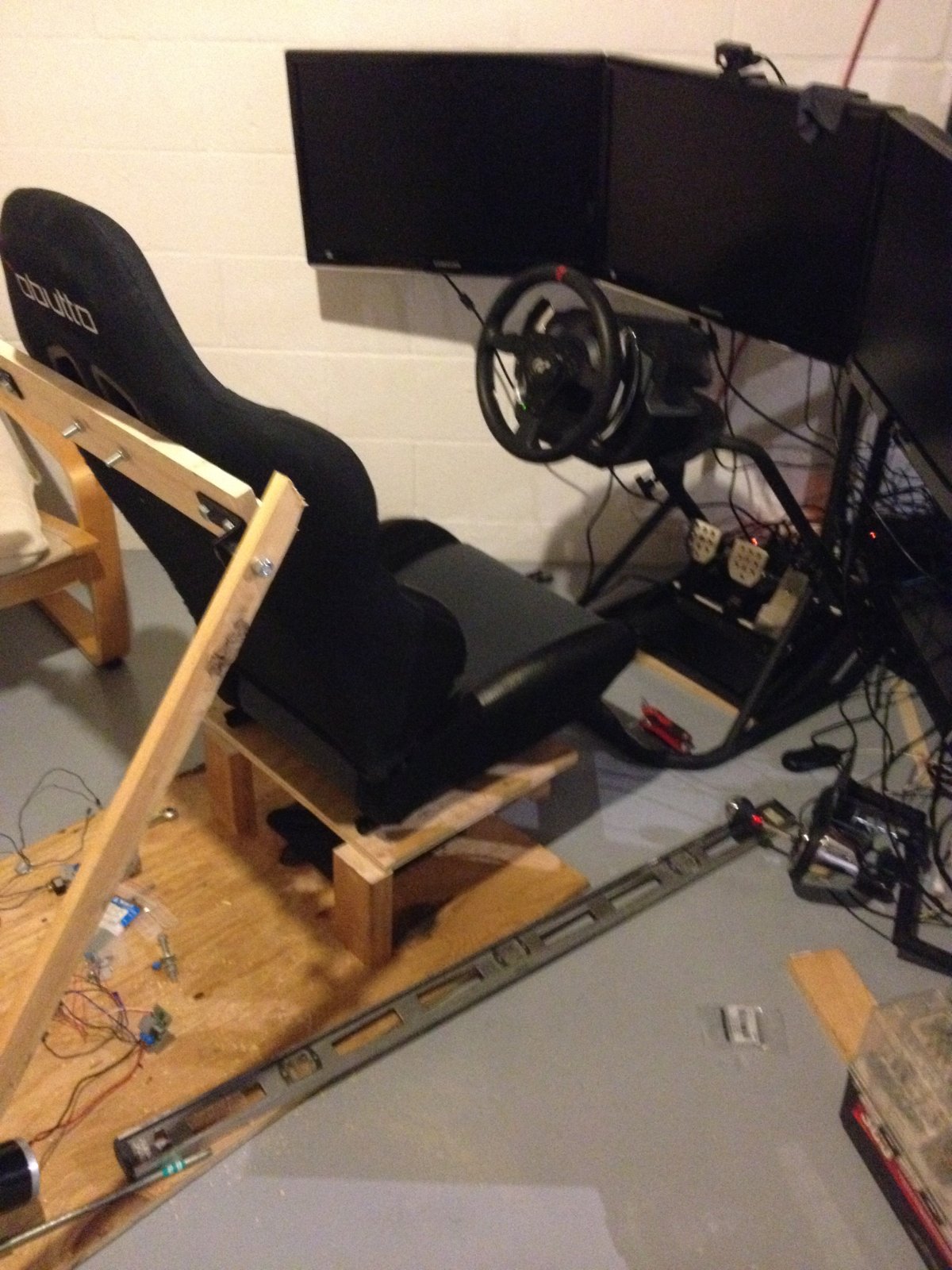

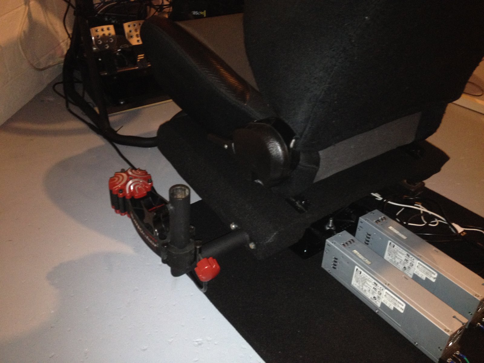

    Ok it's been a while. I have totally reconfigured my setup and have the first version almost complete.

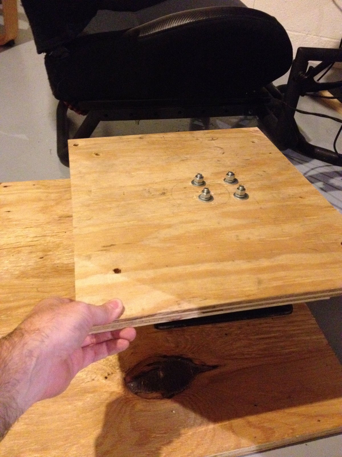

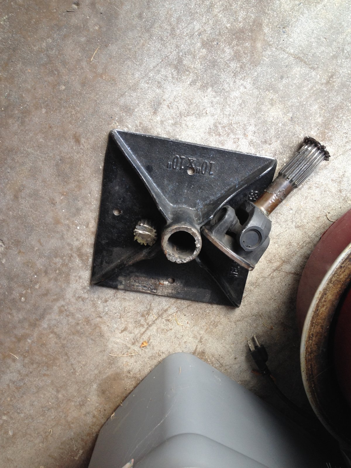

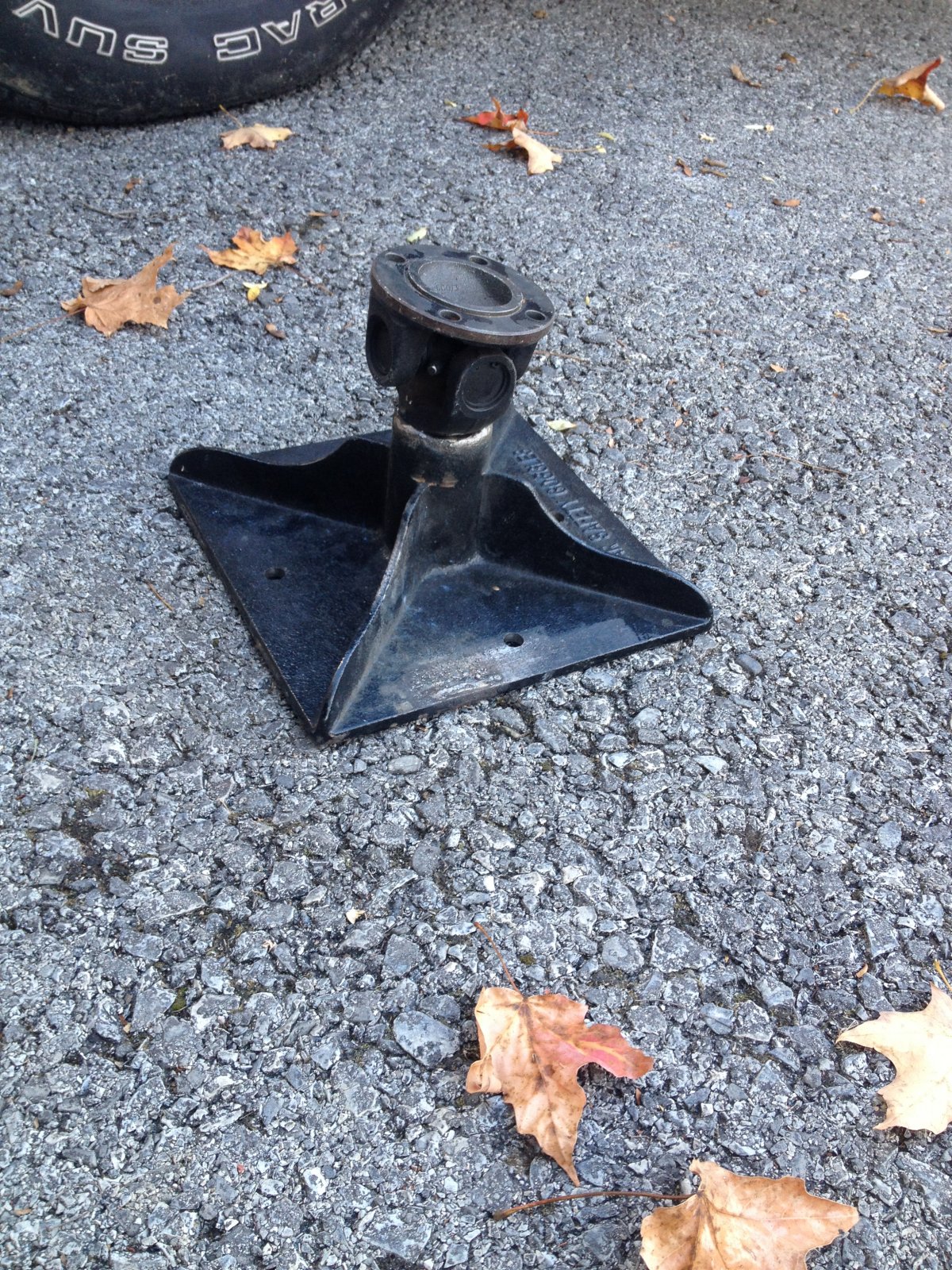

    So first thing was first. I had to cut down my pivot for seat mover height

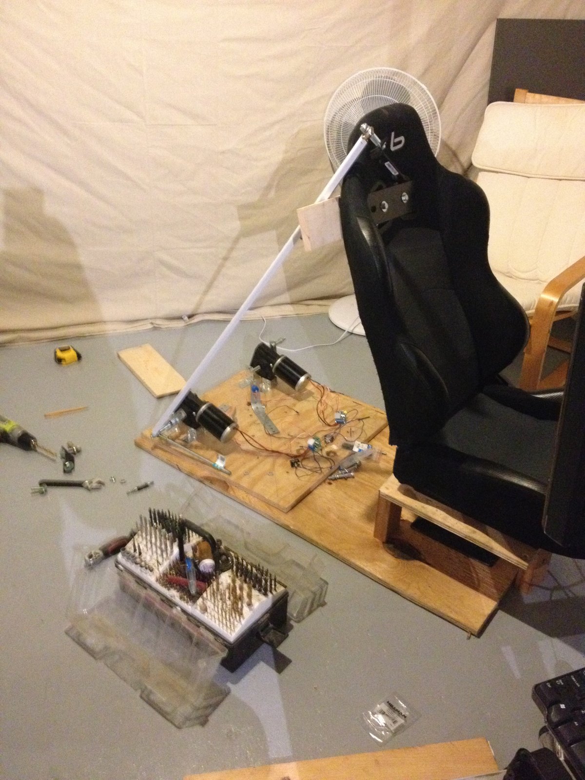

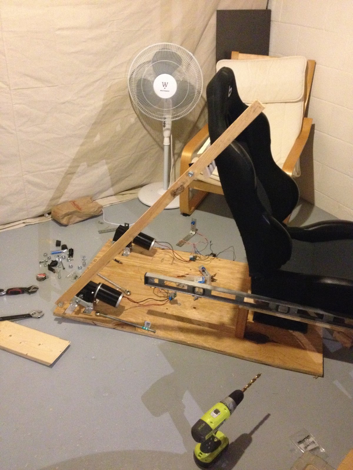

    Then I started mocking up with some wood.
    IMG_2040.JPG IMG_2041.JPG IMG_2042.JPG IMG_2043.JPG IMG_2044.JPG IMG_2045.JPG IMG_2046.JPG

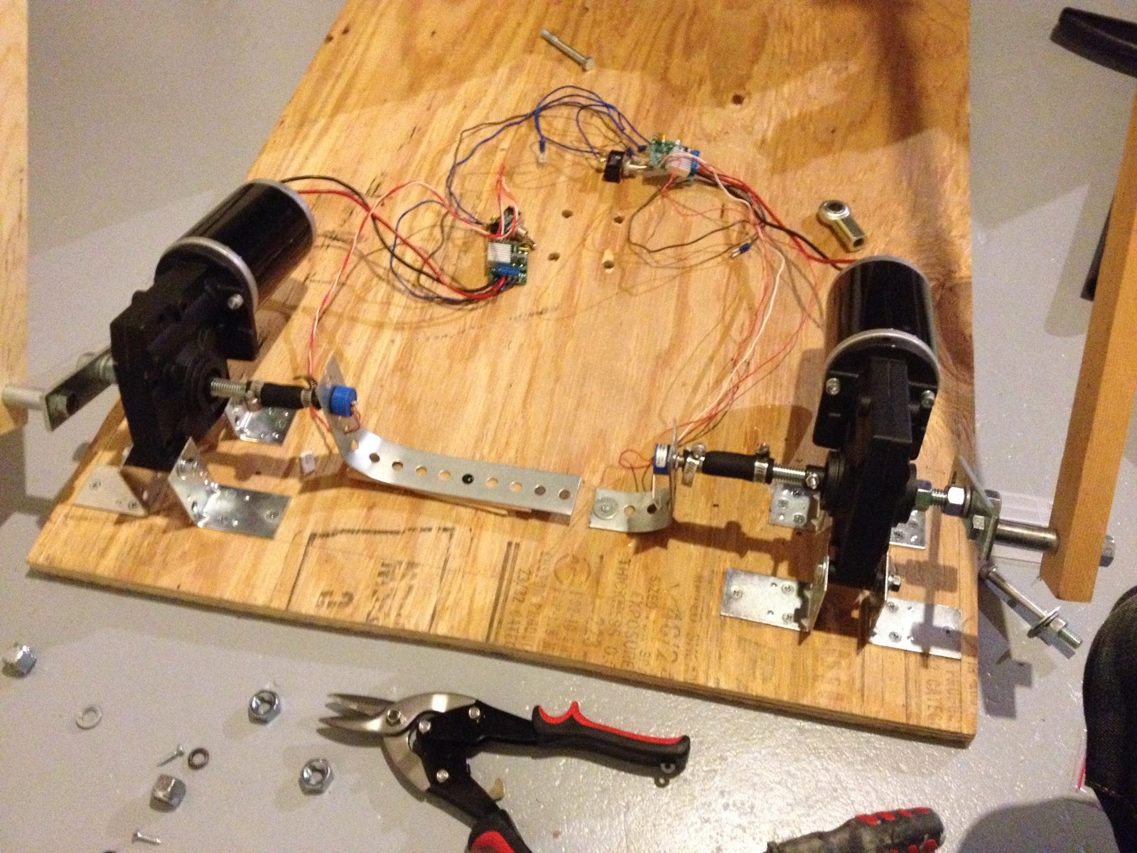

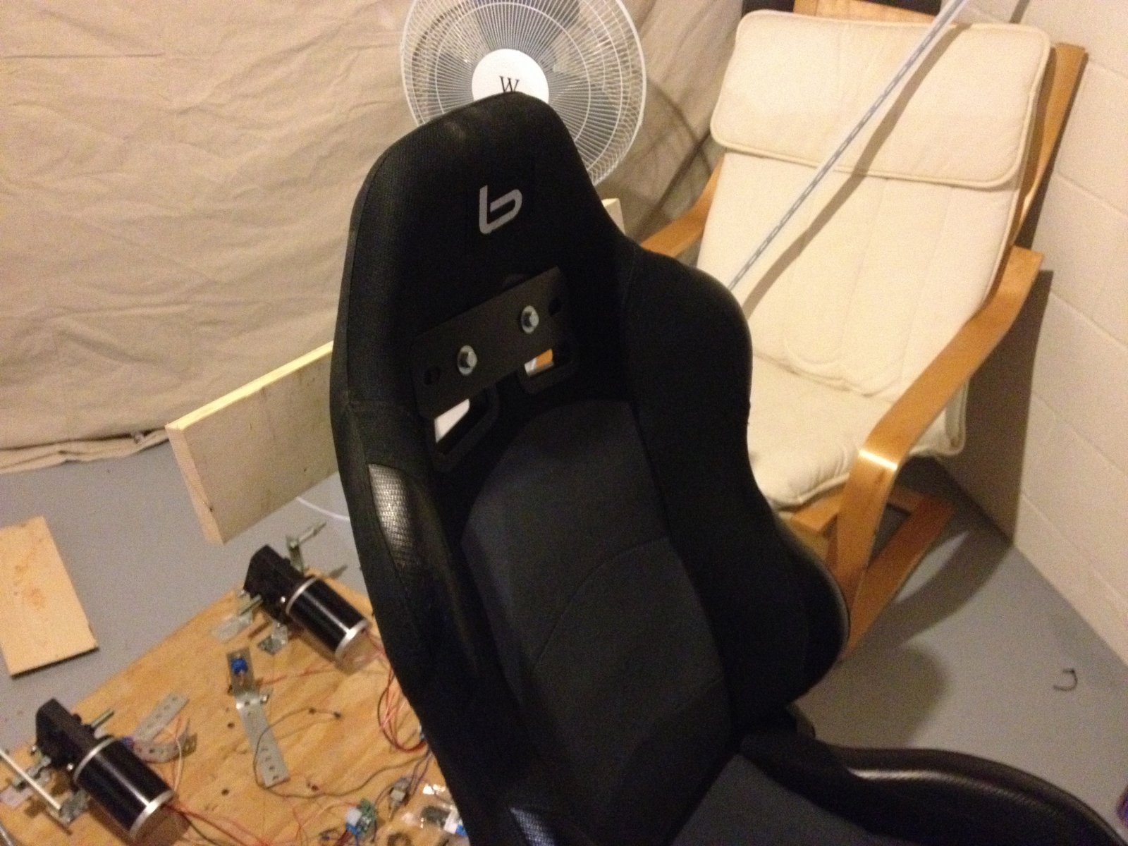

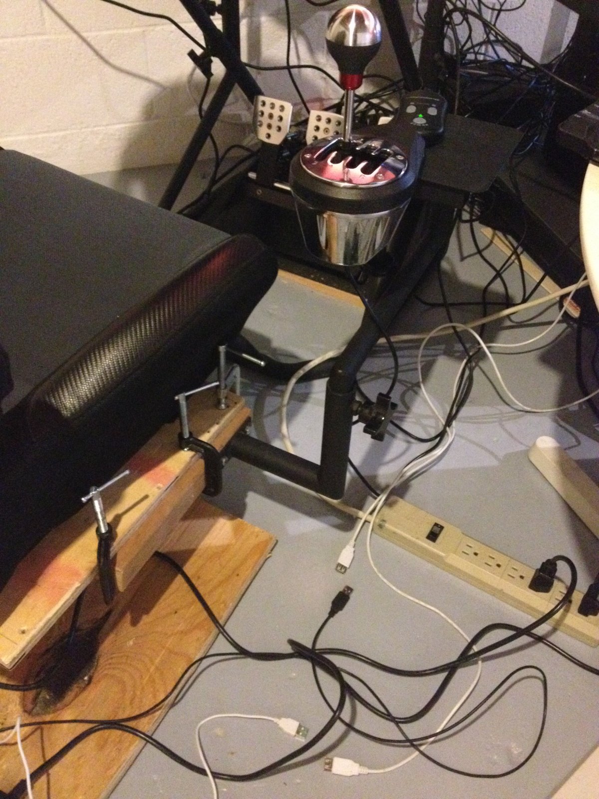

    At this point my wife has cut all spending on me so we are going to get creative for our prototype

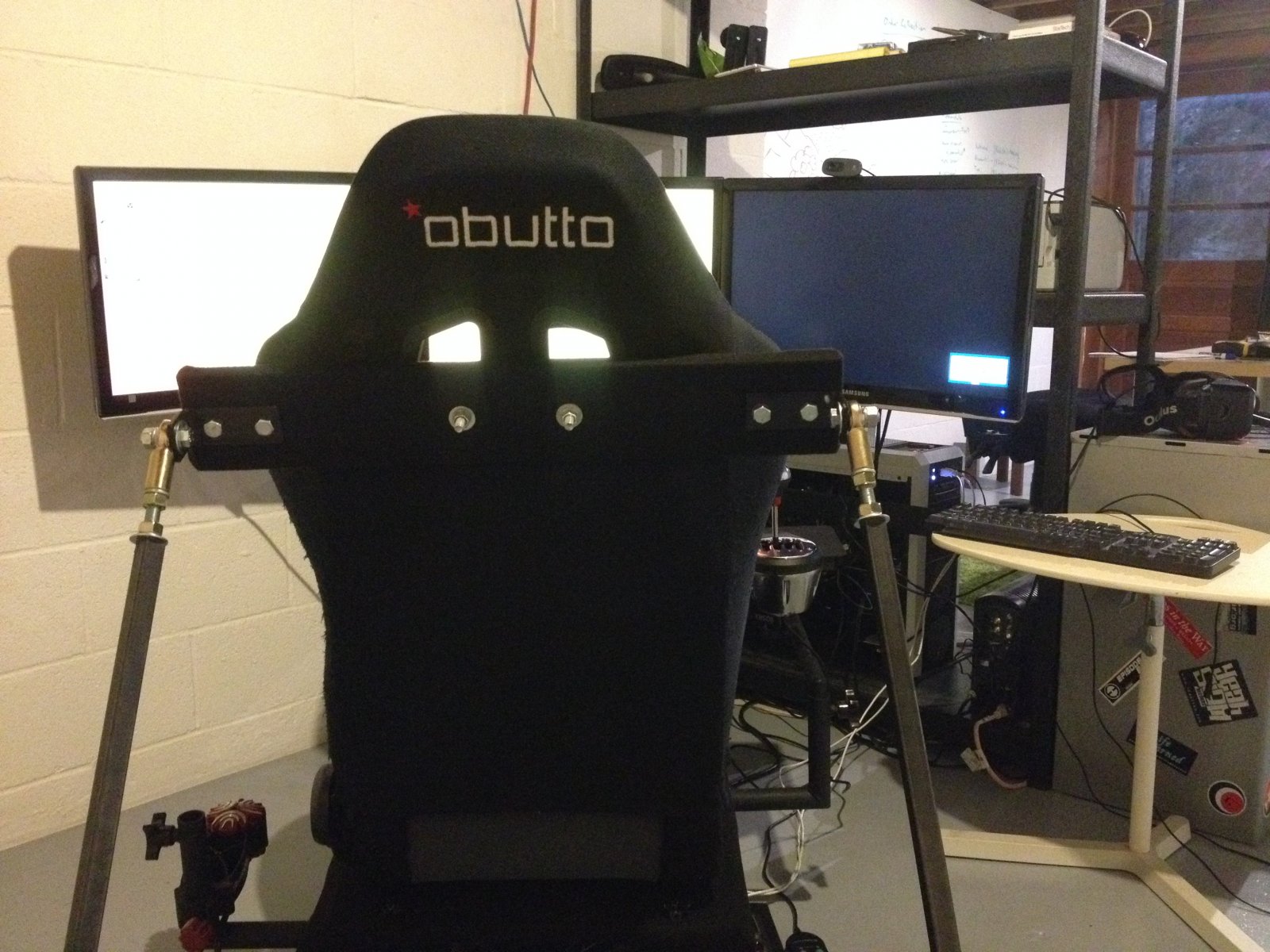

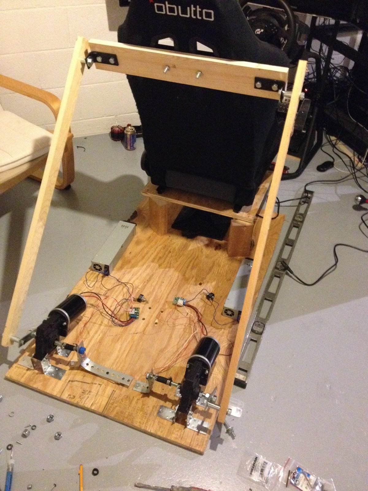

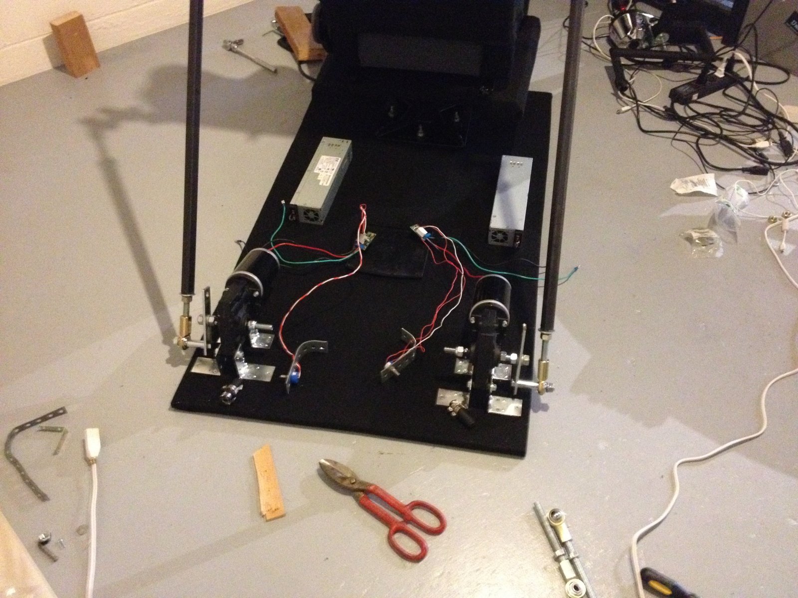

    Started mocking up my addons
    IMG_2063.JPG IMG_2064.JPG IMG_2065.JPG IMG_2066.JPG IMG_2068.JPG IMG_2069.JPG IMG_2070.JPG IMG_2071.JPG IMG_2072.JPG IMG_2073.JPG IMG_2074.JPG IMG_2075.JPG

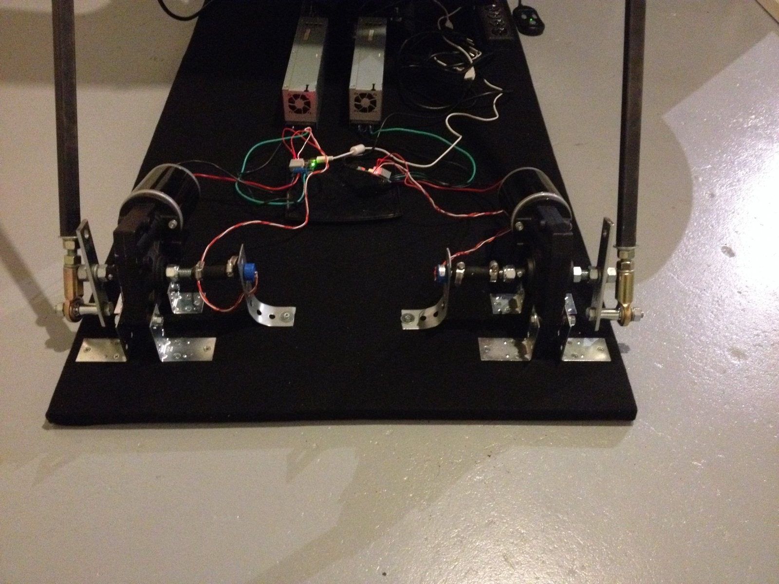

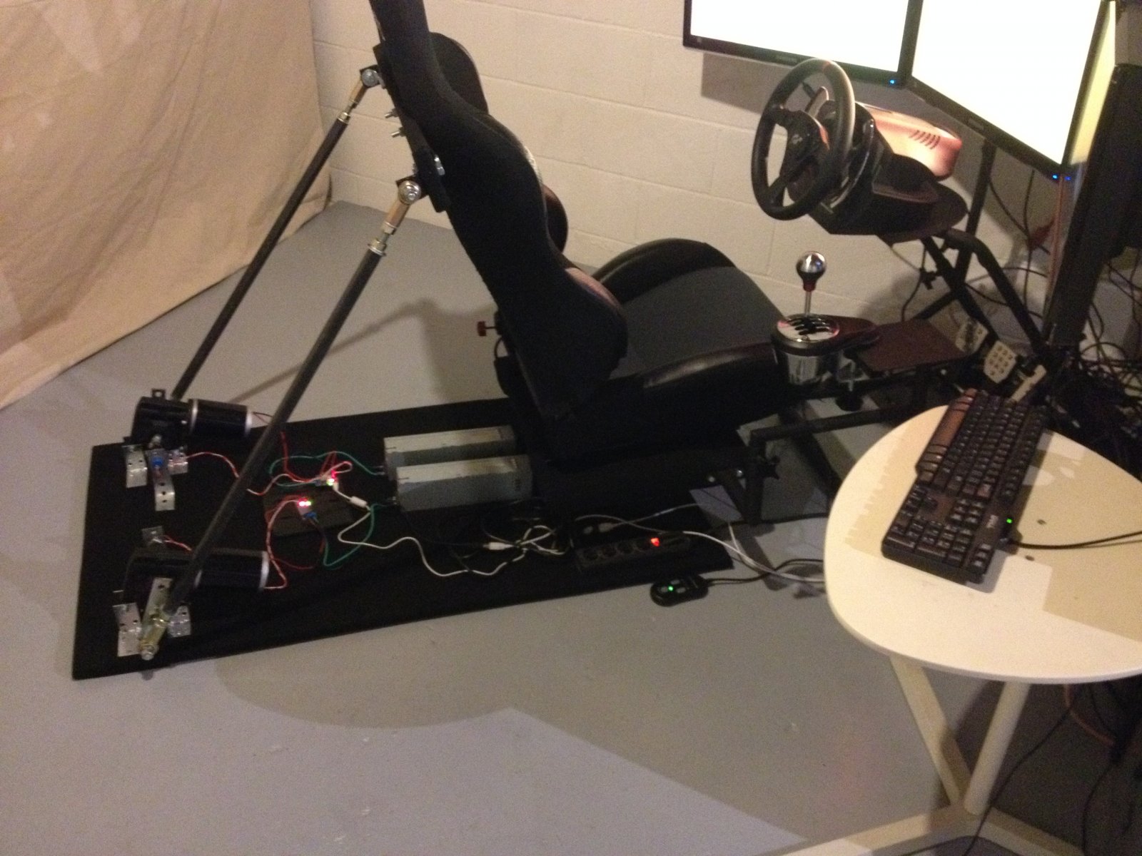

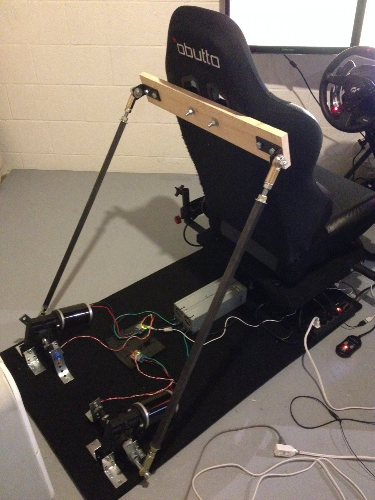

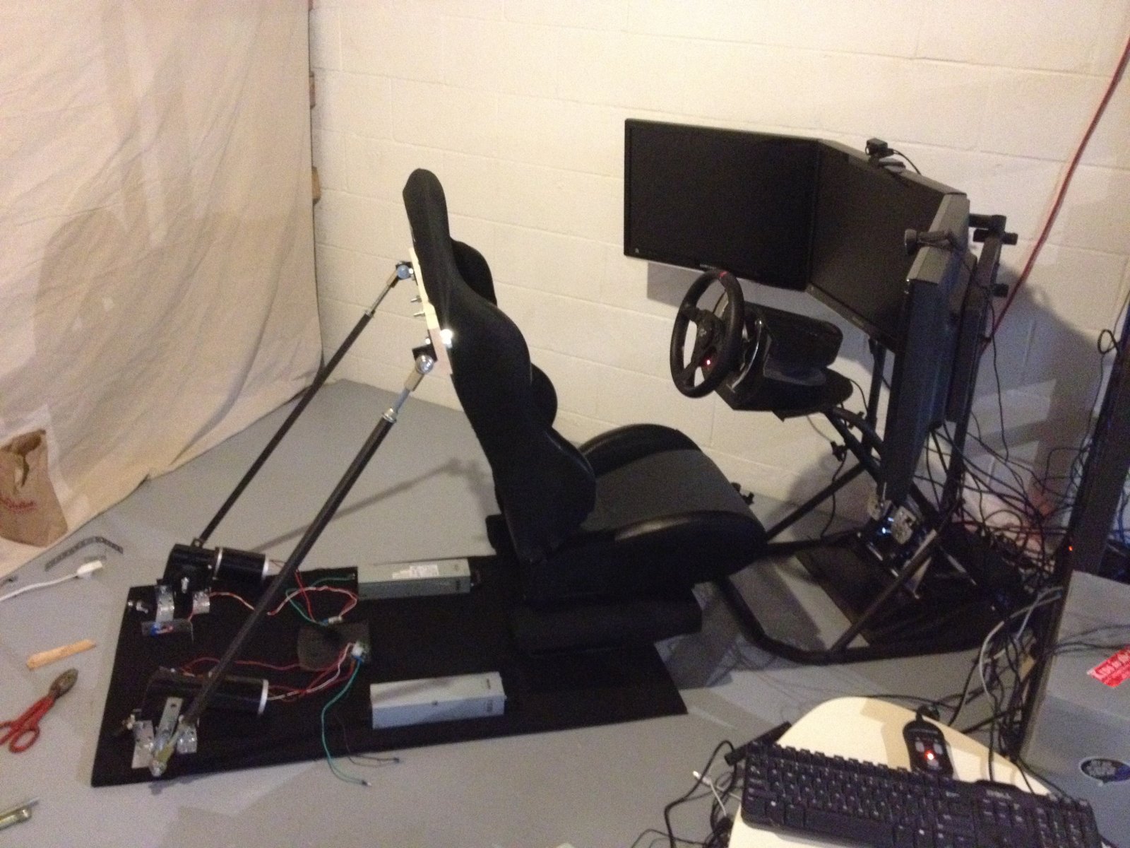

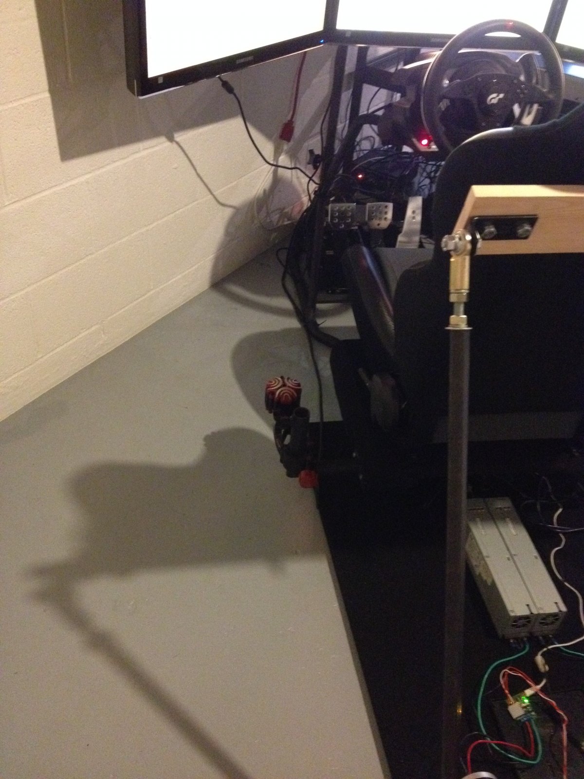

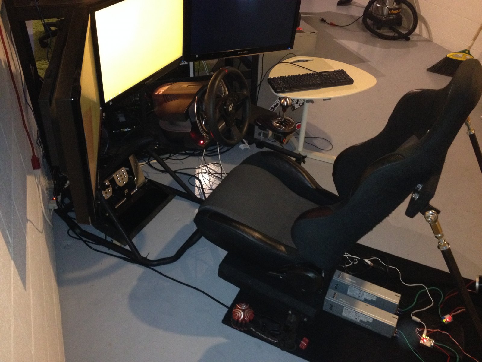

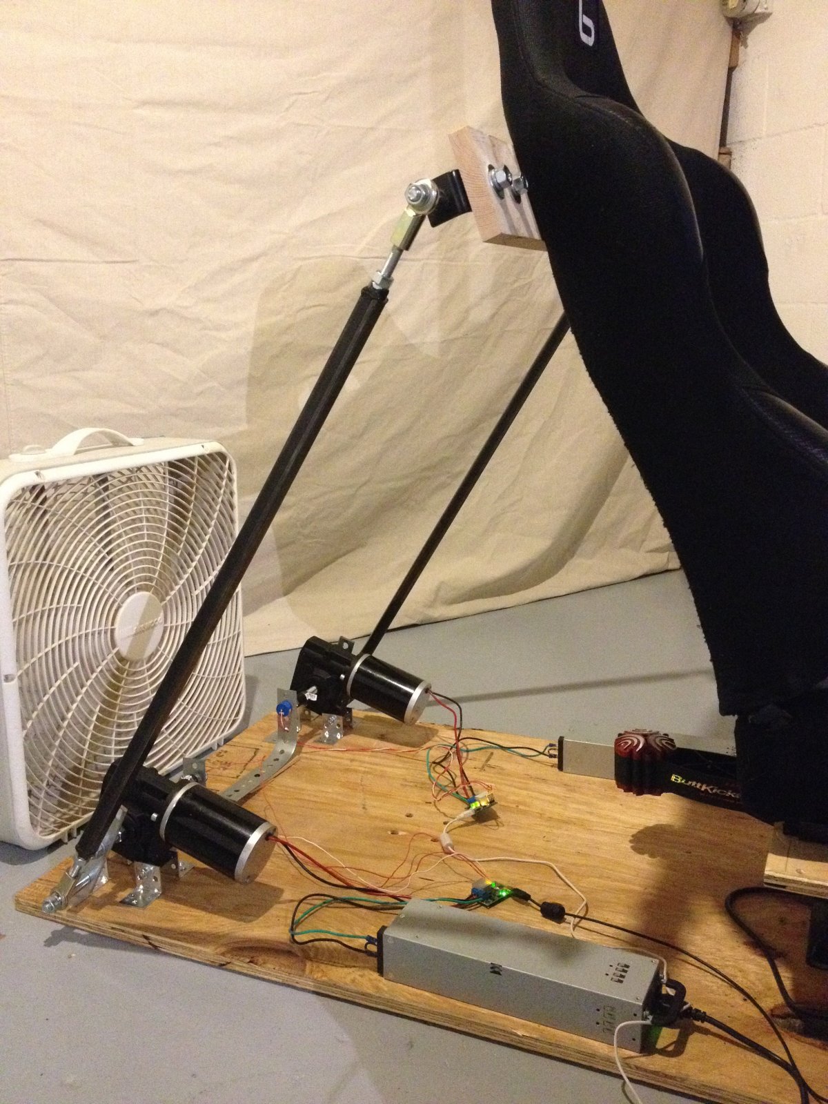

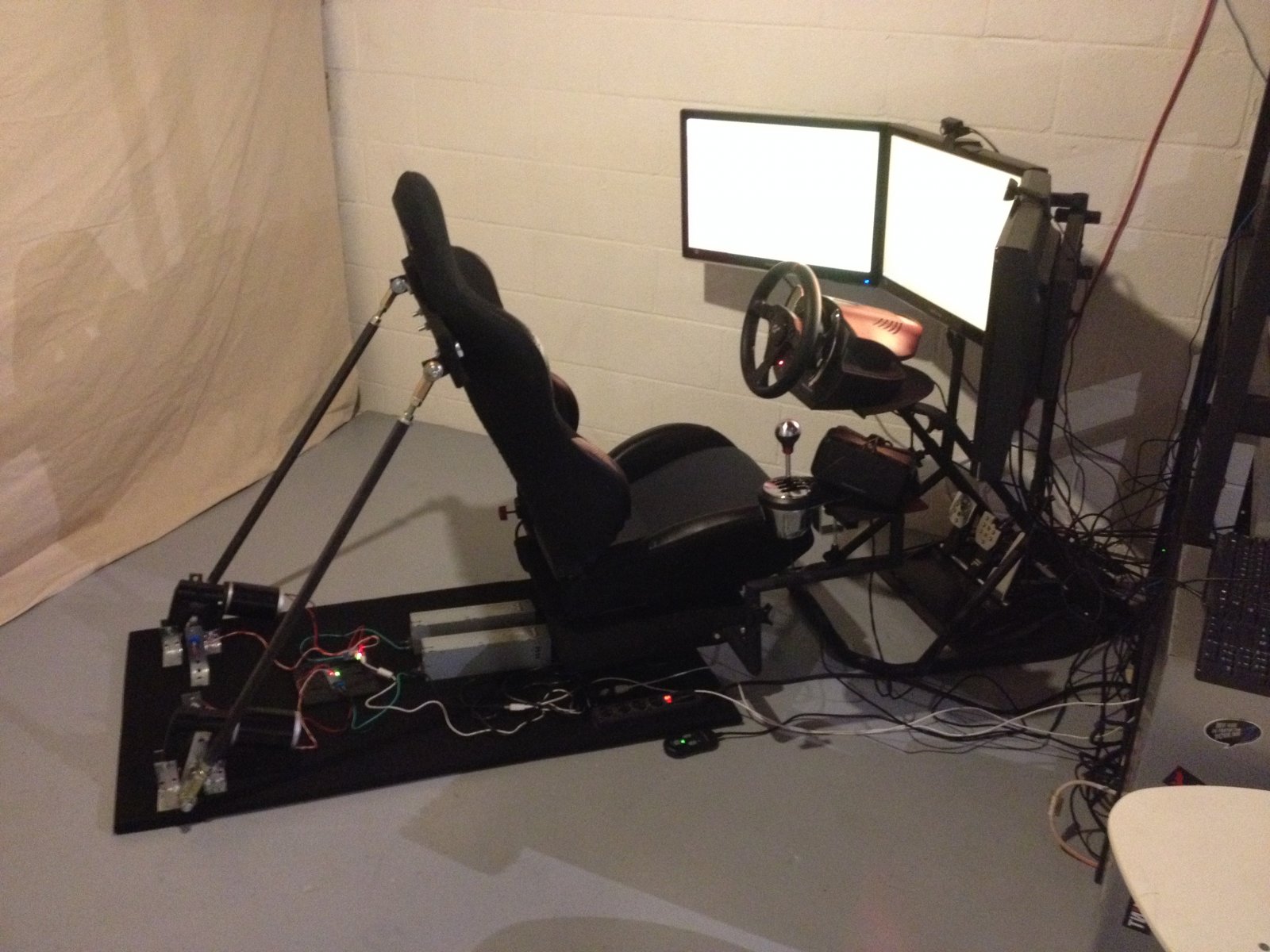

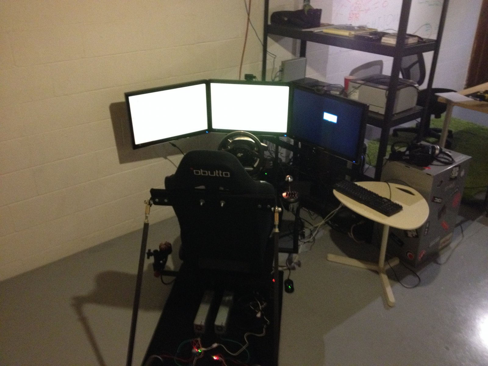

    And this is where I am now
    Now I'm waiting on mounting hardware so I can build an enclosure for the jrks/fans/and hide all the wires. For now I'm using a big box fan on turbo behind the unit to keep it nice and cool.
    This build so far has used all the parts from an Obutto Ozone except for the seat base. All shifter and keyboard mounts where used.
