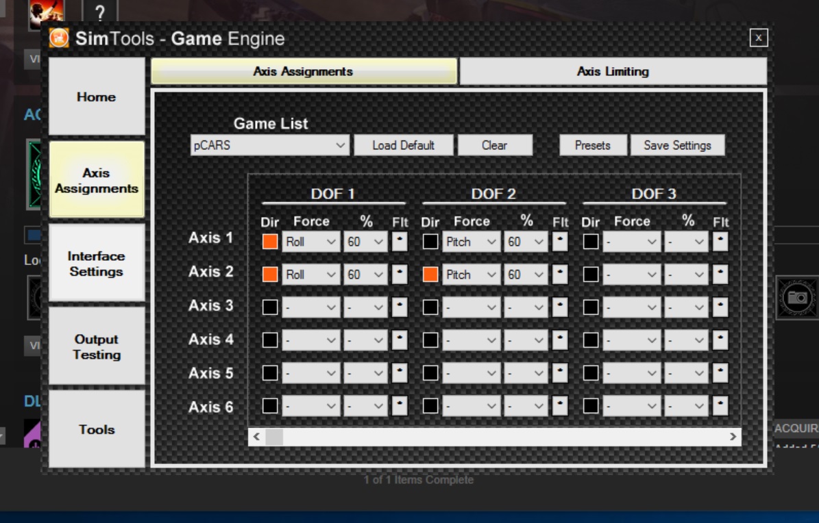

    On another note,
    Playing with PCars initially, the motions are backwards in the game but correct in the Game Engine using the mouse to control. Any thoughts?
    Also ONLY Pitch and Roll are working in the Game Enigine testing as well. I'm sure I am just missing something...

    Contact Pololu, they will likely give you a discount on the replacement JRK.
    Please post pictures of your settings.

    Pololu is working with me, I am sending images and files to them. We'll see.

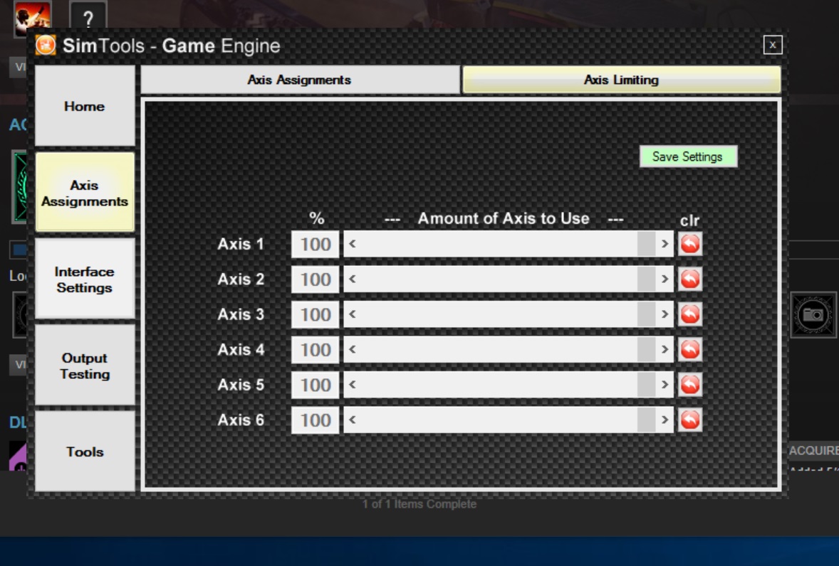

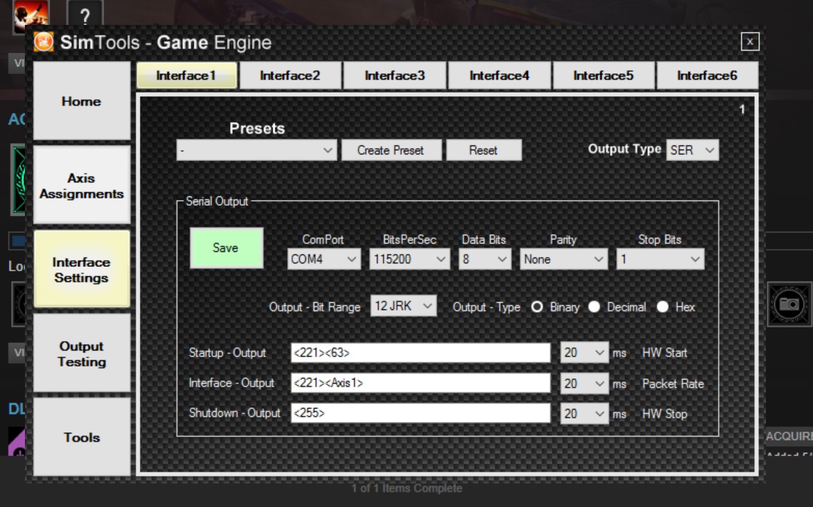

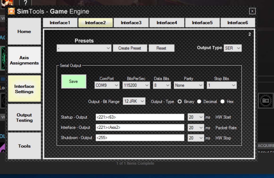

    Here are my current settings:
    Nothing on interface 2 through 6
    Axis Assaignments 2.jpg Axis Assaignments.jpg Interface Settings 1.jpg Interface Settings 2.jpg

    Also, I think I remember seeing a discussion about setting a break function on the rig when not in game? Currently when I exit the game the rig goes limp.
    Thanks guys!
  5. Nick Moxley
    17,057Coins
    +2,507 / 30 / -2
    Copy your Start up output Command to the Shut down Output command, Easy peezy then the rig will hold its Default (set in JRK utility) position.
    Next Start with ONE force at a time, Figure out which way they need to move, Manipulate the setting's a bit and you'll quickly figure out your faults.....PS Roll Axis DIR reversal is a hint. If you cant get it by all means a Skype chat could be arranged to talk you through it in more detail.

    Again, It is going the correct direction when using the slider, just both backwards in the game?

    I'm sure I'm doing something stupid.... Brain fairly fried for awhile lol....
    This look better now?
  8. Nick Moxley
    17,057Coins
    +2,507 / 30 / -2
    Winner Winner, Chicken dinner. :thumbs:thumbs

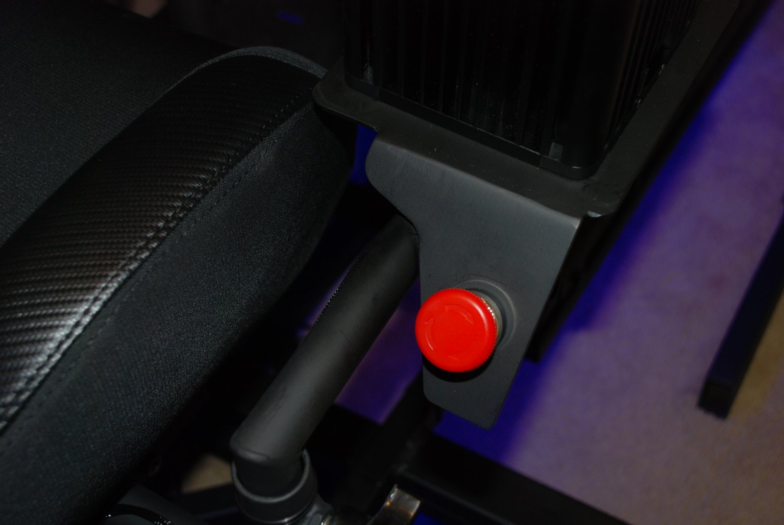

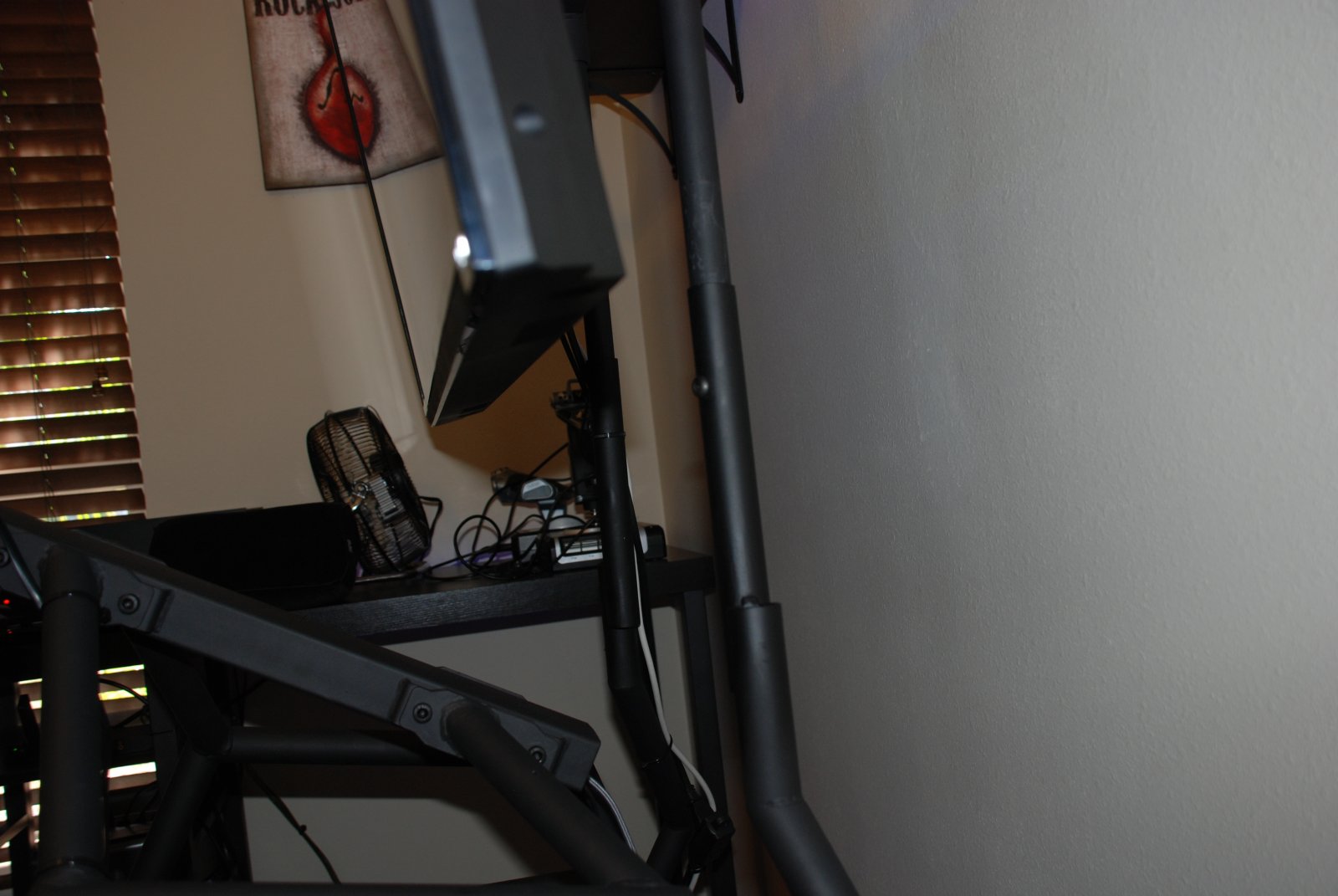

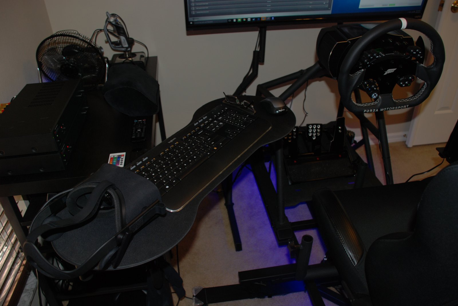

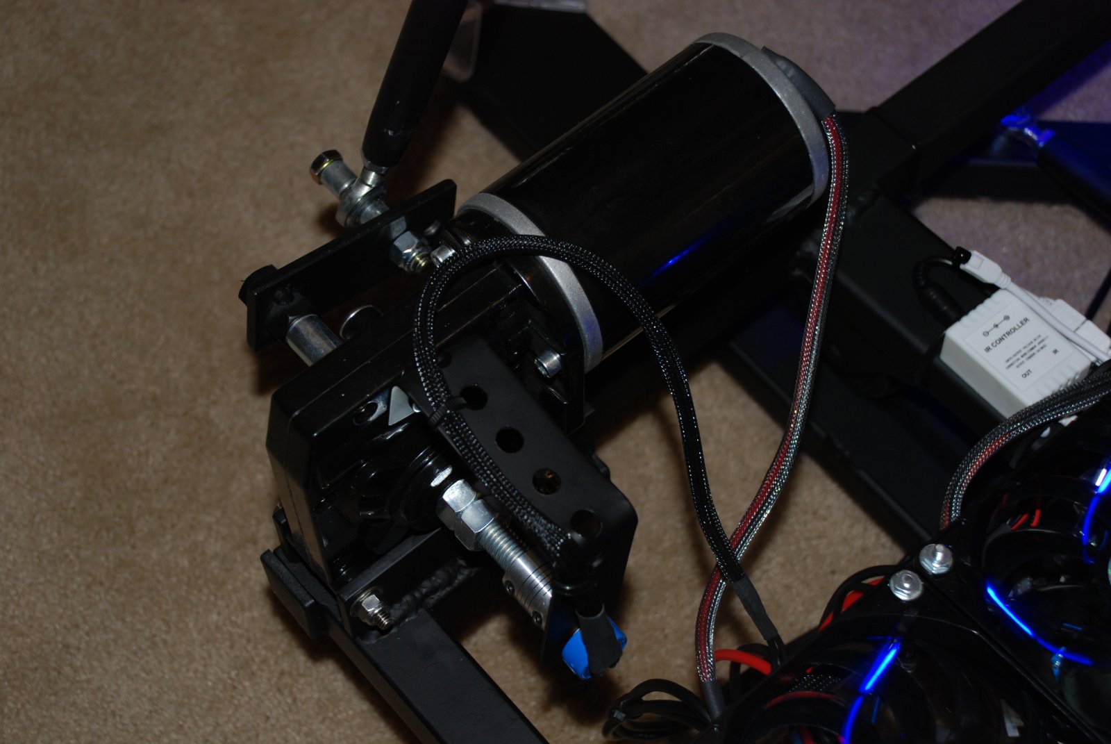

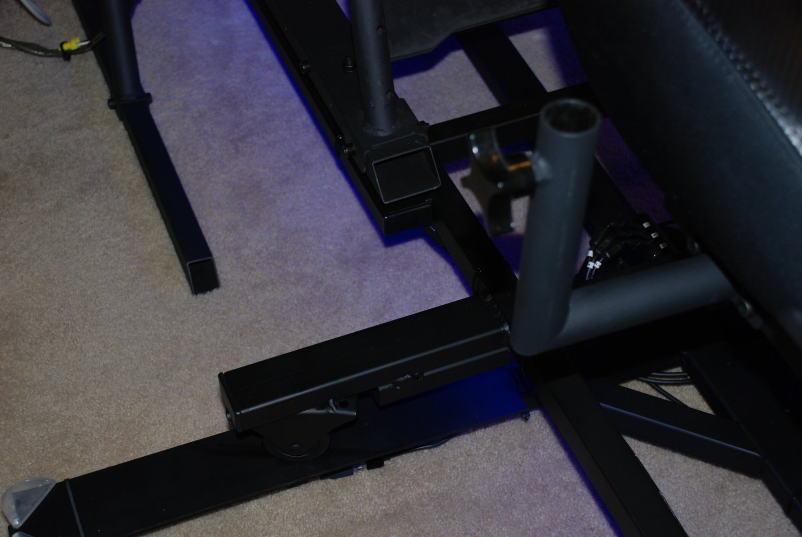

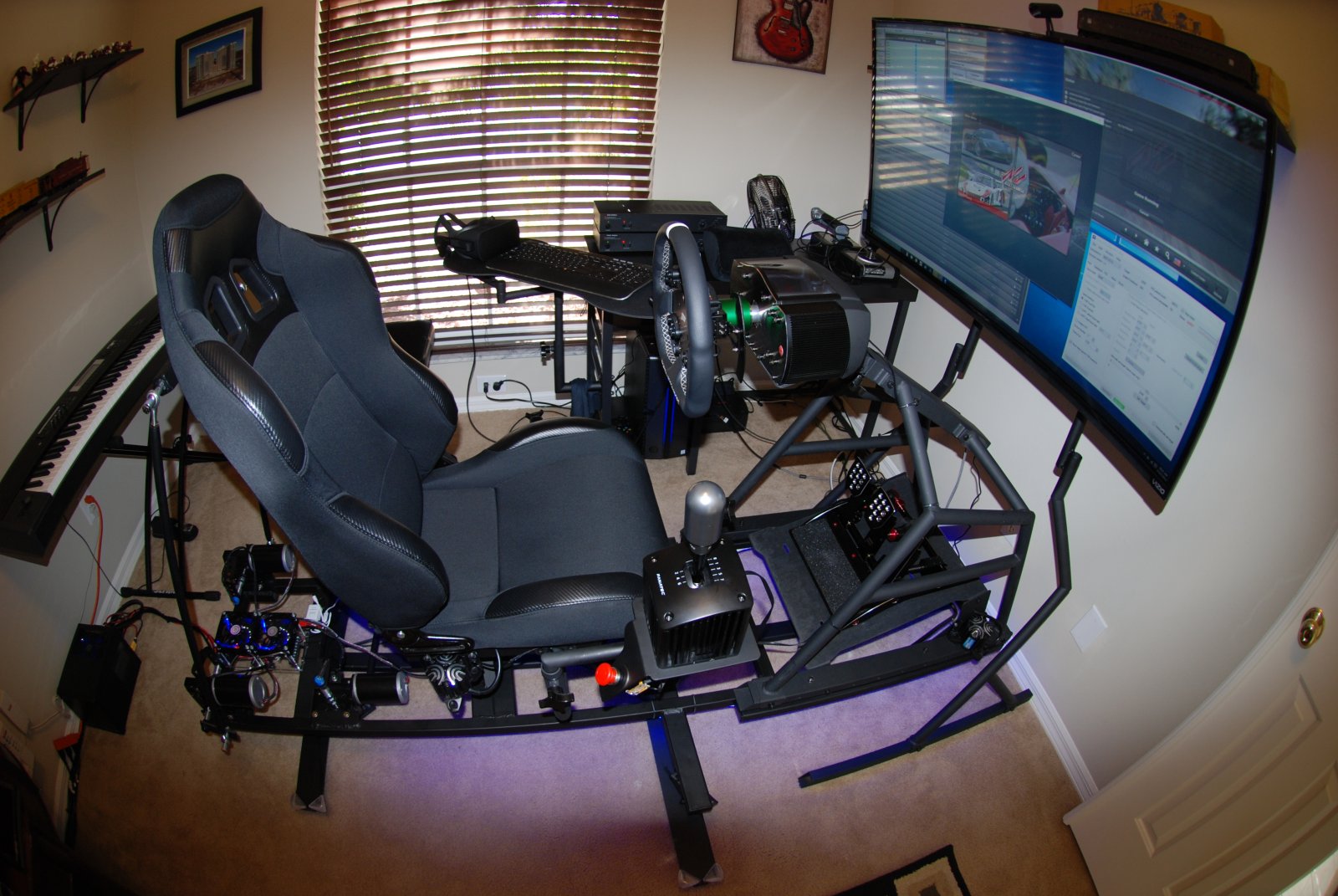

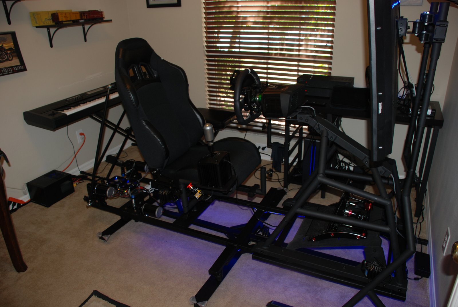

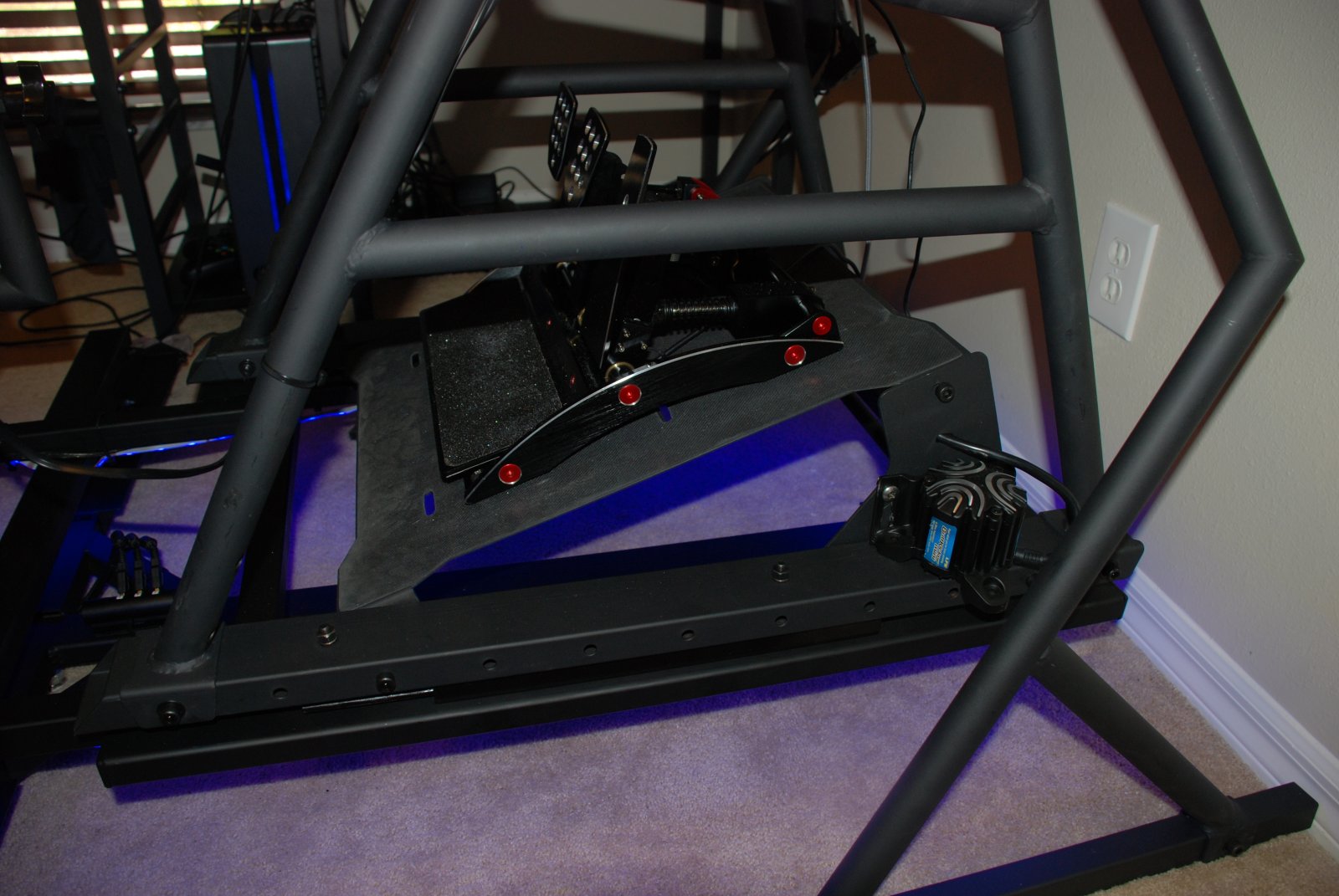

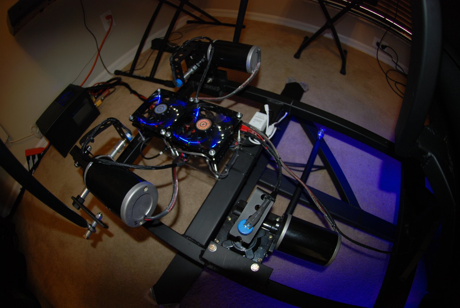

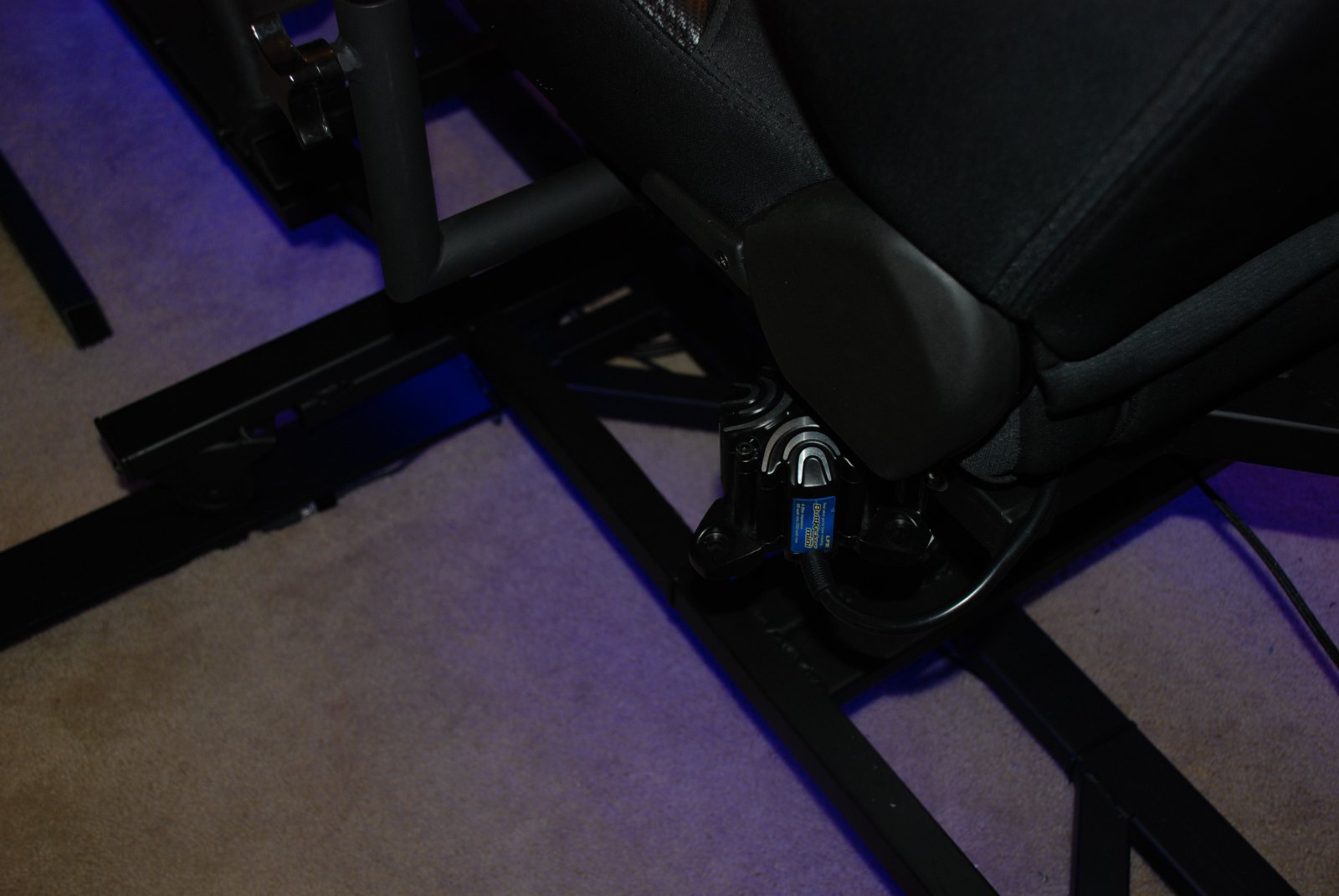

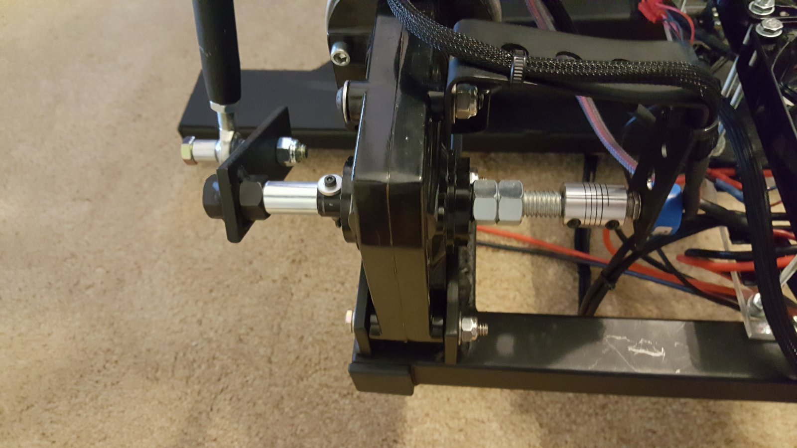

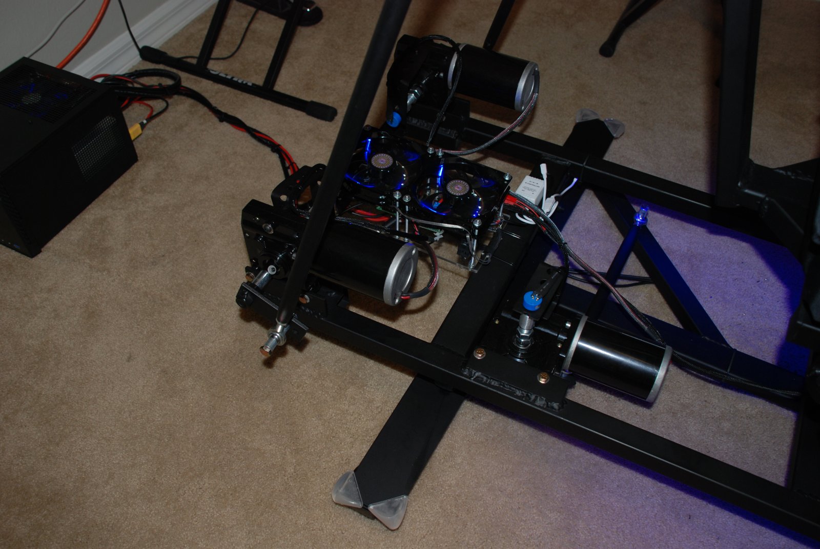

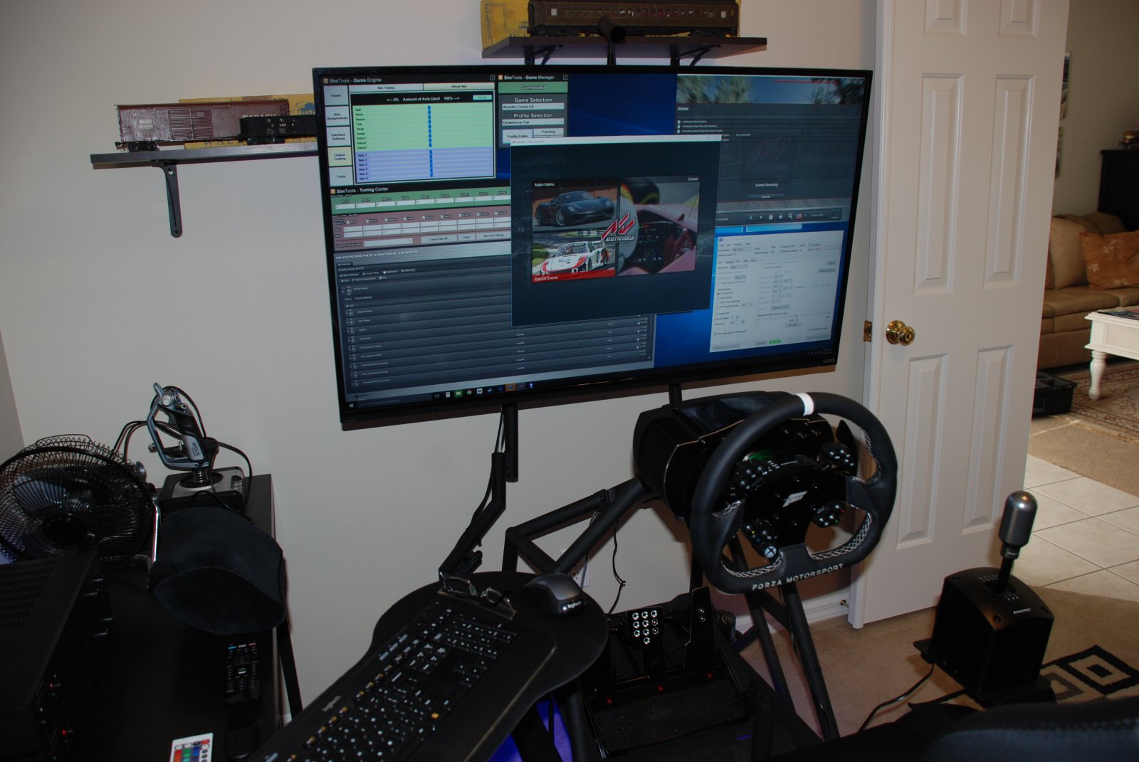

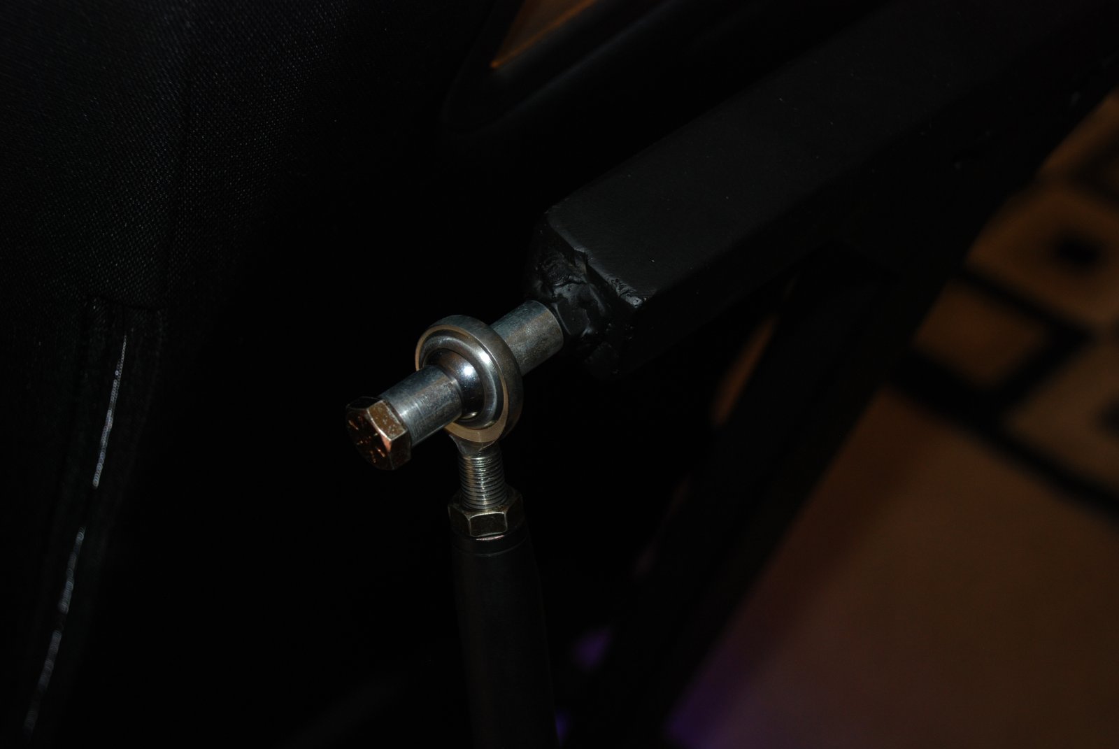

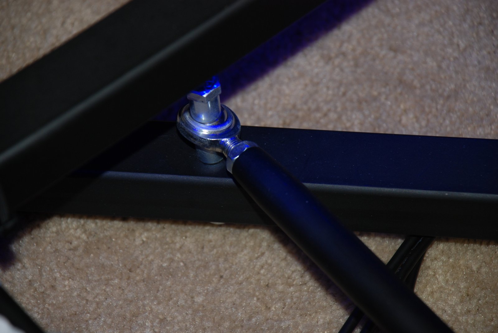

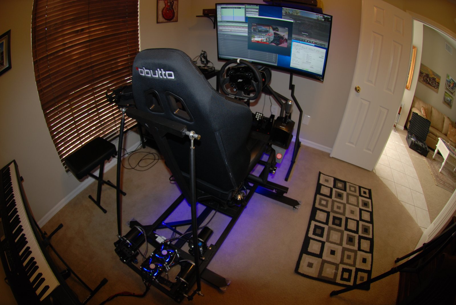

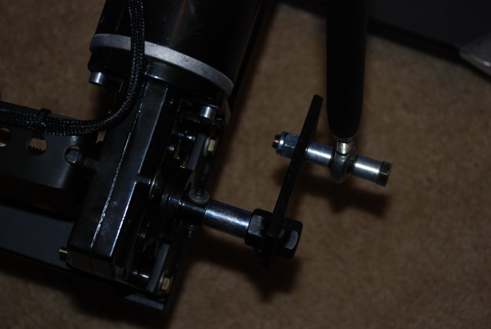

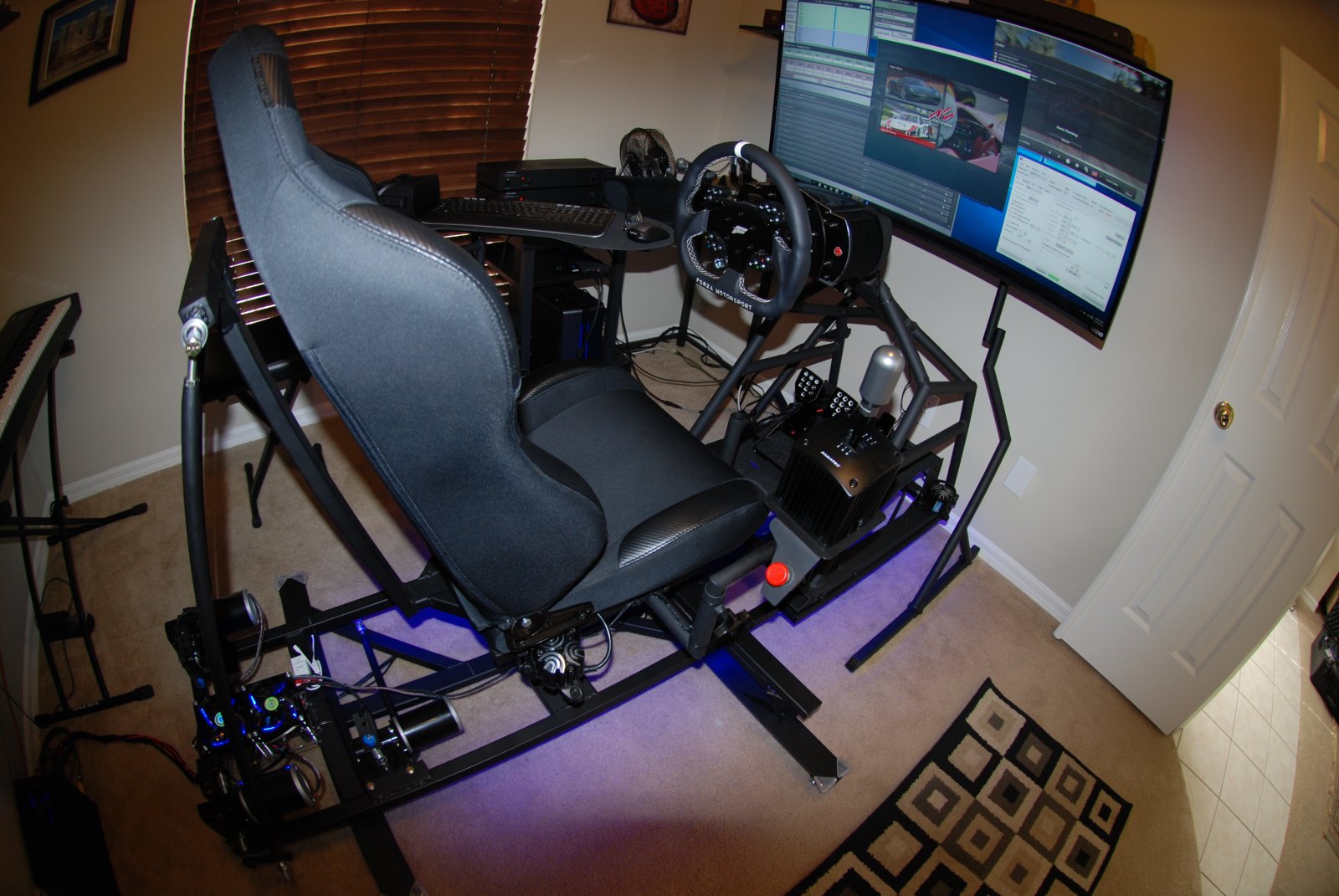

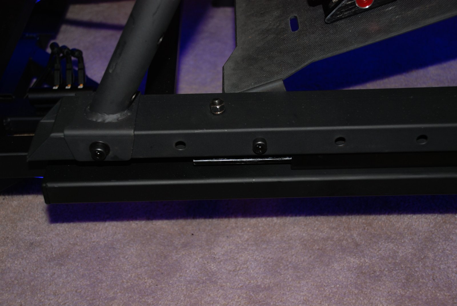

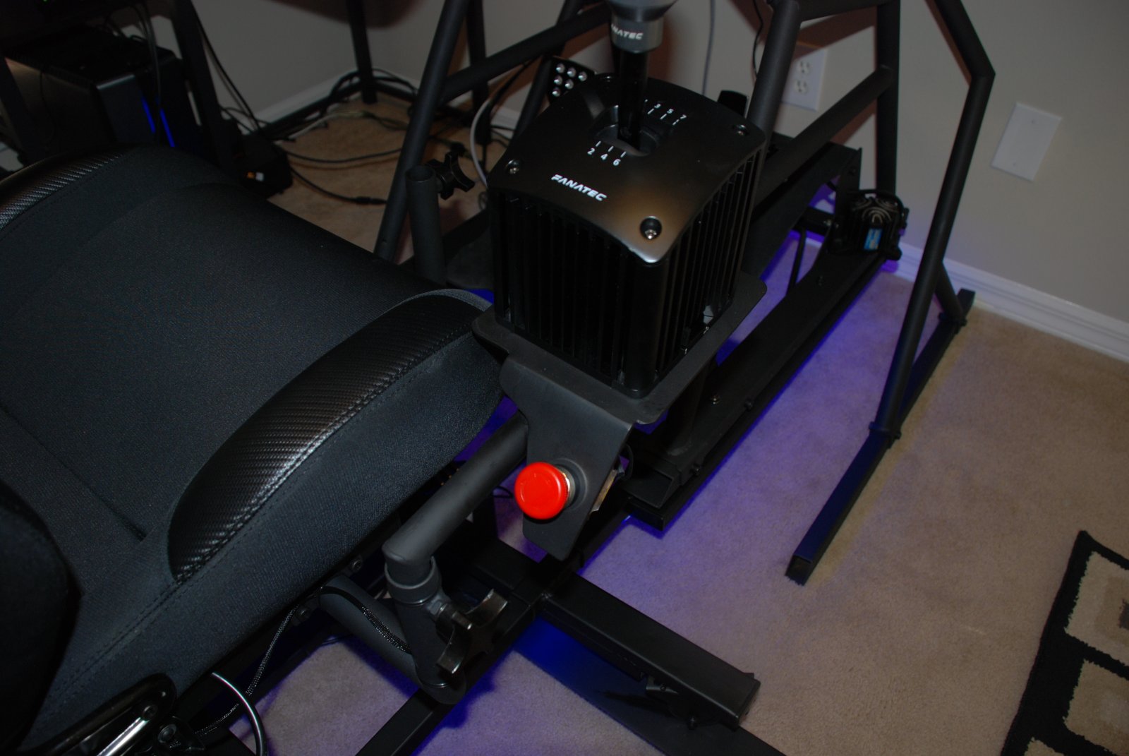

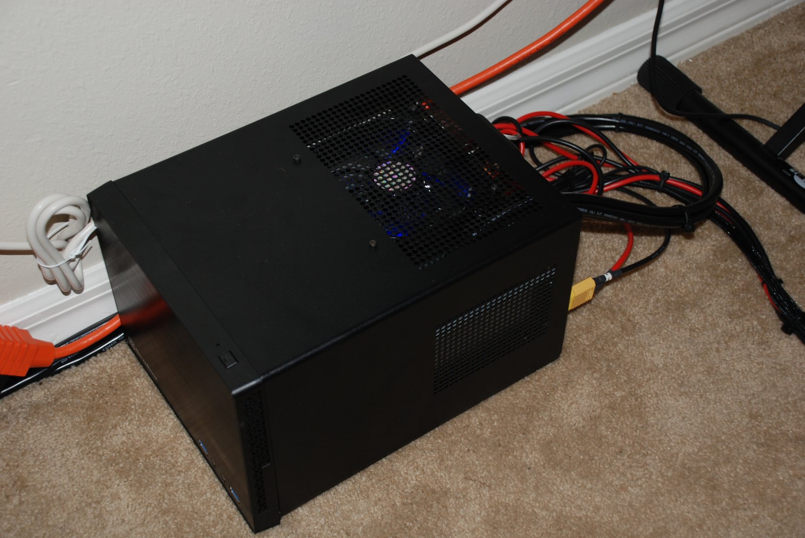

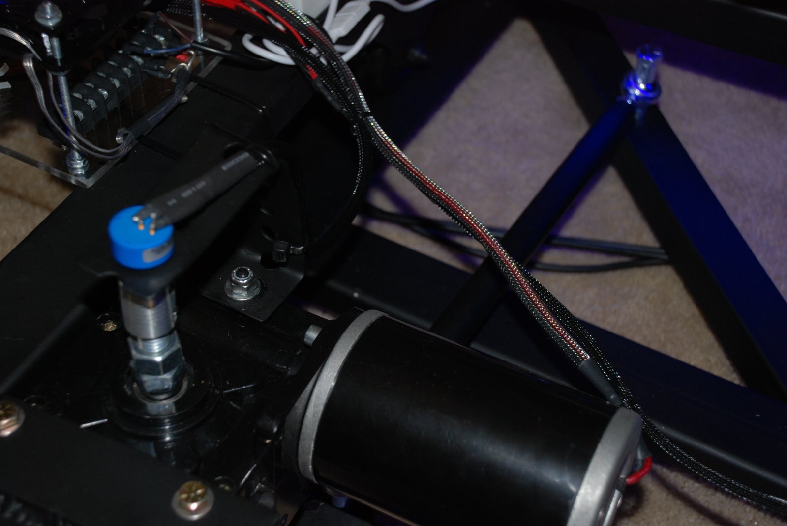

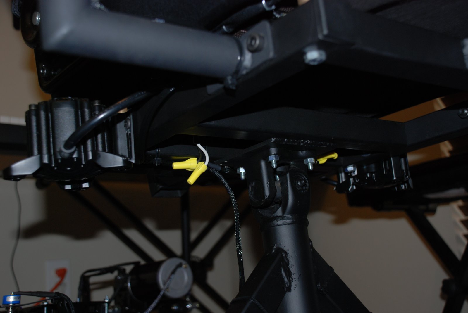

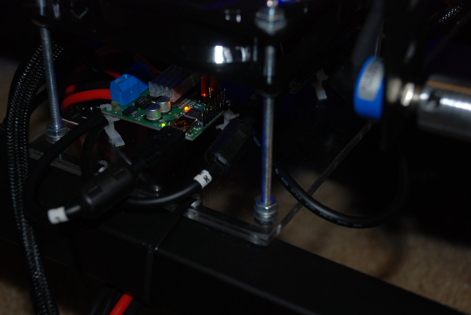

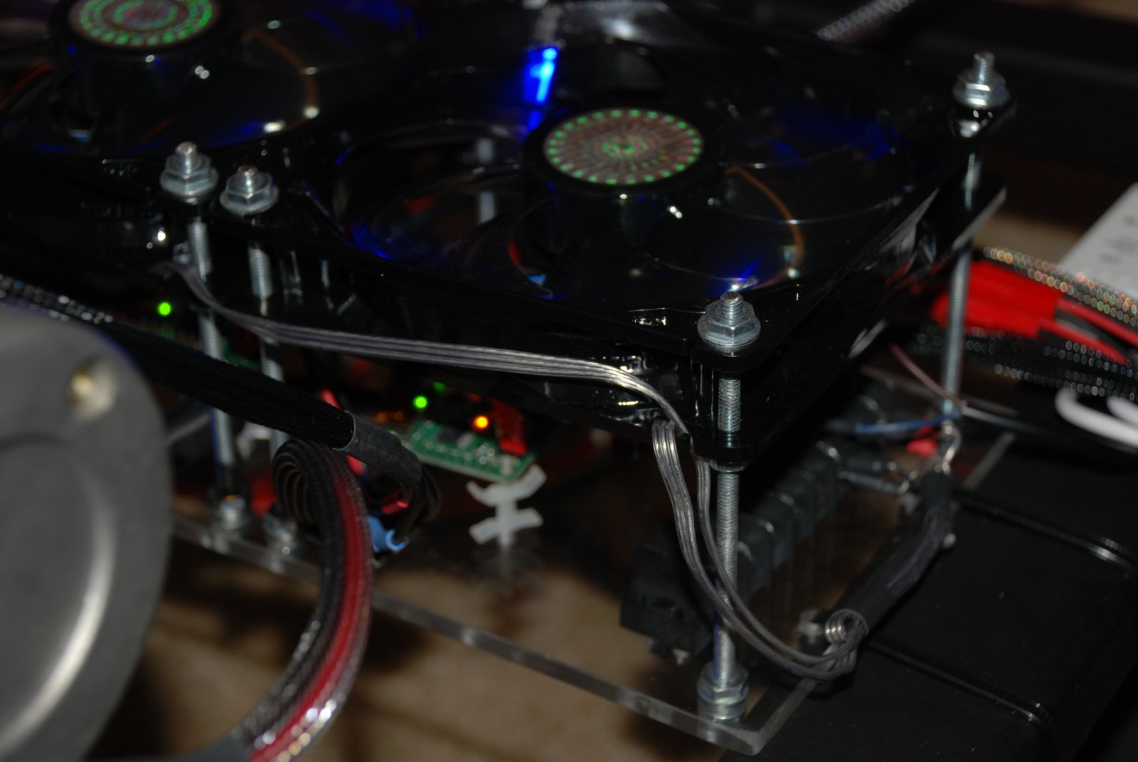

    Here is an update to my Project
    Everything is working great, Nick has been an amazing help taking the time to help me learn.
    I have about 10 hours running the sim with ZERO issues thus far.
    I have been learning how to tweek and getting everything dialed in as I see fit.
    Here are a few pictures of the "finished" product.... yeah right :)
    Still have to receive and install the diamond plate for the floor and add some bracing on the seat (lots of flex, losing fidelity)
    And lastly a YouTube link of me driving the x2010 at Nords lol...
    DSC_0410.JPG DSC_0411.JPG DSC_0412.JPG DSC_0413.JPG DSC_0414.JPG DSC_0415.JPG DSC_0416.JPG DSC_0417.JPG DSC_0418.JPG DSC_0419.JPG DSC_0420.JPG DSC_0421.JPG DSC_0422.JPG DSC_0423.JPG DSC_0424.JPG DSC_0425.JPG DSC_0426.JPG DSC_0427.JPG DSC_0428.JPG DSC_0429.JPG DSC_0432.JPG DSC_0433.JPG DSC_0434.JPG DSC_0435.JPG DSC_0436.JPG

    Great fidelity of movement, looks like you have those profiles dialed in very well. Congrats!

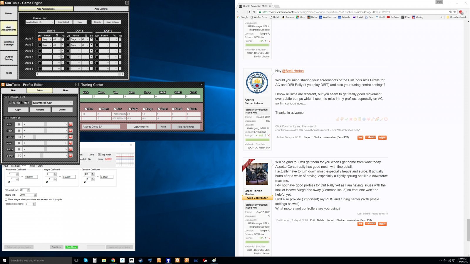

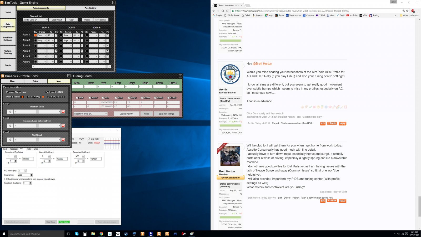

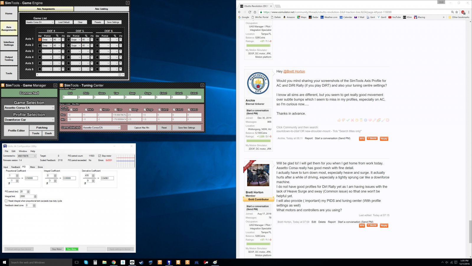

    Hey @Brett Horton
    Would you mind sharing your screenshots of the SimTools Axis Profile for AC and DiRt Rally (if you play DiRT) and also your tuning centre settings?
    I know all sims are different, but you seem to get really good movement over subtle bumps which I seem to miss in my profiles, especially on AC, so I'm curious now.....
    Thanks in advance.
  14. Brett Horton
    Brett Horton Active Member
    Aug 18, 2016
    310
    Program Manager / Pilot
    Tampa FL
    118Coins
    +202 / 2 / -0
    Will be glad to! I will get them for you when I get home from work today.
    Assetto Corsa really has good mesh with fine detail.
    I actually have to turn down most, especially heave and surge. It actually hurts after a while of driving, especially a tightly sprung car like a downforce machine.
    I do not have good profiles for Dirt Rally yet as I am having issues with the lack of Heave Surge and sway (Common issue) so tthat one won't be helpful yet.
    I will also provide ( important) my PIDS and tuning center (With profile settings as well)
    What motors and controllers are you using?

    Here ya go!

    We have identical kit from your build thread. I have the 50:1 gearboxes but the same motors. Also using JRK's but coupled to some HP Server PSU, which I think are 48Amp a piece from memory. Yeah - PiDs and motor acceleration screens would be awesome. Thanks heaps.

    Probably the biggest difference is the 50:1 you are running.... More torque but slower

    PID's are there in the pictures, Motors I will get shortly
