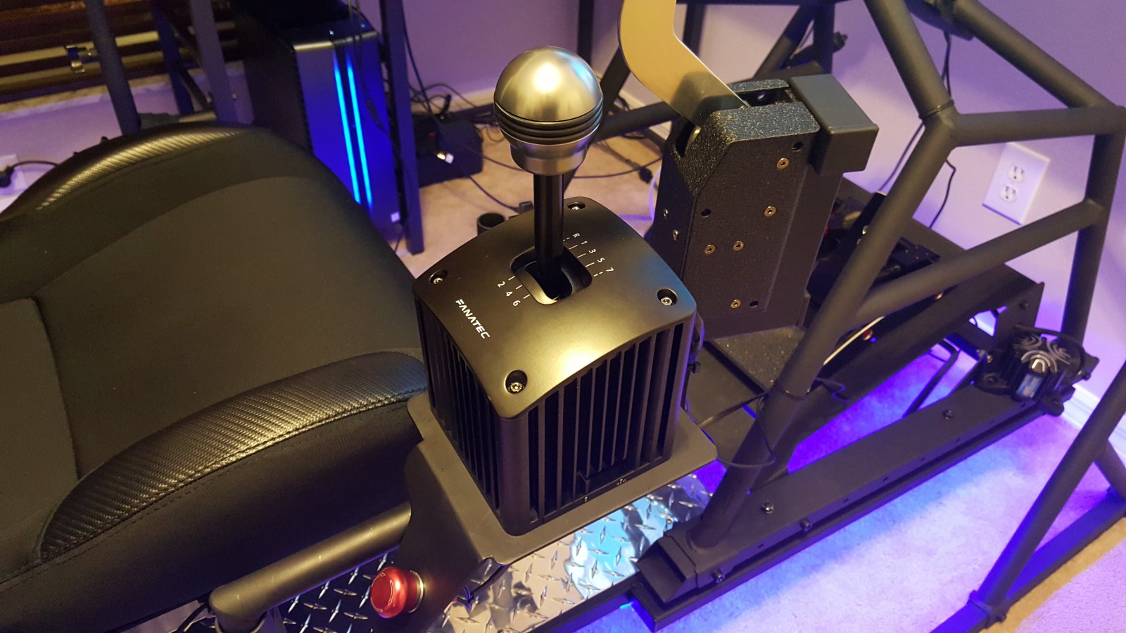

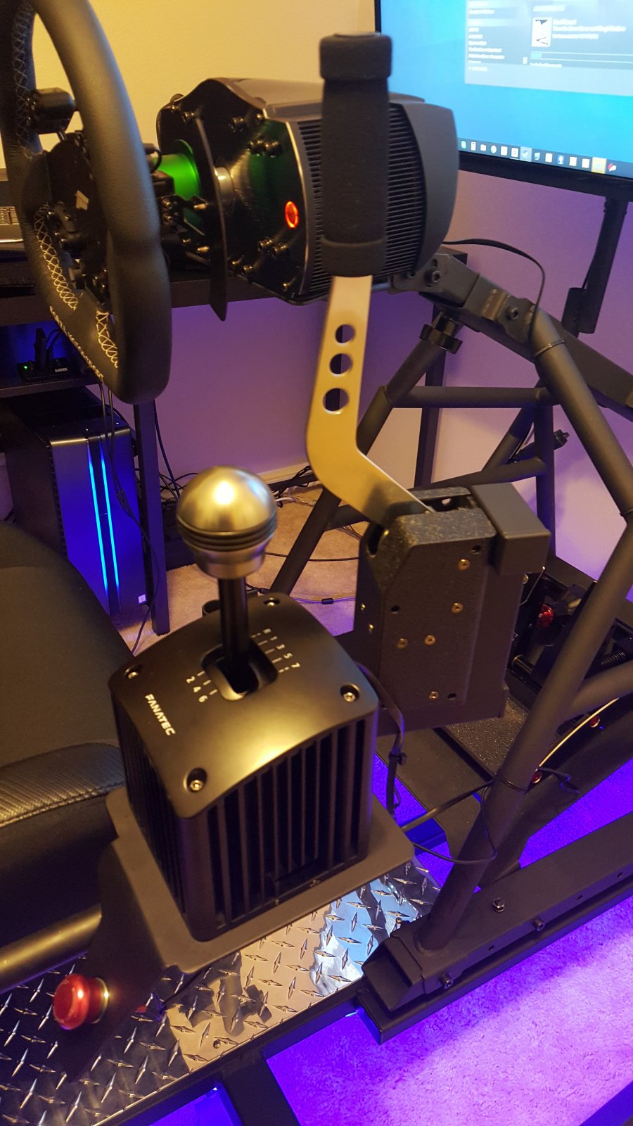

    Handbreak installed and working....
    Now if I can get DIRT RALLY working in motion....

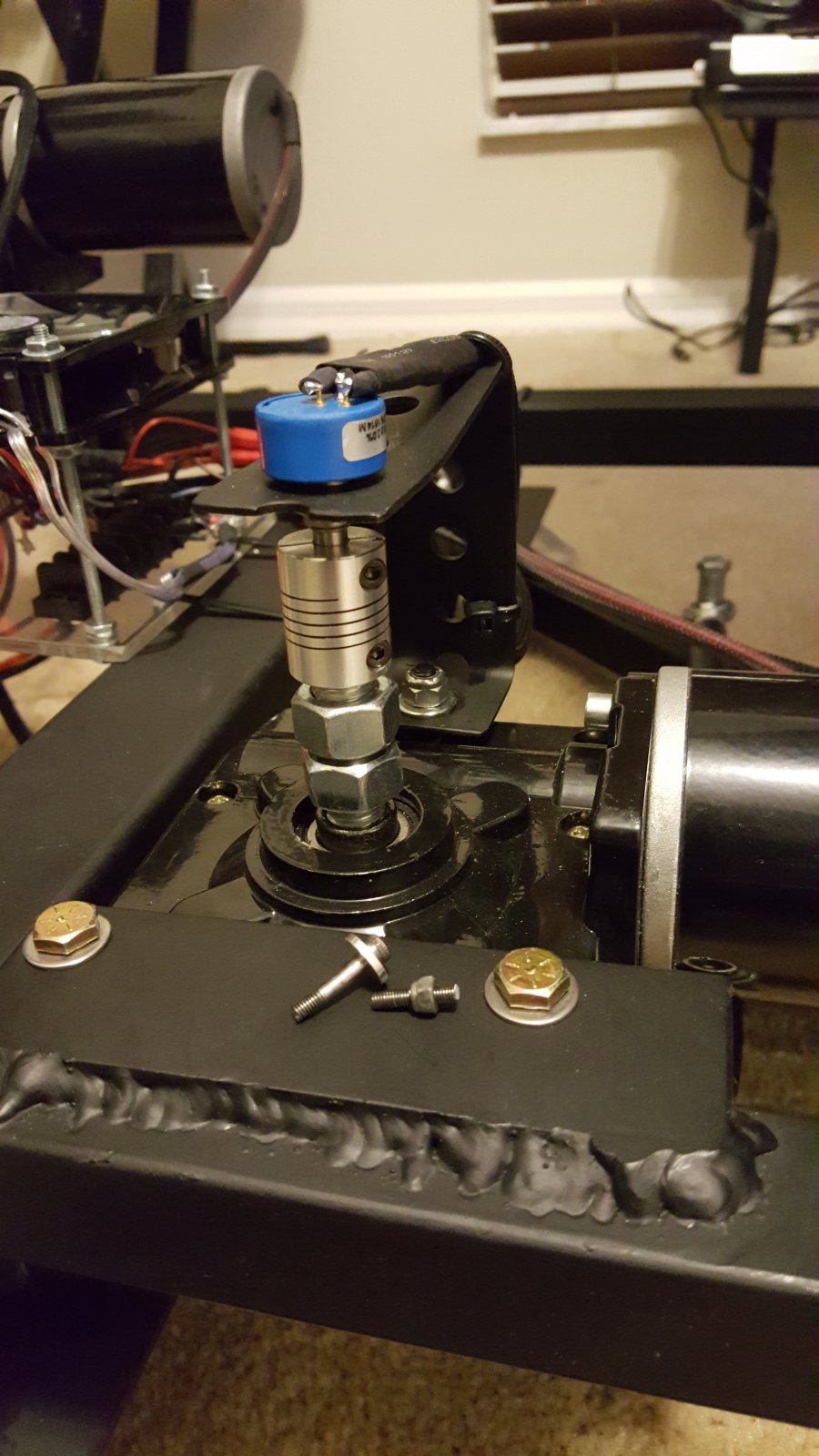

    First failure tonight after about 15 hours. Traction loss nuts came loose then snapped the M3 bolt. Will be going to an M4 (M3 all I had at the time) Tons of stress on traction loss.
    No damage, motor was just spinning while the pot and shaft sat there.
    21,717
    151,937Coins
    +11,061 / 56 / -2
    Glad nothing got damaged.
    It goes to show just how significant the forces involved are, it always pays to over engineer.

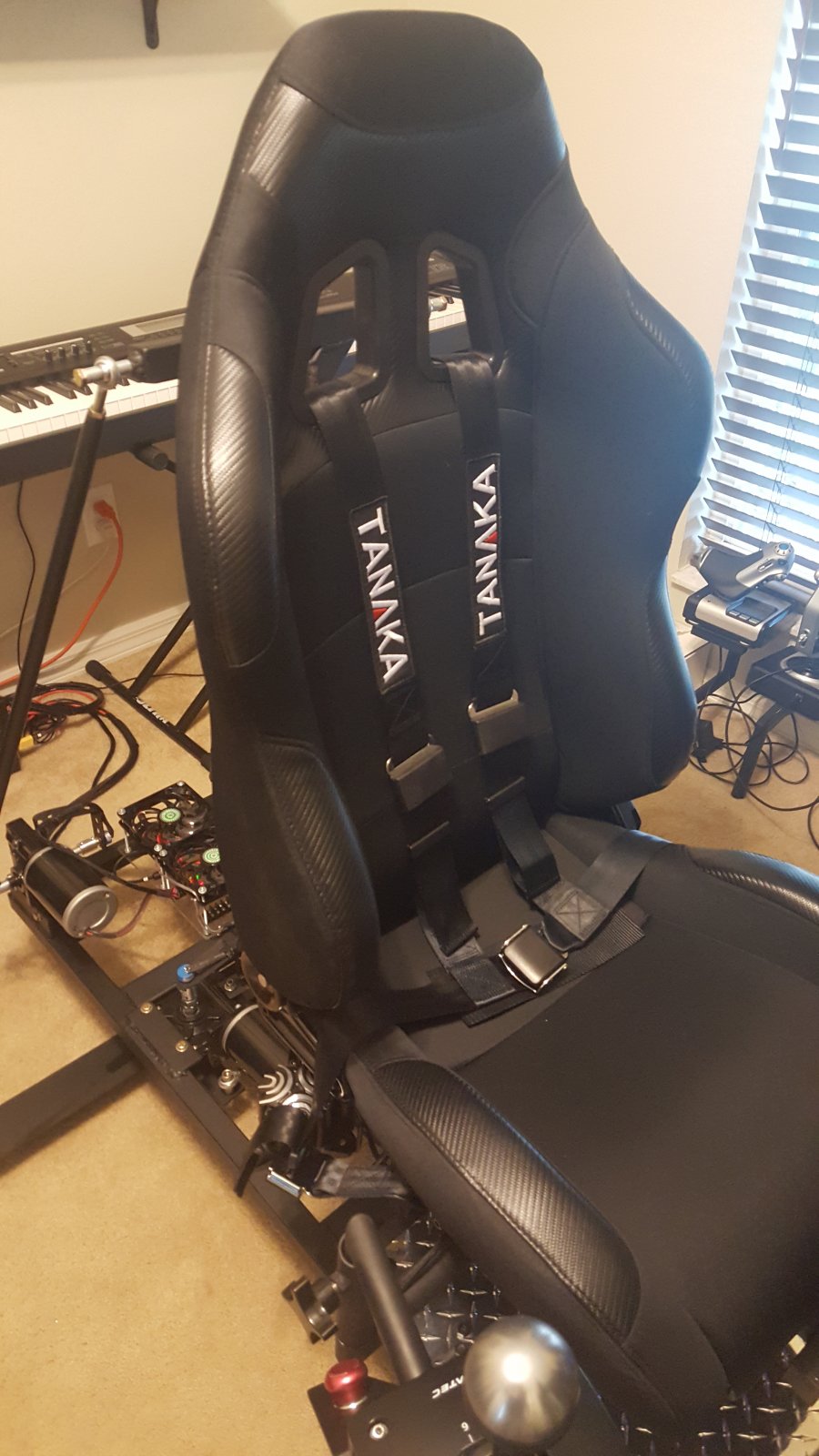

    Finally got around to mounting my 4 point.
    Really does make a difference in immersion. I tend to lean forward when I drive as I get tense from traffic, so this helps hold me in place. Made a big difference in fidelity in my rig as it transfer more information to me!
