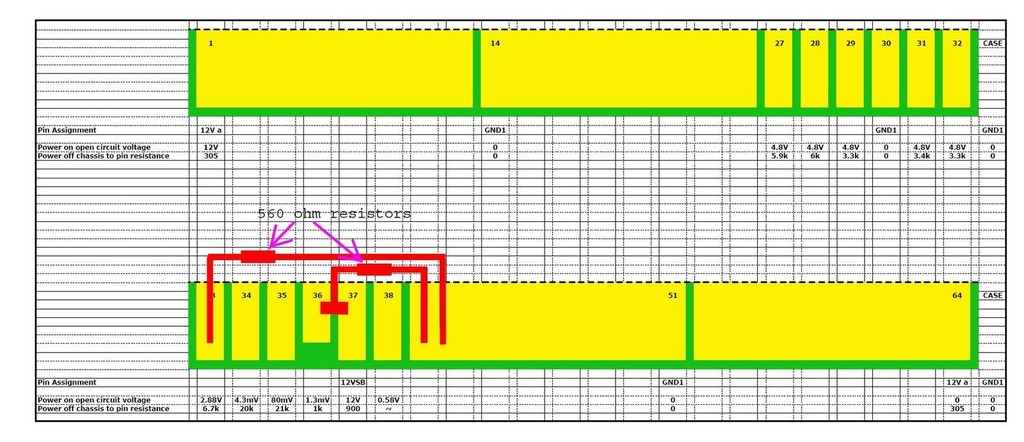

    Hi all guys!
    I'm back with the same old unfortunate problem..
    I would like to discuss with you about the strange behaviour my actual motors and electronics are showing me.
    Maybe my last video and description of the problem wasn't so clear, thus I've updated another clearer video (I hope) to show it.
    Here's the link .
    To show you how the motors turn on and off I've directly connected the blue lamp to the same 12V which supplies the two MotoMonsters for one motor.
    As you can see, there's a time when the lamp blinks and turns off that means (I suppose) that the PSU isn't giving any electrical power.
    Again, I cannot understand what causes this behaviour. Should I focus on the stall current only?
    At the time I took this video the CTC was just 3.5 cm.
    Thanks again for your precious opinion guys!
    Marco:cheers

    What are your power supplies rated to?

    Are they server PSU? Have they been modded to enable maximum current output (there's something like a power enable pin that needs 5V) ? If you have done the mod then all I could say is that the power supply might be going into protection mode. It's better to go with high power LED supplies in that case because they are "dumb" supplies and don't get picky during current spikes.

    It is a server PSU, specifically this one: HP DPS 1200 FB A PROLIANT DL580 G5..

    Note that there are actually 3 pins shown here being linked to ground. Pins 36 and 37 are linked to the same resistor.

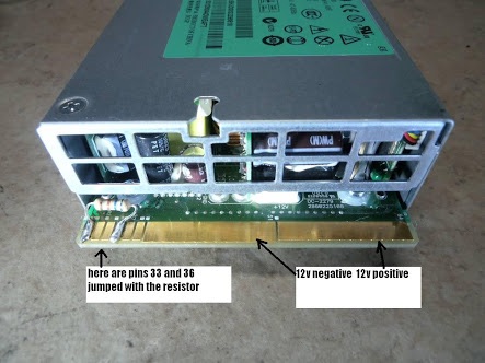

  19. Alexey
    Alexey Well-Known Member
    Sep 23, 2014
    452
    Electronics Technician
    Adelaide, Australia
    8,066Coins
    +623 / 2 / -0
    This one only shows these two pins being linked, whichever mod works.

    guys thanks a lot! this really solved lots of problems I had!
