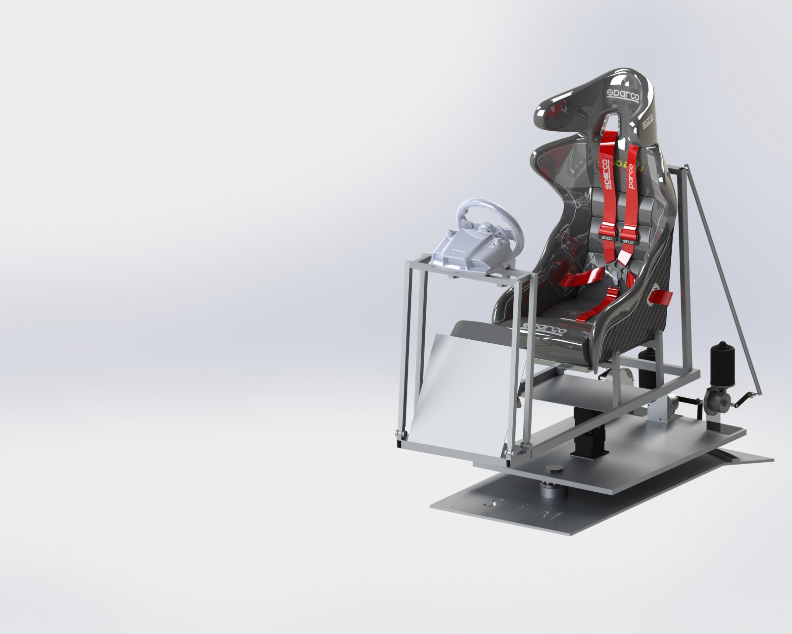

    Well! a new video for 3th movement

    Cool, not chain driven....wire pulley system. Very nice solution :)

    we have tried chains , lever system , for a small space , a simple dc motor (
    car's windscreen wiper ) with mountainbike's steel cable of brake is the best

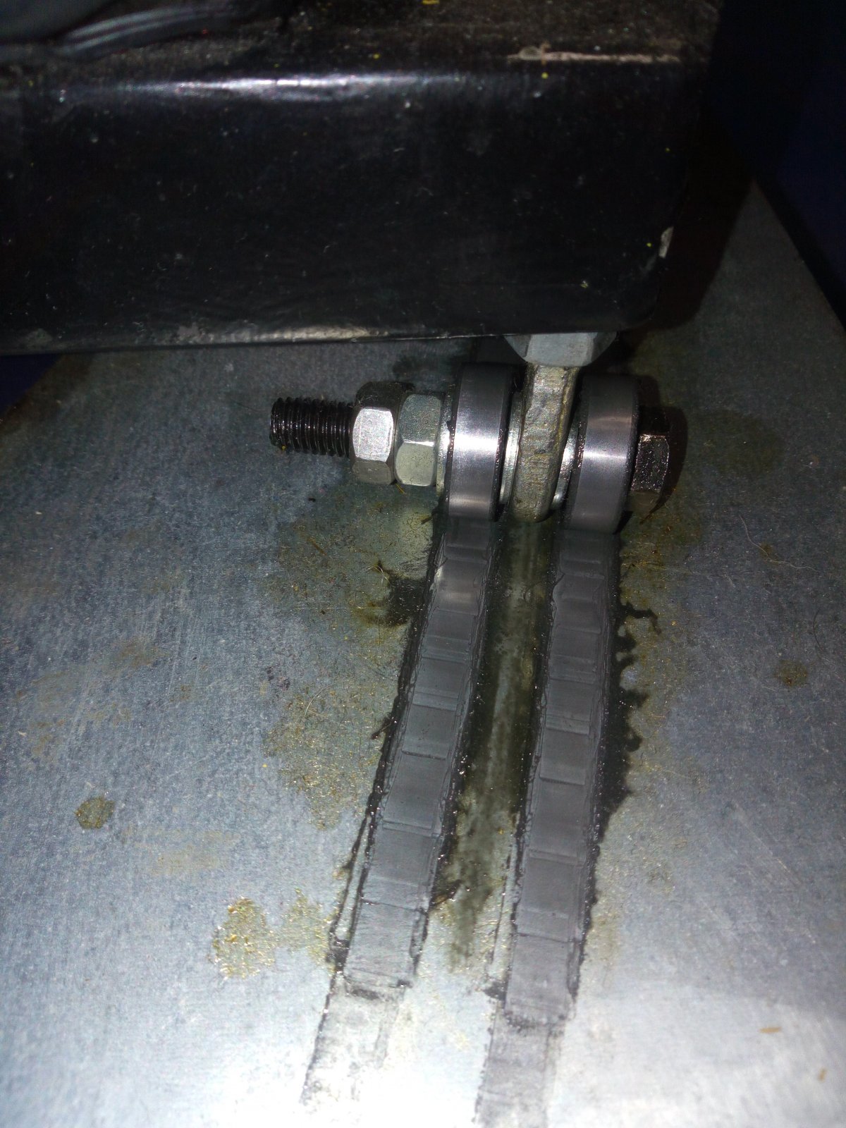

    this is show system pin for traction loss system

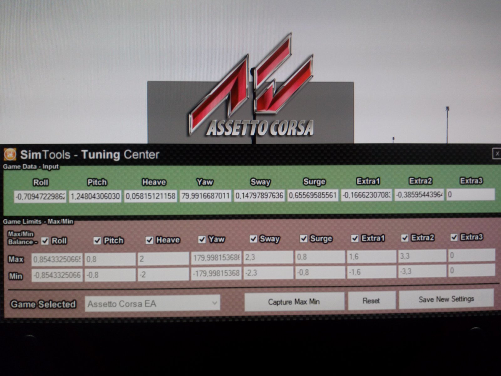

    Try larger values on the Tuning center for Extra 1.

    how big for extra1?? i using 1.8 and 2.8 for extra2 but I admit so difficult to setup. It's happened that have like a shock, about traction loss, in some point in the circuit, mugello or imola for example

    What Game are you playing and can you please post a screen of your Tuning center #'s.

    I'm playing Assetto Corsa

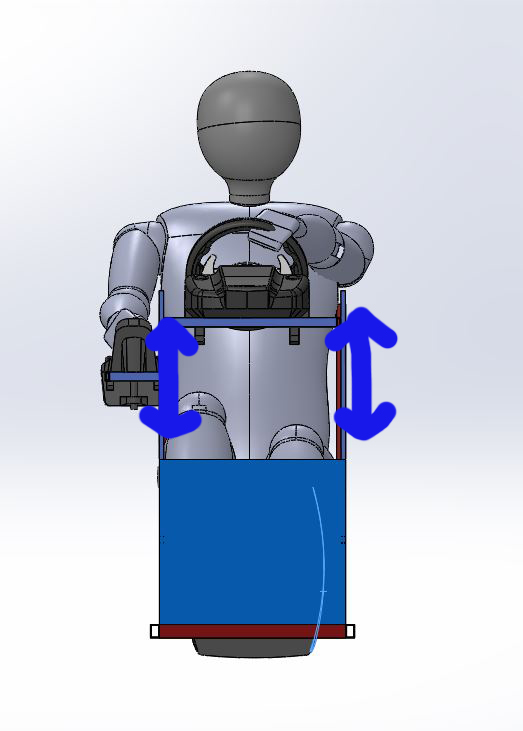

    a particular of traction loss system, ther are four of this

    As i feared, You need to Open up the Extra 1 # BIG Time. like 10X what you currently have. i settle around 18 if i recall for Ac. This ensures your not getting TL moment when your not Actually losing traction in game.
    Easiest way to get this dialed in is with the Skid pad Track available on Race dept. Turn off ALL the Seat forces, either use really big Tuning center #'s or go into the Axis and turn them to 0% test ONLY the Traction loss axis. This is where you will "see the light at the end of the tunnel" running it out of sync with the real world forces going on in game is a Terrible terrible idea and will ultimately lead to you learning REALLY bad driving habits.

    So, the problem is the
    torque of return for the tracion loss ? or the big latency
    between what happens in the game and the traction loss in simulator motion ?
    Sorry, but I do not know that ' ' Skid pad available on Race Track dept ' ' .

    Google this "Assetto corsa Skid Pad Race Department" Download it and turn off ALL other forces, ONLY tune Traction loss by itself.
    The problem is your rig is "loosing traction" when its Not loosing traction is game.
