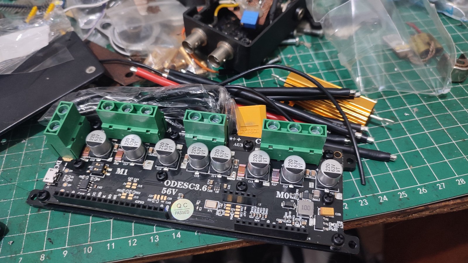

  20. Tehrawk
    Tehrawk New Member
    Feb 27, 2021
    22
    170Coins
    +30 / 1 / -0
    You control the motors using 3 ODrives. Each ODrive can control 2 motors.
    You dont need endstops. When you turn everything on, the ODrives understand that it is at the start position. They can calculate the movement positons from there. The Odrives wont exceed the maximum distance specified in the firmware.
