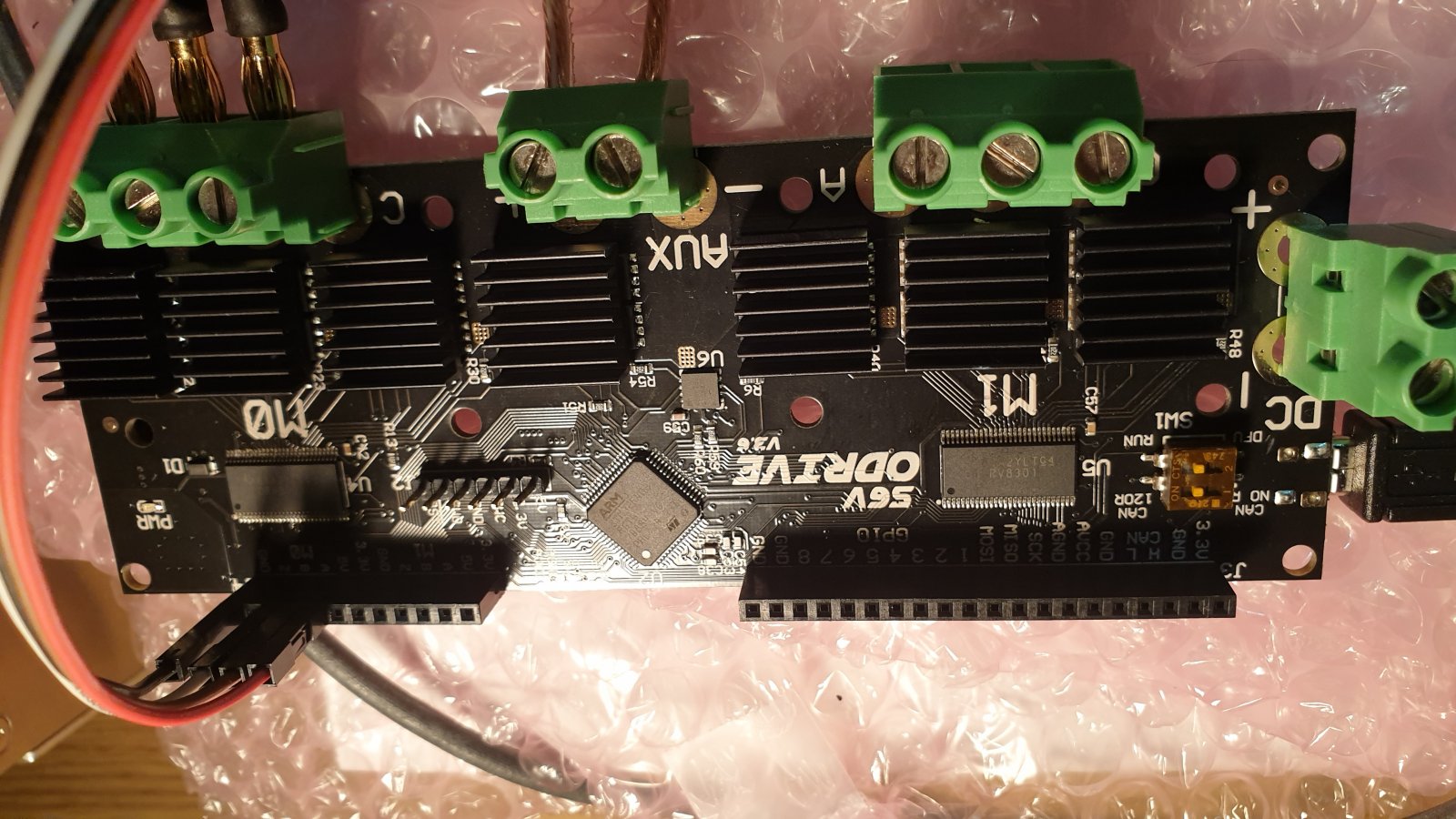

    I have made my own 6dof Simulator with your instructions. I have the same motors, encoders and power supplies. I am able to drive with it about two corners before it cuts operating because of over current of the motor. My rig have sometimes problems to be even still. Sometimes it takes just a few amps, but sometimes about 30-40 amps and then the motor gets really hot.:mad:
    I am curious, how high is your current limit? I have 50A limit and it is not enough. I assume my rig is little bit heavier than yours because I have made it from steel and I have three 32" monitors. One of your post you mention that your setup can handle about 400kg. My rig isn't so much heavier :D. I am pretty sure that the weight isn't the problem. I just don't know what it is.

    what firmware do you use your own or
    what firmware do you use your own or SilentChill? if you use your own try to use from him, provided that you use the same motors and the same odrive

    My odrives are 3.6 56V, so I think I can´t use his FW? I tried ones, but I got all kind of errors so I didn´t look in to it after since. I made my own firmware to them with the instruction video below.

    You will get errors if you have a different firmware version that the one that SilentChill used. Im pretty sure it should be 0.4.12
    You can install it to your Odrive using the following code
    pip install odrive==0.4.12
    That will replace whatever the version you have currently, with what I believe is the correct one.

    That command just downgraded odrivetool. I manage to flash the odrives with STM32 programmer to 0.4.12. Or should I say I think I mangage, because odrives show that fw version is 0.0.1 or something like that. It still look like it works properly. I didn´t have time yet to test the rig, but everything is calibrated.
    The answer to my original question, @SilentChill motor current limit is 50A.
