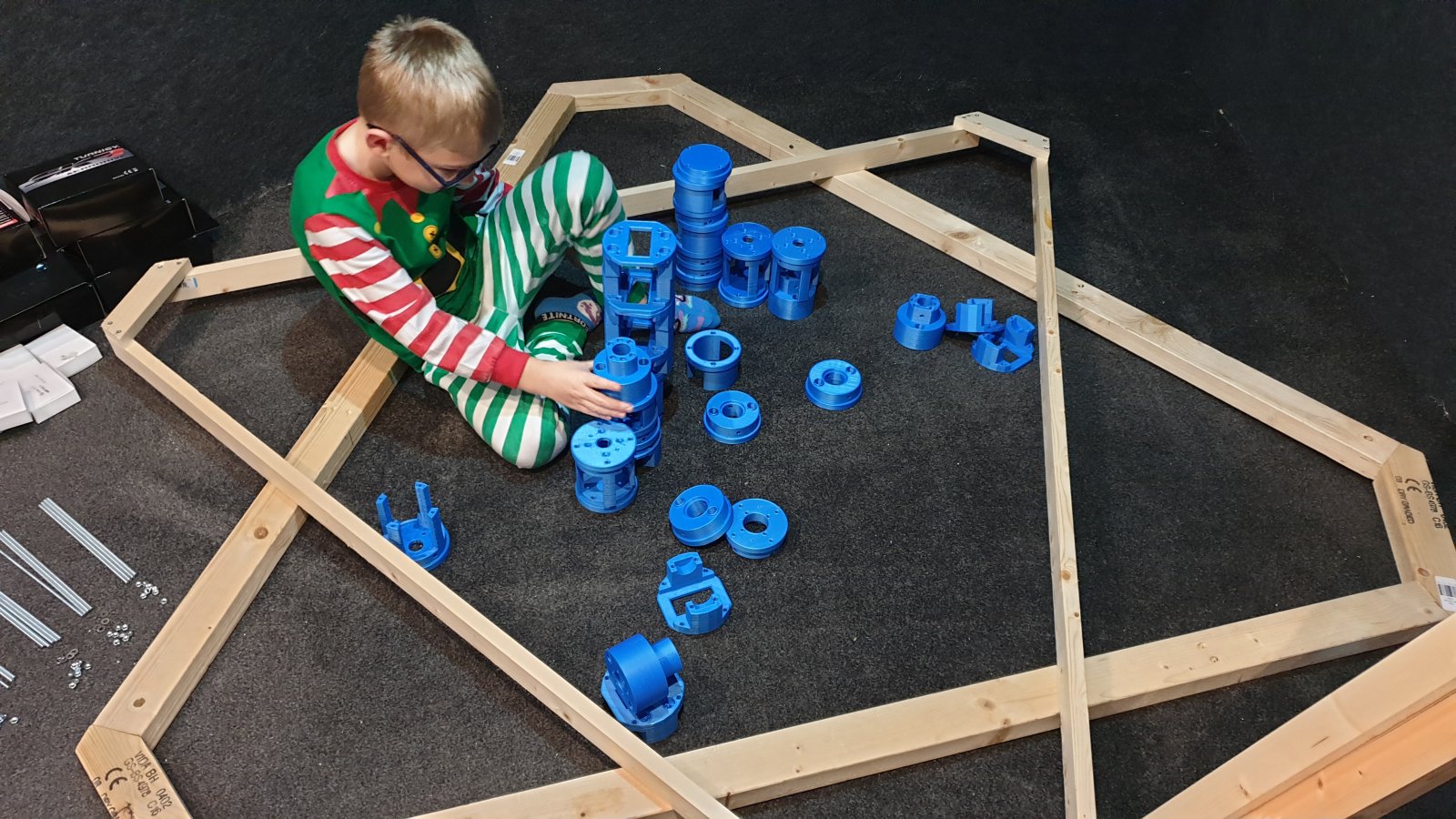

    Hey bud, I see you are using PLA filament.
    Have you ever tried PETG? It is more resistant and is a little more flexible than PLA (PLA will break easily on small part that you try to flex, but PETG will tolerate more).
    I have a lot of 3d printed part on my rig and PETG last longer for me.
    Only downside, it is a little harder to print than PLA. (at least on my ANET A8)
    You may want to try if you haven't yet.
    Just my 2 cents.
  2. SilentChill
    2,645
    20,604Coins
    +3,570 / 34 / -0
    I'm using "PLA Plus" supposedly as strong as PETG but soo much easier to print with not as flexible but not brittle like normal PLA
    I did try PETG did a couple of spools but didnt really take to it
  3. SilentChill
    2,645
    20,604Coins
    +3,570 / 34 / -0
    Because all my 3D printed parts are building blocks, child is there for size reference. @Pierre Lalancette he is 7 and half years old just so you know 20191207_194231.jpg

    The base will be wood but the frame aluminium, the top wood frame is just temporary to see how big its gonna be and decide how I'm going to build my frame as I have not designed it yet.

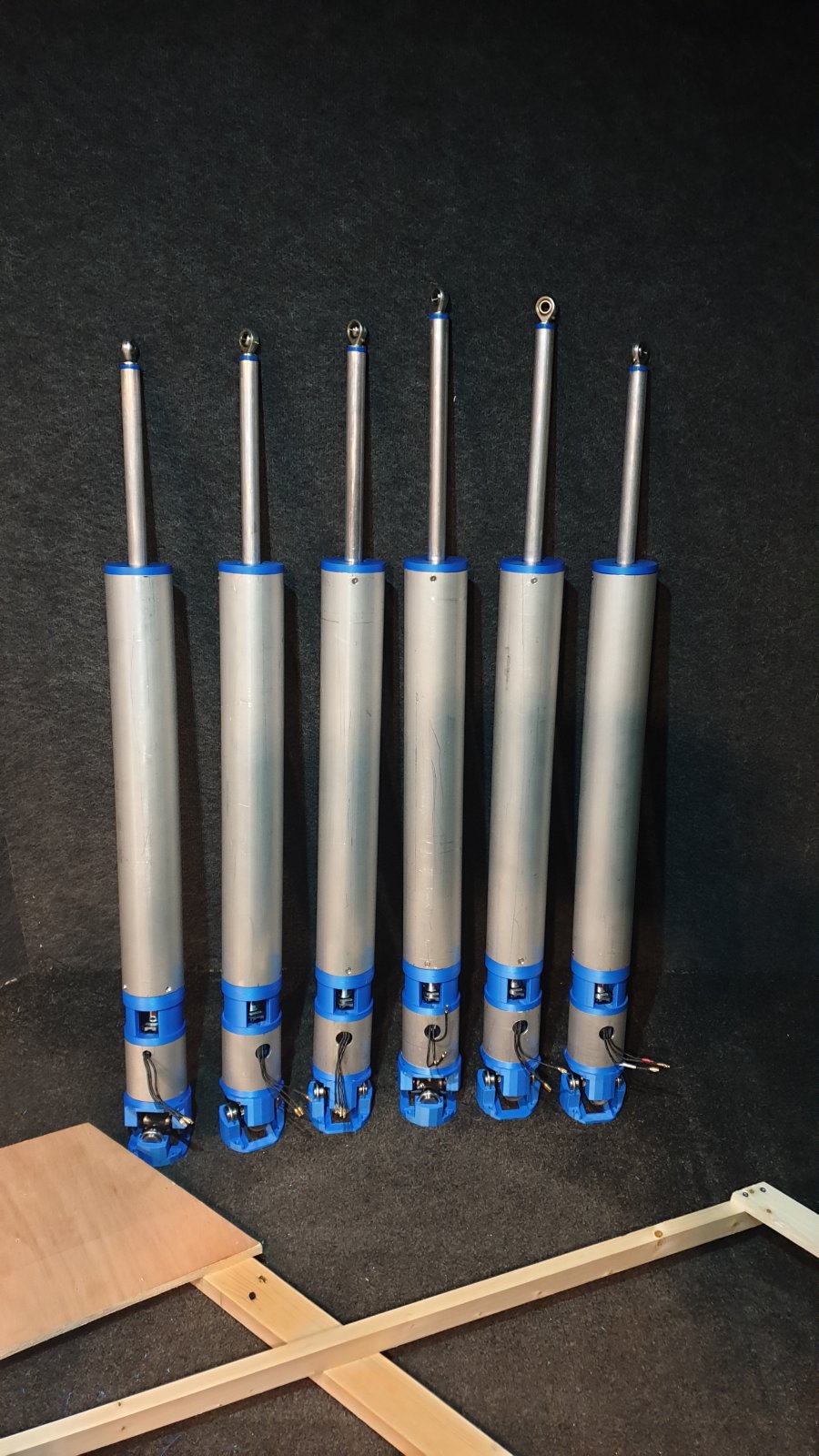

  14. SilentChill
    2,645
    20,604Coins
    +3,570 / 34 / -0
    Finally we have 6 ! So much to do so little time
