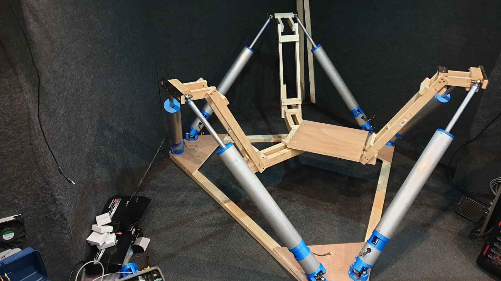

    Wow - that was fast. Congrats on such a rapid build. Your printed parts are stunning, though I have some concerns about actuator assembly precision. You see I'm working (pretty slowly) on my take on 6dof and during my resarch and some help from my friend who is a constructor of several different industirial machinery I'm convinced that precision is a key to propper operation of mechanical parts and assemblies. On your actuator assembly video you didnt check screw concentricity with dial indicator, your shaft looks like a regular alluminum tube that doesn't hold specific diameter tolerances and ruffness required for slide bushings. The same goes to your guide shafts (at least that how it looks). The screw and nut are exposed to high stress during violent moves (obviously you know that :) ) and I belive that thier position relative to eachother and rest of the assebly is crutial if you want semi silent operation and longer life of components - safty is also a concern since parts that are not properly aligned can break in most unexpected moment. Don't get me wrong I'm not trying to diss your fantastic job just wondering what compromises can and can not be made. What do you think?
  3. SilentChill
    2,645
    20,604Coins
    +3,570 / 34 / -0
    Gonna be a while until I get the frame built :(
    I know your concerns but my last rig which lasted 3 years with minimal breakdowns and no major failure of any major component even though that was hand drilled and marked by me. It was really bad aligned made out of a mismatch of wood, plastic and a lot of screws. It was still going strong for long long sessions before I dismantled it.
    These are 3D printed so once all tightened up and held together the tolerance of things being aligned will be within 1mm which is probably 10x more precise than my last build. I think some adjustments will be made but I know where the stress is and what will take the most battering.
    From what I have experienced since I started down this road is ............... don't always listen to the experts.
    As you know I make it and see what happens what's the worse that can happen apart from some broken plastic or a bent ball screw , I won't die and I'll have fun doing it :) and if I pull it off it's a benefit for everyone :D

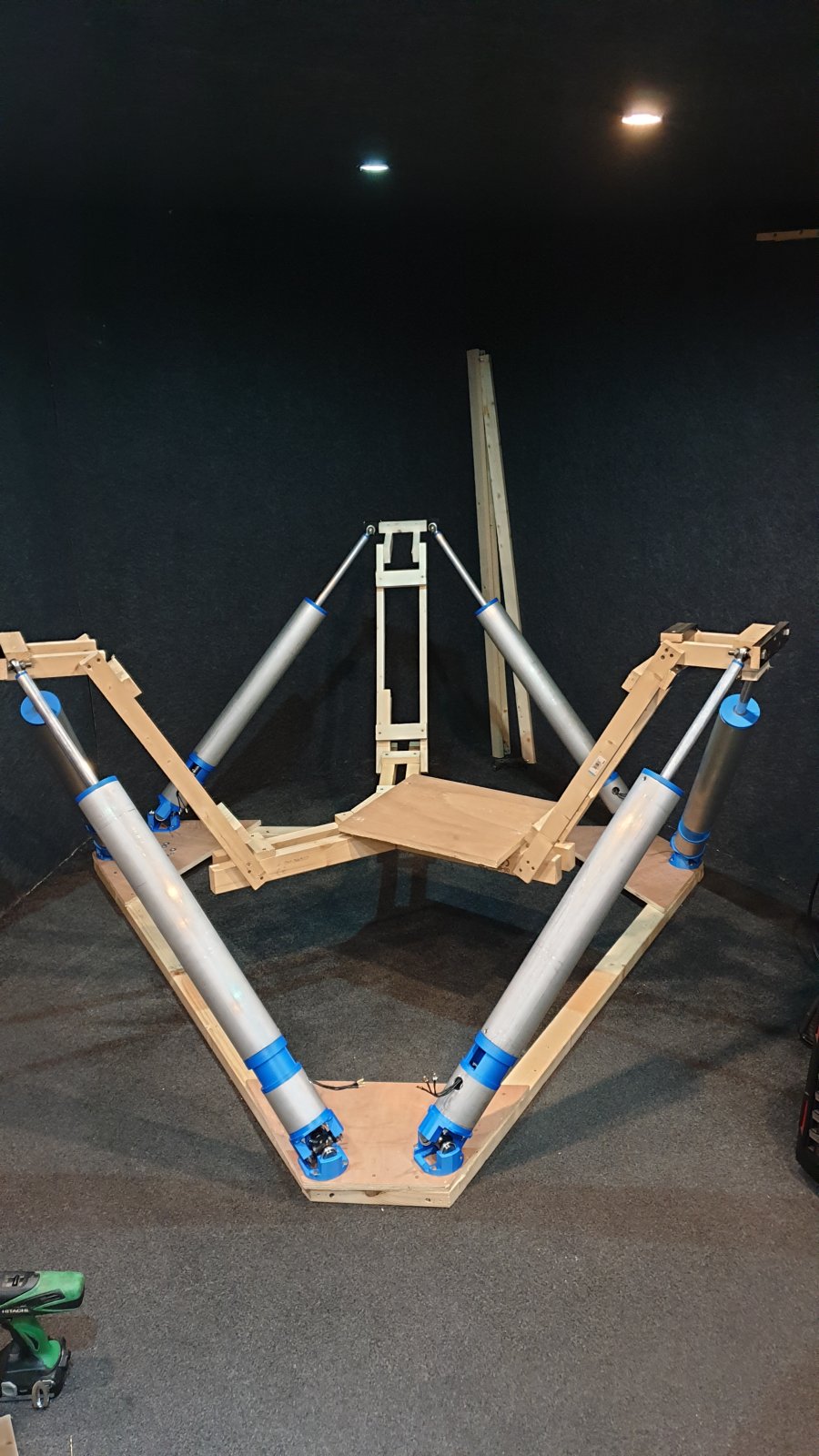

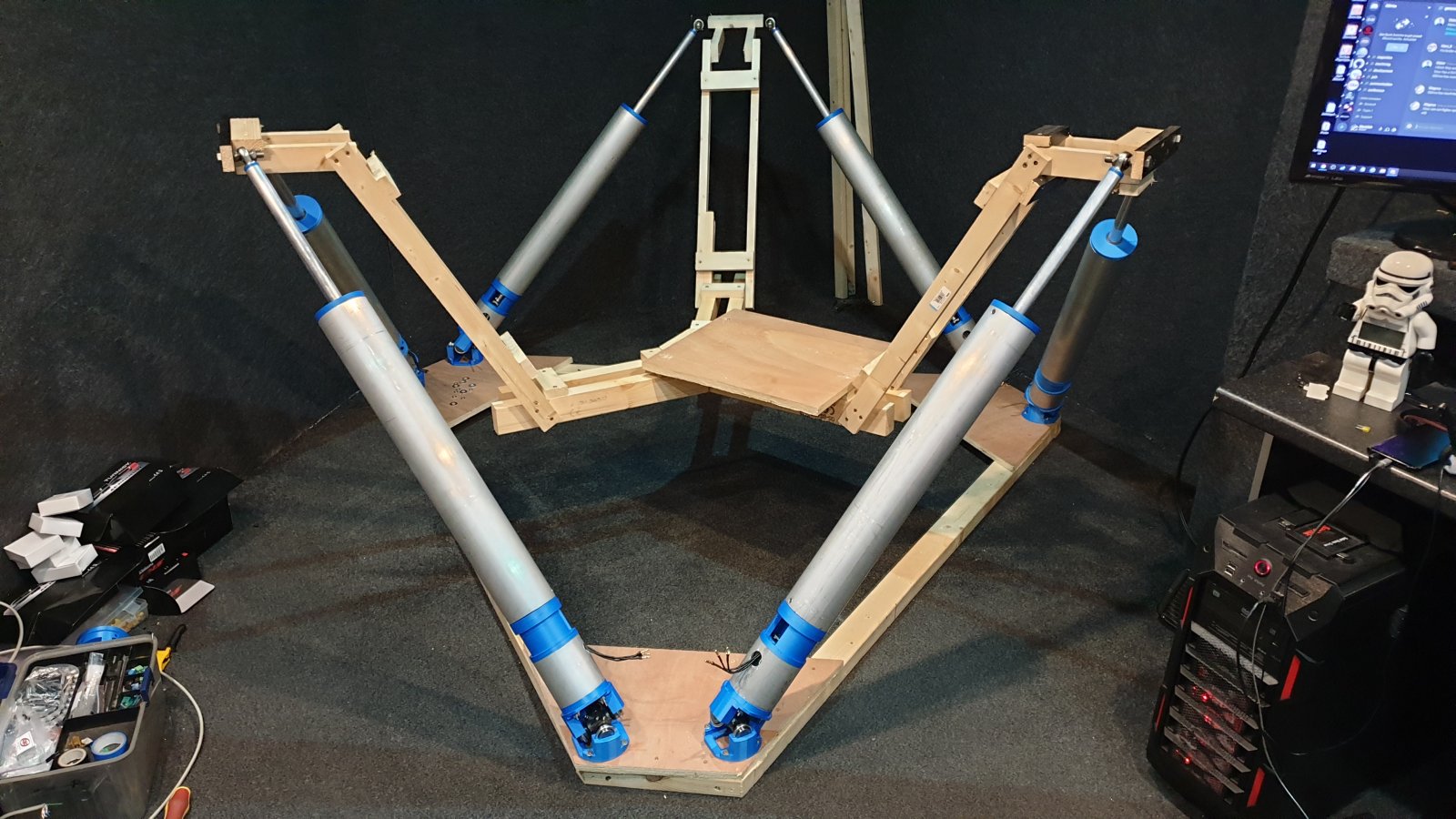

    Hmmm dunno if this will be too low but I have no head room and would like to be able to get in and out of it easily.
    The frame is flexi as hell with it being wood.
    Angles on the actuators maybe to low but I will have to try and see what happens
    Need to get the frame made ASAP

    It does look a bit low. You could only be sure if you mock up the front pedal area to be sure it works.
    I found in my setup I needed to bring the seat far forward not only for a better centre of gravity location but it also got the wide pedal set forward and out clear of the front pair of actuators.
    Or you could go F1 style and set the pedals up nice and high.
  14. SilentChill
    2,645
    20,604Coins
    +3,570 / 34 / -0
    Yeah cheers dude, it's just for ease of getting in and out also all the weight of the pedals and OSW ends up at the front so if j can be further back and bring the OSW back a bit and possibly monitors it will help with the loadnkn the motors. CoG can be sorted with software now so it shouldn't be too much of a problem
    I'm hoping it will fit inside the actuator circle. I may have the seat higher with the pedals lower like a proper car or a plane .
