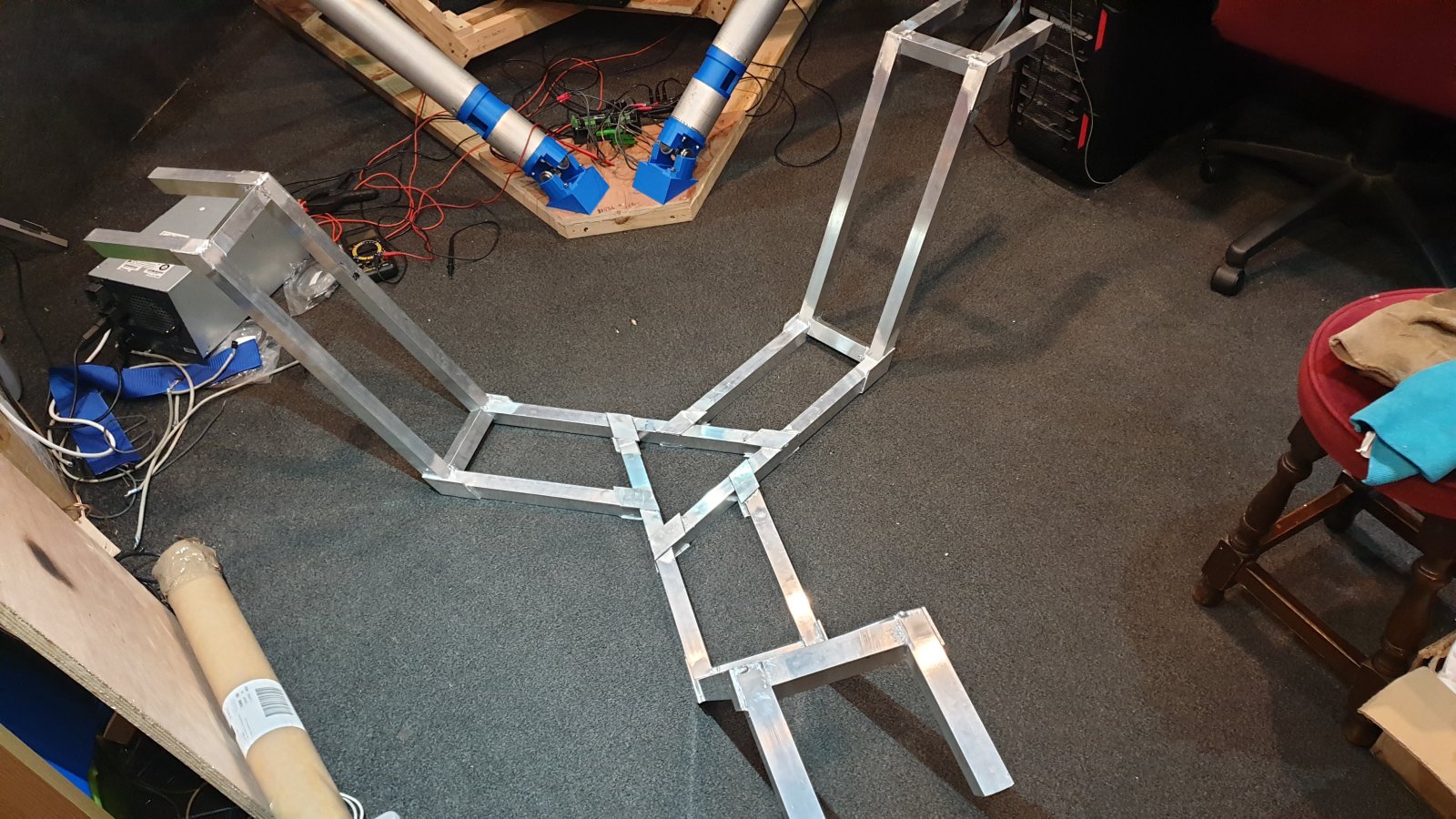

    Quick update, basically I've had a nightmare with the oDrives , these things are not easy for a n00b like me.
    I have to give a massive big thank you to @RobsonSwiss hug: for helping me big time without him I would of given up with the oDrives weeks ago. Hopefully it will get easier for anyone else wanting to use them.
    So I've also had problems with the aluminium brazing rods, I bought twice and they were shit so 3rd time I bought real Durafix sticks and they work as they should. It's a lear ing curve again but hopefully I will get my frame done by the end of the week.
    This is how it's looking so far, I ran out of gas so 1 3rd complete, some cross bars to go on to strengthen it up a bit too.
    Onwards and upwards :cheers

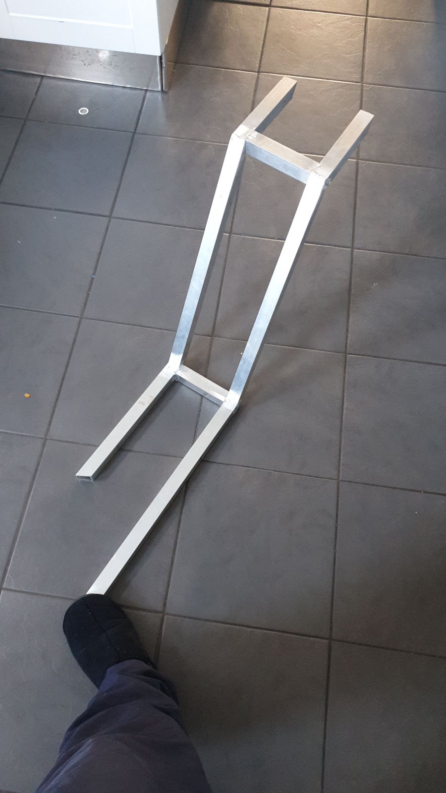

  6. SilentChill
    2,645
    20,604Coins
    +3,570 / 34 / -0
    Nearly finished the frame, I'm unsure whether its gonna be strong enough. I think I should of designed it to be bolted together as the aluminium brazing/welding is not the best for this sort of thing but I'll see how it goes
    Got to add quite a few more bits yet before its complete just hoping it will be strong enough, I've jumped on it and pulled it about and seems ok

  8. Pierre Lalancette
    Dec 11, 2016
    1,012
    Tech Artist
    Quebec, Canada
    8,052Coins
    +947 / 6 / -0
    3DOF, DC motor, Arduino, 6DOF
    You have a lot of possibilities to make a lot of triangle with the shape you have.
    This is how I made my carbon tube platform hold out. Lots and lots of little triangles.

    I can see your Odrives at the bottom left corner of the second picture... are there some encoder cables crossing near your Odrives? Dont do it!!! It took me months to find that my main EMI problems with odrive came from too close encoder cables!
    Wickie
  14. SilentChill
    2,645
    20,604Coins
    +3,570 / 34 / -0
    @wicki
    They are not connected at the moment just put to one side whilts I sort everything out and wait for my new odrive to arrive :)

    Excellent work as ever, hope those odrives start behaving - they're not cheap kit. Why the additional bracing at shoulder level on the upper platform? I'd imagine just the frame under the seat should be rigid enough, though maybe helps to support the welds. I really like your wider flatter design but I have quite limited floor area so will have to go more compact - and try not to bang my head on the ceiling :)

    +3,570 / 34 / -0
    Thanks, there was just too much flex so the supports really really stiffen it up, I think 40mmx400mmx3mm would of been a better choice or even bigger to stop the flex. I'm happy with though at the moment.
    My biggest problem is head height I only have just over 2 metres but plenty of floor space. Even at full extension I'm maybe 50mm from the ceiling which is good.
