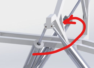

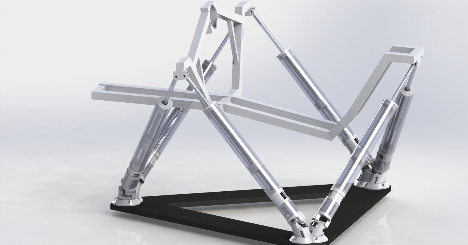

    Many thanks for sharing the actuator design files @SilentChill, I modeled it into solidworks combined with the frame of @PeterW.
    below just a quick preview wich is far from final...any tips or late design changes are very welcome !

    Looks great from here :)

    @alex1970 I'm at about the same stage as you... your eyebolts look to be clamped, can they rotate? Reading other builds I noted rotation at the top joint or rotation in the actuator itself. Mr Chills actuator has guide rails and is ridged. If this helps great, if I am wrong please ignore.

    Looks great apart from that !! lol i didnt even notice

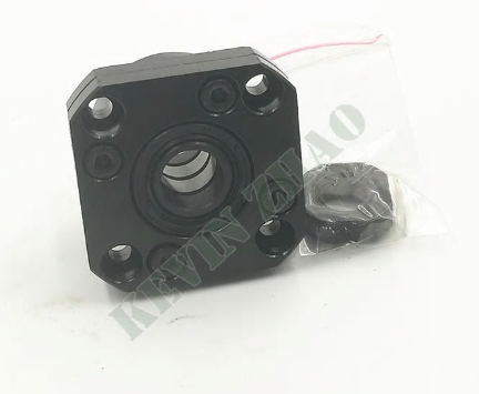

    Do the fixed end support seals you used handle thrust and radial loads? My assumption is yes, but you've used them could you confirm? Using them will save me nearly 80 beer tokens over the thrust and radial bearings I've been considering.

    That part holds the whole load of the rig so it's a pretty critical component I wouldnt want to try and cheap out on that part. It's the FK12 bearing housing

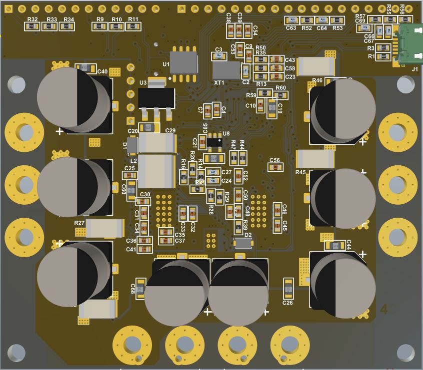

    Very well seen, that was a fast way to get the assembly done, it is far from final. This and lots of other things are still in process of development, as I did a redesign of the Odrive PCB which is finaly ordered :blush (btw this odrive pcb is only 70x80mm). So time again to get the mechanics done.
