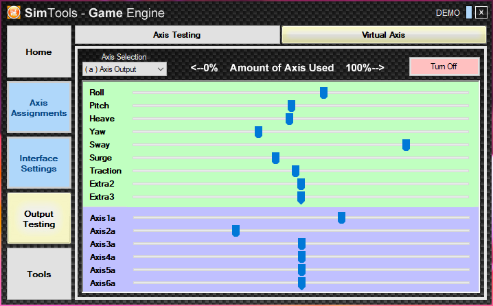

    I know that many of you are familiar with SimTools and Live For Speed, but I wanted to present where I am at so it is easier to understand where I am in this process.
    I have SimTools open with tuning center open and the game manager on as well. All three have the green icon in the top right, which I believe means they are all communicating with one another.
    I tried running the SimTools program while operating the demo game, liveforspeed. I used it to see if it would generate any feedback I could see, and this becomes present in both the Tuning Center (TC), as well as in the Output Testing window of Game Engine (GE).
    In TC, it shows up with a ton of real-time values that are all over the place, with roll/pitch/heave/yaw/sway/surge/extra1 (which is set to Traction Loss) generate constantly variable values as you do certain things while driving. In GE, under the Virtual Axis tab of the Output Testing, the slider goes back and forth (essentially positive and negative, which I would assume is translated into values both +/- of the absolute position), so this would then be the values sent to the Axis1a and Axis1b bracketed arguments made in the Interface - Output function.
    The issue there is that I can't see what these exact values being sent are, as once you are in-game, it locks you out of the interface and axis settings pages. I would assume the values are somewhere but I can't find them. While live, these numbers are visible in the Game Data - Input table, but it looks like everything except Yaw is working from -20 to +20. The best I was able to do in a screenshot was this:
    Here you can see the upper and lower limits of each value as I played the game. I think the reason the surge max is so low is because it never reached 100% (couldn't accelerate fast enough); however, I did hit a wall, which allowed it to reach near max on the min.

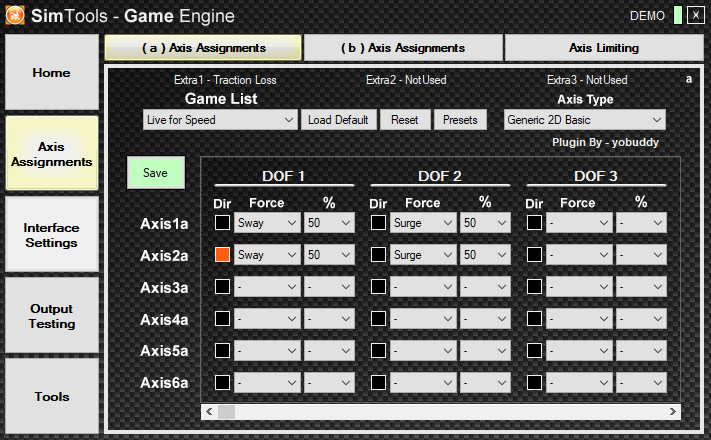

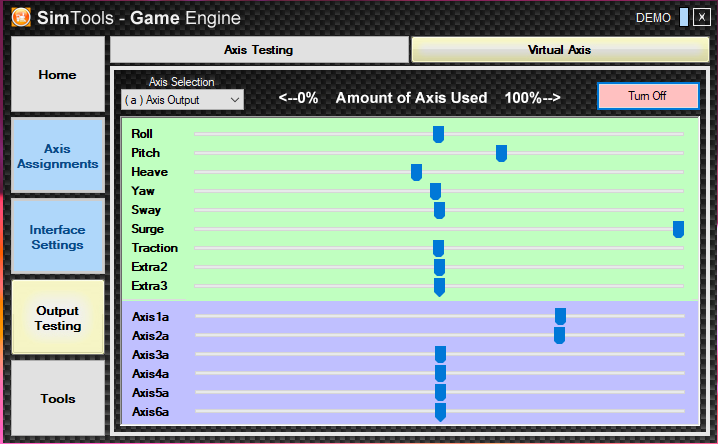

    Focusing for now on sway and surge, as sway goes from 0-100% it basically splits the value in half and gives each motor 50% of the duty: positive to one, negative to the other, exactly as expected the way I have it set up, where surge is both motors + pr - together:
    When I have full acceleration, surge basically maxes out, which is shown here, having split between the axis1a and axis2a:
    As you can see, I have the sway function with an inverted axis 2a, so I get this as the split between the full value (let's say this is close to 15)
    The way I see it, if you have the values from TC showing +/-20, and the sliders are showing it cut in half and shared between the two axes, then at max these values would be 10, and either positive or negative depending on how they are setup.
    I hope this clears up the feedback from the game to SimTools; now it comes down to expressing these values into a path for galil to understand.

    Ok! I got everything working within SimTools and was able to test it out using the demo of Live For Speed. After a lot of troubleshooting, mixing up the axes, messing with counts, and fighting with software conflicts, I finally have the motion corresponding to actions on screen!
    From the beginning, I felt like there was something I just couldn’t see that was messing me up and it mostly turned out to be the function at the end of the commands, \r\n. Can you tell me what this is and why it was an issue? The IP, 2-char commands and even the Bitrate being translated into decimal values for output all make sense, but that suffix doesn’t.
    Here is what solved it:
    Interface settings - Output
    IP 192.168.1.50 Port 23; Type Decimal
    The command I put into Interface Output is the only thing I am doing right now with SimTools; the rest I am still using a combo of InMotion (manual commands and initial variables) and Galil (changing variables to fit the 13-bit values)
    JG3000,3000;AM;PA<Axis1a><Axis1b>;BG
    This ensures the jog speed stays the same (doesn’t need it but if I mess with it in InMotion I don’t want to slow the system down on accident); then this makes the values output by the telemetry interact with the x and y motors appropriately.
    10ms seems to be a good number, so I’m hoping that is a good place to stay, the response is fast enough you don’t notice it by reaction.
    As for in-game, I learned that my 13-bit points (0 to 8192) are enough to nearly reach the maximum limits of the system, which is plenty.
