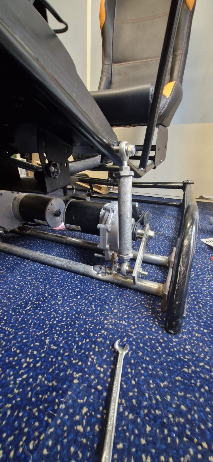

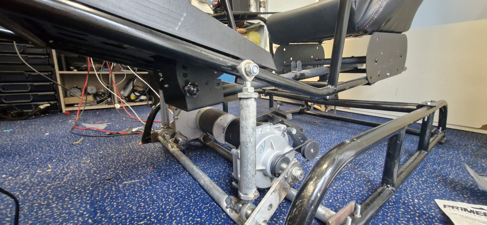

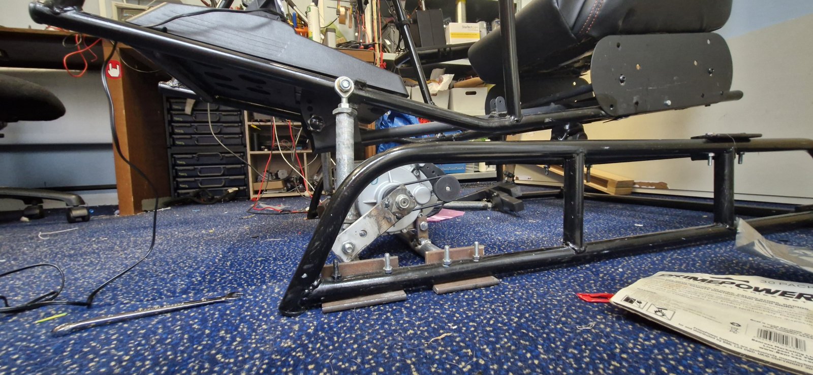

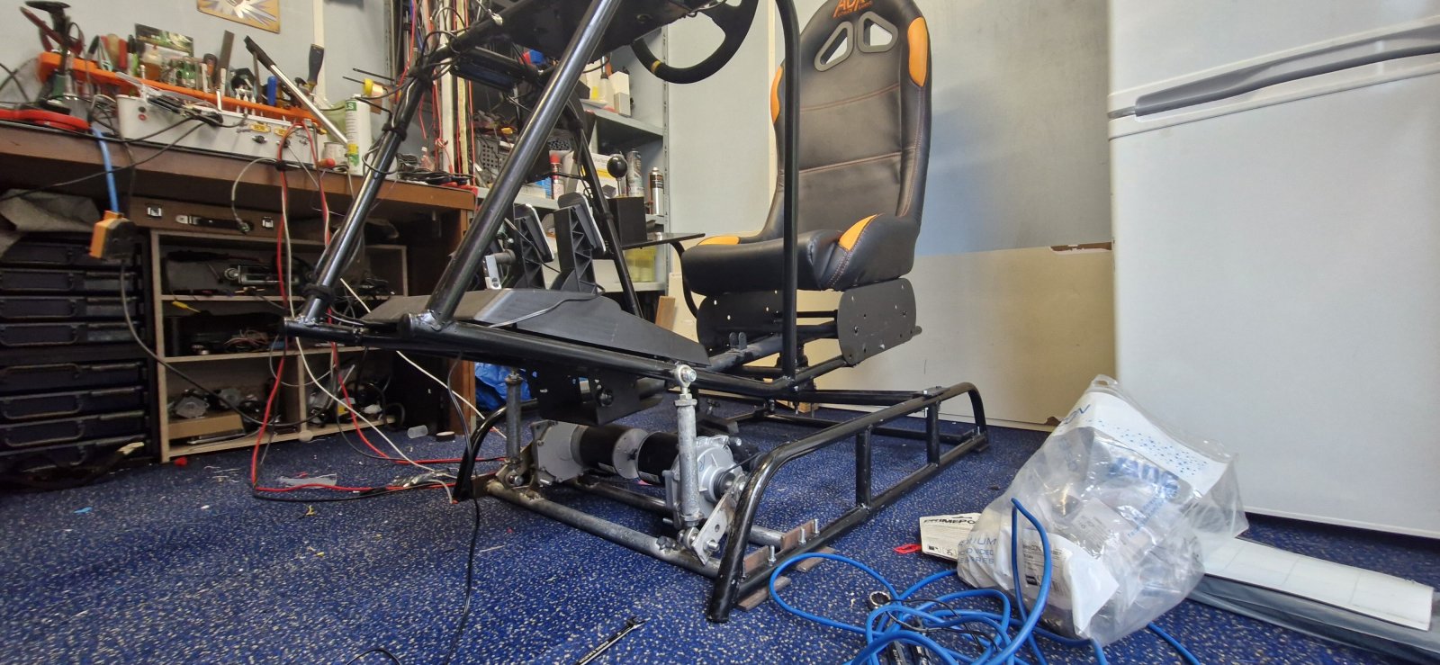

    This is my rig as you can see with the motors off the rig drops down until the arms from the motors hit the bottom of the lower frame. It looks like alot of other people's rigs stay stationary at the mid point.

    Given the gear ratio and a full-frame design you may need to shorten the CTC of the levers, and I see there is a shorter hole already, that won't stop the motors being back driven but will reduce the load on the motors and IBT2s:

    I will try that. I drilled extra holes for adjustability but never tried it on the shorter ones.
    for reference the CTC distance is 95mm on the further away holes and 70 on the closer ones

    You could also try one at 50mm.

    As for the tilting of the platform without powered motors it's just that you have an unbalanced upper part of the platform.
    You should build a top frame attach the seat and the rest of the hardware to it and while sitting on it put, for example, a brush stick under it and moving back and forth find the center of gravity, such a balanced platform will stay horizontal when the motors are off.
