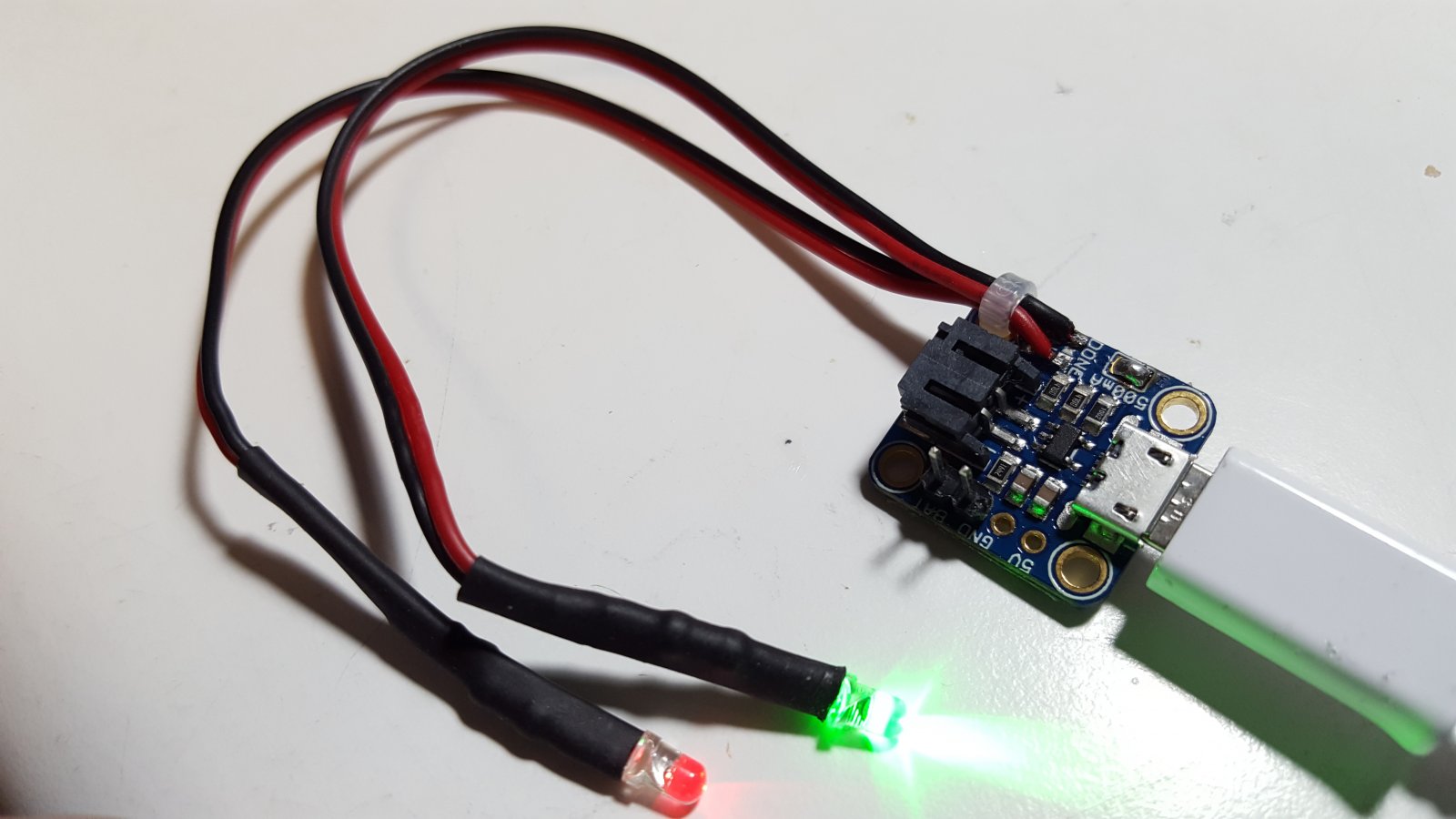

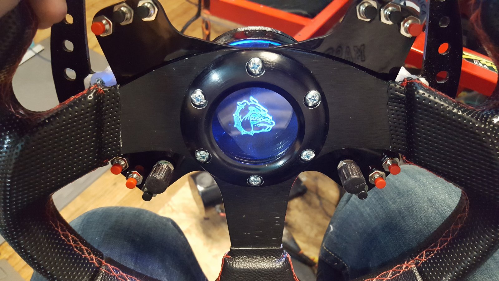

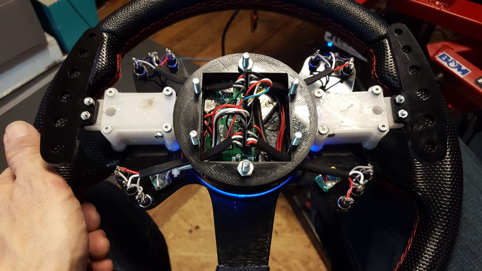

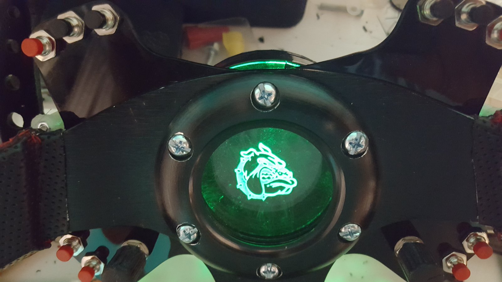

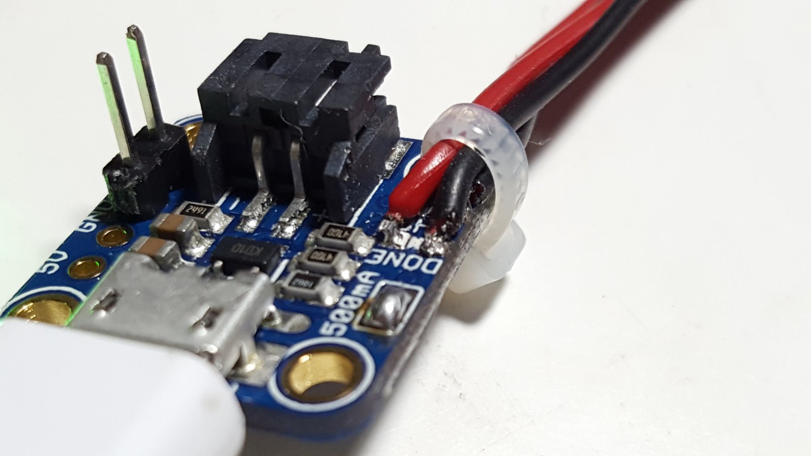

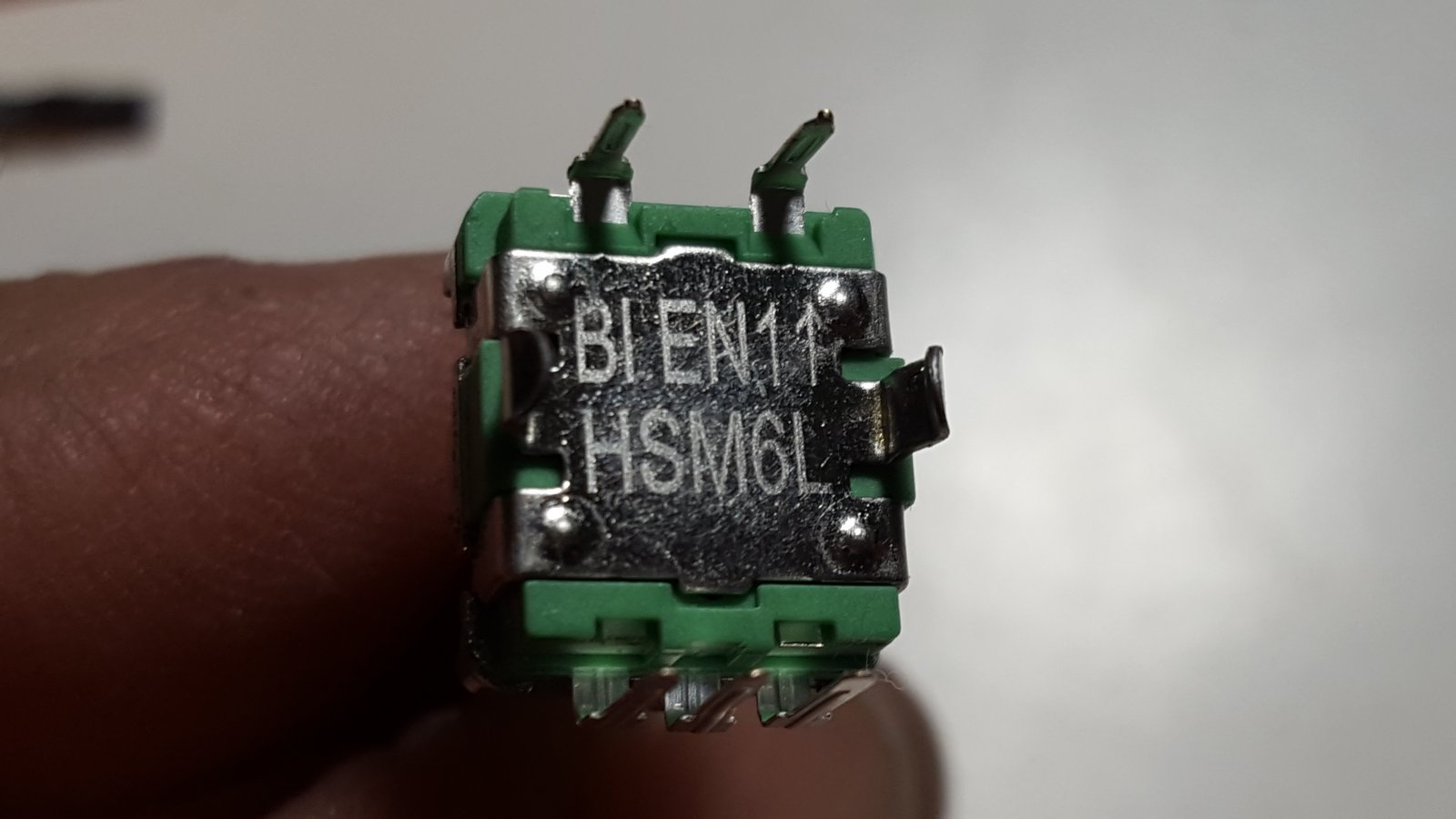

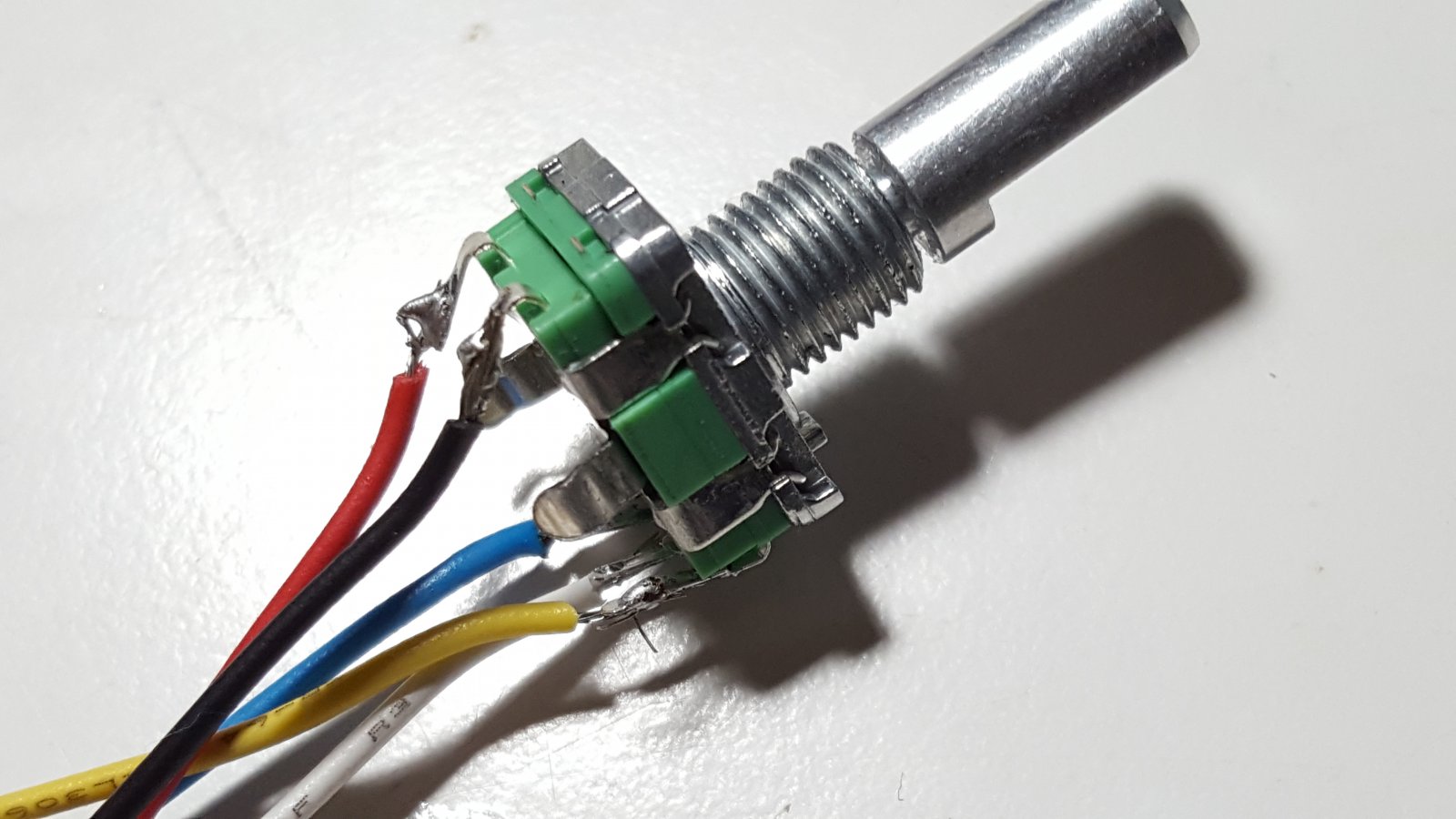

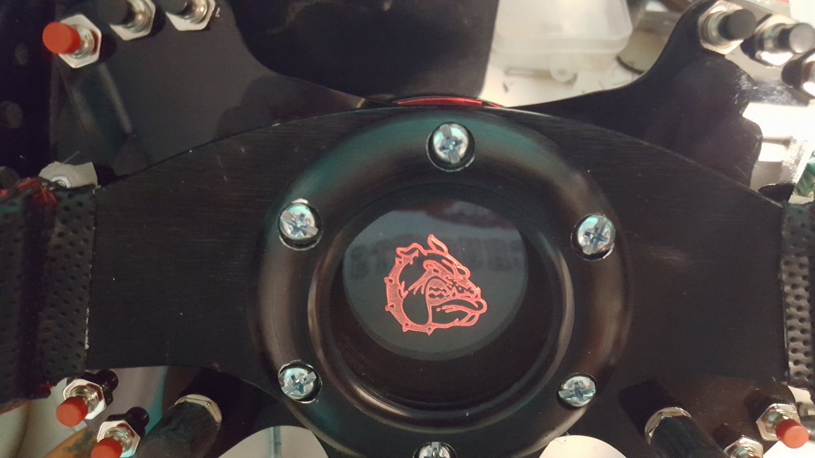

    Did some more work on my rim. Added two en11 encoders with button. So the button count is two encoders 12 buttons and two paddles. I also upgraded the led status indicator. Red is charging, green is fully charged and blue is bluehid power on. I remove the onboard leds on the adafruit ADA1904 charger and replaced with wired low voltage leds. I also just added a blue to 5v and ground. Bluehid has built in resistors on some of the pins for leds.

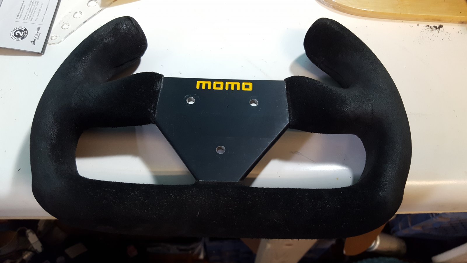

    New project showed in the mail today. Its obviously used but got a good deal. Its a mod 12c 250mm. So small. Formula and karts are what it is intended for.

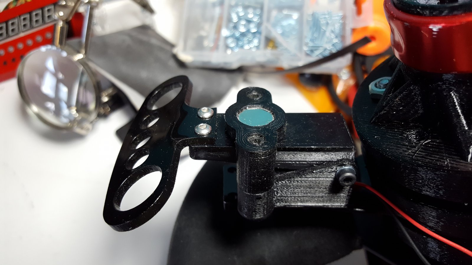

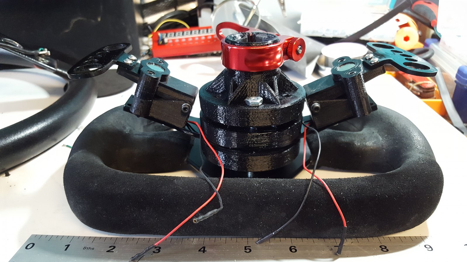

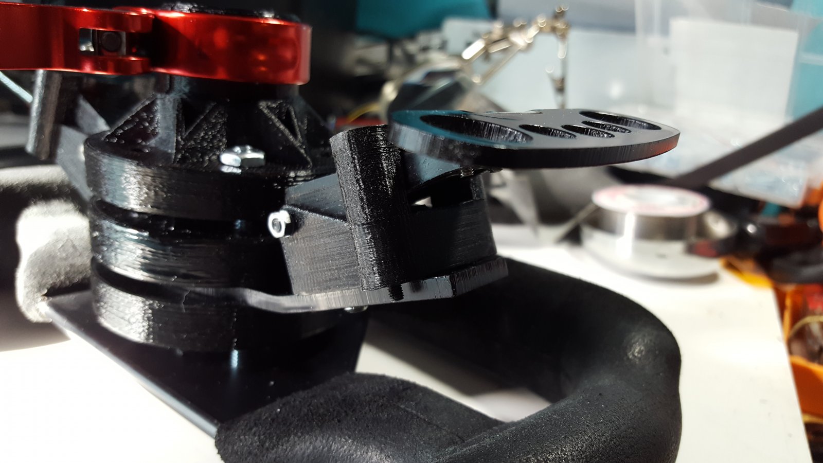

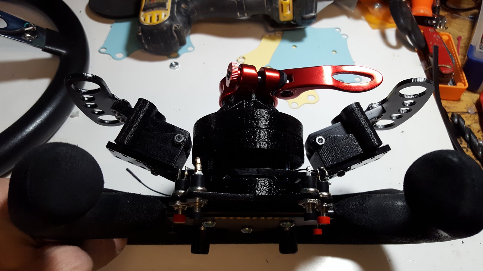

    The mod 12c with new plate and new shifter design. Ty you know who for the shifter drawings.
    6 buttons
    2 rotary encoders with momentary switch
    2 shifters
    On this one because of the small size the shifter and button plate are separated. The shifter plate has the shifters mounted at an angle with offset paddles.
