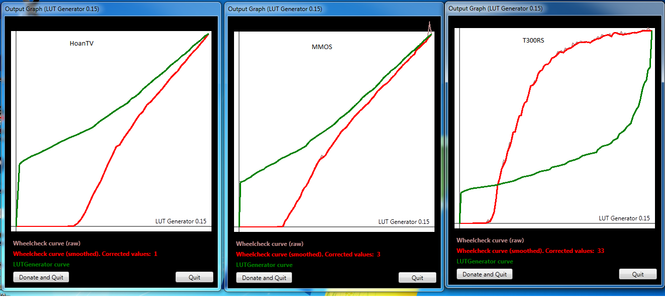

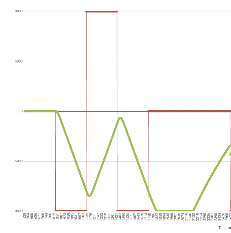

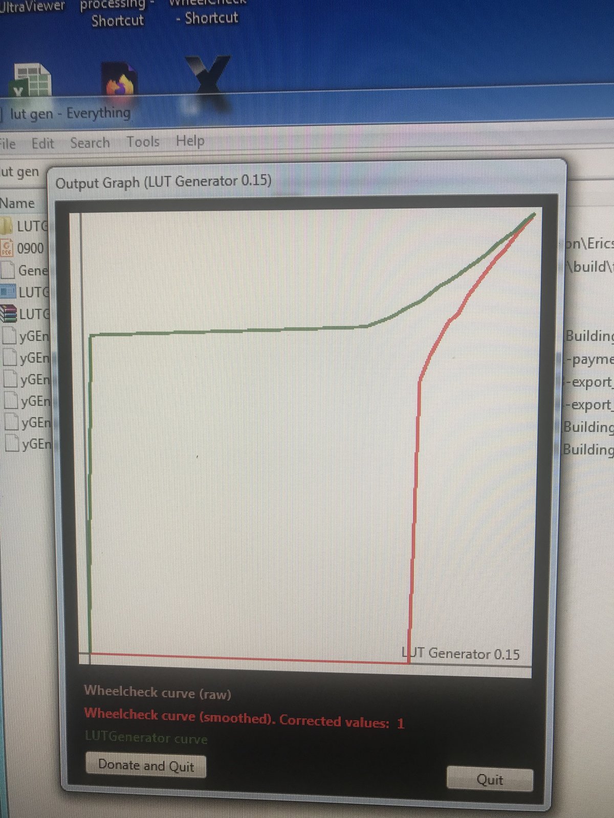

    I. About LUT Generator. Here is result with myfirmware, MMOS Firmware with same hardware and result T300rs. I dont understand these. can you explain them?
    1. what do color curves mean
    2. which is good and why is it good?
    II. Grapth.
    I dont understand too. Which is good and why is it good?
    I have not used EMC yet. You mean MMOS have internal gain for each force?
    I will display gain configuration for each force (arduino version did)

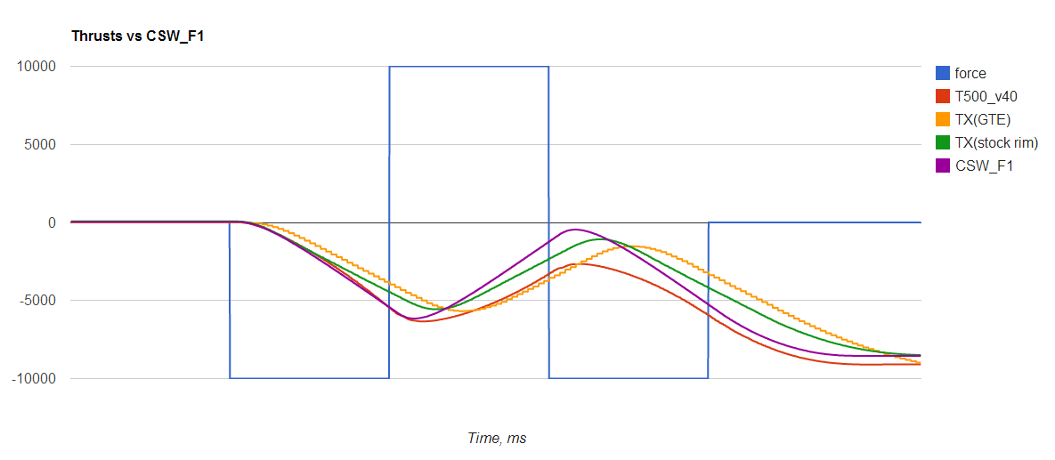

    You've got DD so you can compare. That's a dd too. You can get what is what then with that test. Your chart is fine.
    Lut basicaly Asseto Corsa tool, here it's convenient to look up the linearity with it. The line should be straight. Eliminate the dead zone with your wheel and it'll be good.
    Kinda.
    But this is also a basic concept for this test, and the wheel also may not be seted up according to this for gaming, to make the long story short.
    No I mean MMOS may be suppressed on gain vs EMC.

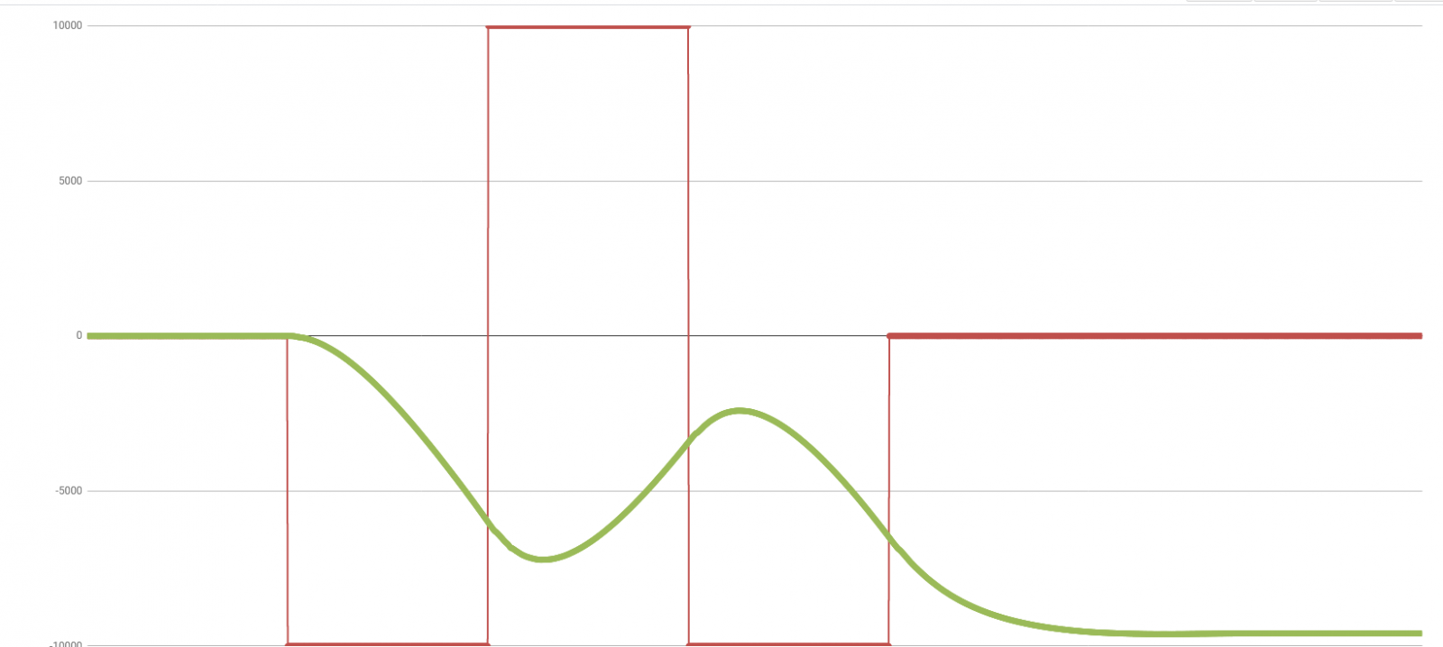

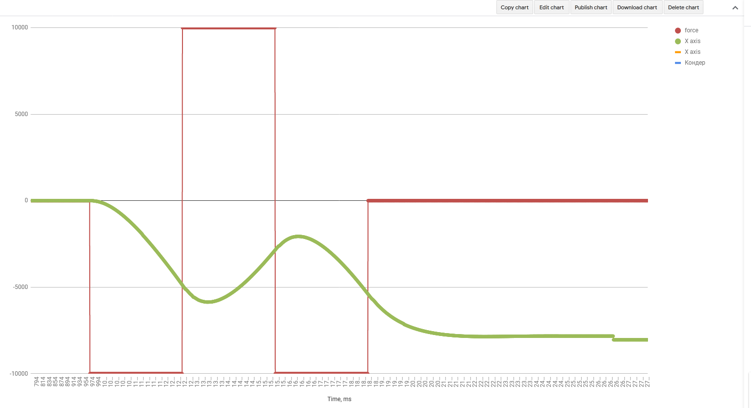

  4. Hoantv
    Hoantv Active Member
    Jul 19, 2019
    117
    981Coins
    +74 / 1 / -0
    AC motor, Arduino
    Hmm, I understand that,:
    1. About LUT: If I resolve deadzone, it is good.
    2. About Graph:
    here is result with MMOS with same wheel. Compare with other wheel, this firmware is still not good.
    the better x axis reach 0 and -10000, the better firmware.
    Currently I have not thought which affects this result yet.
  5. Sieben
    Sieben Active Member
    Nov 6, 2018
    395
    2,241Coins
    +115 / 2 / -0
    This is simply full power direction changes in 300 ms if default signals. Depends how much gain you put in soft ofcourse. The other thing is the sharpness of that changes, reaction, and all that depends on the wheel not on the soft then. It even can be a motor driver itself too. For the sake of a test you can power up the motor with crazy figures, but that's not gonna be a practical application for gaming.
    Your graph is quite alright for a belt drive with this motor.
    Tell more about your software. Do you have an interface already? When will be released?

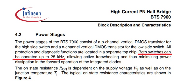

    that cause pwm update too fast and turnback immediately after receiving torque command.
    What do you mean by this?)

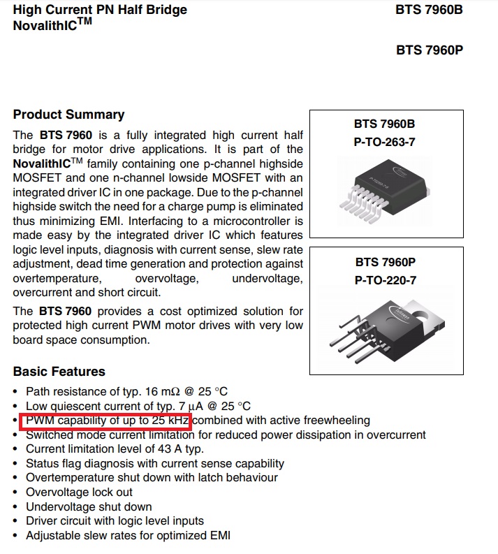

    If you are using BTS driver, going with 38khz:

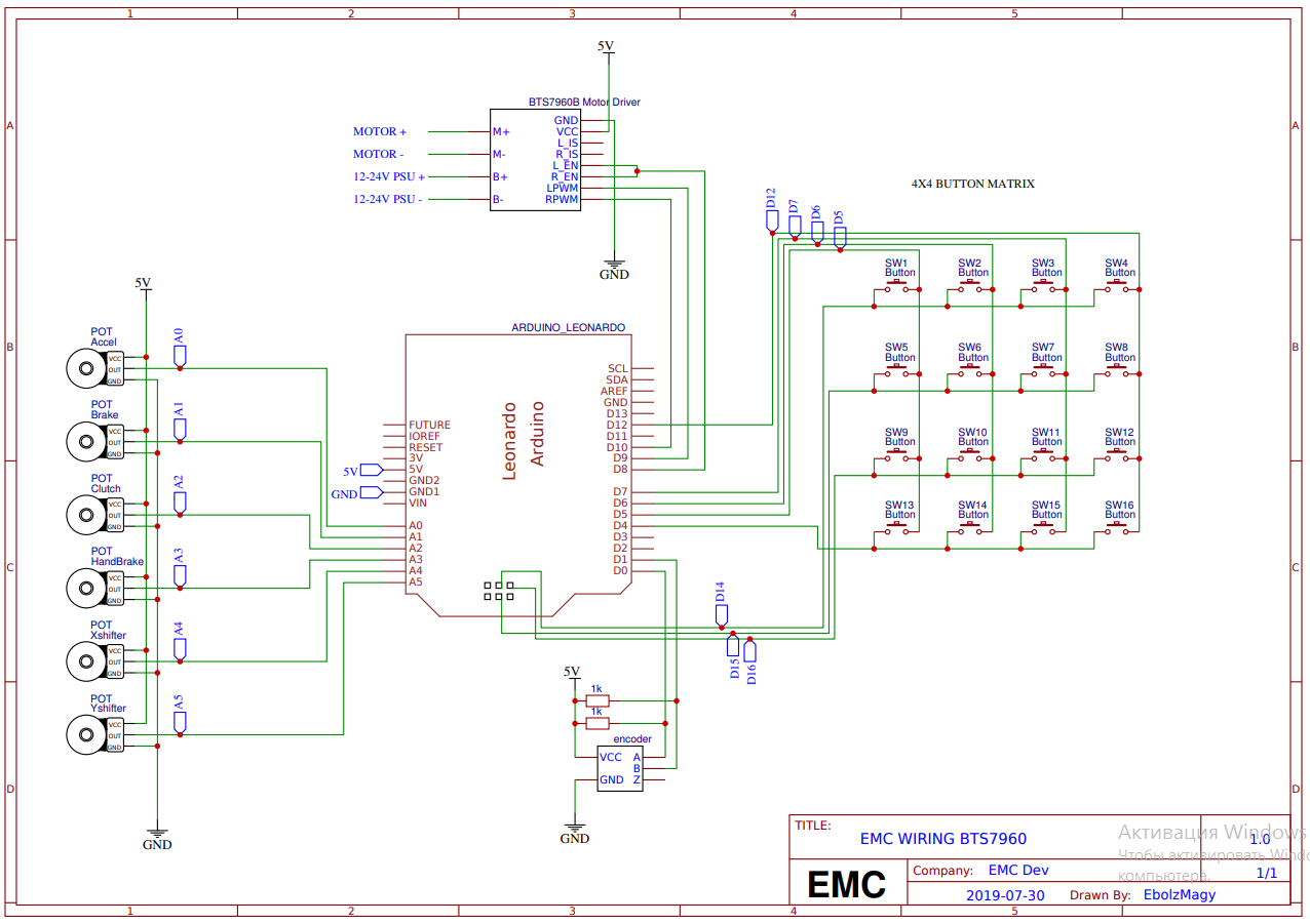

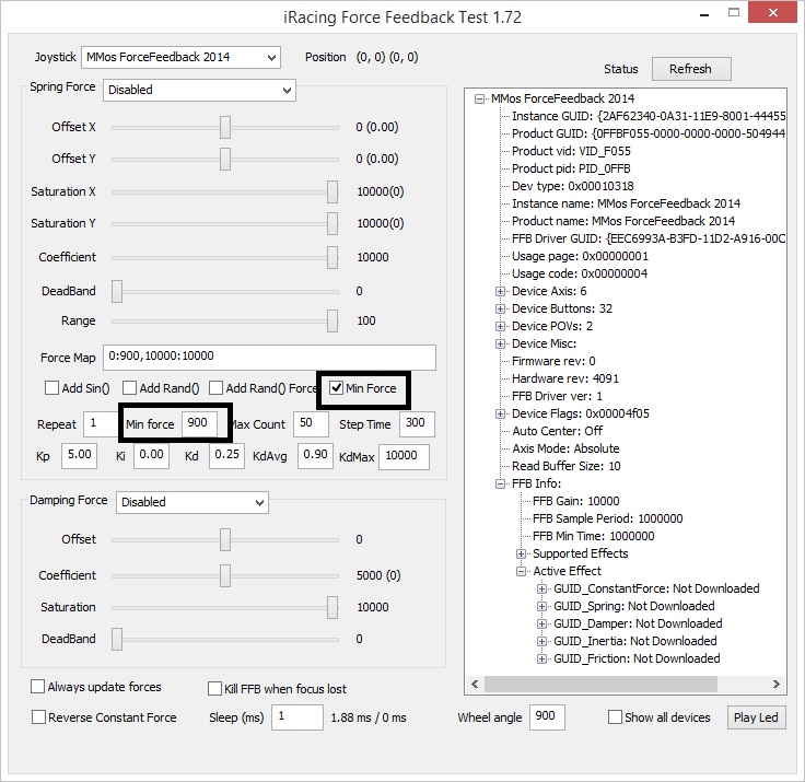

    With reports on power on motor hardly moves. Haven't noticed such things actually, but people report. With EMC new versions, the author made two pwm signals, and instead of giving constant 5v+ on r_en/ l_en hi made dir pin activation when it is needed. Also min force applied must be resolving it a bit.

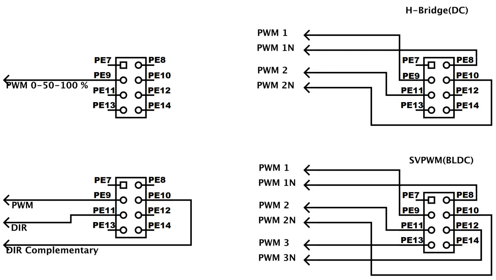

    MMOS has such connections layout, if it might help you too.

    I mean main loop set PWM strengh. It update too fast with ffb calculator (38khz in main loop, pwm is 20khz) => motor can not reach desired position. I reduce frequency update to 10khz, i think it ok know.
    I think min force is good idea, it is remedy for this case. Now I test each effects one by one:

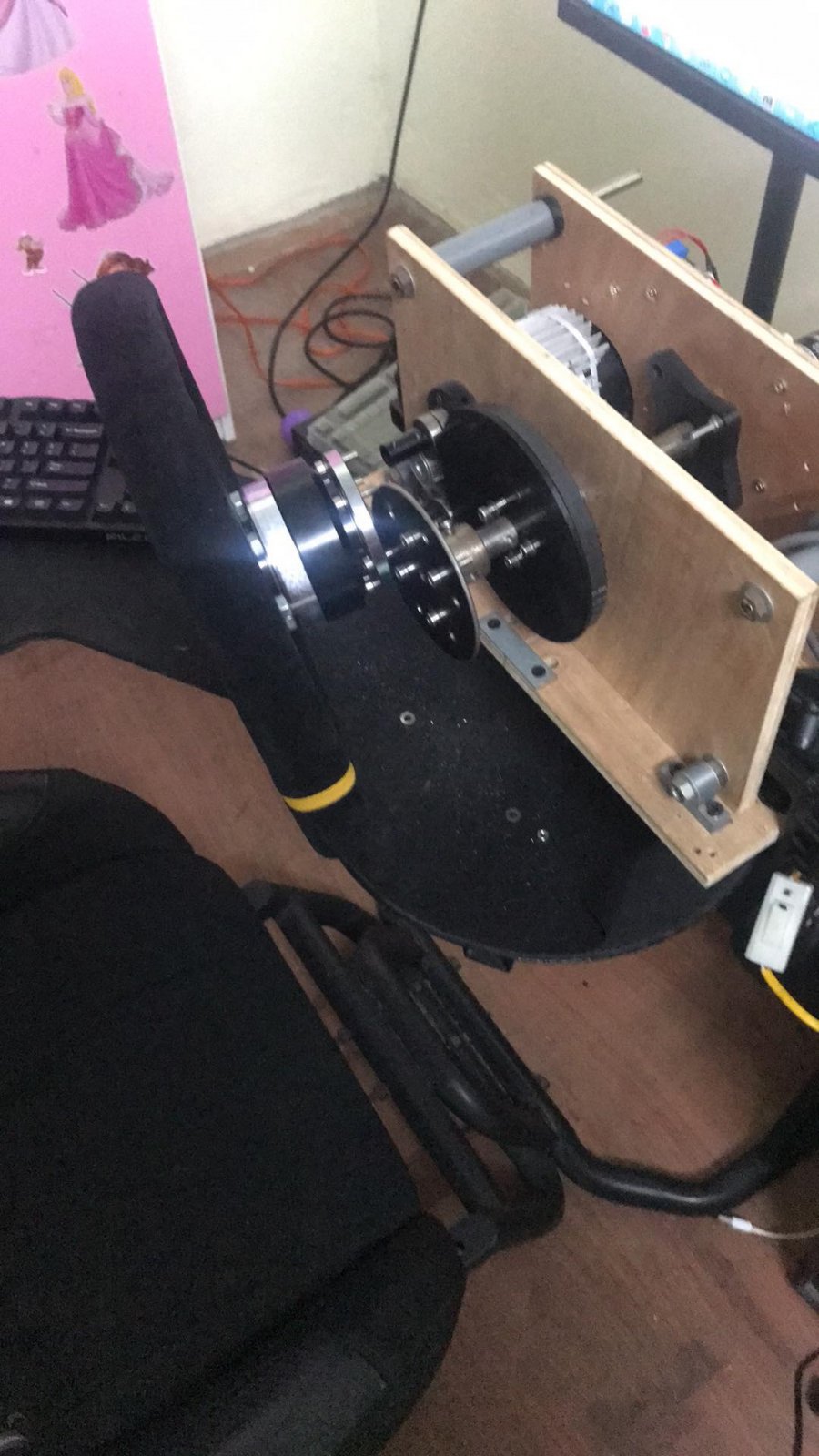

    I made my own simulator with steering wheel and pedals. I will post some pictures but now I want to develop the for feedback with the arduino code of HoanTV. Thank you for your job, it's amazing !!
    I want to make FFB in two steps :
    - 1st step : arduino LEONARDO with TB6560, STP-58D111, power supply 24V-15A and rotary encoder LPD3806-600BM-GS-24C
    This is a micro FFB configuration to verify the code and play a little before I use the real configuration. if I succeed this micro setup, I apply in my real configuration
    - 2nd step : arduino LEONARDO with HBS86H servo drive, 86HSE8.5N-B32 (encoder included 1200), power supply 24V-15A

    Do you have an schematic wires please ? Can you confirm me :
    Pin 0 and 1 for the encoder ?
    Pin 9 for the PULSE and Pin 10 for the DIRECTON ?

    Pin 0,1 for encoder
    Pin 9,10 for pwm +-, pulse/dir not yet test because i dont have driver.

    i recognized that, bts had a problem, it only control motor when ffb is greater than 20%, that why motor can easily move. I replace with new bts. It is hard to move the motor again. Not yet found a solution. I will try set pwm =+- 1 based on encoder value to see what happen.
