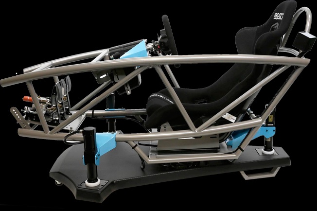

    No, you would have to add math and map the output accordingly.
    So for a 8 bit setup, and a sim like below with 3 legs, lets fix heave.
    Lets say all axis are centered at 127 ‬(127 ‬is center for 8 bit)
    And the sim can heave up and down (2" inches)
    //Get Current Location for Heave (center around 0)
    ((Axis1 + Axis2 + Axis3) / 3) - 127‬ = 0 (output = 0)
    //Get percent used for output
    If output <> 0 then
    output = output / 127 (to get a number between -1 and 1)
    output = output * 2" (Amount the sim can heave up or down)​
    End if
    //Send output
    Send new offset value for heave = output
    I have not debugged this or anything, but i think it explains the idea pretty well.
