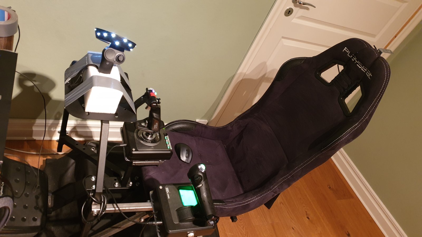

  5. Onslope
    Onslope New Member
    Dec 23, 2019
    25
    211Coins
    Quick fix (not ideal)
    Feedback appreciated
    1. Setup the Reverb (wmr) controller as picture below.
    2. Select the controller as the motion compensator unit in OVRIE.
    It works as long as the controller is active.
    It works ok looking around during dogfighting in DCS, but some distortion is felt.
    Using 2 controllers (1 not motion compensated) tend to keep the controller alive longer.
    Solution: we somehow keep the controller active it's a working setup for now.
    Problem is long cruise segments.
    Turning, pitching and rolls keep the controller alive and just lightly move the controller by hand wake it up quickly.
    Issues I see.
    1. Battery is drained quickly. (No charge cable)
    2. Controller fall asleep during low continuous motion from the rig.

  7. Onslope

    There is still also the issue of pitch motion. When the sim pitches forward driver head goes up, but controller goes down because of the center of rotation.
    Perhaps this could be solved by inverting the heave value sent to OVRIE on 2DOF or some 3DOF but that would not work on a sim that has a heave axis.
    Has anyone else attempted putting an enclosure on the sim for WMR tracking? My experiment was not "real-world" but it indicated that the WMR positional tracking would not function at all in a very small enclosed space.
